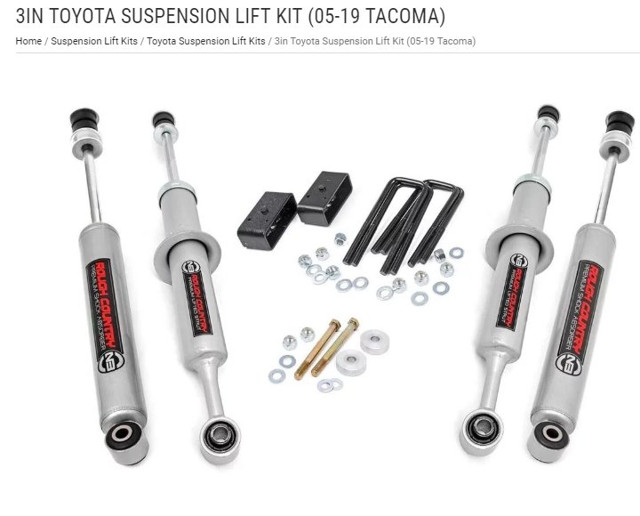

    This is the kit OP ordered...
    Get rid of that spacer

    Kit comes with shocks, not coilovers

    On that link, when you choose the "N3" shocks option as you said you have, notice how the spacers go away? That's because it's one or the other.
    I believe they sent you BOTH by mistake possibly and you installed both, so as everyone has said you have stacked lifts. Take the spacers out.

    The second option is a coilover kit.

    Yeah yeah - it's still a shock absorber. I understand that it's structural.

    Would it not be like a non-adjustable preload strut set to 3”? Using stock coils?

    Somebody fucked up at the warehouse.
    OP, pull out the spacers and sell them. You should be good to go.

    Wait, so you have a 3" suspension lift (coilovers), and then you put a 3" spacer on top of the coilover? :eek:
    No wonder your UCA is hitting even at ride height...

    Yeah someone screwed up and sent you the spacer with that kit. All you need to do is remove the spacer and you’ll be golden.
