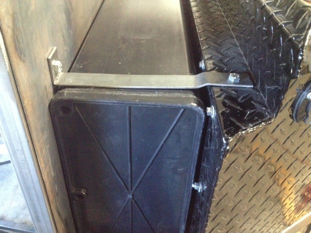

    Tongue box is secured presently with four 3/8" bolts with nylon lock nuts and large fender washers on the aluminum tongue box to help distribute force. The front skin of the cargo box as well as the tongue skin is 14g steel.

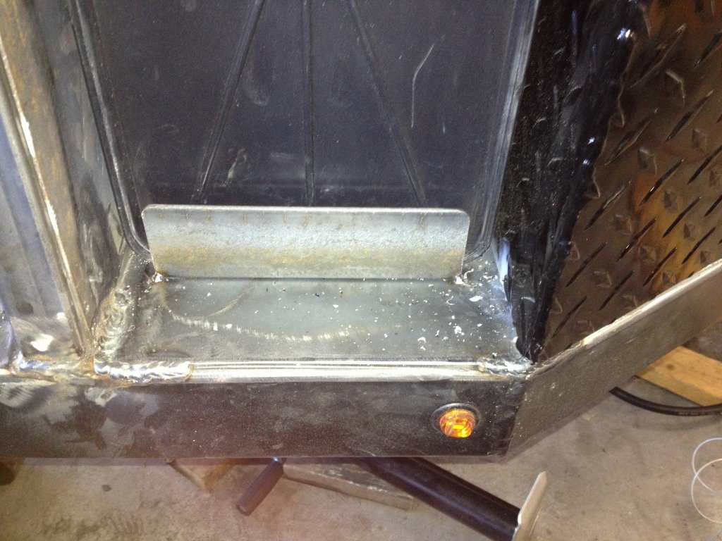

    I wanted to keep the water tank reasonably removeable. So here's how I decided to secure the water tank. Fore and aft movement obviously restricted by the cargo box and tongue box. Left/right movement is restricted by some 2" angle iron welded in. Vertical movement would probably be fine with gravity alone...except I'm the one towing this so I added a couple strips of 1"x.1/8" and tied it to both cargo boxes.

    Hmmm. Truck=LT. Trailer=MTish. Kind of concerned about top straps on water tank not handling what might possibly be thrown at them. Side to side, not worried one bit. Just might need a little more "hold down" as it is close to the tongue and any up and down motion on the truck will be amplified to the front of the trailer.

    I'll give it a whirl and see what happens. I put two top straps, one on each side. The weakest spot on the top straps are the mounting points in the aluminum tongue box which i backed with 1.5" fender washers (not pictured). So if it starts elongating the holes in the aluminum, it'll be real easy to tell that it needs more cow bell. If that happens I'll just go all jberry retarded beef on it.
    In the event it blows up on trail, it's in a convenient enough spot that I can just wrap a ratchet strap around the whole damn thing to snug it to the frame.

    I'd just be worried about the tank's ability to shift around. Don't think it's gonna fall off but rubbing on the bolts of the tongue box are another story. Those might rub thru if it shifts.

    The picture is deceiving there. The bolts you see on the backside of the tongue box are what's holding the battery charger in place. They however do not touch the water tank. They cleared minimally and then I hit them with a flap disk and brought them down to about 1/2 thickness of the original size, so I've got good clearance. The friction points will also have that self adhesive foam sealant used for windows to act as a pseudo cushion.

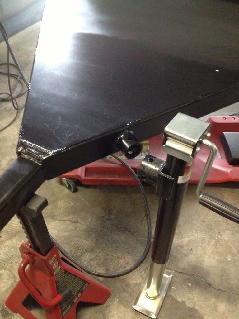

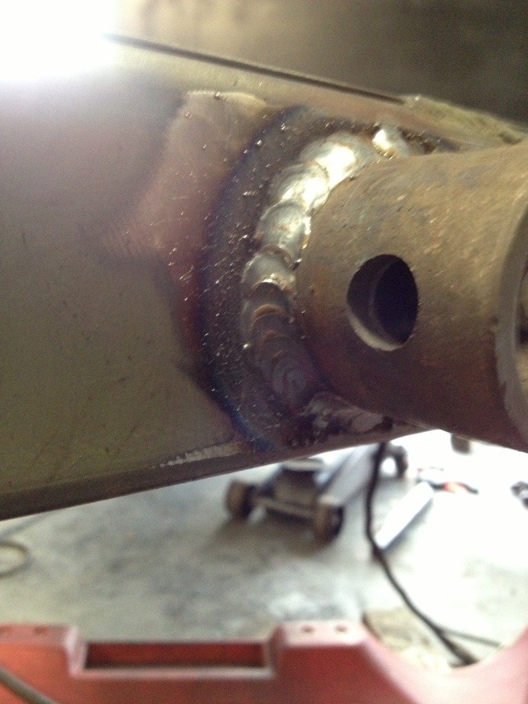

    Got the tongue jack mount welded in. Kinda cool, it's just a piece of .250 wall DOM with some holes drilled in it so I can easily remove the jack and throw it in the tool box, or just rotate it 90* kept in place with a pin and keep it on the frame for on-road towing.

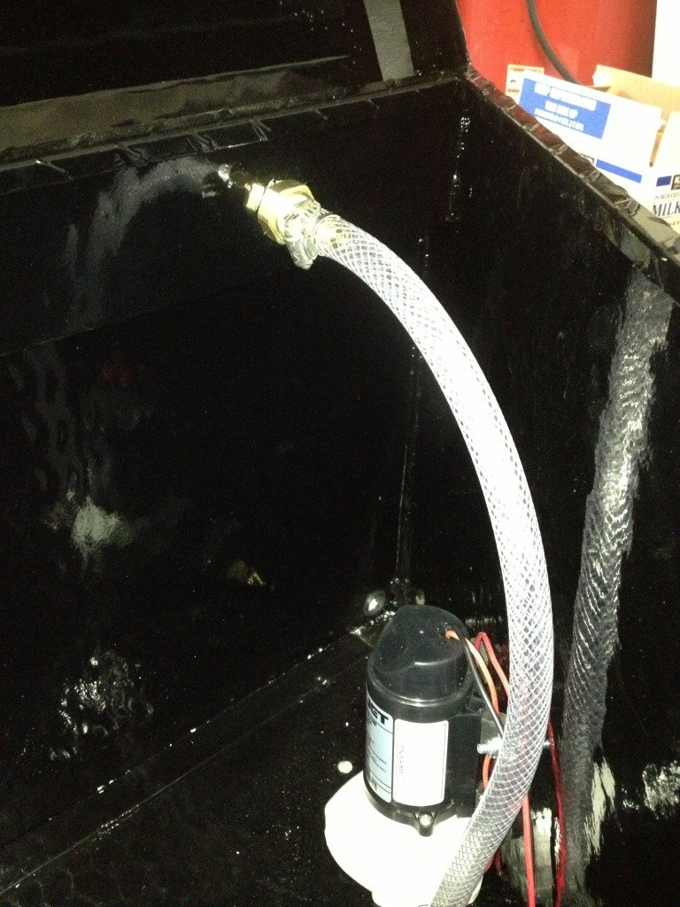

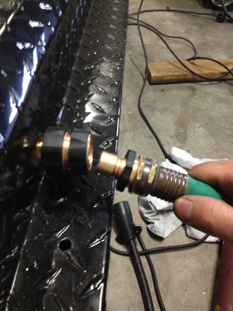

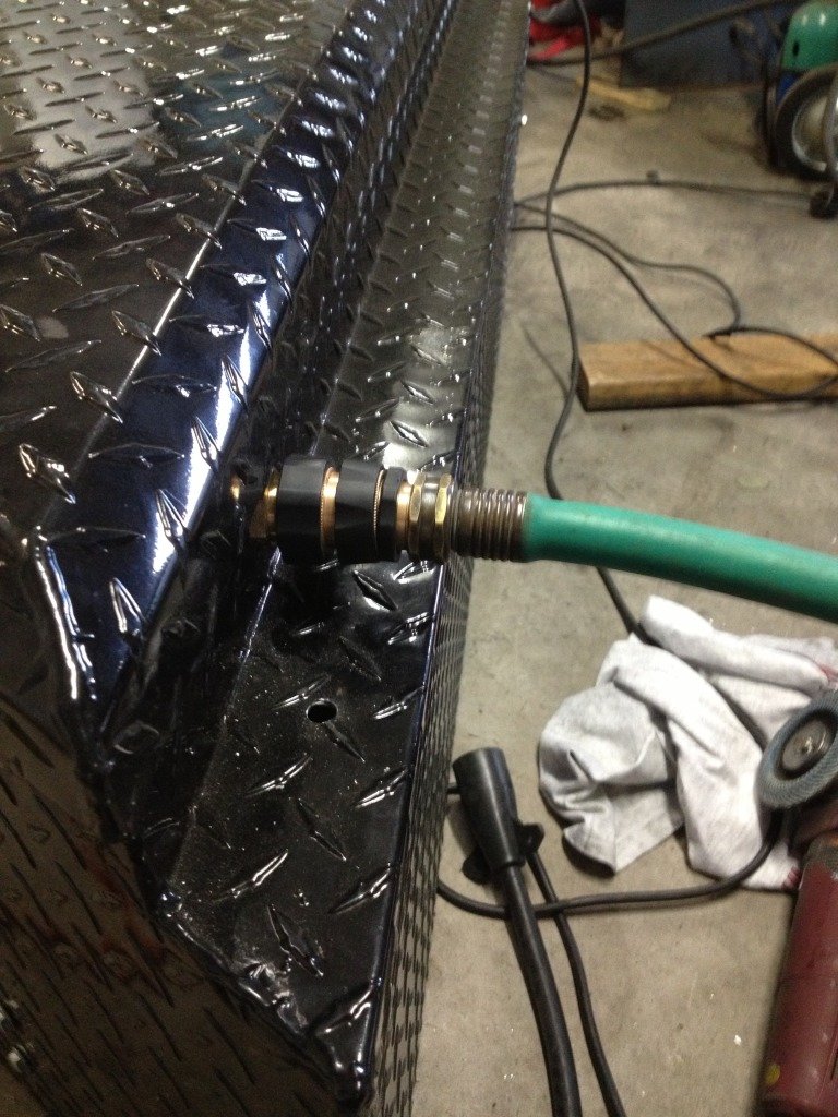

    And some bit of the bells and whistles. Outside the toolbox, with the help of a metric shit ton of adapters and a bit of ingenuity, I was able to rig a quick disconnect garden hose setup. The hose pictured is for illustrative purposes only. I'll actually have a small coiled garden hose which will have a showerhead on the other end.

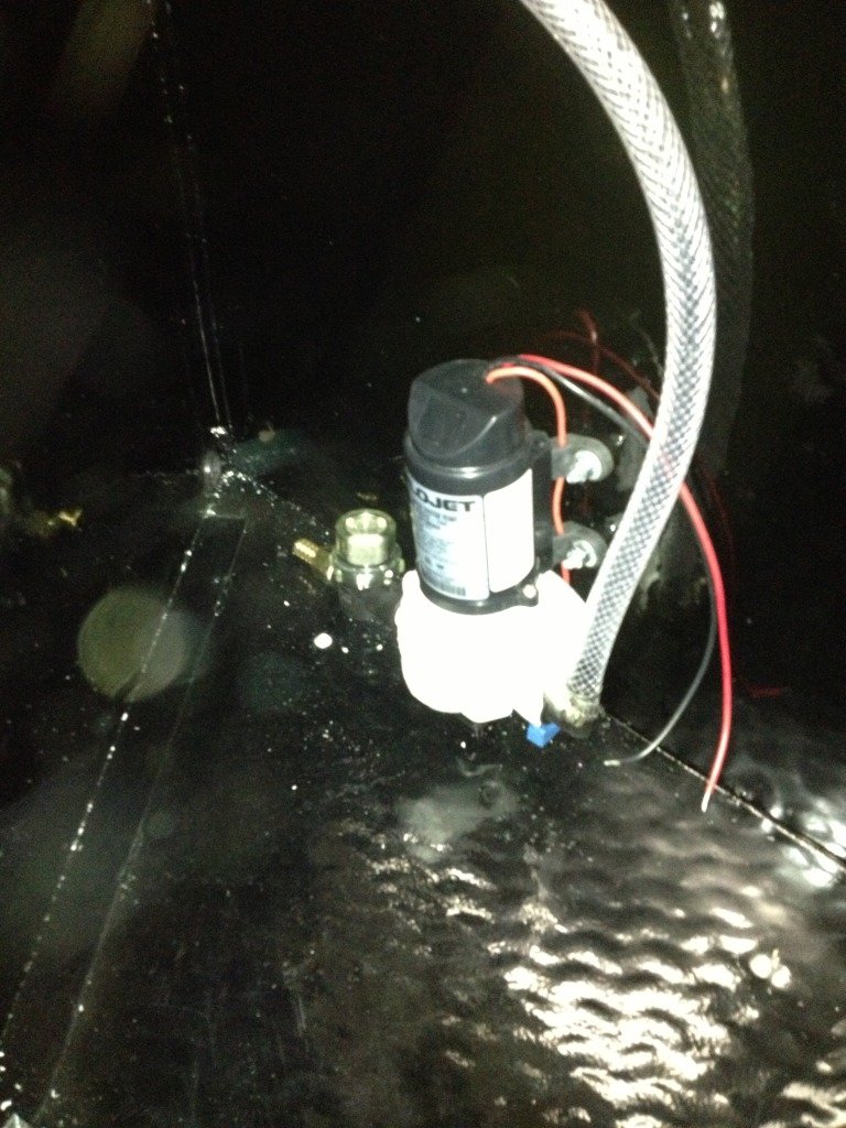

    Inside the toolbox you can see it hooks to the output of the RV water pump which is mounted to the wall of the box. On the inlet side there's a prefilter to keep debris out. The water inlet line will go strait out the backside of the box and into the water tank.

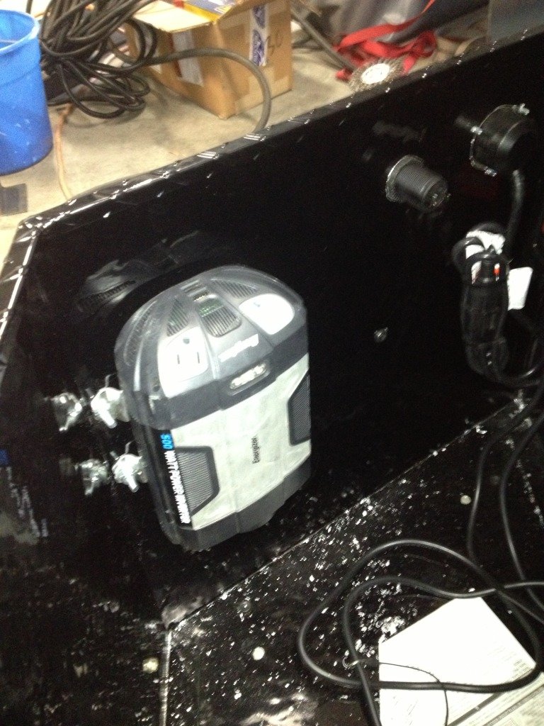

    Also got a 500 watt inverter mounted on the other side with the other power accessories. Naturally it has USB ports so the misses can charge her phone when we go places with no reception :jerkoff:
    For a crappy little cheap Amazon inverter, this thing does work! I was able to run my 4.5" grinder off this thing and cut off a bent to shit exhaust tip.

    dang that inverter looks like 2 times the size of my 800w one.
    Good additions though! i like the hose connection.

    Didn't really seem that big to me, but I've got a shit ton of room in the tongue box. It's 9"x5"x2.5". I like it because the fan doesn't turn on unless it starts heating up thus keeping power consumption lower.
    Also it's 500w continuous. Actually 1000w peak.

    now that would explain it!
    think mine is like 300w contiuous or so.
    Was just odd that it looked so much larger. but now makes sense.

    What walls thickness is that 2" stock on the reciever?
