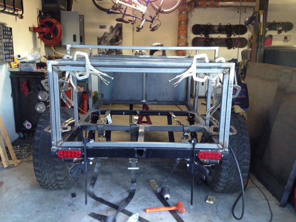

    Ran out of shielding gas....so on to other things.

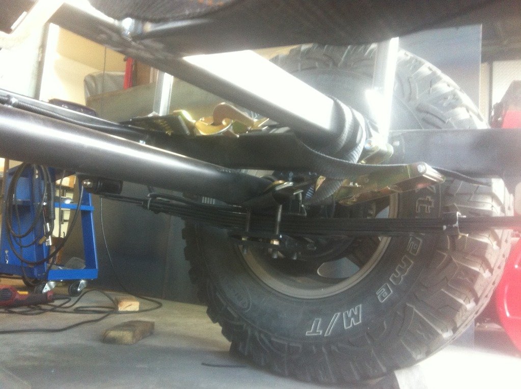

    Just look at that bump travel!
    Bilstein or Fox shocks in short order. Just gotta get final numbers once I get the bump stops mounted.

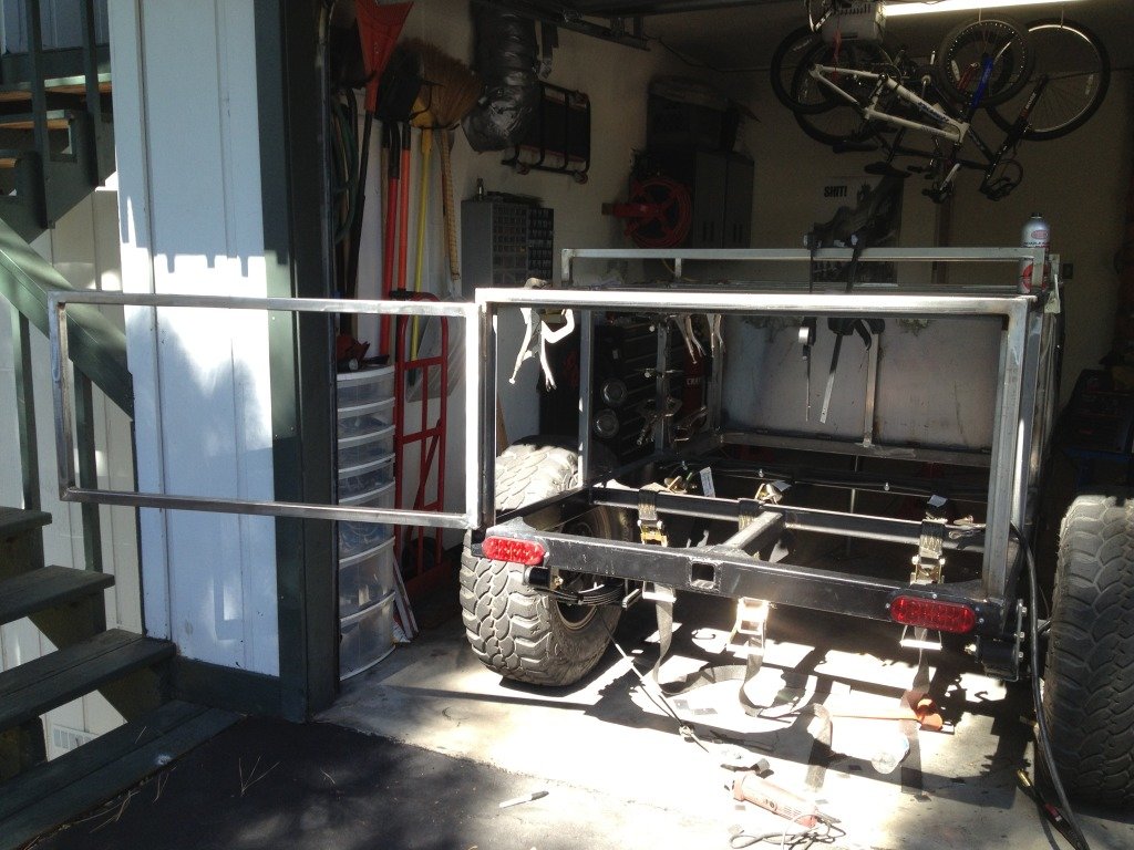

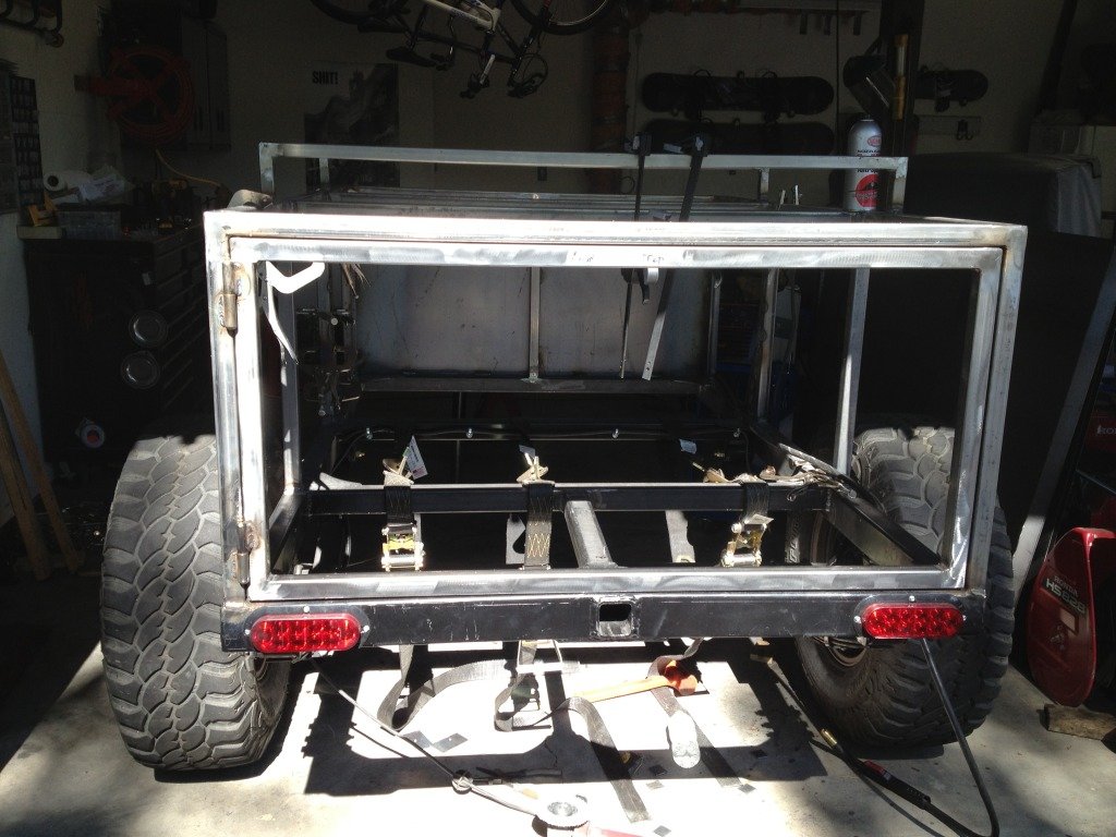

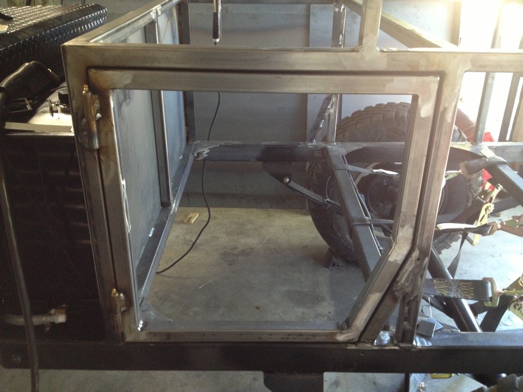

    Tailgate framing.

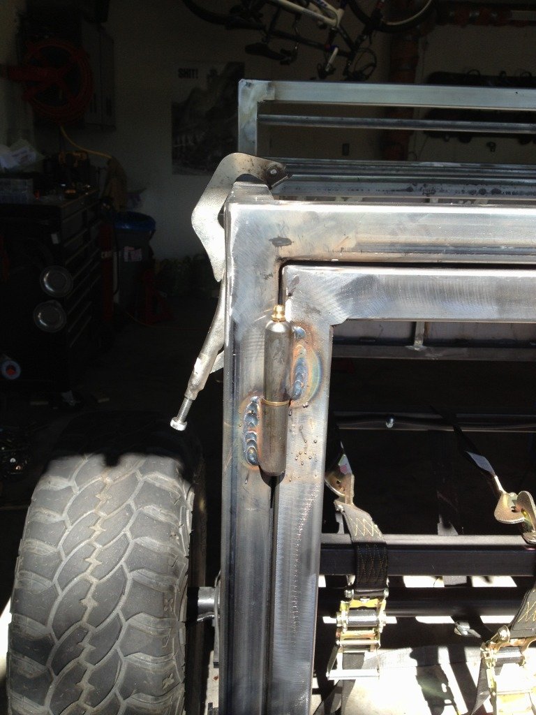

    Greasable bullet hinges welded and working. Slides like butter.

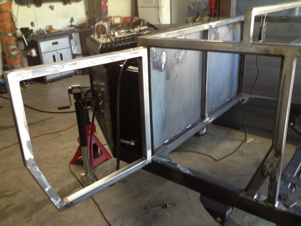

    One of two side doors done. Fuck angles.

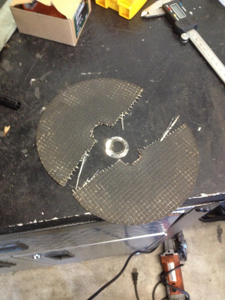

    Oh and.....
    Go home cutoff wheel...you're drunk.

    Man, if that had shattered... JBerry-1, shitty cutoff wheel-0.

    Quick question about the gate-what was the reasoning behind the swing out vs. drop down? Also, why not square off the side doors? Let you get stuff in there a bit easier I'd think.
    Definitely starting to look like a trailer tho!

    I think he should put a fold down table on the fold out tailgate;)
