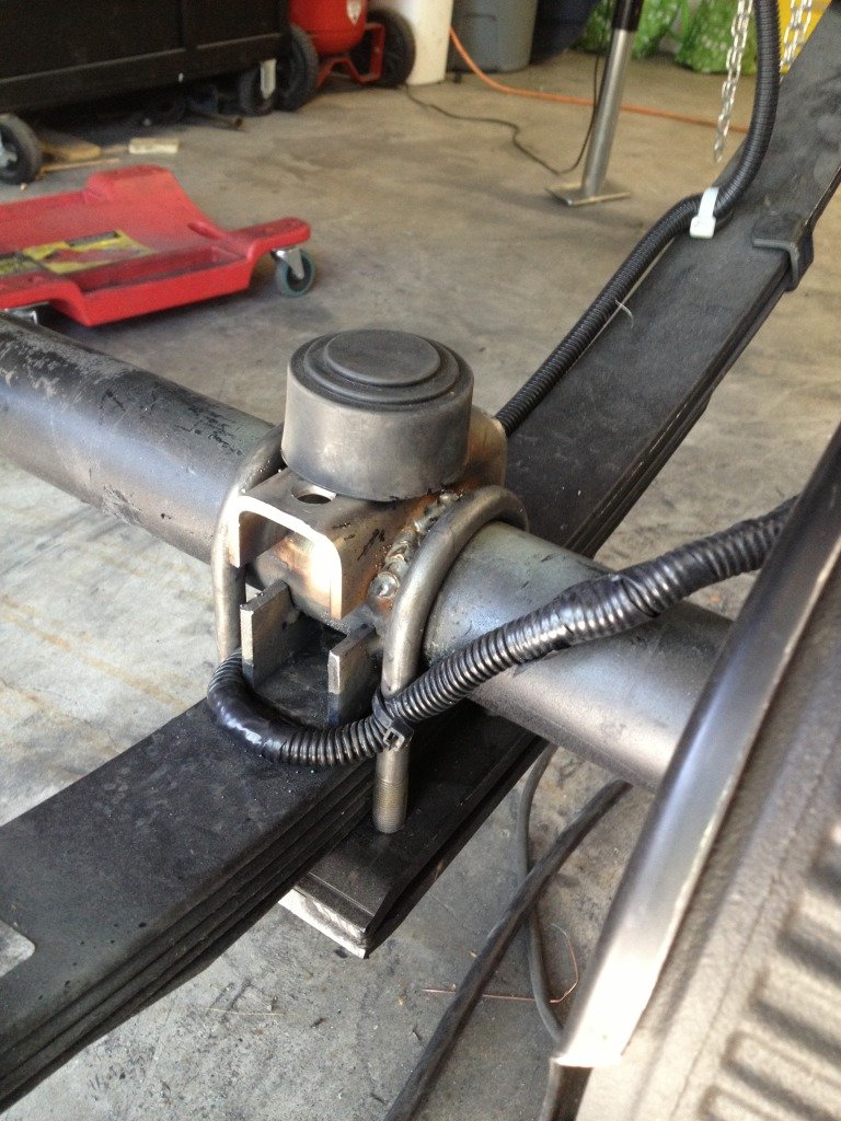

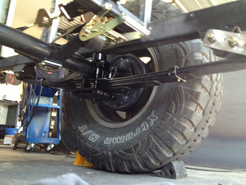

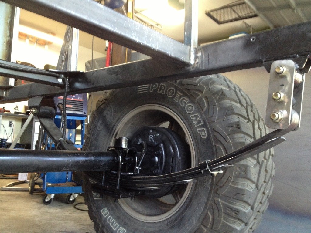

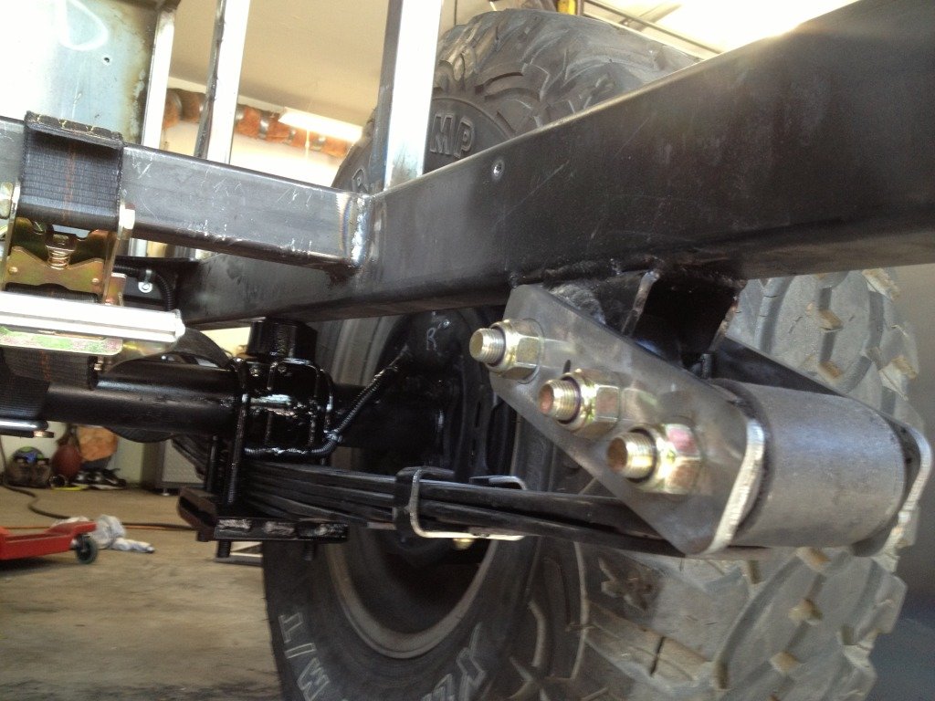

    Bumpstops are mounted. I used another set of spring seats and welded them to the top of the axle. Used the poly bumps i linked earlier with a shaved down nylon lock nut and washer and bam...perfect bump hitting the frame dead nuts center.
    Frame to bumpstop at full droop is exactly 7.5" now that I've got shorter 4" shackles. A hard hit and the bumps will compress about another .5"
    Can also see some of the detail work I did with the brake wiring. Everything is loomed and taped and placed in a spot that would be in the best possible spot i could visualize as being snag free from obstacles.

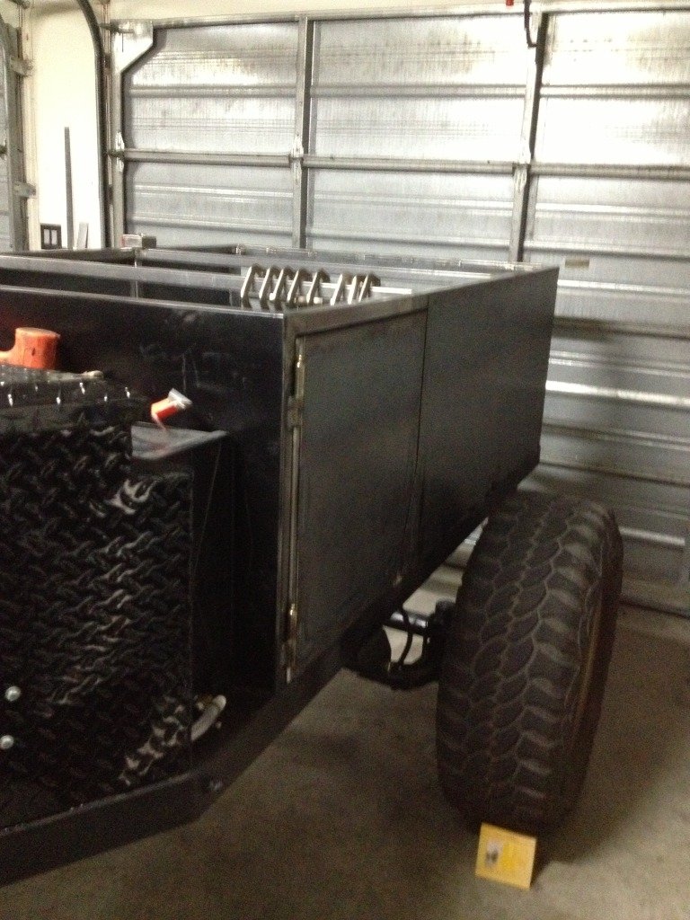

    Also I started skinning the doors. Didn't get many pictures as the seam sealer is still drying. I'll did take this one is just cause it looks purty. :eek:

    Nice, that spring perch for the bump is a great idea.

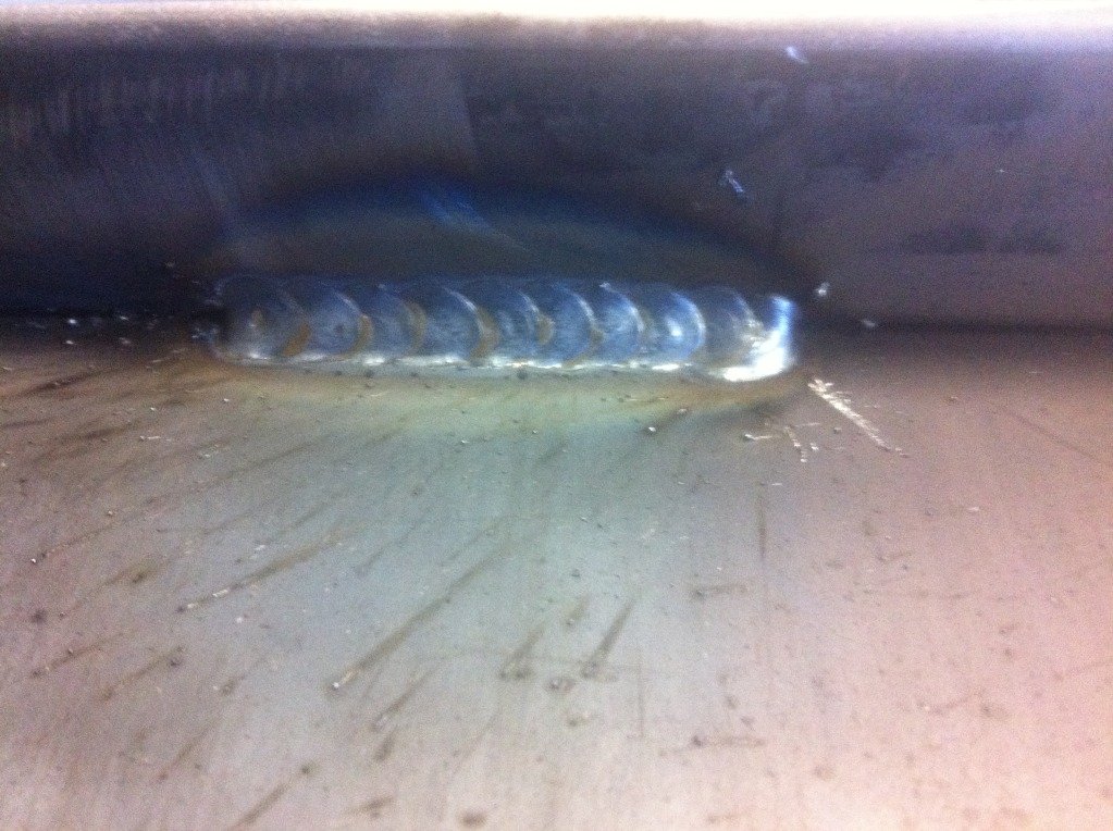

    Shit's getting cereal

    Lets jump it!

    You're making fun of my scratched iPhone lens drunken photography skillz huh?
