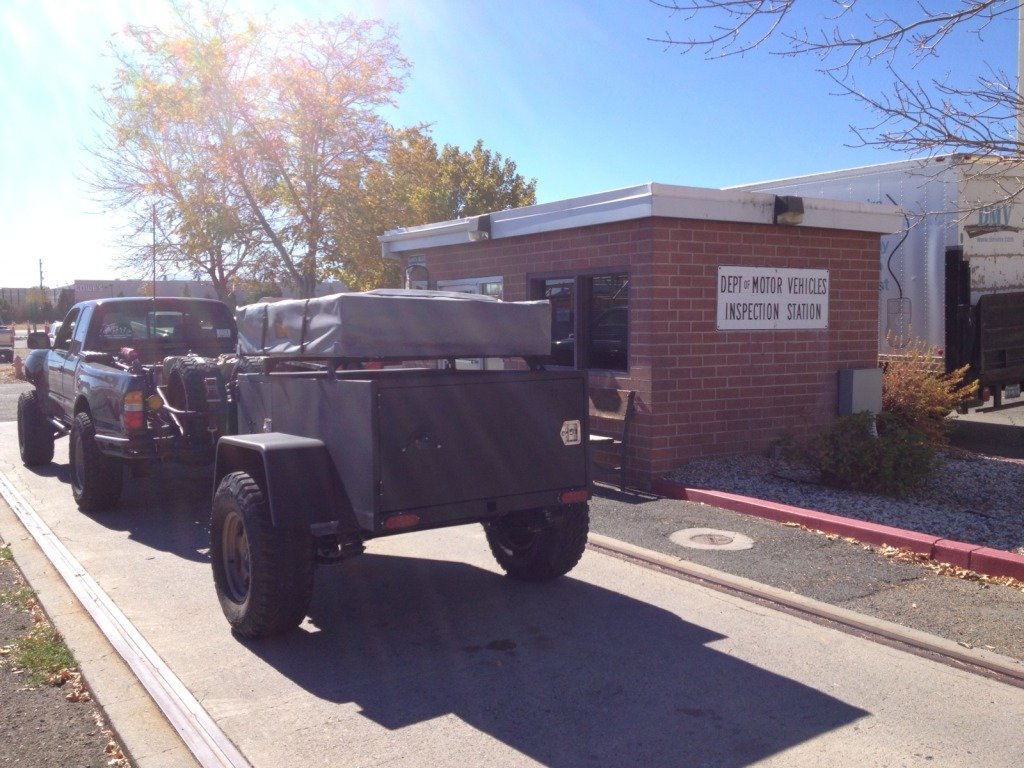

    On a different note...I towed the trailer down to Carson yesterday to make it all legal. Part of getting it registered is you must get a unladen weight slip first. Anything under 1000 lbs gets a dinky motorcycle license plate (which I don't want). So...to ensure I was over 1k lbs, I filled up the water tank to the brim, put the battery in, kept all the cabinetry and oven in, and of course left the RTT on.
    Got to a local scale and the lady running it was super cool as I explained I wanted to make sure I was over 1k. It's a catch 22 though...as part registration is taxed based on weight. Unloaded the trailer onto the scale and it read 1480 lbs :eek:
    So pull out 150 lbs for tent, 175 lbs for 21 gallons of water, 50 lbs for cabinetry and oven, and probably 60 lbs for the battery, plus misc shit inside the tongue box. Trailer itself is right around 1000 lbs. The nice lady wrote the slip up for 1100. :D
    Regardless...tows pretty damn great. No sway at all. I pulled the bottom two leafs out of the leaf pack and after driving it around I'm going to stick one of them back in and bump up the nitrogen in the shocks. Suspension is actually too soft at the moment.
    Anyways....all tagged and legal now! Official DMV assigned VIN stamped and stickered on the trailer. The inspector told me it was built exactly to state requirements (actually beyond considering I have brakes too) and "damn sexy." Anything over 80" has extra laws (which I knew). When he measured the width, it came out to 78 inches...by design. :D

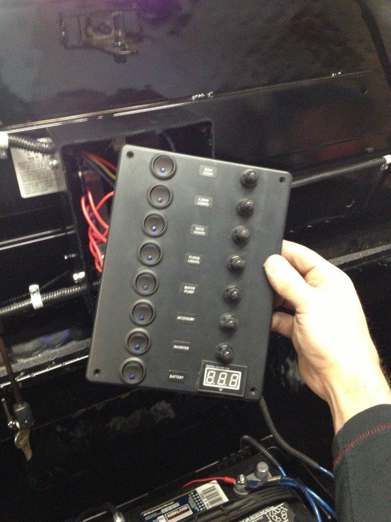

    but... a little dremel happy near the gauge? :p

    Yeah that was an oops. :anonymous:

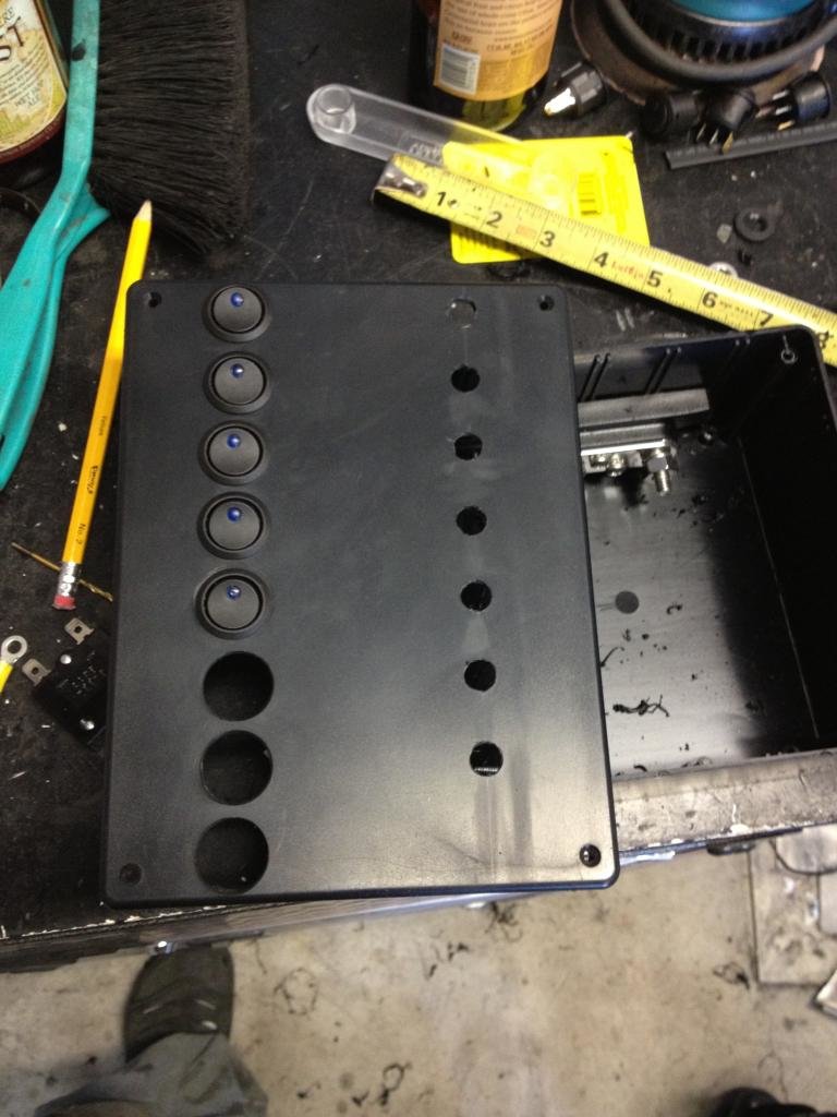

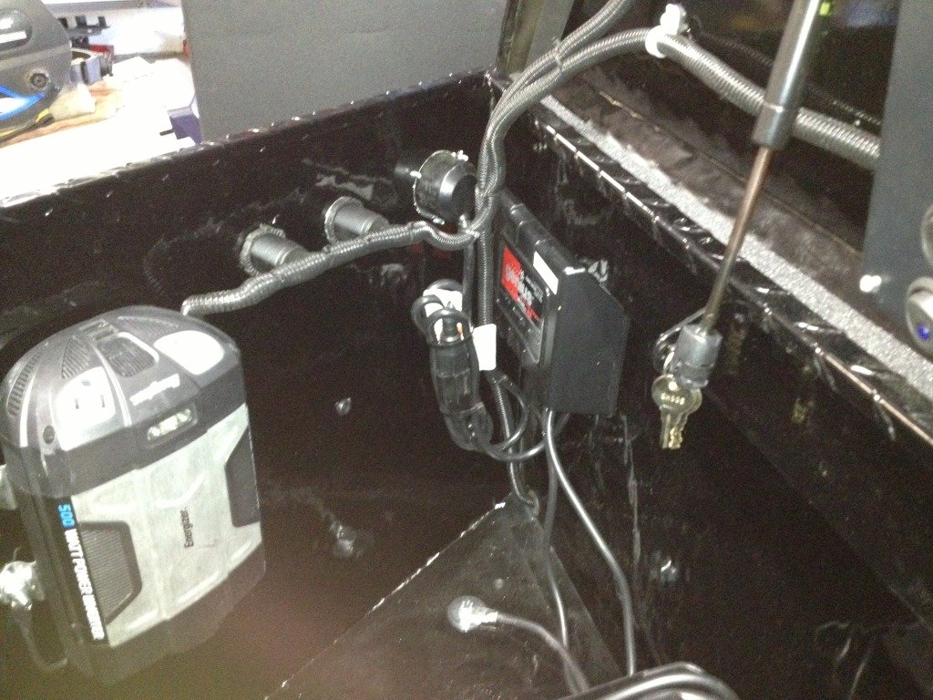

    Fuck me six way's to Sunday....I am so tired of doing wiring. I'd rather build another trailer frame than do more wiring.
    I could have not loomed it...
    I could have crimped instead of soldered the "important" bits...
    I could have bought a pre-built panel...
    I could have just ran wires all of the fucking place like most the bullshit wiring I see....
    But NOOOOOOOOOO. I'm too much of a god damn perfectionist. This is why I do this shit as a hobby and not a profession. Companies that make these trailers as a living have guys that do fab, guys that weld, guys that do electrical, guys that do accessories, etc. etc. etc....
    Dumbasses like me who think they can just put on a different hat from day to day and have to be a jack of all trades...we get frustrated and swear profusely and throw tools out our garage door so far that they end up in the neighbors driveway.
    /rant
    I'm about half way done with the wiring. My switches use a smaller .187" instead of the standard .250 connector...which is impossible to find locally and the dipshit I bought a pack from on Amazon sent me a clusterfuck of male and female connectors instead of just the female connectors I ordered. But I digress...

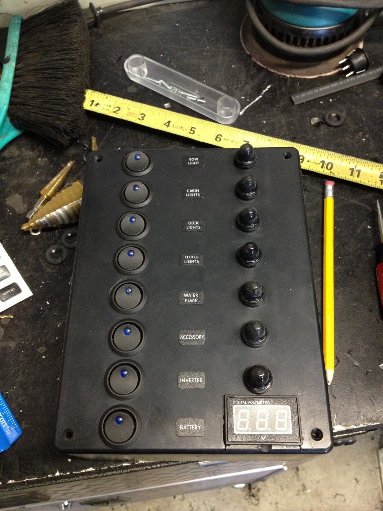

    Are the bottom 3 switches off-set a little? And the 2nd from the top?
    How is that for poking your OCD in the ass? :rofl:
  14. Oct 20, 2013 at 5:26 PM
    #354
    jberry813
    jberry813 [OP] Professional Fluffer Moderator
    Jan 21, 2011
    #49636
    28,482
    Jason
    Lake Tahoe
    2012 DCSB Sport
    ...too much shit to list.
    Yeah...don't think I didn't notice that too. Trying to drill 8 fucking holes completely in-line with a drill that has a bent chuck is a pain in the ass. If there was a radio shack within any reasonable distance I would have bought a whole fucking new one and started over.
    PS....fuck you.

    What do the push buttons on the right do?
    Shame your not closer. I love wiring :) I'd do that for ya, plus have this whole week off school.

    Top-down:
    Bow (Tongue Box) Lights
    Cabin (Interior) Lights
    Deck (Rock) Lights
    Flood Lights (Off rear of trailer, also wired as reverse lights)
    Water Pump
    Accessories (External USB and 12 volt plugs)
    Power Inverter
    Battery (switch on to see remaining charge left in the battery on the voltmeter)

    Meh I'm over it. Kind annoyed me at the time along with the accidental dremmel notch, but whatever. It's still gonna function perfect and it still ended up looking pretty good.
