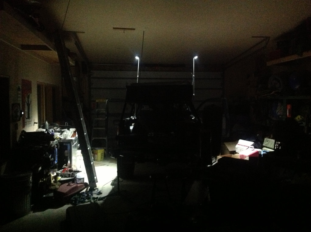

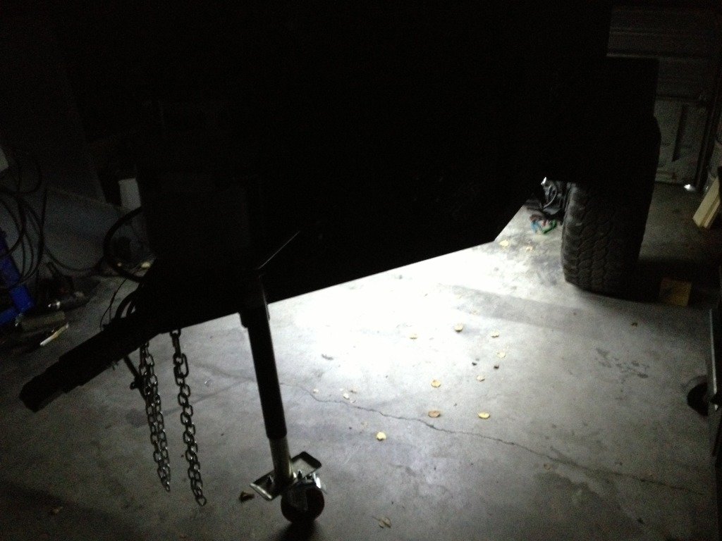

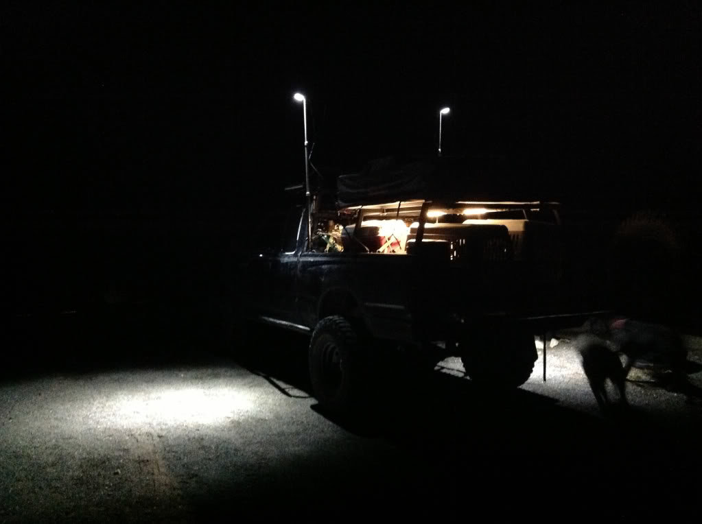

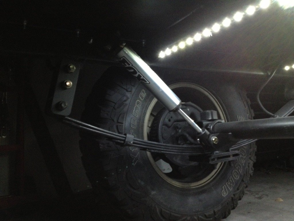

    A little mood lighting
    DECD272D-8E81-455D-837E-200EC4A46E06-427_4a984d36ed9aa5914ec3fac5cb4cb1b8814df879.jpg

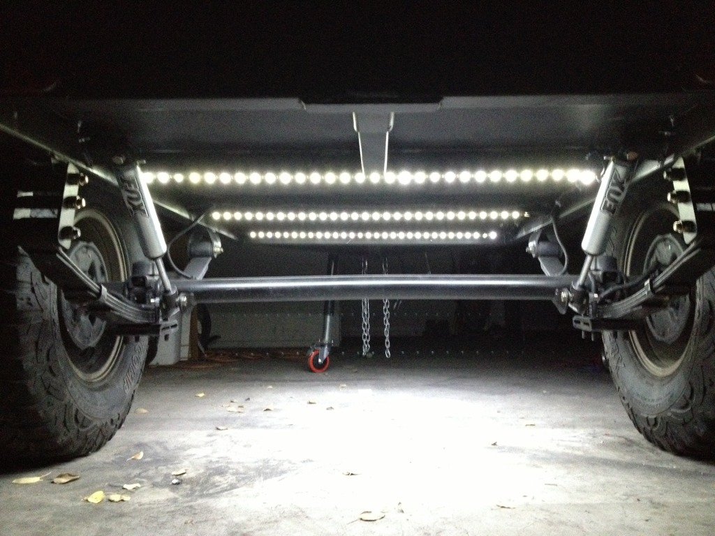

    And damn them shocks look sexy
    9D7E11FC-A457-487A-A520-4C7086CDEC6D-427_e69d5c76638fadd0bdb0c3425f7a321775f9ee0d.jpg
    D6A9C221-FD17-4738-89CF-3A28B5E79780-427_819b5660472a36137c4e1415b72fc107405c85a1.jpg

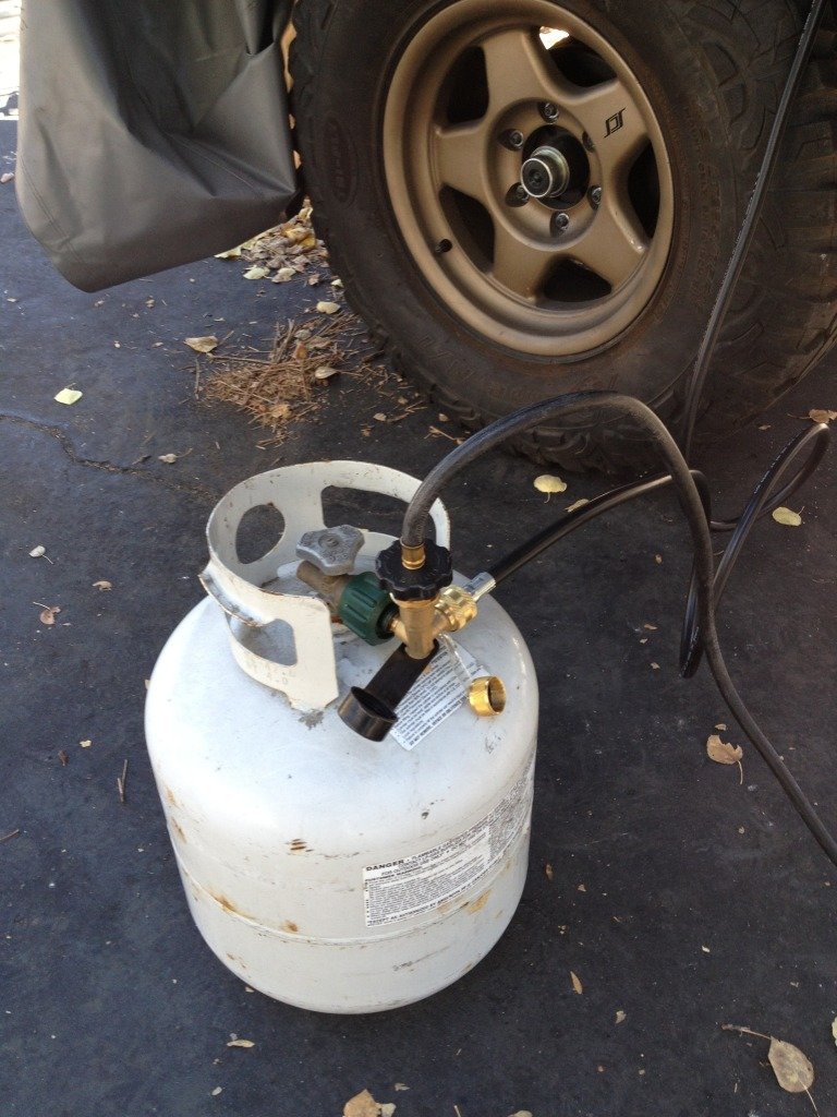

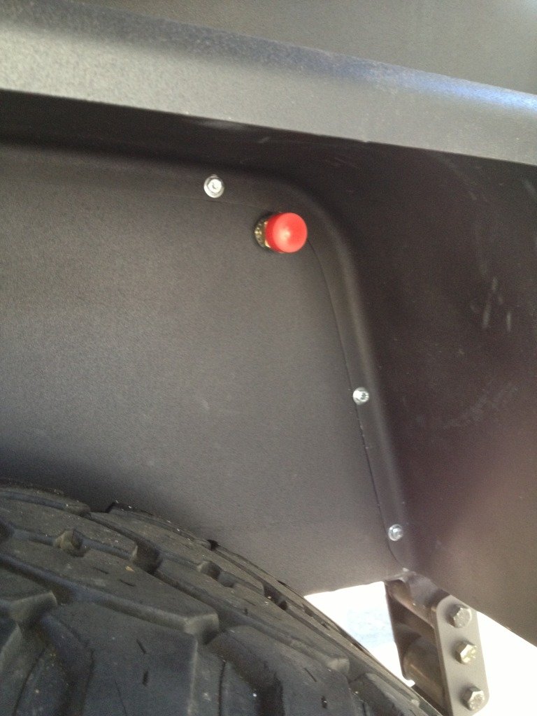

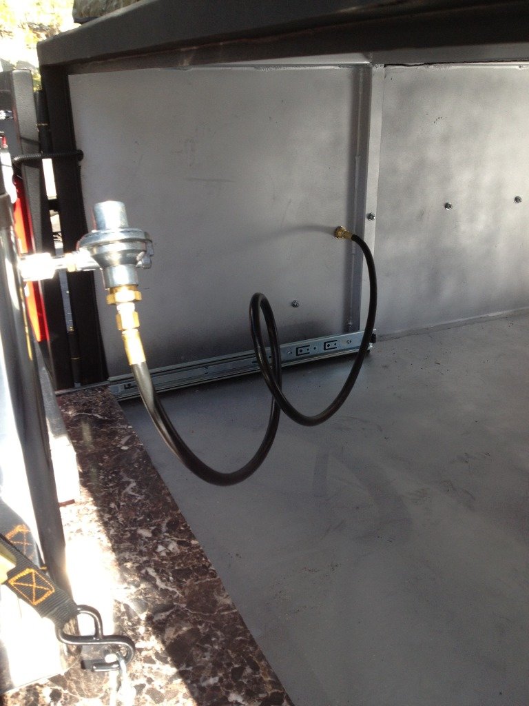

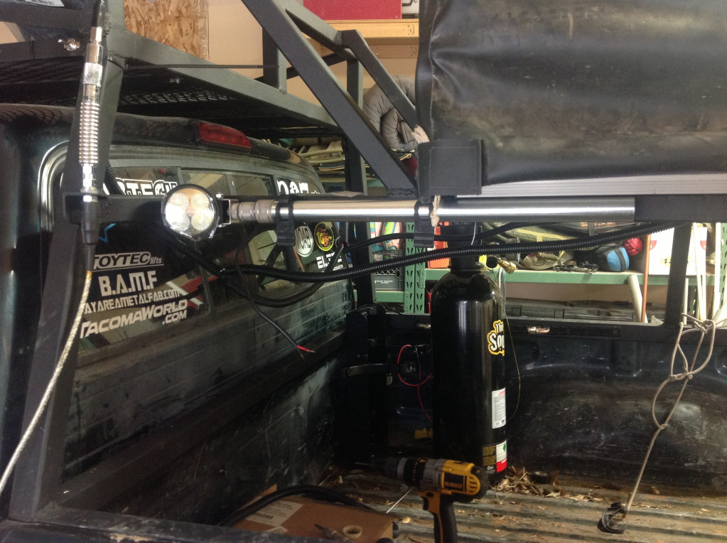

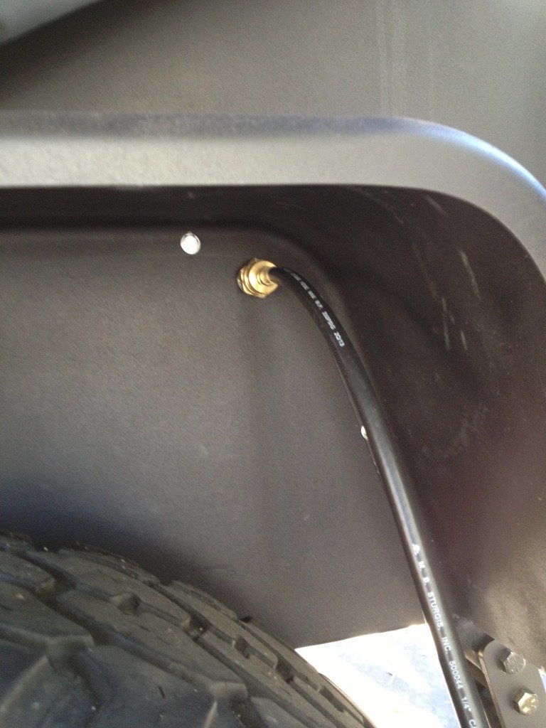

    So this is where my mind goes all mad scientist and shit.
    I have an oven/stove...which is intended to be semi-permanent. I also have, as you're about to see, Webber Q propane grill. So...two propane devices, one of which I want to remain relatively semi permanent, yet still have the flexibility to pull out if I need to. The other...intended for the fold down shelf on the tailgate. The propane bracket up front was only meant for transportation. I did not want to risk tearing a line in transit or anything like that so the tank will be removed as needed. Enter mad scientist....
    Propane splitter
    0A0F710A-8831-4F99-B993-F43BCD4DCD0C-510_97b6408cdafaac162b39df94bdcb687ee4ab32d2.jpg
    1/4" bulkhead fitting with female disposable propane fitting on one end along with handy cover to keep debris out.
    DD347ED7-CC69-4046-9F70-E9A95301D62B-510_4a4c02b52e73d3e24b83ef2487dcc357b953e685.jpg
    98020D58-6DBC-4046-9C90-E3827E7B8748-510_7bbbcfa9ed5f8848e3a663e0cdb71b9e578b5d78.jpg
    On the other side, 1/4" extension hose with male disposable propane tank fitting right into the stove/oven.
    F72B6ED8-DC35-4A4D-9DD6-F593251678EE-510_3c2b748c021839b86082431eaeceba0b1d87cb95.jpg
    F740227A-C4E5-4866-B343-D5F9827495C3-510_c1397d7260361037ae4c36389954979ae1204189.jpg

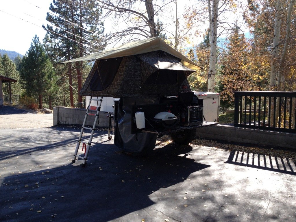

    Now can bbq and bake cookies at the same time :D
    5FDCE74A-260A-4110-99E1-6480B610D117-510_4223dc64ada7d5e0f7844967a88e8cccc951ea39.jpg

    I would imagine you have a spot picked out for wheel chalks? Or are you just going with the old faithful, abundant rocks?
    That last pic of it fully set up with out the truck hooked up put visions of the wife and kids rolling down the trail while your out wheeling.:eek:

    Oversized wheel chocks are in the tongue box.
    Also the caster i put on the tongue jack has is lockable

    That's cool. Until you fill the wheel well with mud getting to your campsite and want to cook dinner. :) Why not have the fitting just above the wheelwell and enter the tub in the same way but keep it out of mud/water etc.?

    I'm too anal retentive and it just stuck out like a sore thumb.
    Also why i got the cover. Believe me...I "mock" screwed it in a hundred times on placement. There's a lot of clearance between the tire and the fender .
    Besides...if it really is that bad...not like I can't just hose it off with the shower first :p
