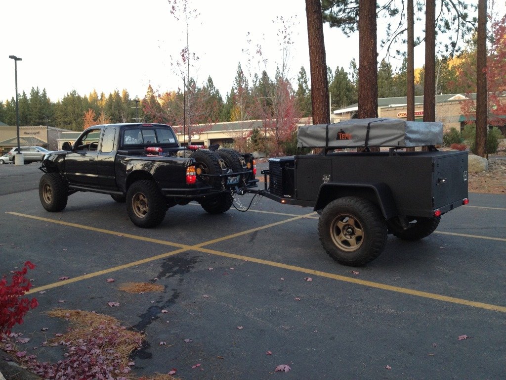

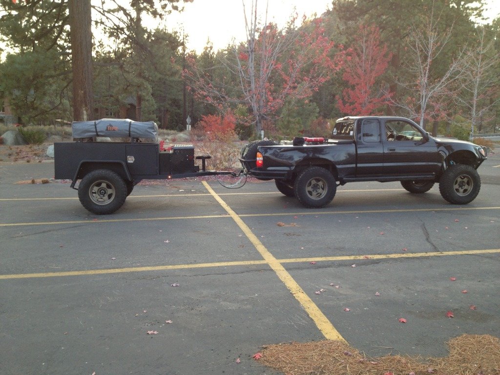

    Tire pressure was at 18 psi all the way around, trailer included.
    I have safety chains, as they are an on-road requirement and part of the DMV inspection. I removed them for the shakedown session and put them back on when I hit pavement. The purpose was to beat the piss our of it and to be able to listen for clicks, pops, clangs, bangs and what not. Chains would have just made too much noise...and got in the way of the go-pro. I kept the brake wire hooked up so if I by chance I decoupled, it pulls the pin and automatically locks the brakes up on the trailer.
    You can see the chains in this picture:
