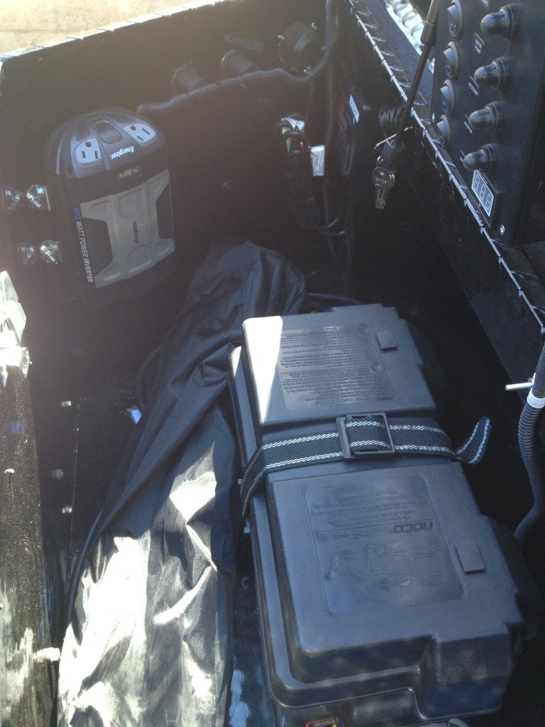

    So anyway, a few pics of a Treeline Teardrop Offroad build underway for another customer when i was in Petaluma...thought folks might be intrerested.
    Inside box, deep cycle and inverter

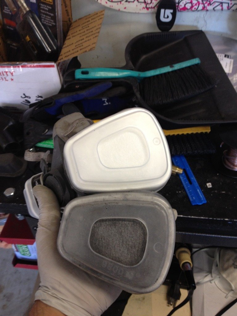

    Guess it was time to change the respirator filters after this project :eek:

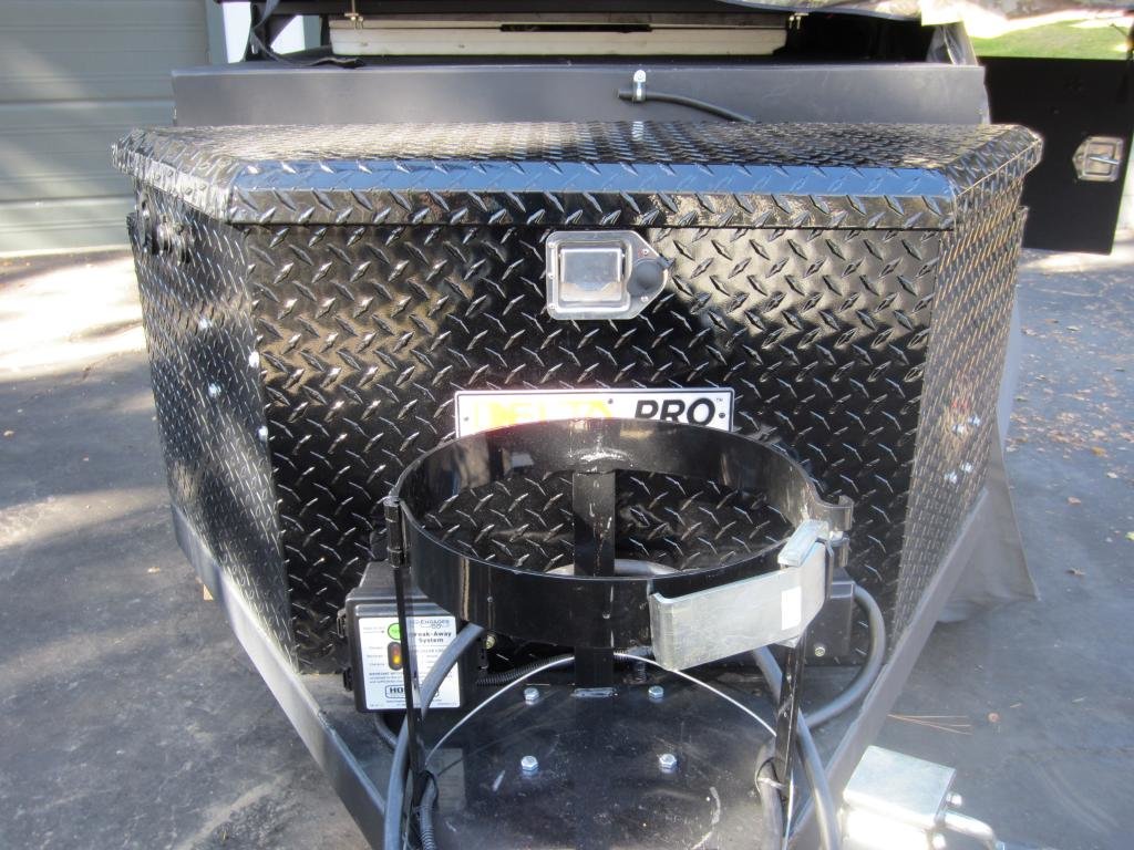

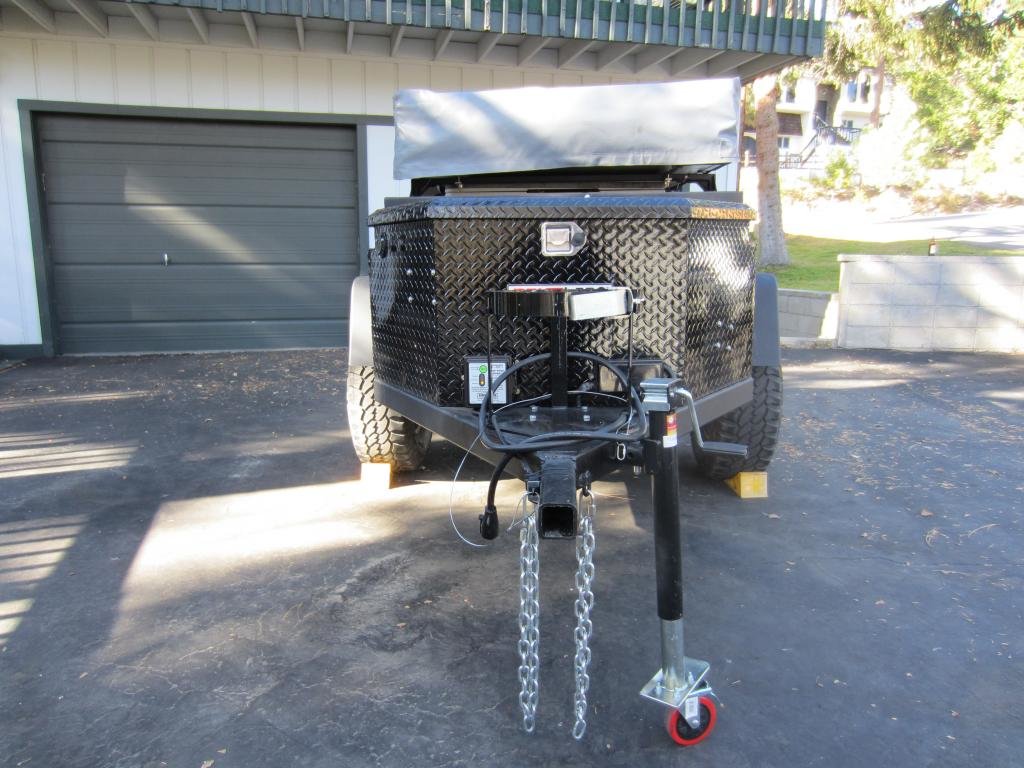

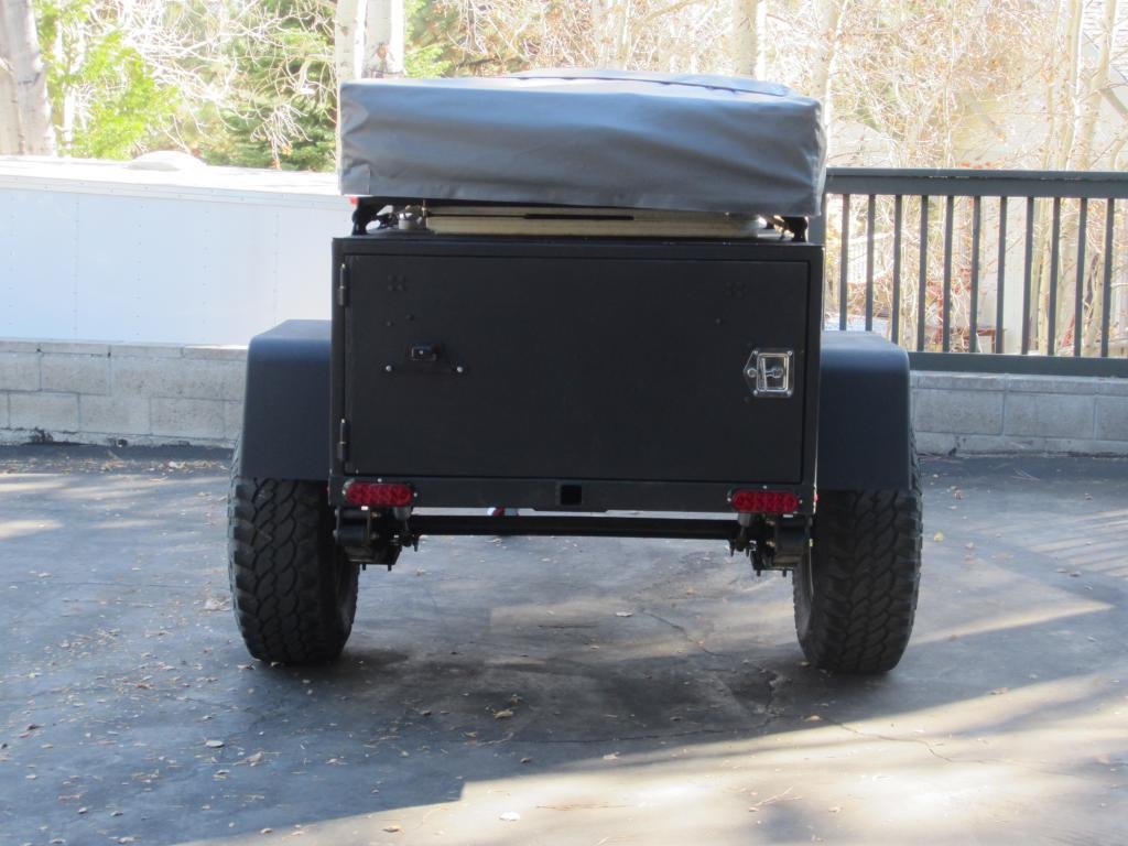

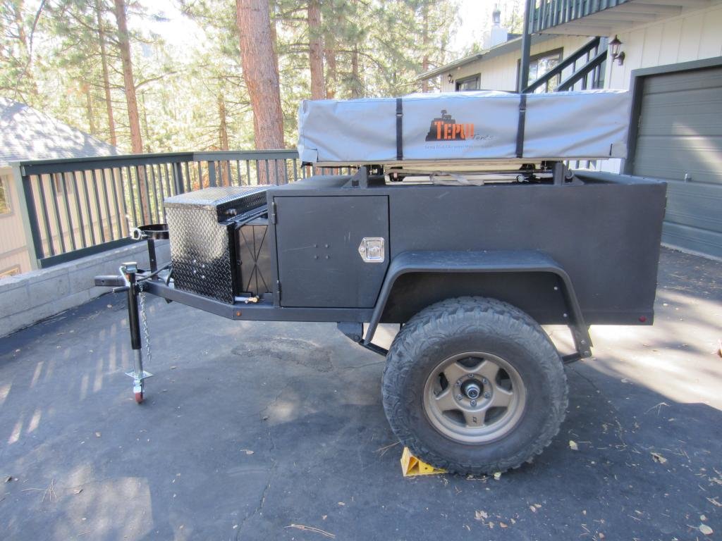

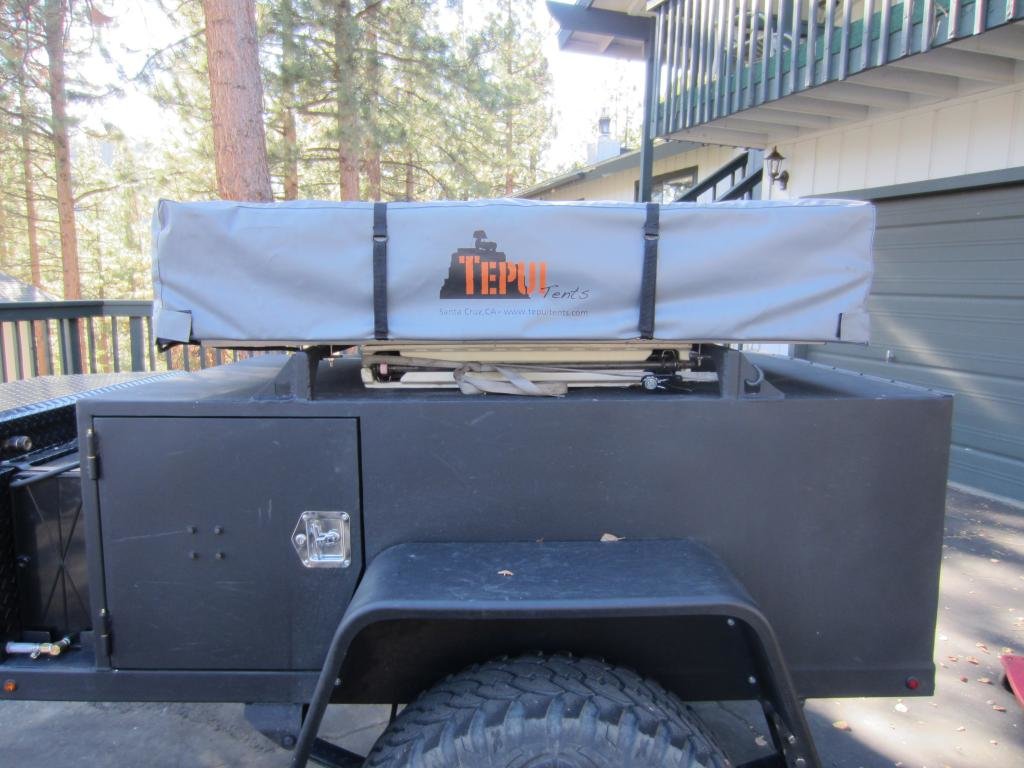

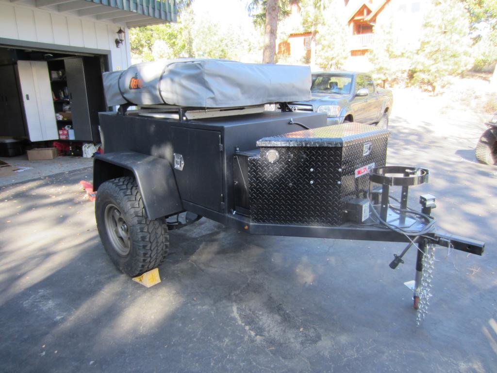

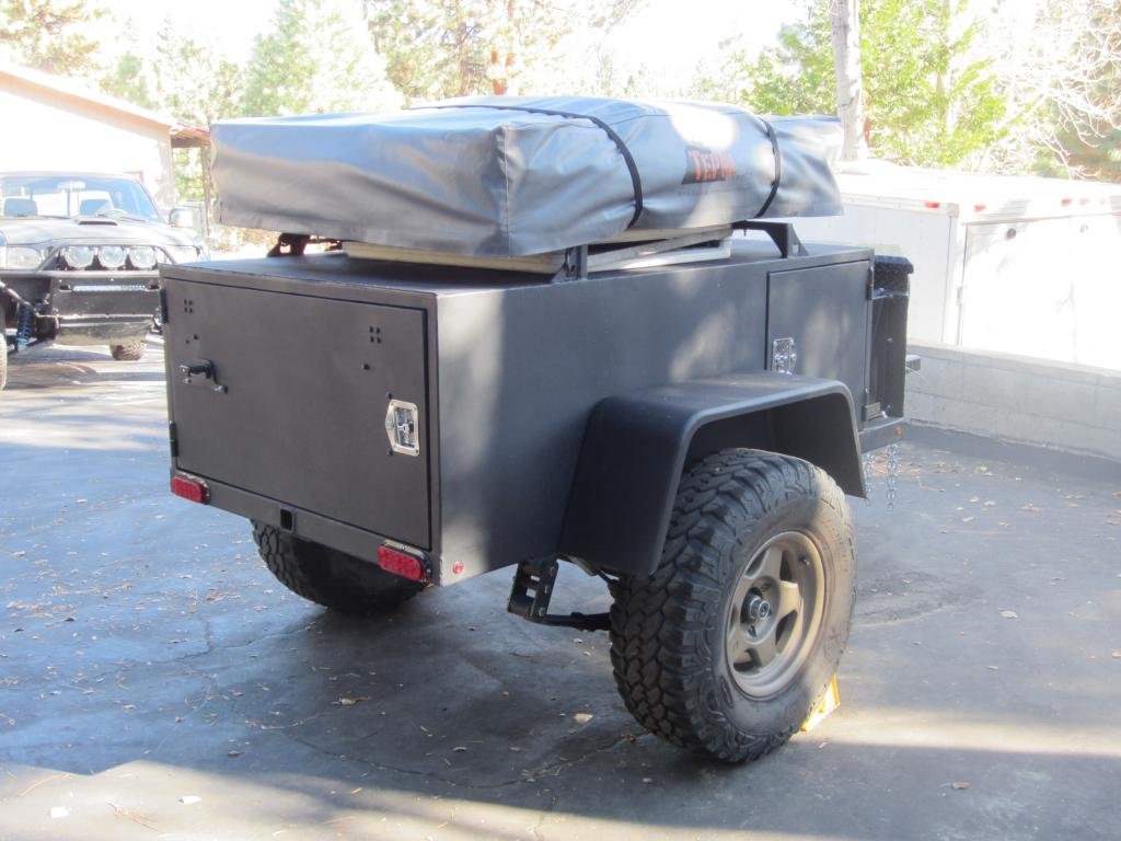

    Exterior Shots:
    79873DDC-72BE-43E7-B19B-1FEDC3015A9B-364_a9668f338ffbf0be46926811c43f9606c5703d5d.jpg
    061590D4-7B68-408D-B36E-02A387E42AC5-364_694bfd55cf251e0c9d6fcd2ed16feae4d0180e52.jpg

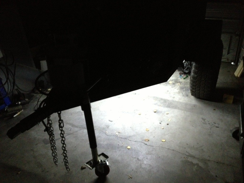

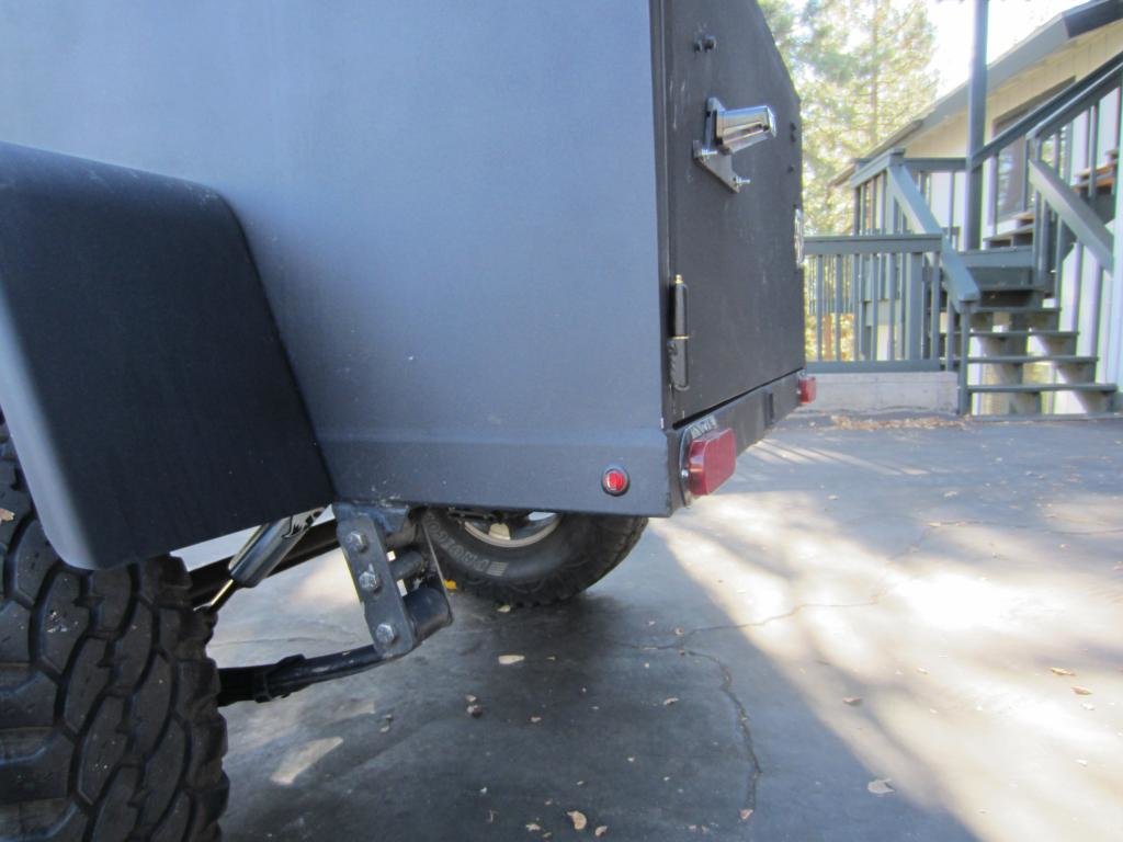

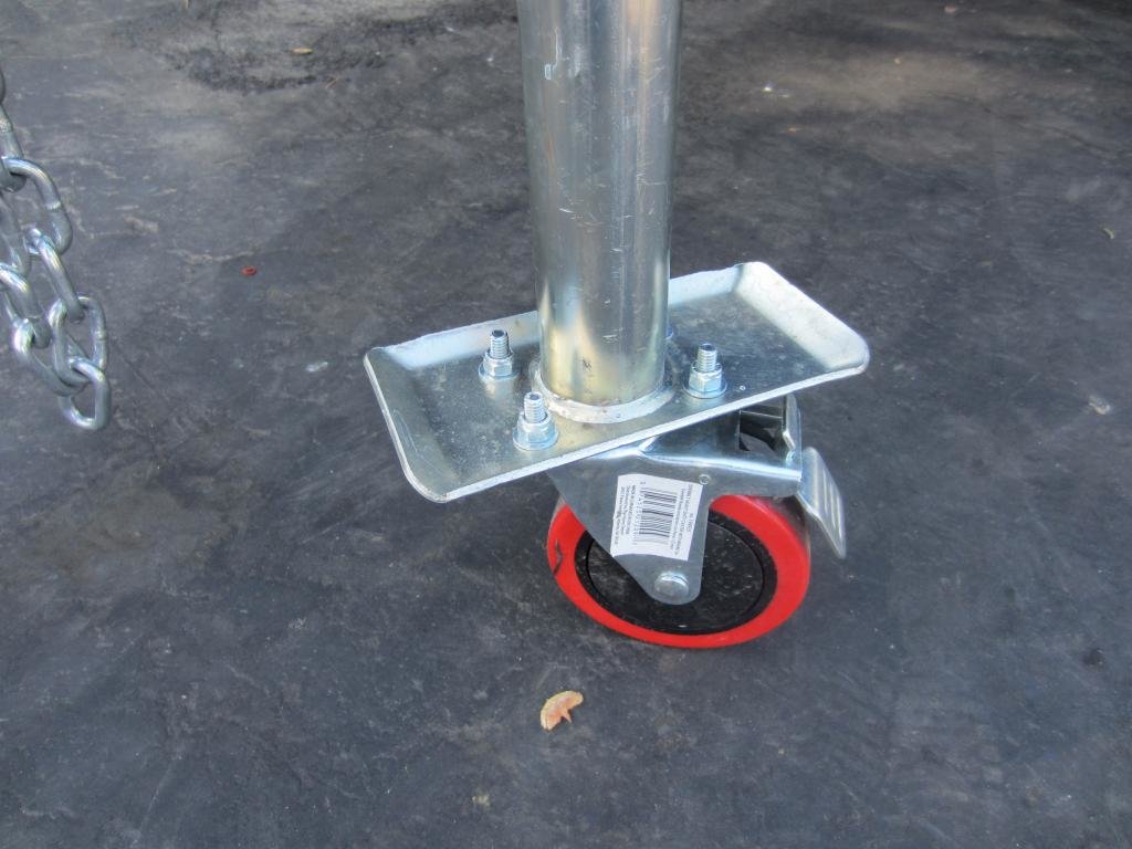

    Lockable Home Depot caster I added to the tongue jack:
    Safety Chains:

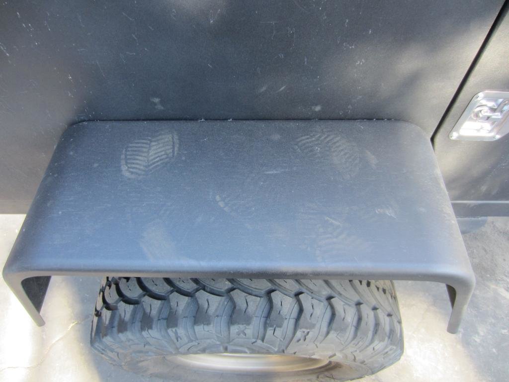

    Fenders are nice and stout...can be used as steps (as you can see)

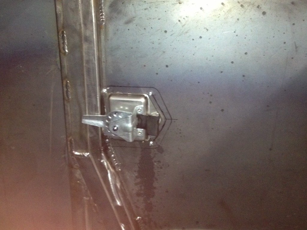

    Lockable T-handles on all doors:

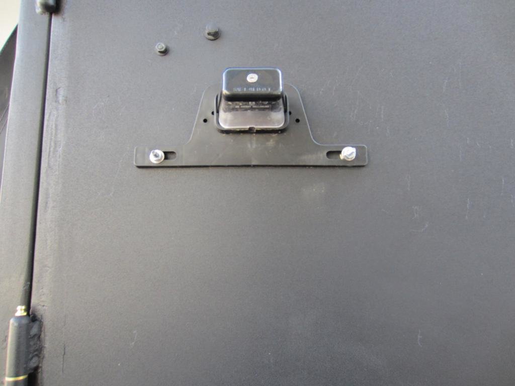

    LED license plate bracket:

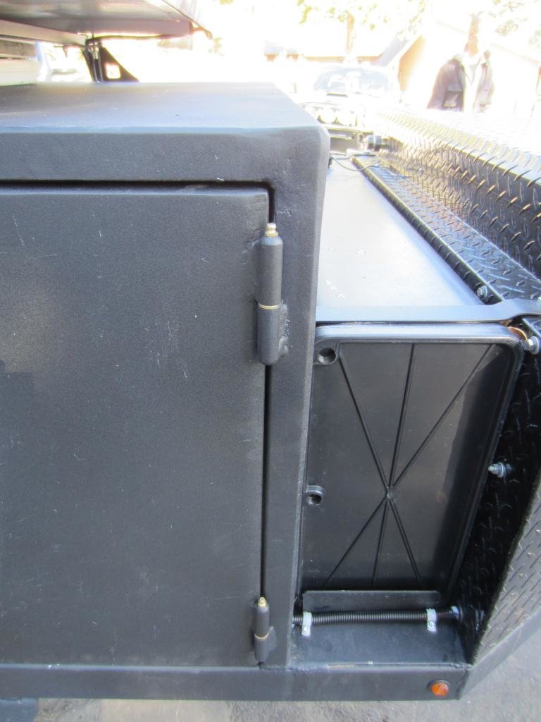

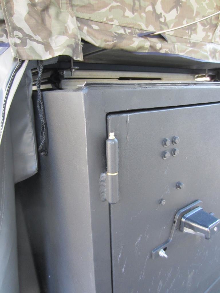

    Greasable hinges on all doors:

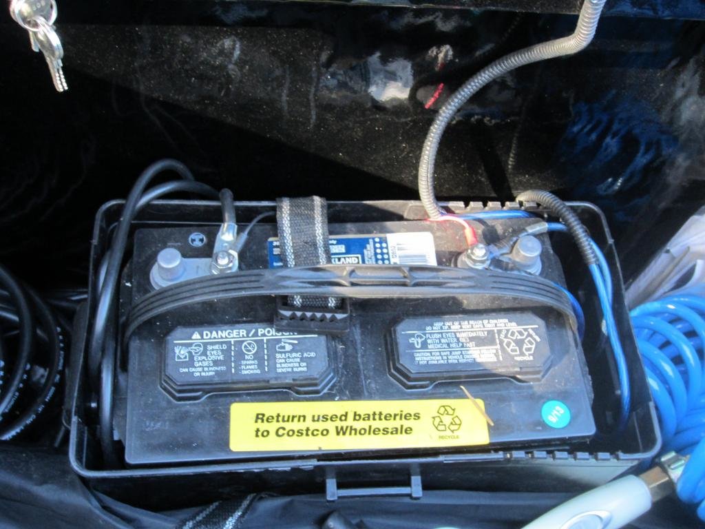

    Electric brake setup including 5 amp hour battery backup:

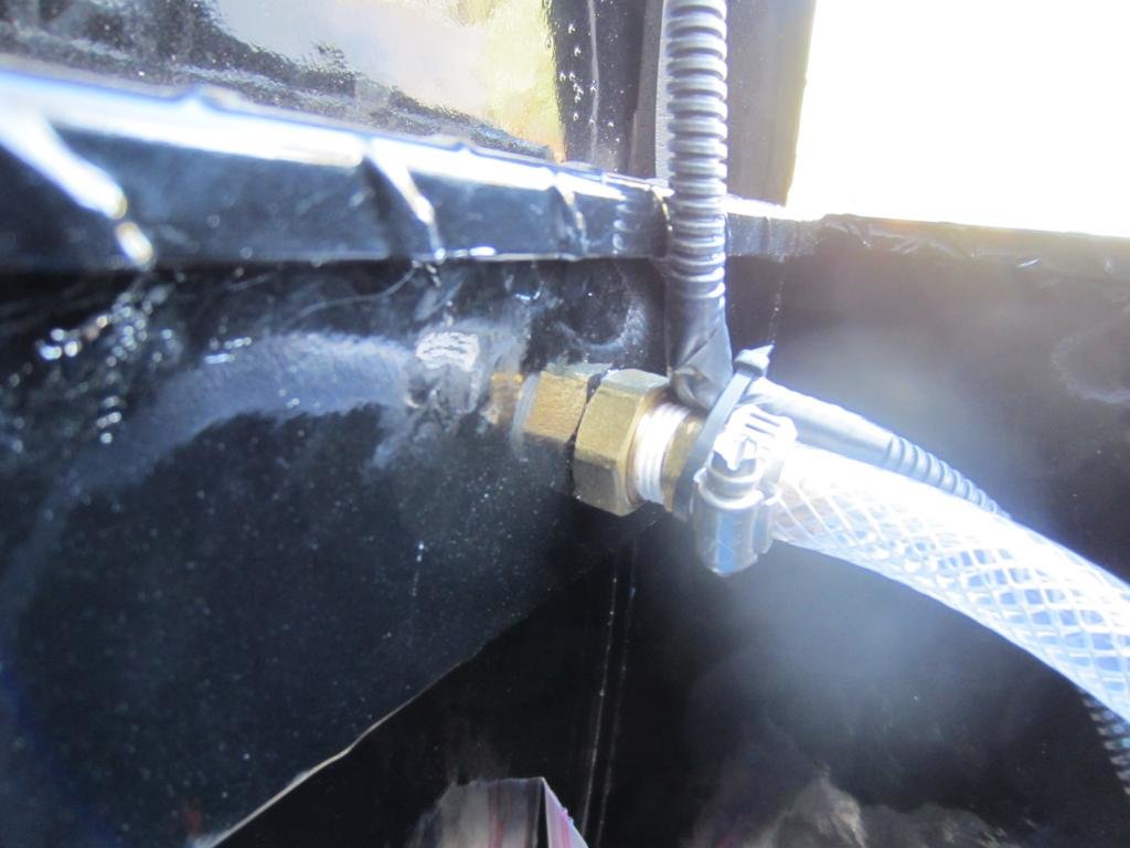

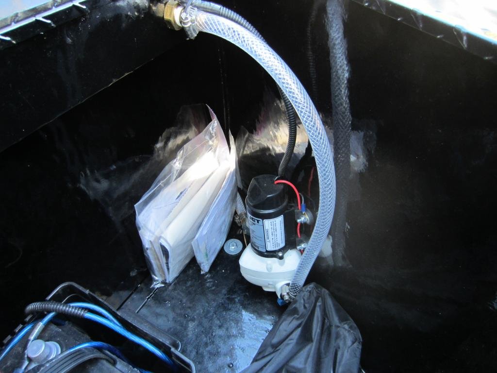

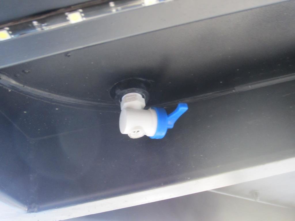

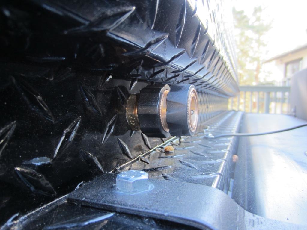

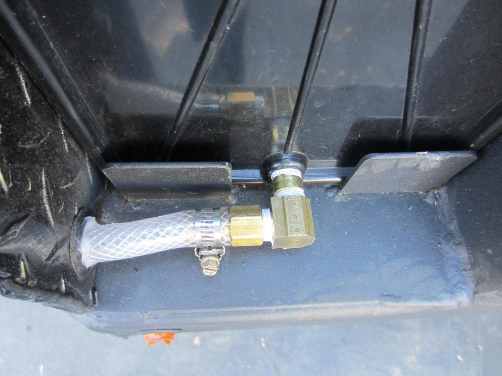

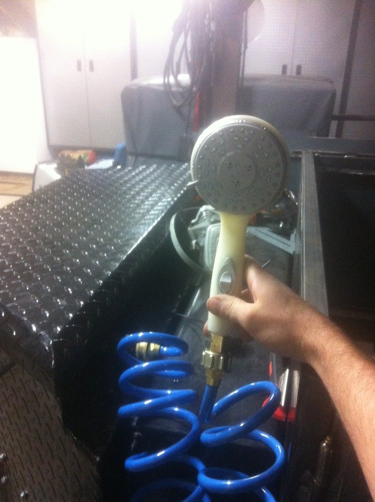

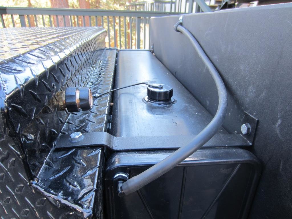

    Fresh Water Setup:
    Drain spiggot on water tank:

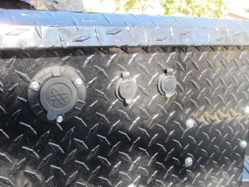

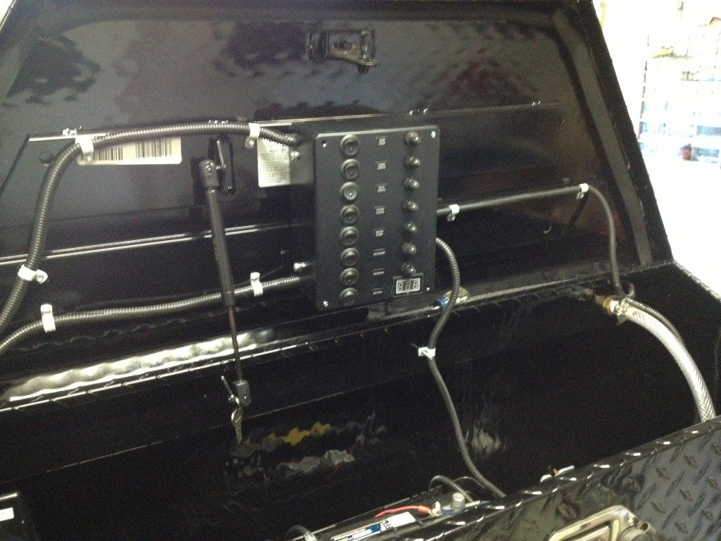

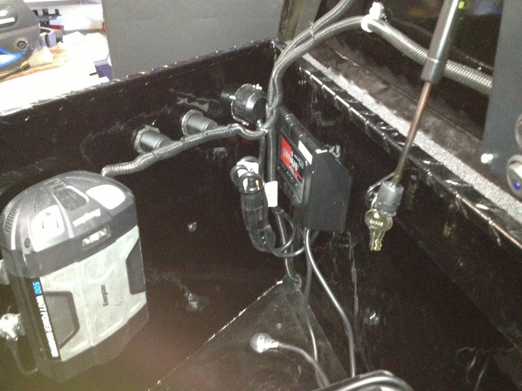

    Electrical:

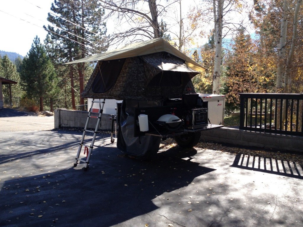

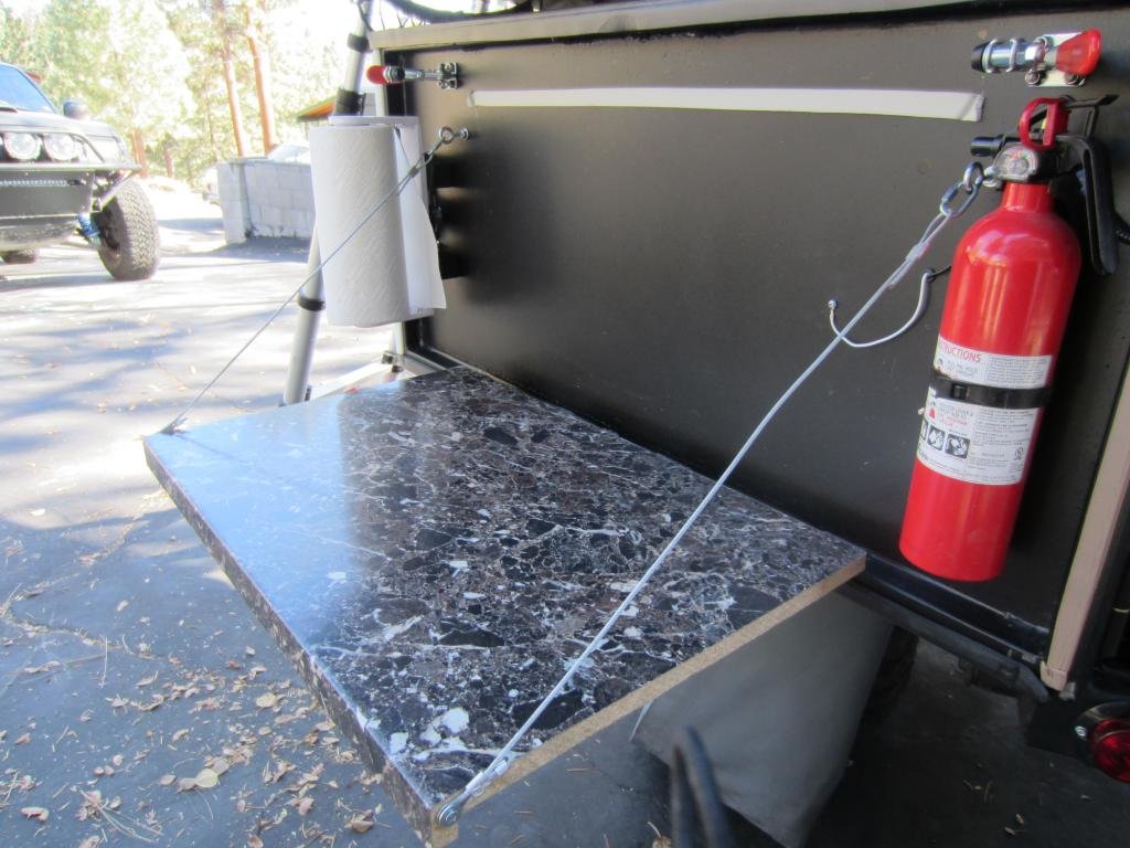

    LED lights inside tent with little e-bay switch:
    Folding camping table nestled between the roof and tent...like I planned it.
    Fold down tailgate table:

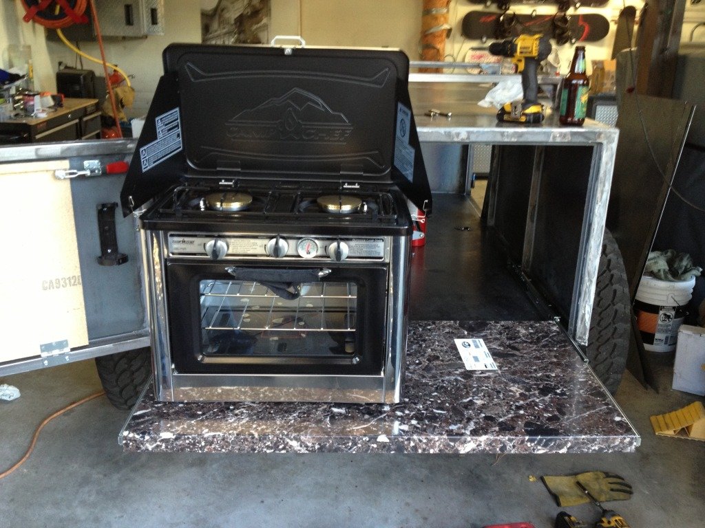

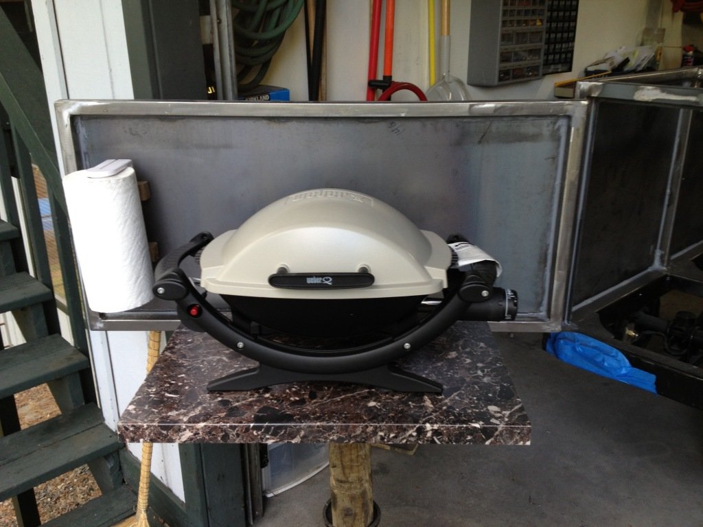

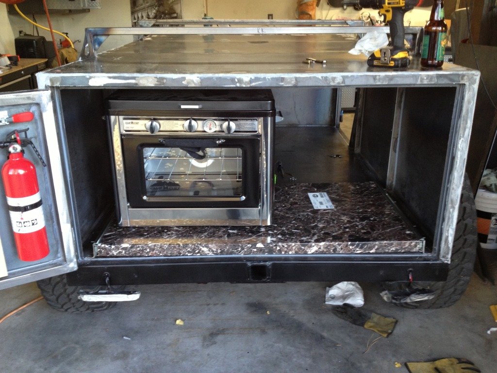

    Stove/Oven on slide-out:
    B0BE1224-A5A4-41B7-8234-A50CB47CFFB5-145_4b04d5da43a931587ecb74513dbd0d09f93c2a33.jpg
    F0BC4FE1-72A6-456E-ADFA-1FF7B6DC16DB-145_408b2341e86db96c686fbdadf0eeddc41da22713.jpg
    Pleanty of space:

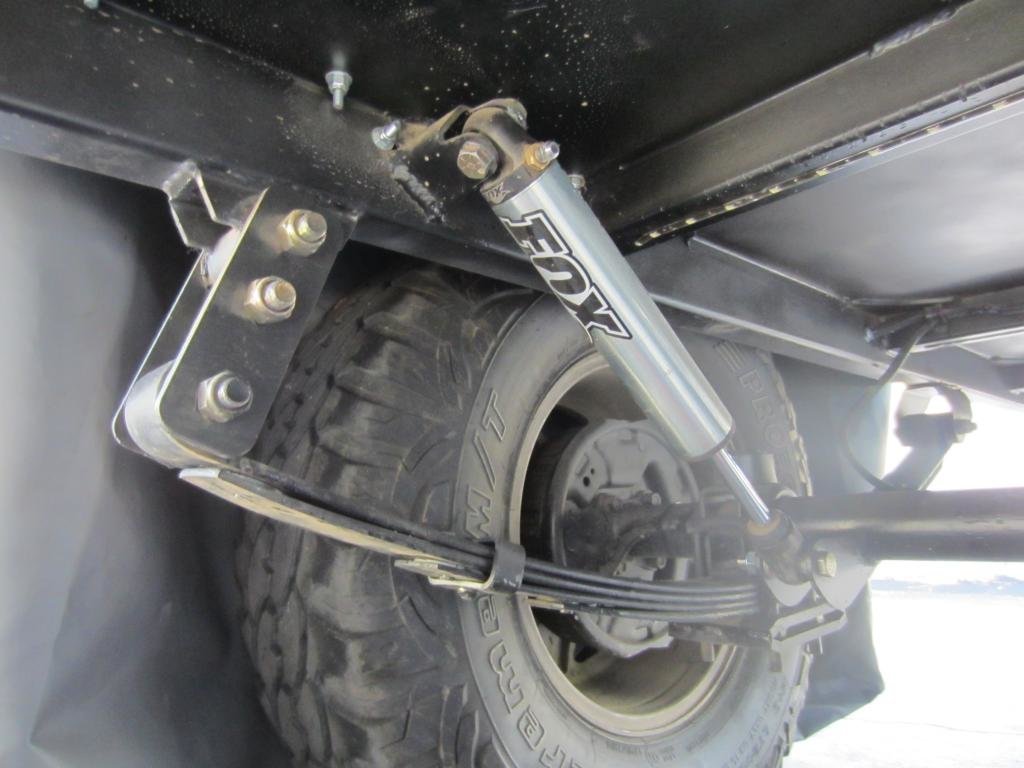

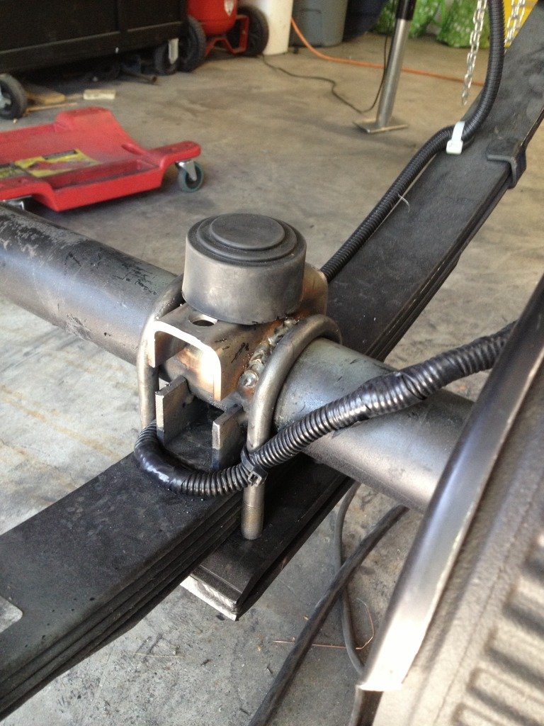

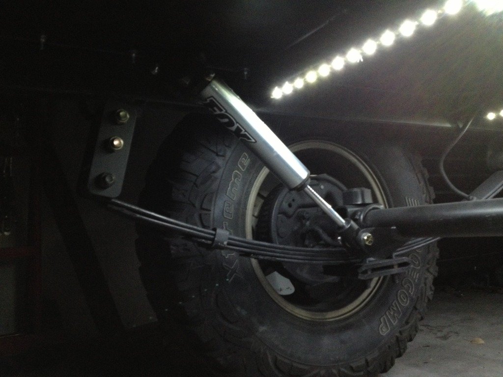

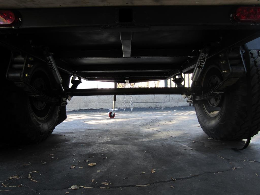

    Supsension:
    D6A9C221-FD17-4738-89CF-3A28B5E79780-427_819b5660472a36137c4e1415b72fc107405c85a1.jpg
    9D7E11FC-A457-487A-A520-4C7086CDEC6D-427_e69d5c76638fadd0bdb0c3425f7a321775f9ee0d.jpg

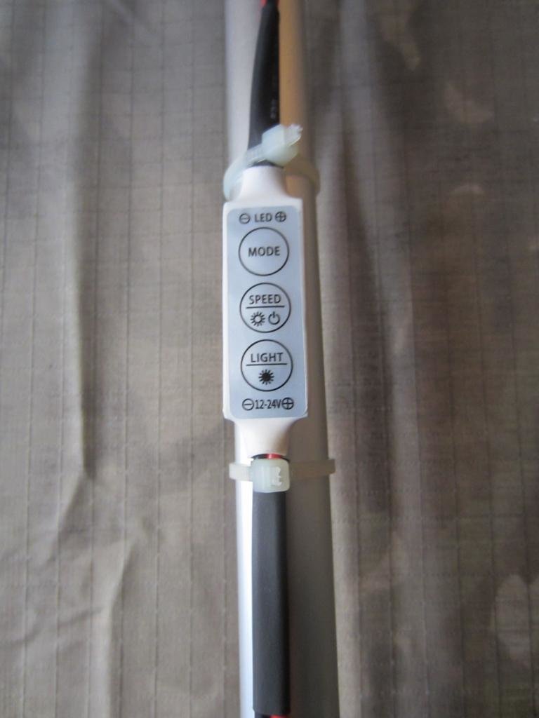

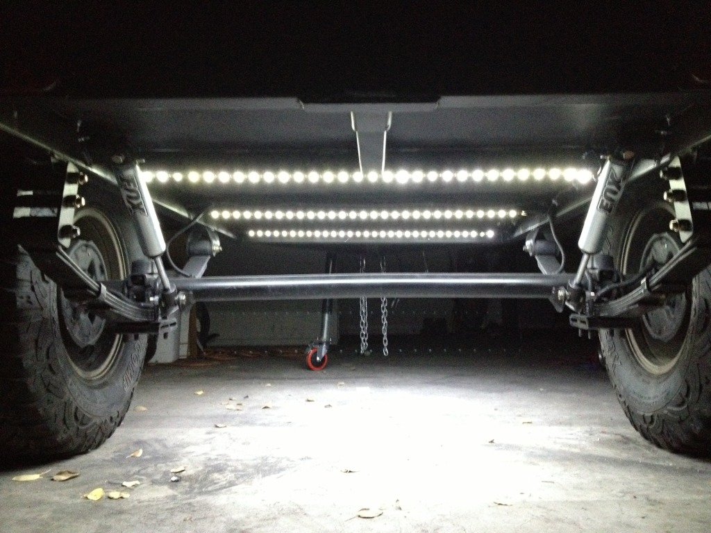

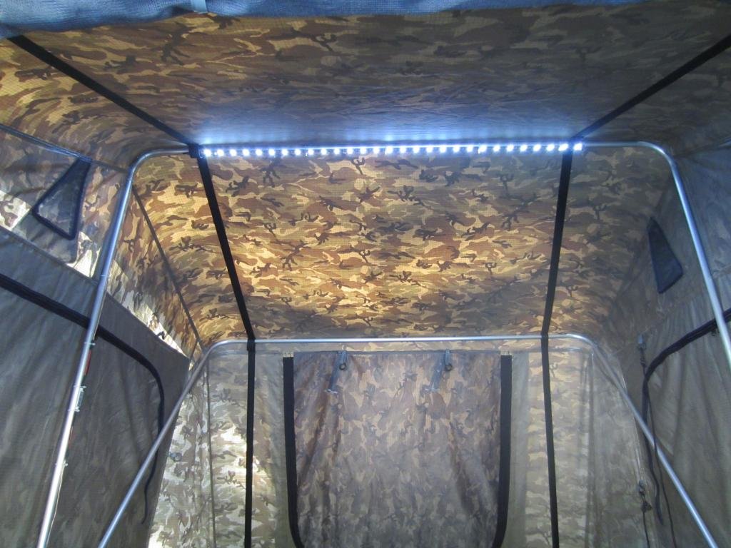

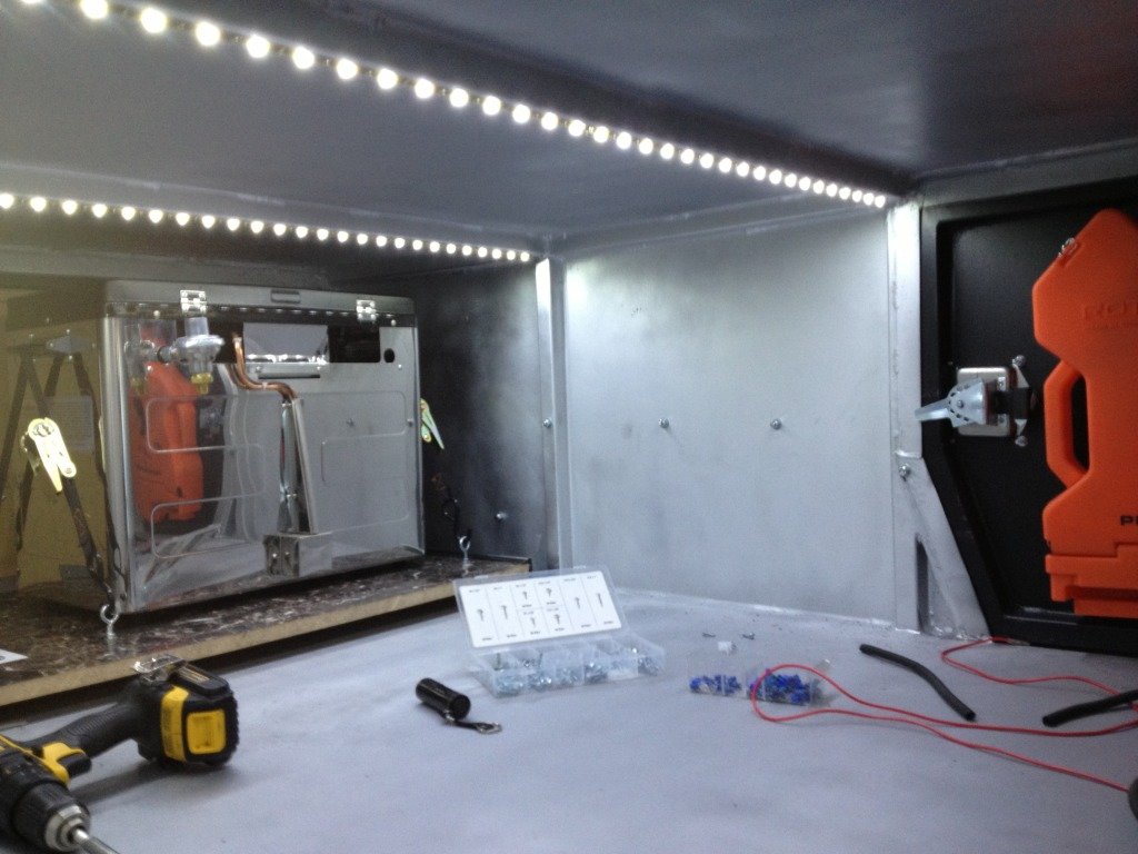

    How did you get the LEDs inside the tent?
  11. Oct 27, 2013 at 4:45 PM
    #451
    jberry813
    jberry813 [OP] Professional Fluffer Moderator
    Jan 21, 2011
    #49636
    28,484
    Jason
    Lake Tahoe
    2012 DCSB Sport
    ...too much shit to list.
    The LED's are the same LED strips I used for rock lights and interior lights. I just ran wires to the switch and then from the switch down the center pole. When you have the tent open, there is a velcroed gap right in the middle of the tent by the center pole that I slid the power/ground wires to a 2 pole quick disconnect (in case I remove the tent).
    Quick disconnect:
