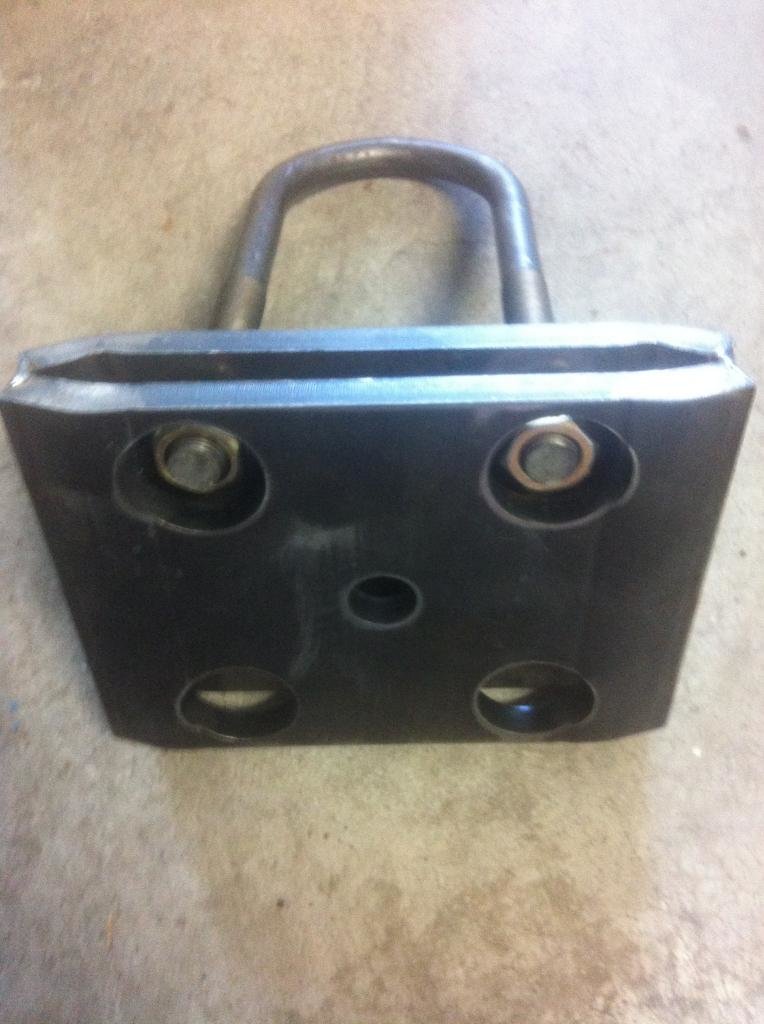

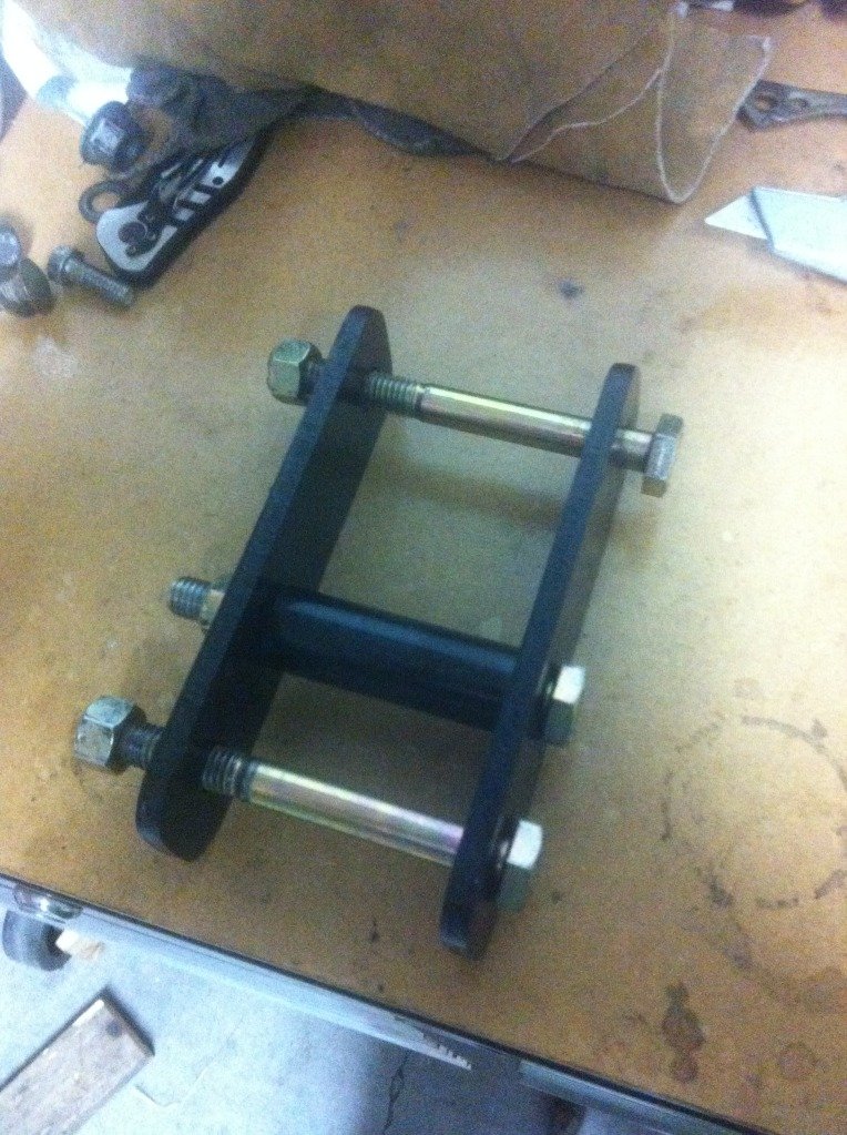

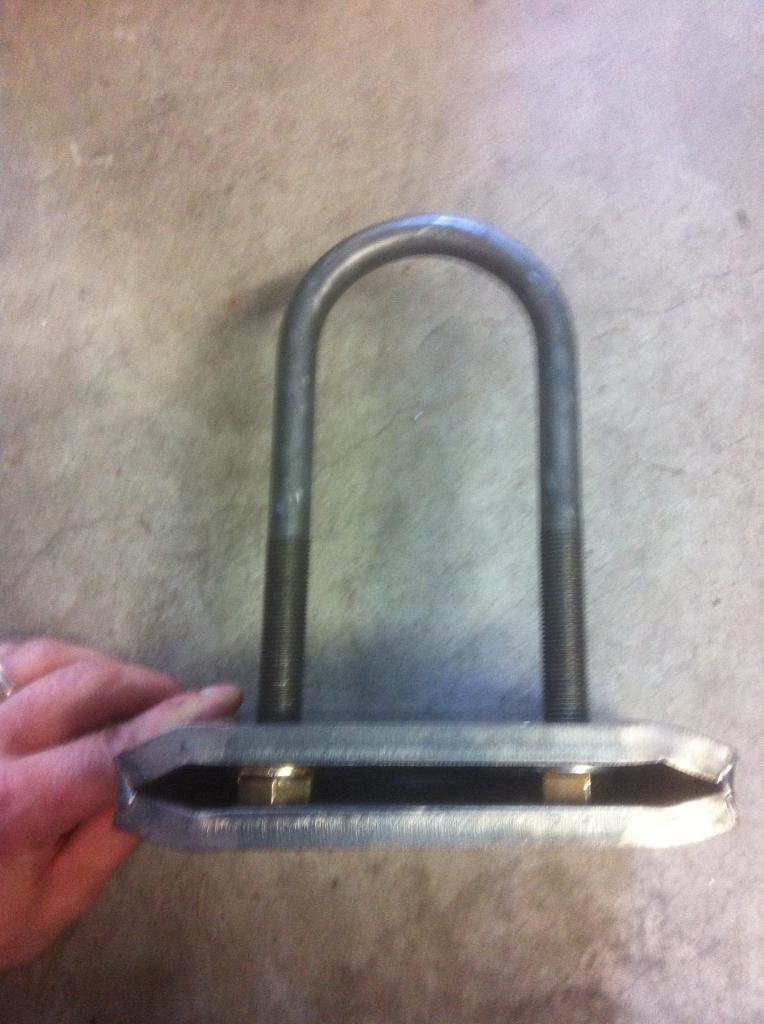

    Can you recall the source on your u-bolt plates? What might be the shortest length of shackles that I can get away with as I am not really concerned with a max travel trailer?

    Bash plates I got from Sierra 4x4 trailers. I got my fenders, bash plates, and tongue jack from them. They make off road trailers and lids for military trailers. They are headquartered in Gardnerville, which is 30 minutes from my house. Honestly, the owner is a really good guy, but terrible when it comes to business practices. I would not recommend buying anything off his website (if he is even still in business). You can do your own research on the company. If you show up on his doorstep and he has the products you want in stock, he is great to deal with. Otherwise, look elsewhere.
    As for shackles, it all depends on what spring pack you use. The shackles I designed were to accommodate the lateral length the pack required to fully cycle. You can do shorter or longer as long as you understand the ramifications.

    Thanks for the heads up on the spring plates. I should be using your spring package 42" e-e. I'll experiment with a shorter length at the start.

    4-4.5" shackle then. I started with 5", reduced to 4". 4" is a money maker with a standard size RTT. With the bigger tent I would go to 4.5" and not look back.
