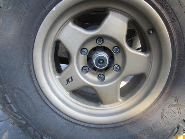

    @jberry813
    Jason could you go into a little detail on your ....hub,wheel lugs, Lugnuts, and hubcenbtric part of the build, thanks
  7. Aug 23, 2018 at 10:45 AM
    #727
    mach1man001
    mach1man001 eh whatever
    Nov 4, 2009
    #25415
    22,394
    Rob
    Bellingham, MA
    2024 Tundra Limited
    I love my new truck but miss my Tacoma
    I can tell you those are not hubcentric. The hubs in that picture are tiny as are most trailer hubs
  8. Aug 23, 2018 at 1:40 PM
    #728
    jberry813
    jberry813 [OP] Professional Fluffer Moderator
    Jan 21, 2011
    #49636
    28,484
    Jason
    Lake Tahoe
    2012 DCSB Sport
    ...too much shit to list.
    @mach1man001 nailed it. I built the axle with 6x5.5 hubs and drum brakes on a 3500 lb axle. It's trailer parts so it's all SAE lug studs with acorn style lug nuts. The trailer is sub 2000 pounds fully loaded, so I'm not worried about riding on just the lugs. I just had my tire shop balance the tires with the lug adapater rather than just the hub.

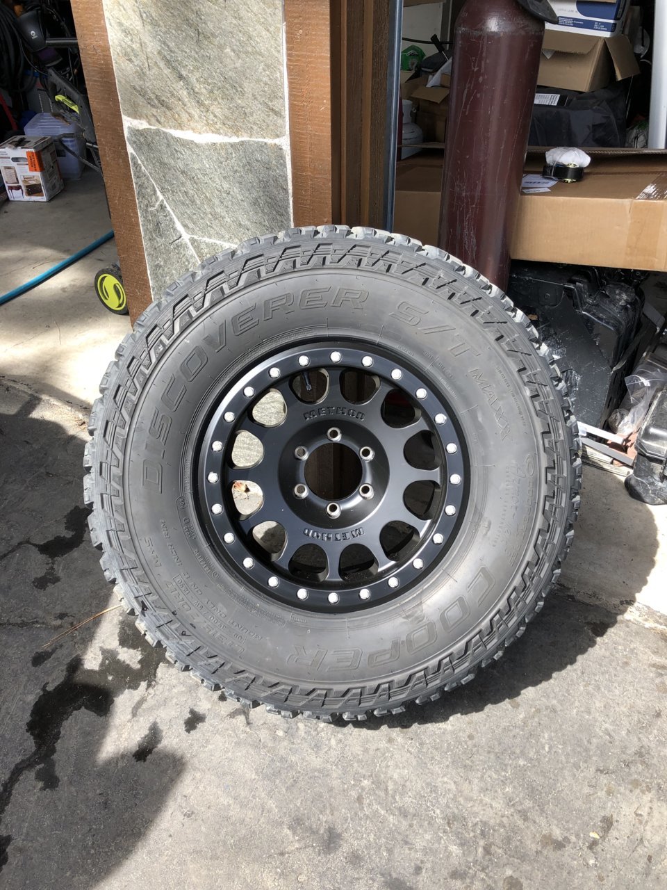

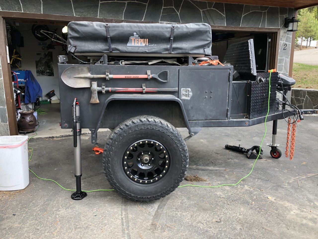

    Oh speaking of trailer. As soon as the snow melts enough that I can actually get to the trailer, the dingleberry is getting new shoes. Can’t keep dragging that thing around without bead locks and 35s. :anonymous:

    New shoes who dis?
    Ridgewalker1, ian408, POOLGUY and 3 others like this.
  17. May 2, 2019 at 11:06 AM
    #737
    TireFire
    TireFire Superunknown Member
    Feb 6, 2016
    #177349
    7,666
    Olympic Peninsula
    Damn! So much time, money and blood sweat tears in this trailer.
    Have you enjoyed it for more hours than you spent working on it?

    2012 DCSB Sport
    Oh hell yes. The Dingleberry has been rode hard and put away wet. Over 100 nights in the last 5 years.
    The tires were a gift from @kceastsparks after we recovered his truck on Christmas. And the wheels I picked up on eBay for dirt cheap and 5% off eBay day.
