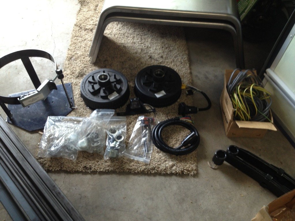

    Found a decent price on a 3500# axle yet? What did the 6 lug brake hubs run?

    I splurged a little on the brakes. I got Dexter brake hubs with EZ Lube caps. They were $65 each. Also got the Dexter Nev-R-Adjust brake assemblies that were $45 each.

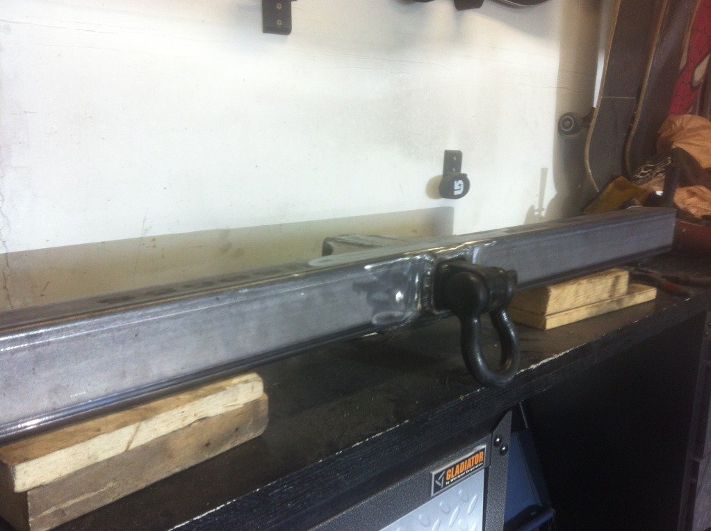

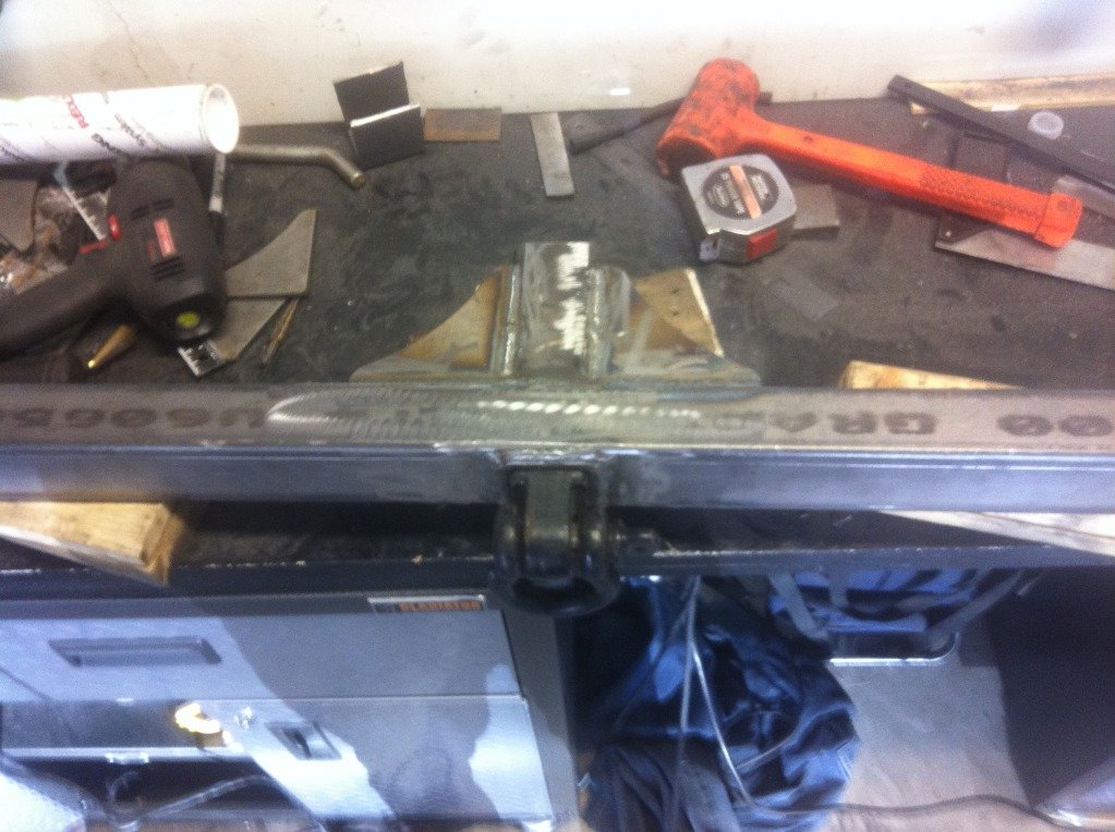

    Rear bumper is done.
    2x3x1/8" rectangle tube with a 2.5x2.5x.25" receiver tube welded into the frame.
    1/4" plate to gusset the bottom and 4" triangle gussets on top.
    Pin for the hole incognito behind the frame.

    Gnar! What are you gonna do about safety chains?

    By law I of course have to have them...on-road. That said my plan is to weld in a safety chain loop to the tongue and have the safety chains connect using a quick link so I can remove them easily and not have them rattling around while off-road.
