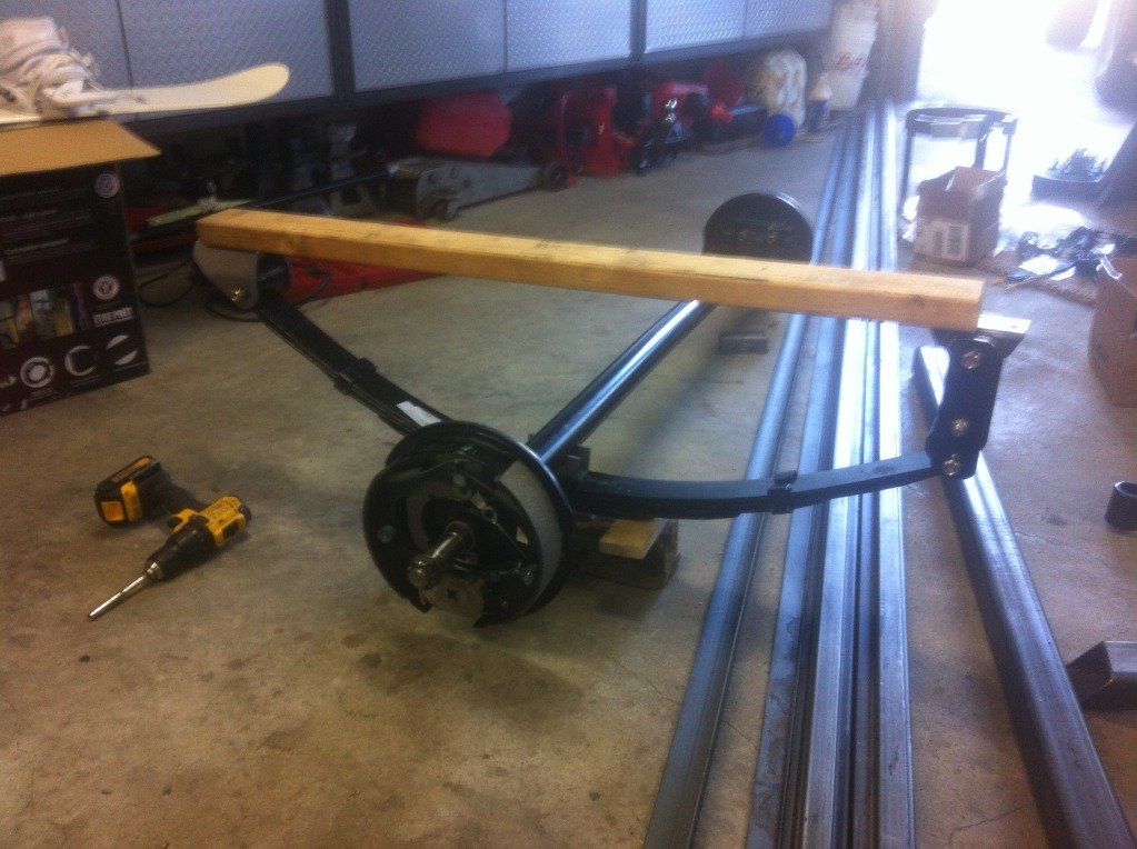

    Did a preliminary suspension cycle with my current planned leaf setup.
    With 33" tires:
    Frame height at full droop will be roughly 27".
    Frame height at full bump will be roughly 18.5".
    My math gets a little fuzzy here, but I calculated a frame height on a fully loaded trailer (obviously based on weight) should be around 21-22".
    For those two lazy to subtract that's 8.5" of travel (Was aiming for 9" but I'll take it).

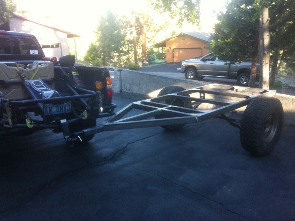

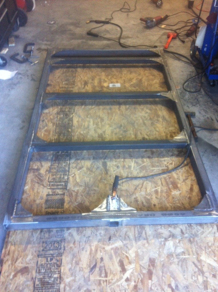

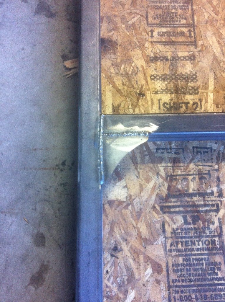

    Main part of the frame is done. I maaaaay have gone a little overkill with the gussets. :anonymous:

    Its not done yet? :p

    Structural integrity! If it ever rolls over you won't bend/break any of the framework :thumbsup:

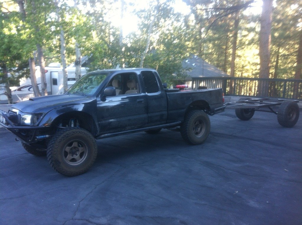

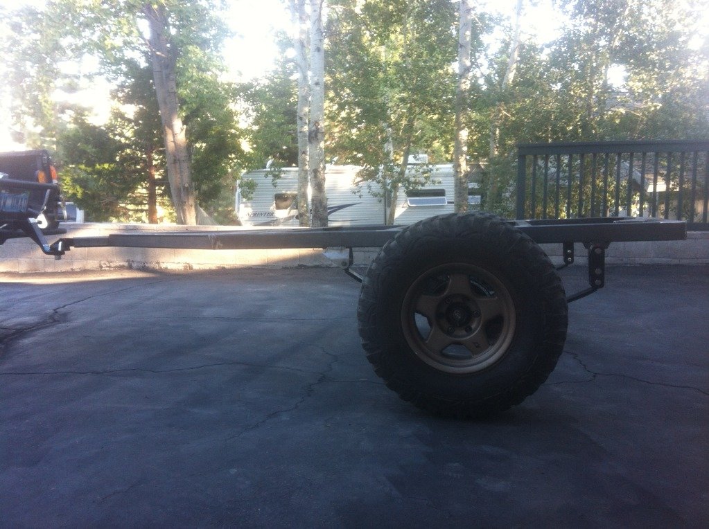

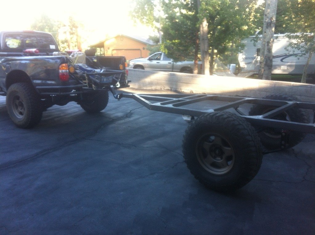

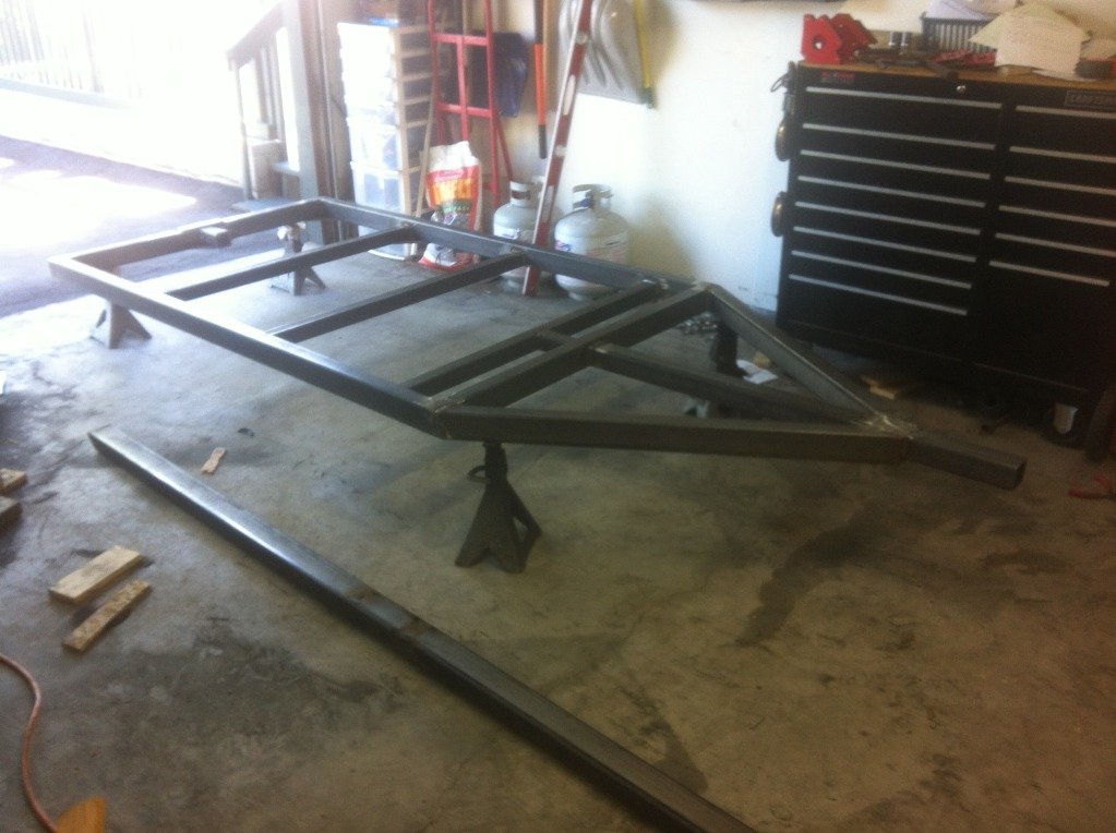

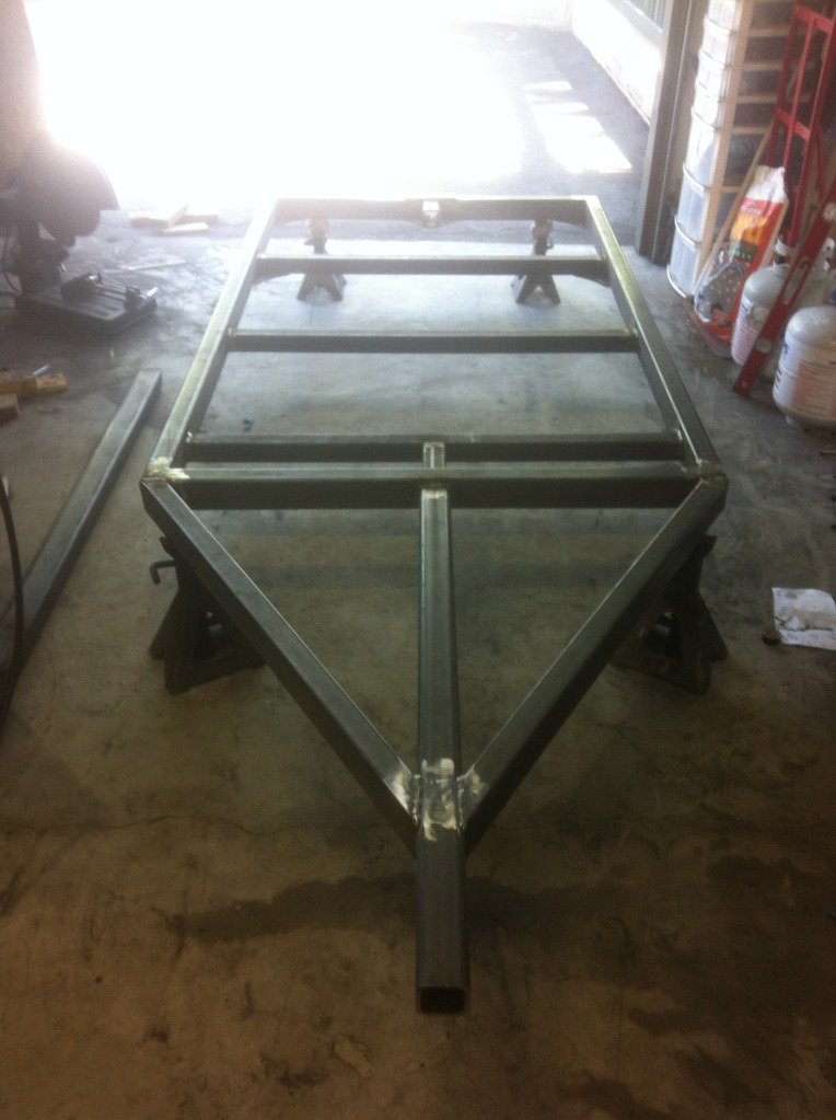

    Got the tongue done today.
    The frame came out way beefier than I had expected. I mean I knew the materials I was going to use and all...just never built a trailer before and didn't realize how gnar it was going to end up till it started taking shape. You could drive a 1 ton truck on this thing and it wouldn't flinch.
    I thought about stopping at that point...but what the hell. Still had daylight.
    I'm SO GLAD I worked out all the numbers for the suspension already. Having it all mapped out and written down made installing it a snap. I've officially got a roller.

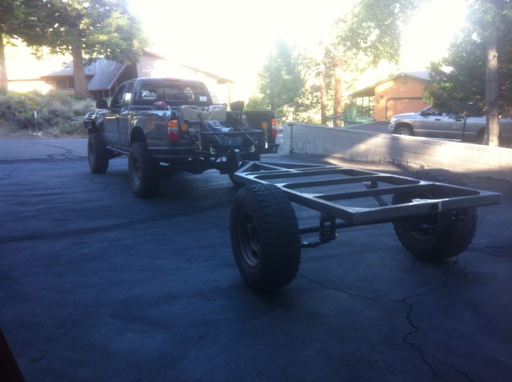

    Here you can see the leaf details. Damn near vertical shackles at the moment with zero weight. But they move really easy. Just bouncing on the frame with my skinny ass and they've got really good movement. I'll definitely have to do some kind of shock setup as they rebound too fast.
    So final details on the suspension are
    Pro Comp 4" lift springs for the front of a Jeep YJ
    WFO Concepts Leaf Spring Hangers (designed to fit a 2" frame and taper out to a 2.5" spring)
    WFO Concepts Shackle Hanger (again, designed for a 2" frame)
    Homemade 5" shackles
    Energy Suspension spring & shackle bushing set (actually designed for a old K5 blazer but the dimensions were exactly what I needed).

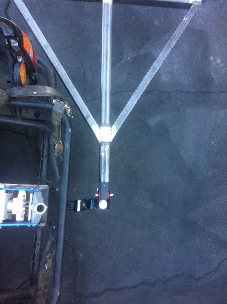

    Andy lastly checking tongue length, max hitch angle, and hitch drop length.
    I'm over 90* with the current trailer length of 126" and so far very pleased. My tow receiver hitch is snuggled in between the tubes on my bumper and quite high. It's looking like a 7.25" drop is what I'll end up using.
