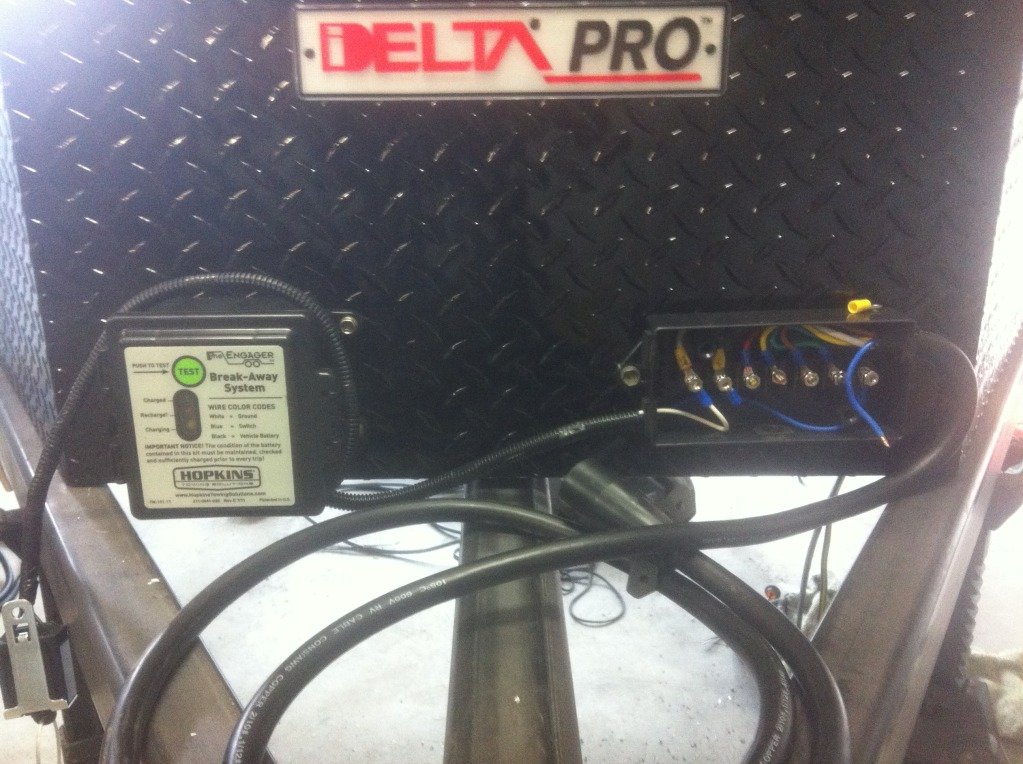

    Only got some remedial shit done. Trailer lights, 7 pin, junction box, and breakaway are wired up.

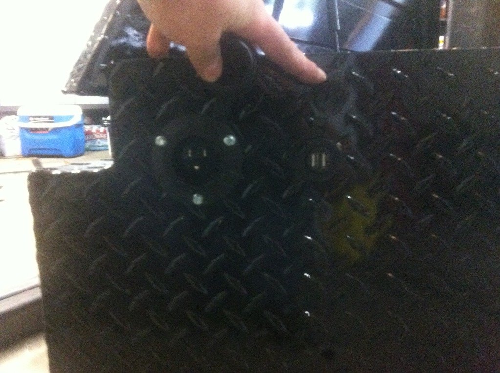

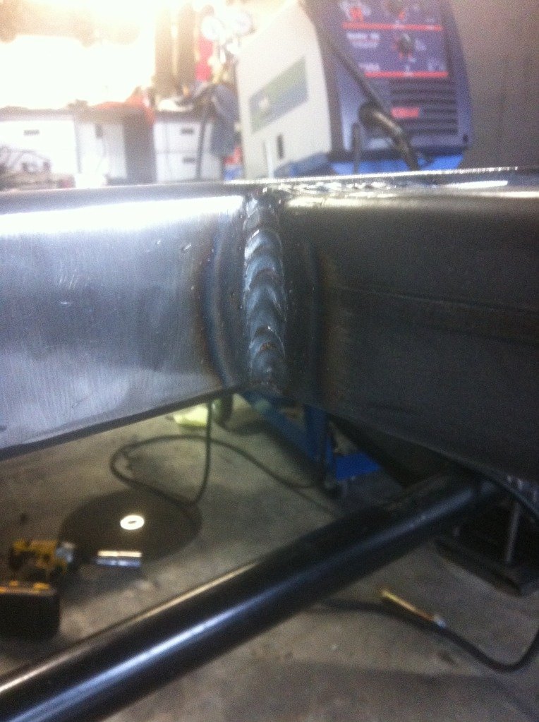

    I had some leftover 2" stock left so I half way took Colin's suggestion. I sleeved the rear hitch a little bit and ran it to the first crossmember. The hitch is probably stronger than the hitch on my damn truck now. Recover whatever the hell I want now.

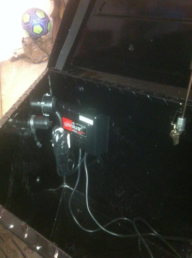

    Also mounted a NOCO 2 bank marine battery charger inside the toolbox. It's completely waterproof and can charge two batteries independently of each other, each at 10 amps. I didn't plan on getting the 2 bank, but for whatever reason it was cheaper than the single and gives me a little more flexibility with my plans for batteries. I think Amazon effed up because right after I ordered it the price doubled.

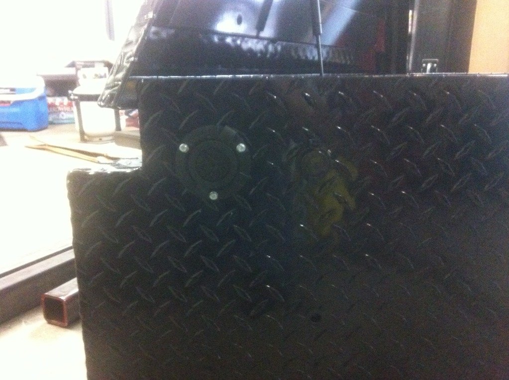

    I paired the charger with a NOCO shore plug that I mounted to the outside of the toolbox so I don't even need to unlock/open the toolbox to charge the batteries at home (or anywhere with 120v).
    Also mounted beside the shore plug is a USB charging port. I've got a similar standard 12v socket on order that I'll be mounting next to that as well.

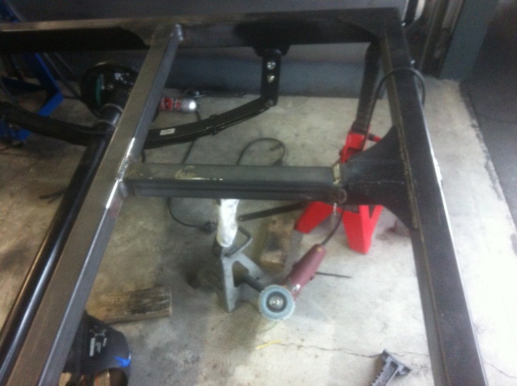

    Ahh yeah that too. You can see it hanging out in the first picture.
    I got the bearings packed, backing plates and drums all assembled, spring perches welded, and plumbed the wires for the electric brakes.
