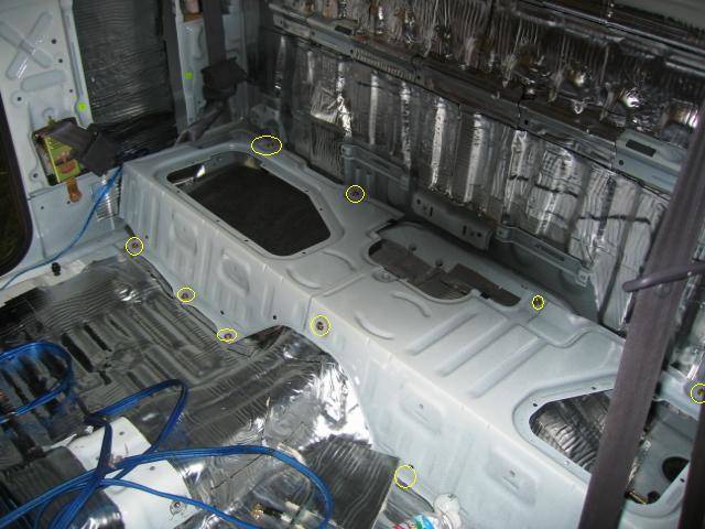

    I'm no stranger to cubby hole subwoofers :D
    I did a similar setup in my Tundra but in that I went all out and fiberglassed the enclosure and it's air tight and hits HARD (since I replaced the subs with some JL audios).
    I was going to do the same thing for the Tacoma, but fiberglass is so much work. It was like 3 days of work to do the fiberglass box in my Tundra and I really wasn't that motivated to do all that all over again. So for the Tacoma though, quite honestly, I didn't come up with the idea myself. I never bothered doing a writeup cause I found everything I needed from other people's posts.
    Check out this thread on Custom Tacos:
    http://www.customtacos.com/forum/showthread.php?t=95004
    There's like 100 different kind of sub setups all for 1st gens. Some are kind of...extreme, but i just stole all my ideas from that thread.

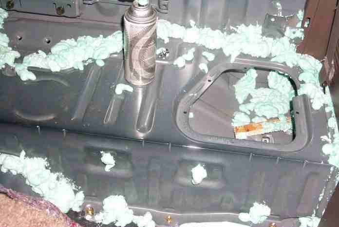

    Below are a few pictures stolen from CT that help illustrate what I did. Sorry, but pulling all my subs out now to take pix would be too much of a PITA.
    There are 12 bolts that hold the metal bracing for the cubby holes to the interior body. Unbolt those 12 bolts and the whole thing comes out in 2 parts. I just layered the bottom side of the bracing, and the entire back side of the cab with dynamat material and then bolted it all back together again. I also cut out the bracing that held the jack and tire changing tools. Never gonna need them again anyway.
    Then filled in all the cracks and crevices with foam similar to this (again stolen pic):
    Wear gloves if you use this foam crap. I didn't and it took over a week to get this shit off my hands.
    I then just cut a couple of pieces of 1/2 MDF out to replace the cubby hole covers. Used the old cubby hole covers as stencils. Carpet it up and screw it all together with some sheetmetal screws and call it done. Oh yeah, I had to pull a couple of the plastic covers off that hide the hinges of the seat so the seat wouldn't bind when they came down.
    The amp hides nicely under the driver's seat and wires ran under the carpet.
    All completely reversable too should I ever decide to get rid of them.

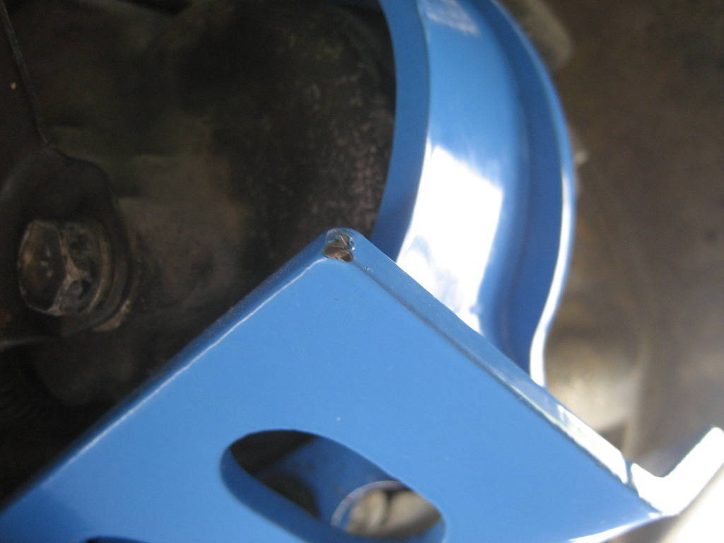

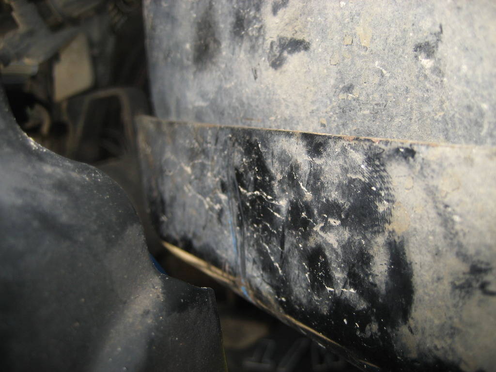

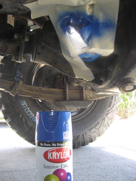

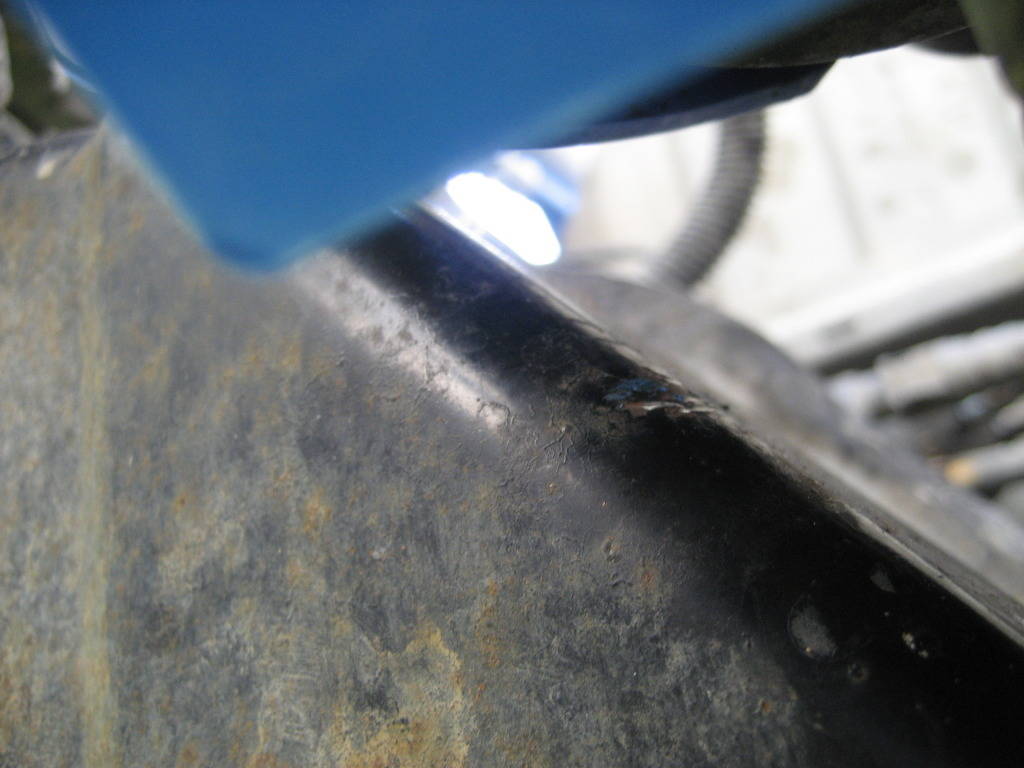

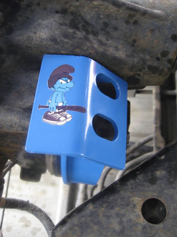

    As I mentioned in my original post, I installed the Inchworm E-Locker Guard. This thing is pretty cool and very well built, but on an all black truck, it stands out like a sore thumb. At a quick glance it looks like I splattered a smurf on my way to work. My front and rear shocks both have some blue in it, but I've really been on the fence about rattle canning it black or not. In the meantime, I photoshopped up a sticker for shits and giggles. Nobody will probably ever notice unless I point it out, but it cost me 5 bux for two stickers so why not. :D
    While crawling underneith the truck, I noticed the corner of the locker guard was actually scraping the gas tank skid plate.
    I read this was a semi-common problem with pretty much every locker guard and having the LT rear suspension probably doesn't help. Not to worry! Nothing 2 minutes with a griding wheel didn't fix. I just notched off the corner and problem solved. To my suprise, krylon has smurf blue in their linup. :rolleyes: It's not a perfect match, but it's close enough!

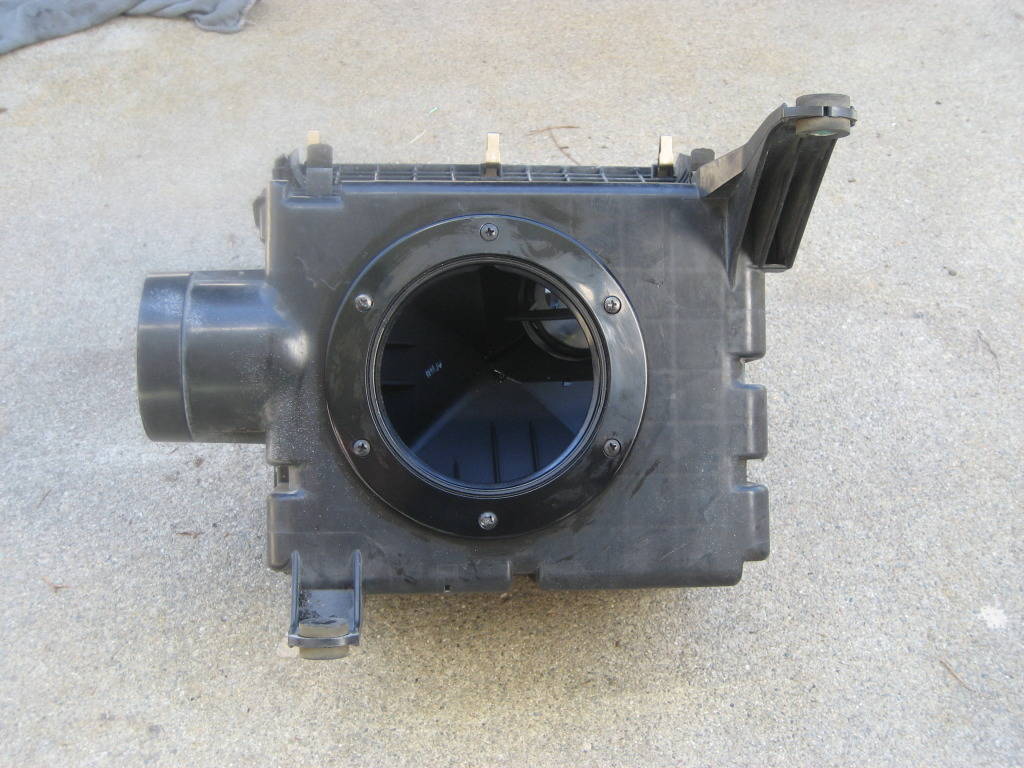

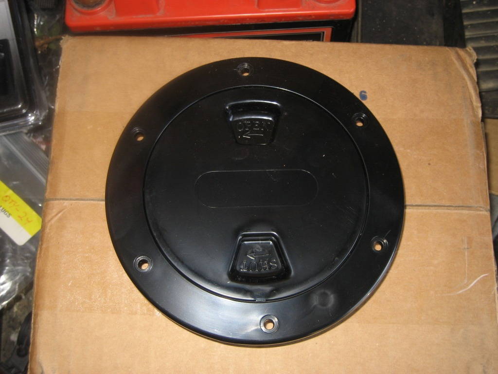

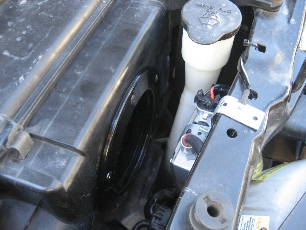

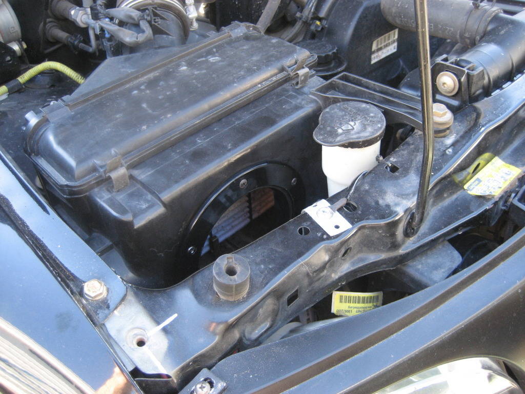

    Deck Plate Mod
    No reinventing the wheel here. I found out about this mod on both TW and CT forums and have yet to read anything bad about it. I purchased a Beckson 4" screw out deck plate from ebay for $15 shipped.
    For those of you not familiar with the deck plate mod, I encourage you to read this how to: http://www.customtacos.com/tech/index.php?article=85
    For the most part I followed these instructions. I found it easier to cut out the hole with my jigsaw as opposed to a dremmel. Doesn't really matter as long as the hole is big enough to fit :rolleyes:
    Now some before and after photos:

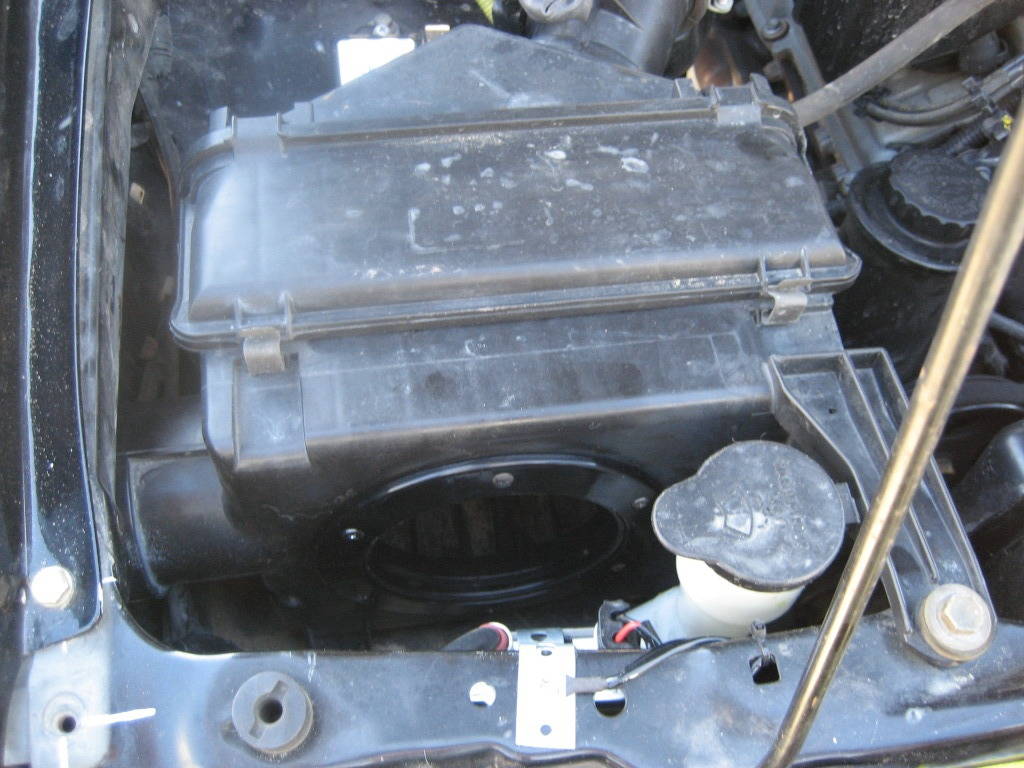

    I wanted to install the module behind the map lights. To gain access to this area, just pop off the covers to the map lights. There are 4 screws that hold the mirror and lights to the ceiling of the cab. I also pulled the two sun visor clips off.
    I just following the aforementioned articles and cut a hole in the headliner. Wiring was simple. Just tapped the power off the map lights and grounded using one of the screws that hold the mirror up. The results are fanfuckingtastic. It came out way better than I expected and, dare I say, it almost looks factory.
    After putting it all back together I noticed there was still a little bit too much wiggle room between the back of the module and the roof of the cab. I folded up a piece of cardboard and wedged it in between the two and now it works flawlessly.

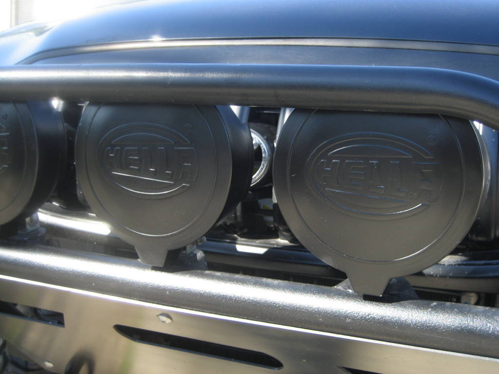

    Hella Covers Get A Makeover
    Yeah, you guessed it...black :spy:
