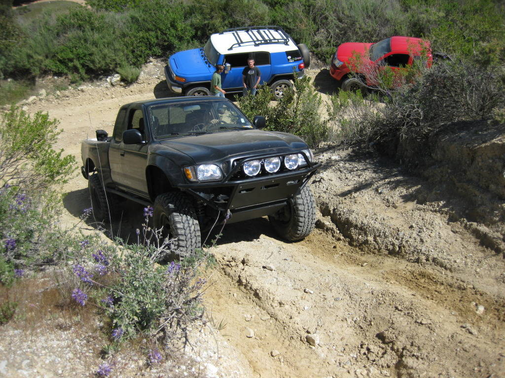

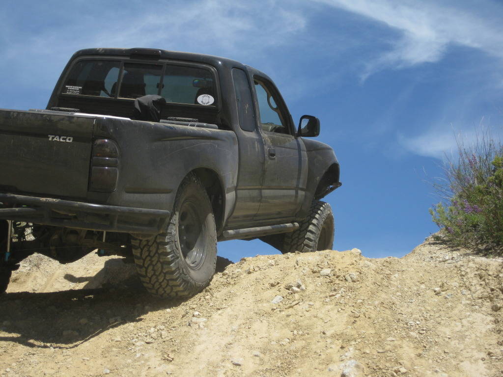

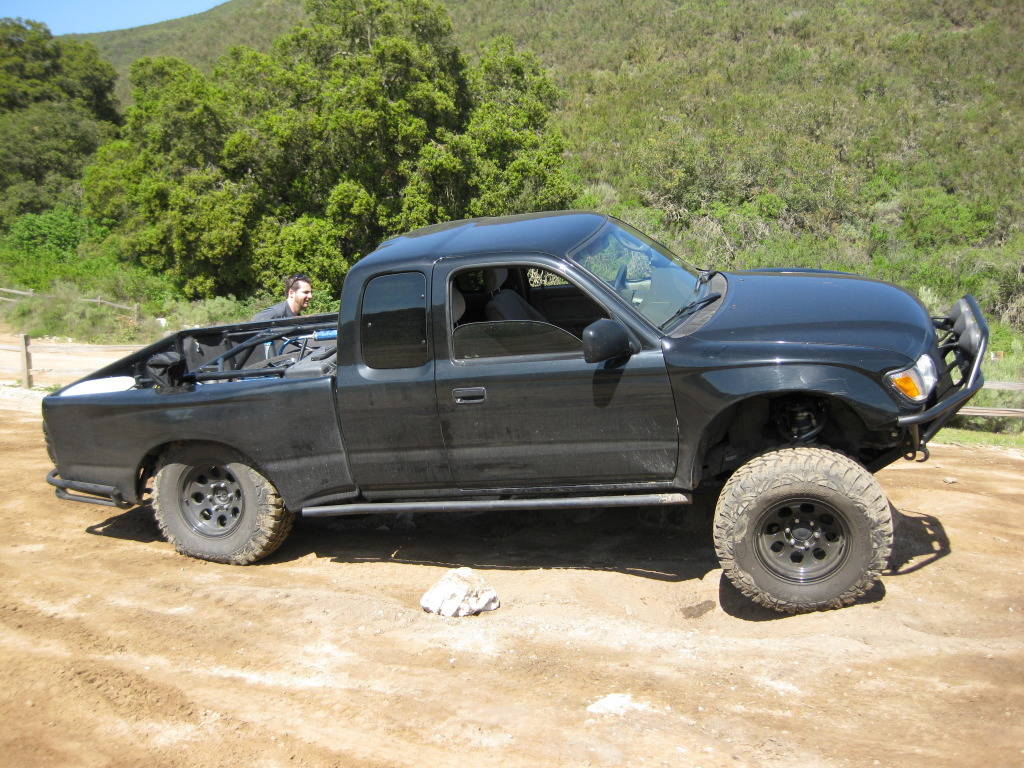

    Some new Hollister pix from farting around last weekend

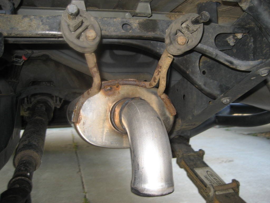

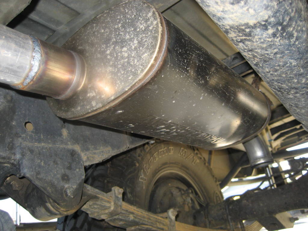

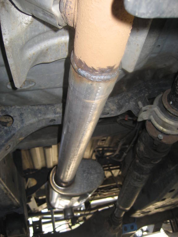

    So I installed a Magnaflow muffler. I heard a fellow TW member's Magnaflow and was quite pleased with sound. It's not completely overbearing and had a nice tone to it. Since I was doing it, I went ahead and decided to increase the pipe diameter to 2.5" and I figured it would help the s/c breathe.
    I cut off the old exhaust right after the rear oxygen sensor. For hanging the muffler, decided not to reinvent the wheel. Just cut off the old hanger from the stock muffler and welded it on to the back of the muffler.
    As for the muffler itself, I got the 18" Magnaflow with a offset inlet and a center outlet. I went this route so I could get a strait piece of pipe to run from after the oxygen sensor to the offset side of the muffler. No bends needed. Since I have the rear LT, I dump the exhaust down right after the muffler. For this I picked up a 2.5" mandrel bent 90 degree elbow from Summit racing. Cut it down a little bit and done.

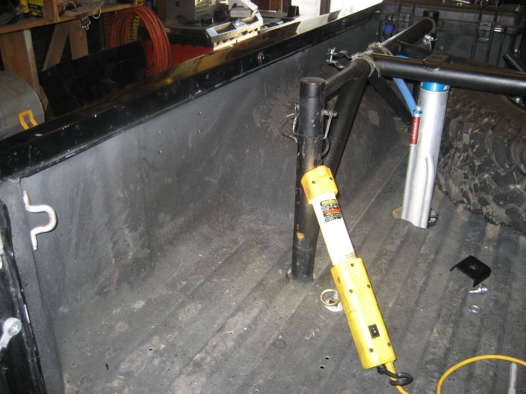

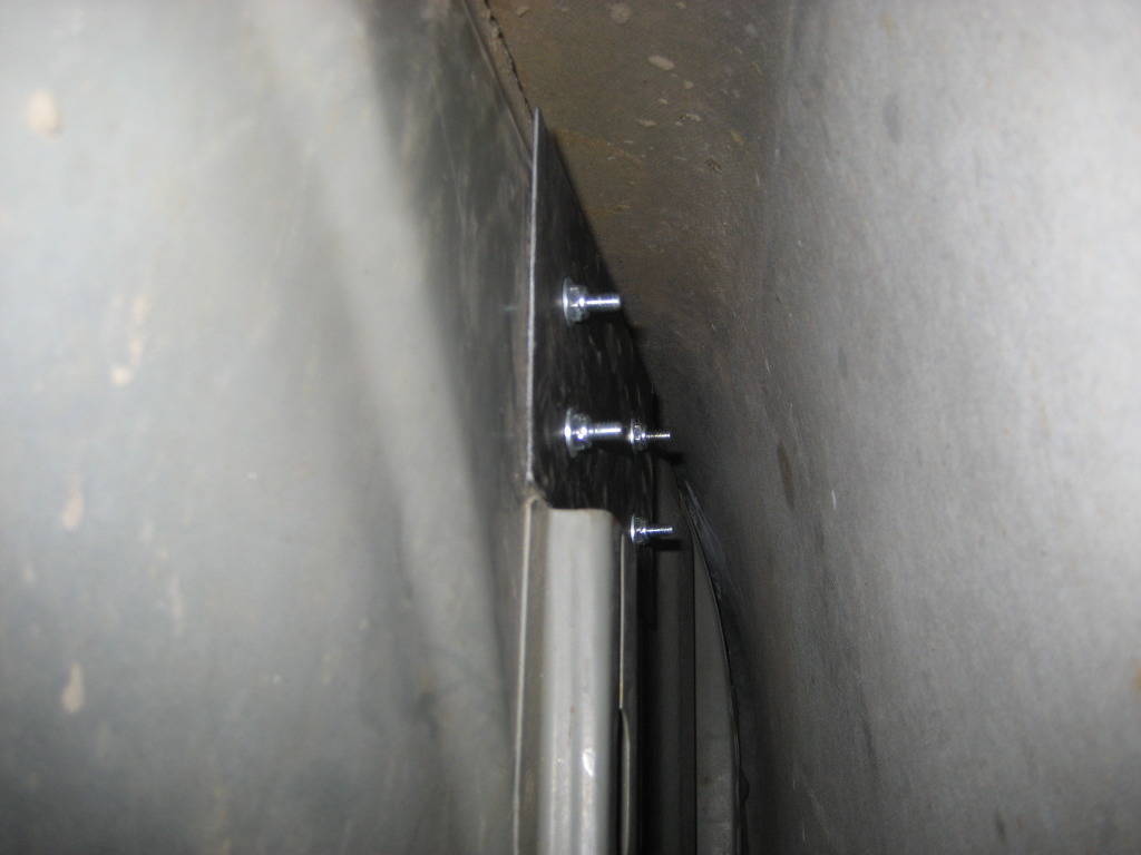

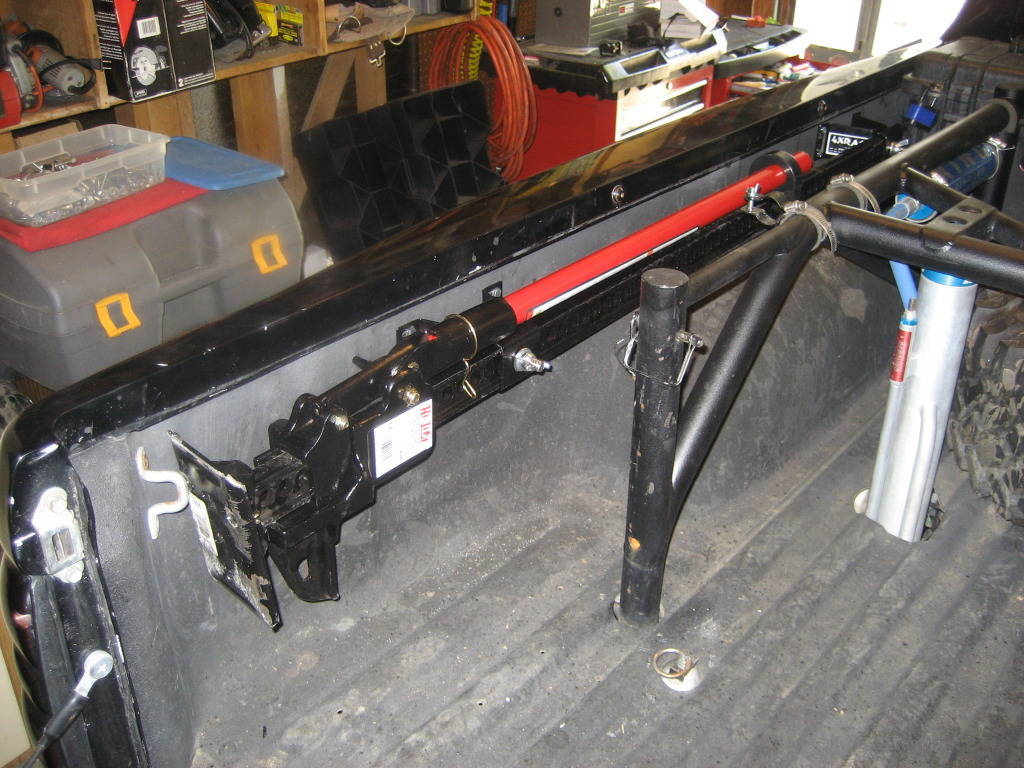

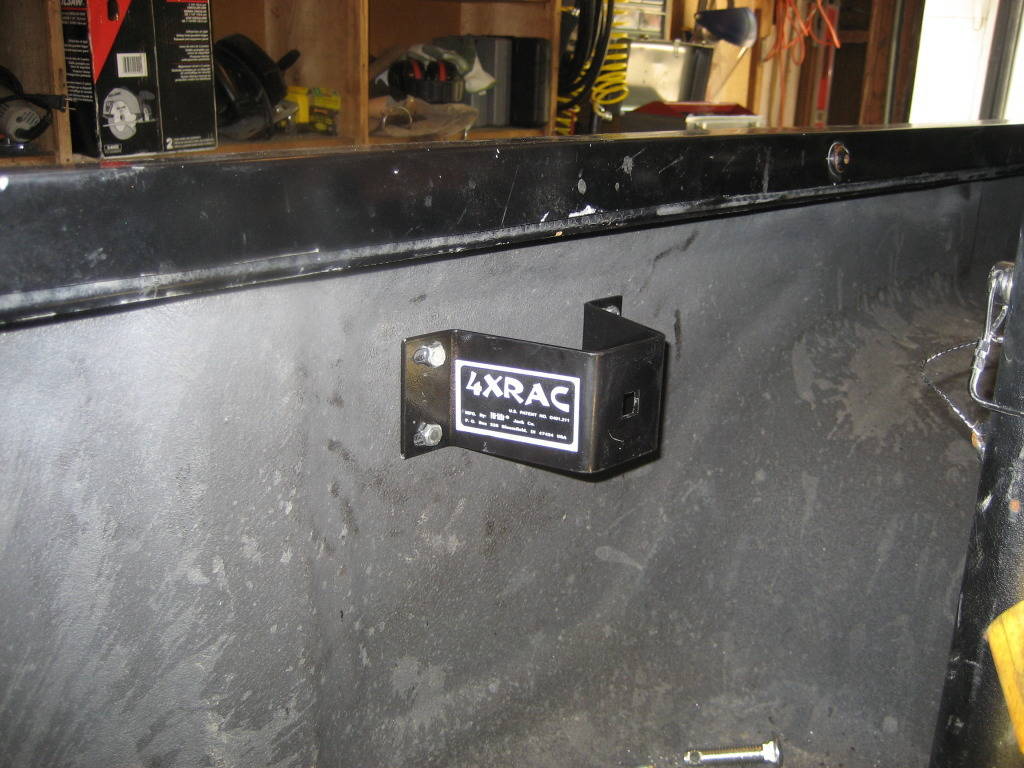

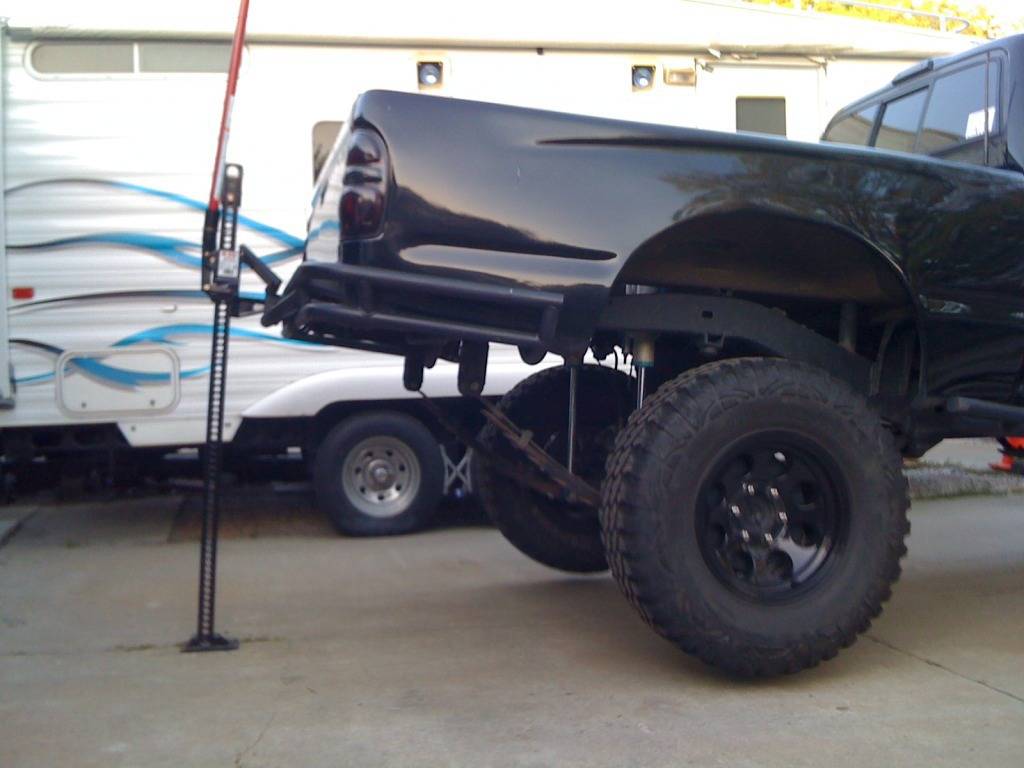

    Installed my Hi-Lift Jack this weekend. I ended up having to buy the 60" one in order to get my rear wheels off the ground when jacking it up from the rear bumper.

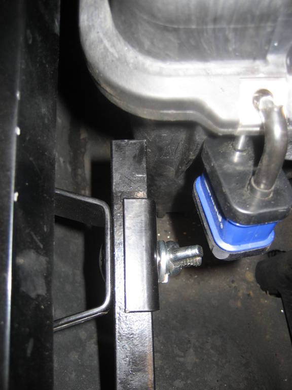

    I used the actual Hi-Lift Mounting brackets to mount to the side of the bed. Fits like a glove. I cut up some backing plates out of some extra stock I had for the brackets. Quick coat of paint and voila.
    I don't plan on having this in the truck all the time, only when playing in the dirt.
