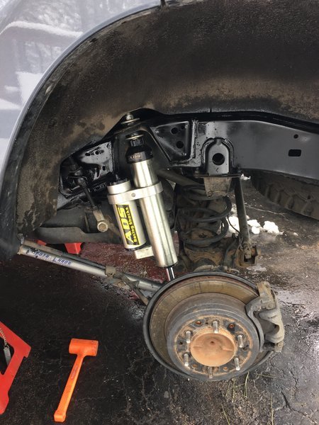

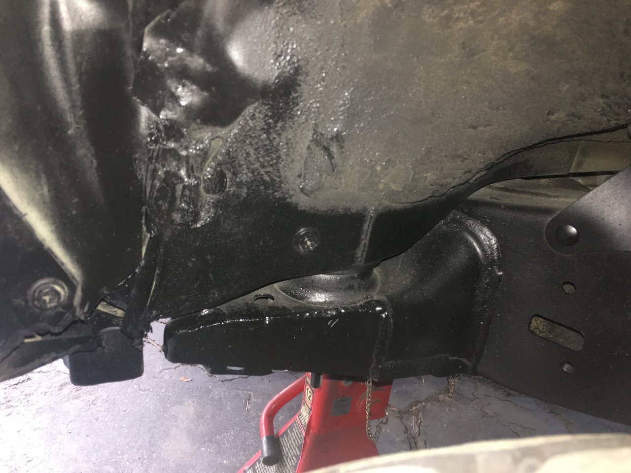

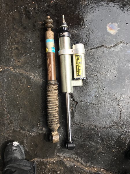

    Out with the old, in with the new.
    Took my rear ADS shocks off the Tacoma and repurposed them for the Short Bus. 10" stroke piggybacks and first round of jberry valving.

  2. Apr 8, 2017 at 1:32 PM
    #182
    TMFF
    TMFF Well-Known Member
    Dec 7, 2011
    #68368
    2,588
    Tim
    Thornton, CO
    01/02 DCLB
    Stuff and junk and things...
    You might want to look into keeping the body from rotating and the resi getting caught under the frame. The older 2.5 Icon's had a rod off the resi adel clamped to the frame to achieve this. The upper bushing friction can usually keep this from happening but I've seen a few different brands with piggy back's rotate on the 120/150 chassis.
  3. Apr 8, 2017 at 1:41 PM
    #183
    jberry813
    jberry813 [OP] Professional Fluffer Moderator
    Jan 21, 2011
    #49636
    28,484
    Jason
    Lake Tahoe
    2012 DCSB Sport
    ...too much shit to list.
    ADS>ICON. The resi is too large to rotate under the frame. I clearanced the bottom of the shock perch so the resi clears the perch but stops at the frame and fastened it with a zip tie.
    4Running Daily likes this.
  4. Apr 8, 2017 at 2:10 PM
    #184
    TMFF
    Dec 7, 2011
    #68368
    2,588
    Tim
    Thornton, CO
    01/02 DCLB
    Yeah yeah yeah Hate on Icon all you want, they don't make the piggy back 2.5's anymore. Remote resi only. And no I don't work for Icon.

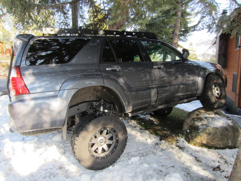

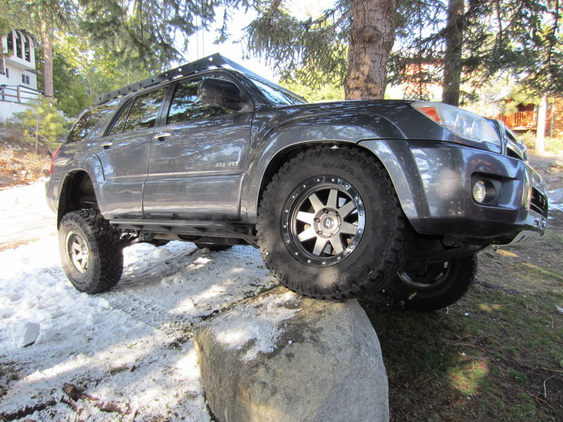

    Let the T4R stretch out and check for bump. Might have to start wheeling this rig. Damn thing can flex and stuff a tire.

    what you got an articulation "ramp" in the yard there!?

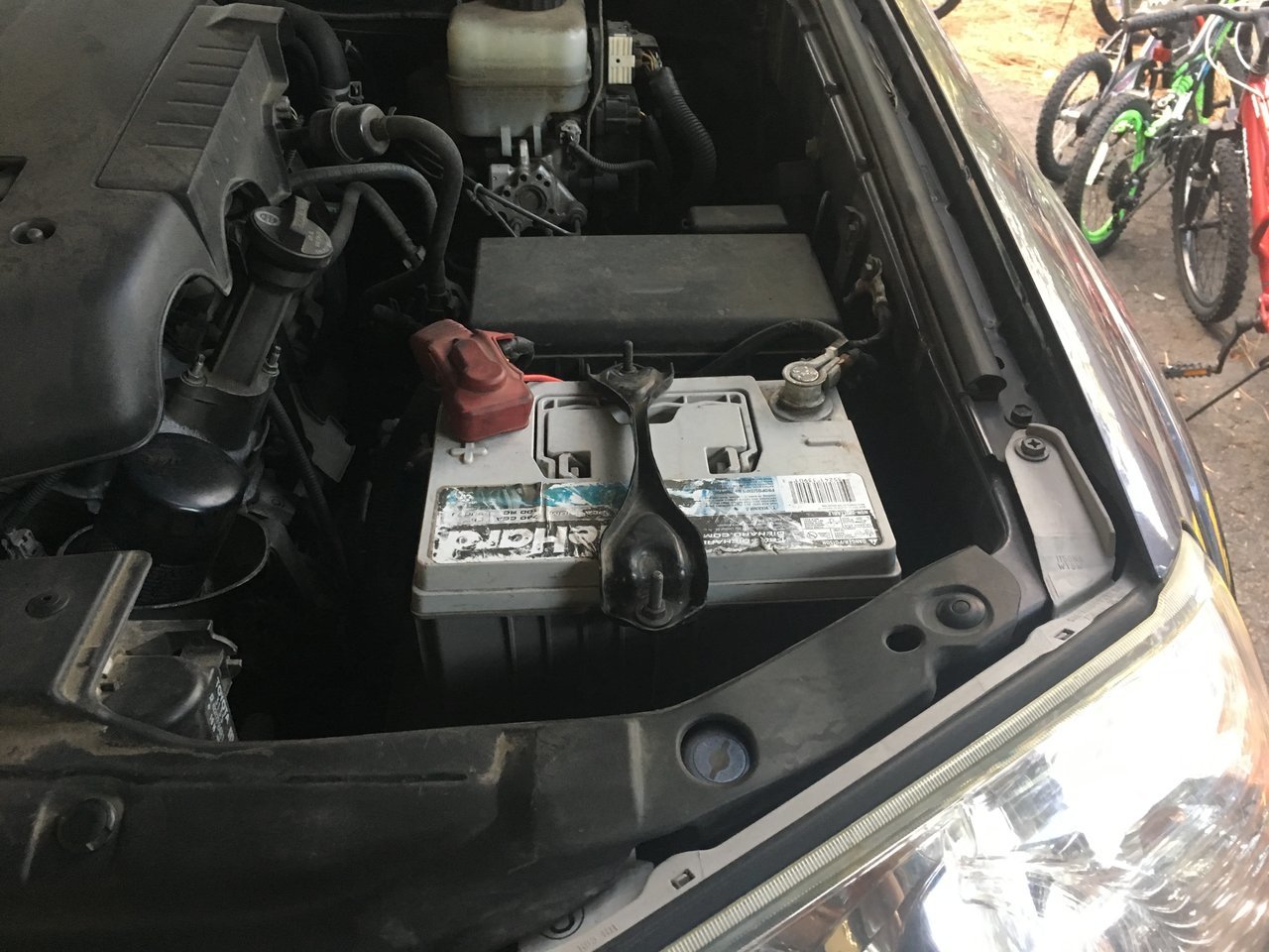

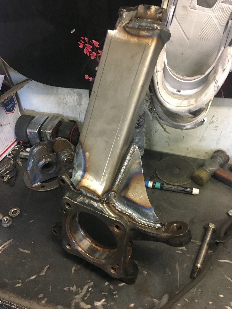

    Spindle gussets, CMC, and my old Die Hard Platinum installed today.
    Also prepped cool bucket top plates for engine hoop and secondary hoops.

    Did you heat up the entire spindle for those, then weld them and then slowly cool them down? Or just weld them straight up?

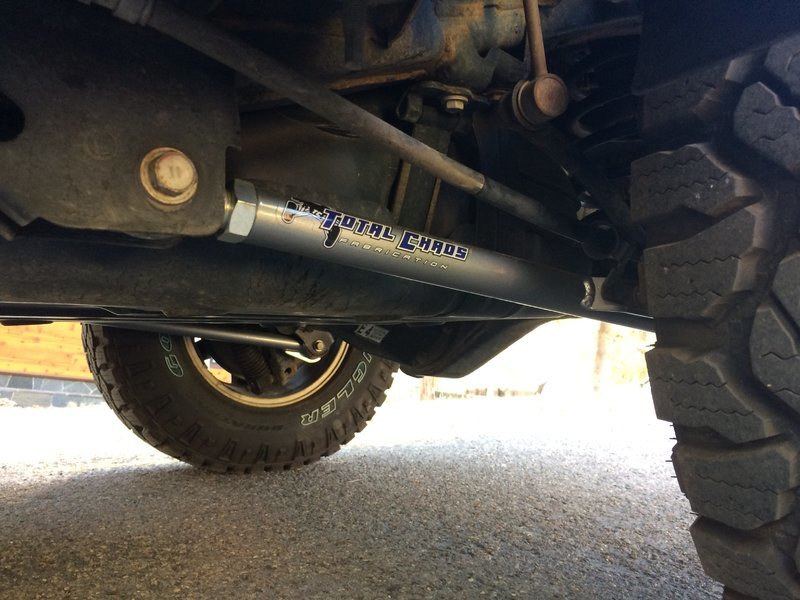

  20. Feb 9, 2018 at 8:30 AM
    #200
    Justin
    Justin Well-Known Member
    Jan 24, 2011
    #49854
    1,381
    Justin
    Colorado Springs
    2018 4Runner TRD-OR
    285/75/17 on SCS 6's. ADS front & rear w/ adjusters. Relentless front bumper & roof rack. BAMF sliders
    Are those recommended because you have so much flex in the rear or just for any mid travel setup in general?
