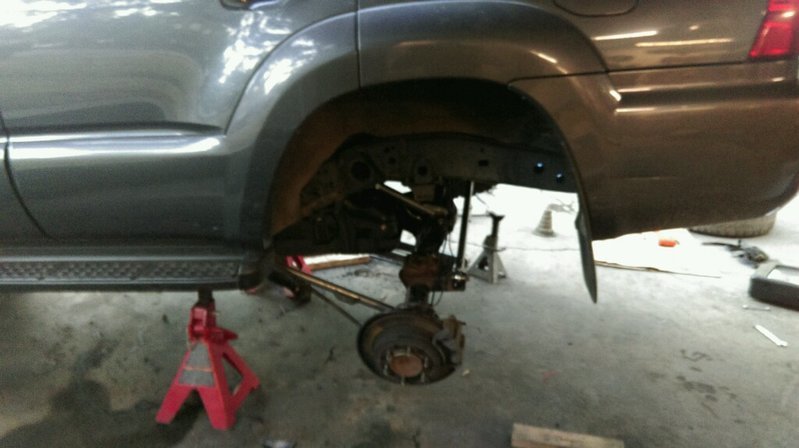

    Did some work tonight. Got the rear diff installed, extended rear brake lines, new MetalTech springs, and cycled the suspension to buy shocks. New 4.56s has some new found pep! Passenger side cycles a little better than the driver. Full droop the upper link on the driver's side comes in contact with the gas tank and stops the droop travel. Passenger side droop travel is limited by the lower link bottoming out with the axle. Only way to get more droop would be with an offset link or lower link perches and to move the gas tank forward.
    Obligatory pix:
    Full bump
    Flexy:
    Had to remove the tire to figure out the full droop
    Should work
    Guess I'll call DSM tomorrow and order shocks. :spy:

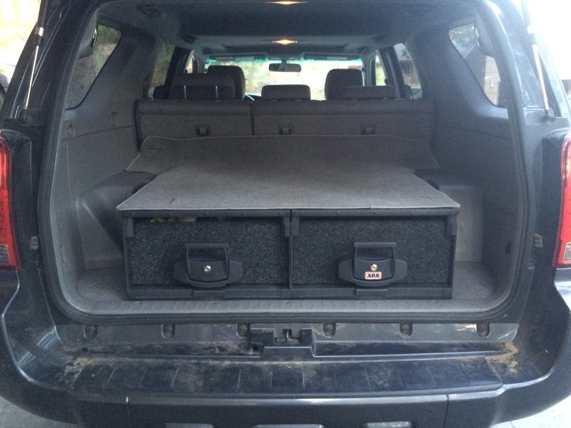

    More shit. Got both pumpkins installed with ARB lockers as well as the compressor. Plumped all the lines and most the electrical. Everything is tested and working. Just waiting for the AOB switches to show up for final switch install/
    I ended up getting the ARB HP compressor again like I have in the Taco. It does the job well. Not as fast as the dual, but I wanted to mount it in a specific location. It was a giant pain in the dick to get everything to fit and made my own T so I could fill tires, but ended up working out perfectly and hides nicely behind the cover.
    Also picked up a pair of ARB roller drawers. These things may as well have been made for a T4R. Fit like a fucking glove.
