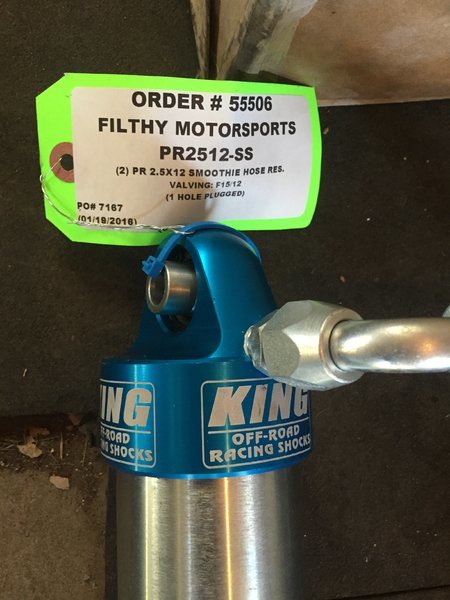

    Here is what I am running on mine, going to make a few tweaks this winter when I have some time to play them a bit more, but providing a good all around performance for now.

    Nice! Close to what I was going to start with.
    BTW, in case you didn't know, bypasses don't have free bleed holes in the piston like smooth bodies/coilovers. Good choice plugging 1 free bleed for the weight you have.

    That's interesting to learn. Curious is that KING thing only?

    No. You would have a double bleed with bypasses and freebleeds in the piston.

    The other think to keep in mind is your resi hose come off the top of the shock. Bypass resi's come off the bottom. When they come off the bottom, all the fluid displaced by the shaft during compression has to go through the shock valving (or bypass tubes). When the hose comes off the top, as the shaft displaces fluid it goes path of least resistance (which is normally through the resi hose). So to compensate you have to run more valving.
