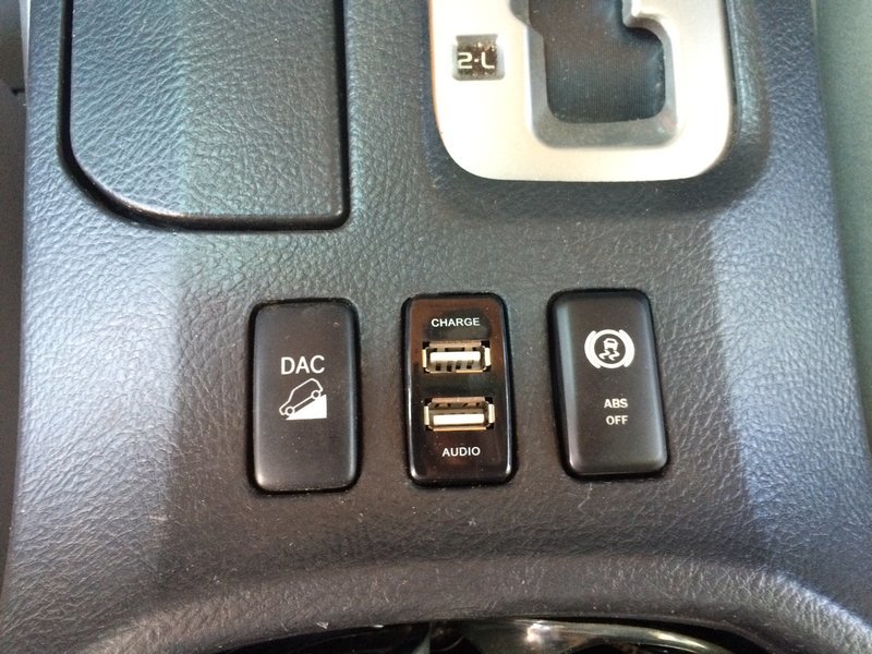

    Ok...last of the wiring is done (for now). Wired up a dual USB plug, one connected directly to the head unit, and one just a pure charger.
    Also wired up an electronic nanny disable button thingy. I found some write ups on unplugging the pressure sensor from the master cylinder, but it kinda sucks since it turns on the brake light in the instrument cluster as well. I always use my e-brake off roading and that light on would make me guess myself all the time. So I came up with my own way to completely disable the ABS/VSC/Trac crap with a single button. :spy:

    Does the disable feature work similarly to bikes? If you insert a switch into one of the sensor wires, you can disable just by taking out the sensor.

    Pretty much how I did it. I accidentally found out that if you break the circuit in one of the wheel sensors (meaning I broke the wires not paying attention), it disables all of the nannies. So the switch I added opens the ground on one of the wheel sensors. Turning the switch back off closes the circuit. Just need to cycle the key to clear the dash lights. It will store previous codes in Techstreem if I open the ABS/VSC computer, but nothing I care about.

    There are all kinds of logged ABS codes. As long as you can clear them and they don't come back, it's all good.

    It throws two codes. One for the speed sensor I open the circuit on and one ABS malfunction code. They both will stay as previous codes, but after a key cycle the dash lights go out.
    Air On Board makes the switches and the USB port that fit in factory locations. For whatever reason, the dual USB is saying call for price now. But below is the link.
    USB: http://www.aironboard.com/online/power-outlet-800s-12v-dual-usb-charger-for-toyota-vehicles.html
    Switches for T4R: http://www.aironboard.com/online/toyota-replacement/4runner-2003-2009.html

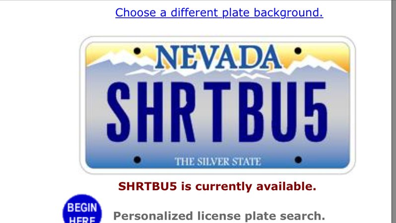

    I tried. Really really hard. But the wife told me to fuck off:
