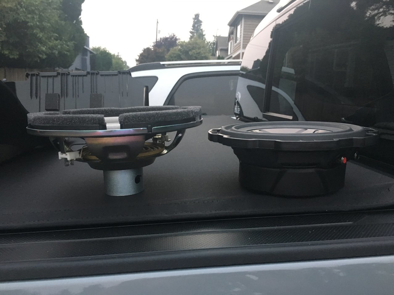

    Went ahead with the following replacement setup:
    Typically I buy speakers through crutchfield but here are some Amazon links for ya'll. Also - I found mixed documentation on how many ohms the factory JBL system is. Some say 2 some say 4. I took a chance based off the research I did.
    Front Door Replacement: 4ohm 6x9" Kicker 43CSC6934 front door speakers. No longer available but Kicker 43DSC69304 looks to be about the same spec.
    Rear Door Replacement: 4ohm 6.75" Kicker 43CSC674 rear door speakers. No longer available but Kicker 43DSC6704 looks to be about the same spec.

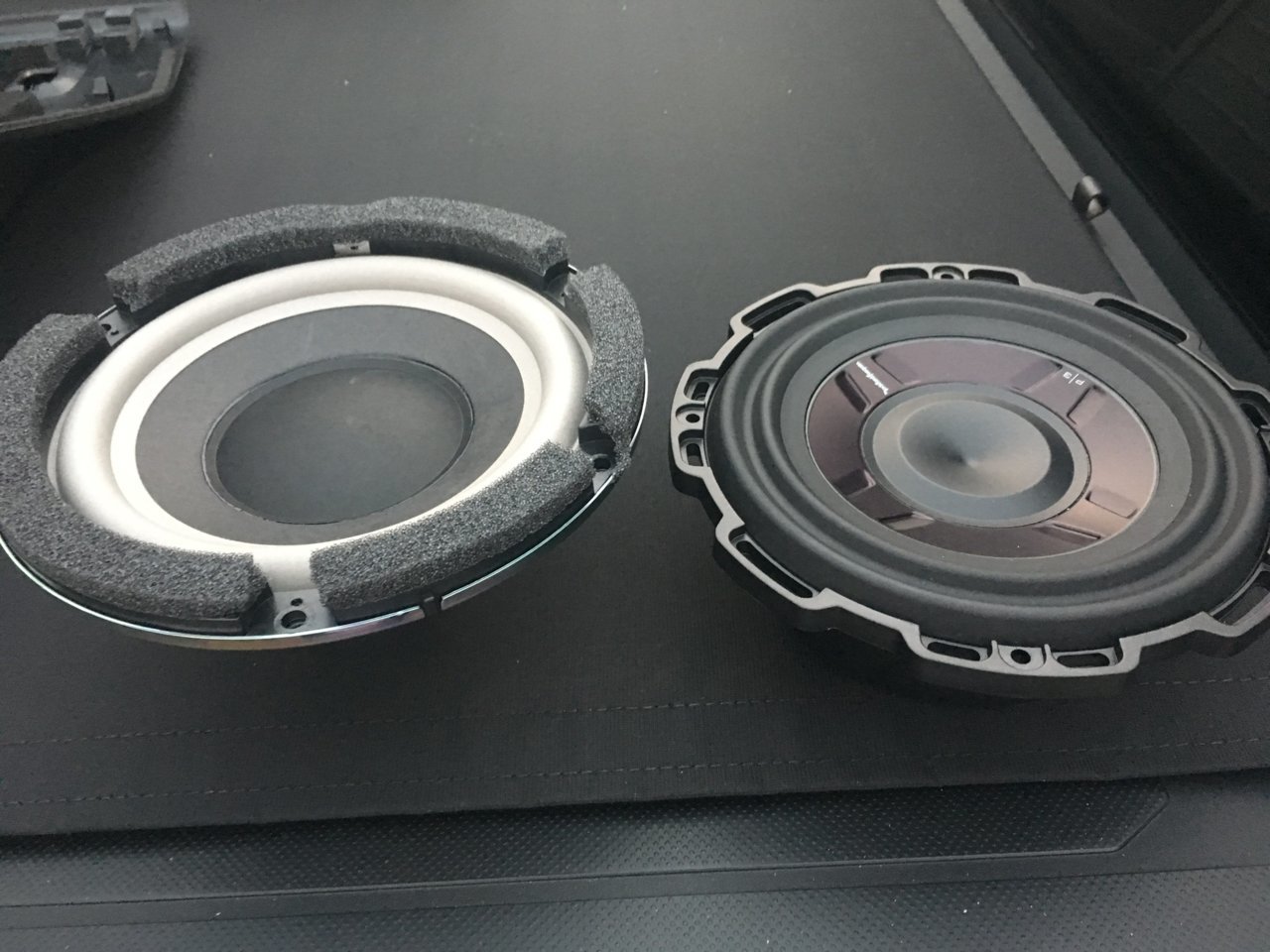

    Sub: I also replaced the factory 8" sub with a Rockford Fosgate P3SD2-8 dual 2ohm 8" sub.
    Tweeters: I did the subaru/kicker tweeter swap (all over these forms) and just made my own harness to fit the factory wiring.
    Results: Huge overall improvement!! It's not the loudest setup in the world (with only a 440w amp to drive all 7 speakers - sub probably gets ~120w) but SO MUCH BETTER than the crap they pass as "JBL".

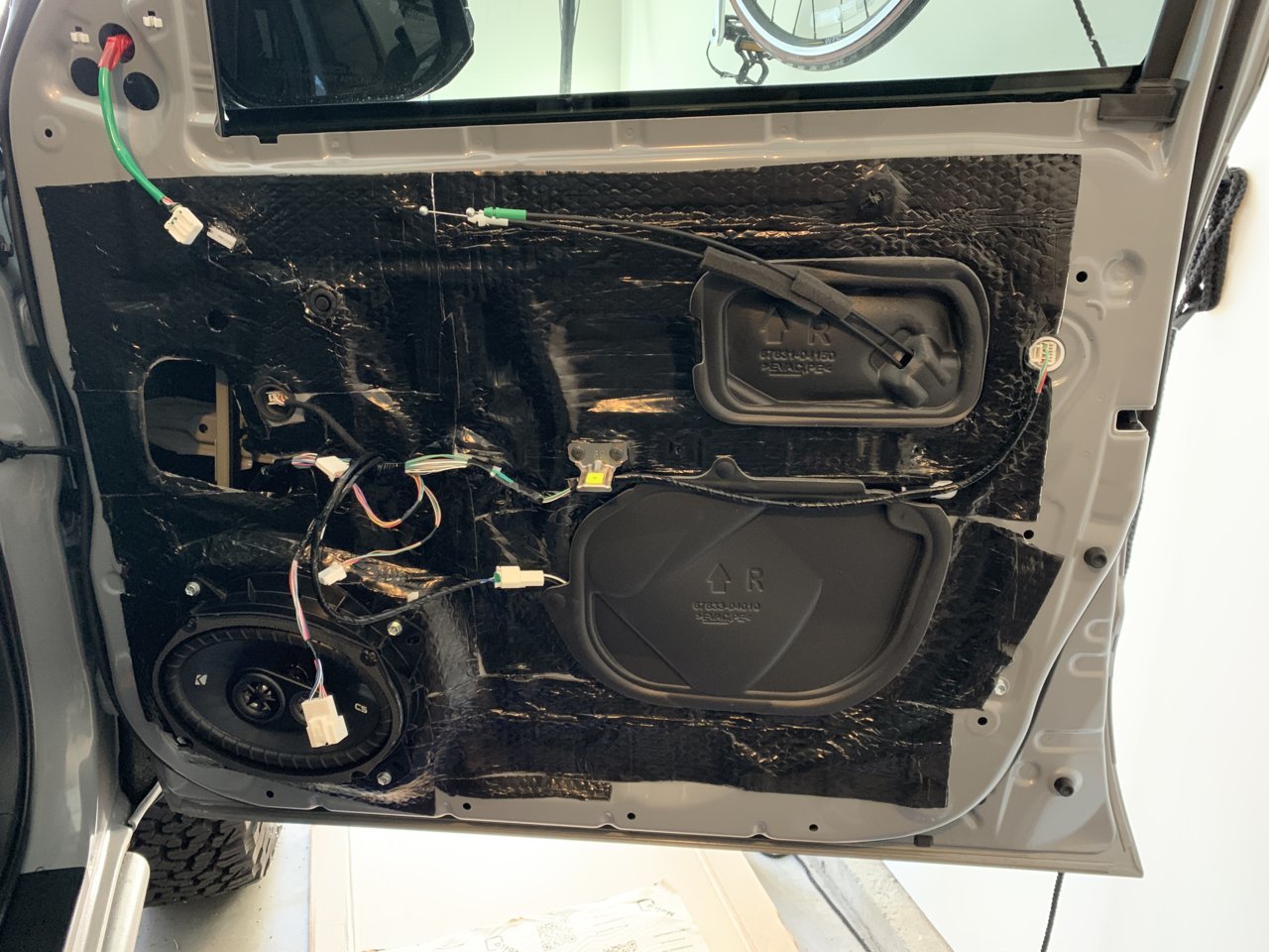

    I should add... I also added as much sound deadener as I could (noico)... covered probably 80% of the front doors (all sides) and 60% of the rear doors. The combo of the speaker upgrade plus sound deadener is well worth it.
    Annoying rattling is gone and instead I've got fuller mids, clearer highs, and deeper lows! For a few hundred dollars it's a significant step above what comes as part of the JBL package. I definitely didn’t lose any volume. I’d say gained some and increased in overall quality/clarity as well.
    In all my previous vehicles I've installed aftermaket everything. And, my last Taco had a 5 channel amp and a big 12" sub so I'm definitely accustomed to a more powerful sound... but for now this'll work just fine. Allows me to continue saving up for suspension/lift!
    I took some very sporadic photos..
    After door speaker and deadener is in on passenger side
    I’ve since gone back and covered more exposed metal (closest to the speakers) with what sound deadener I had left once I got the rear doors how I wanted.

    Stock sub vs aftermarket

    Thank you so much for posting this!!! Was the sub plug and play? Did it fit into the OEM enclosure? Do you have any info about the JBL amp? I'd really like to know if it's designed for 2 or 4 ohm. The only thing I've been able to find says the stock JBL speakers are 2ohm. Since you have yours out, is it labeled on the speaker??

    Yeah the sub did fit into the OEM enclosure but the mounting holes didn't line up, so I drilled new ones. To be frank... ~110watts is not enough to really give the P3 sub the energy it needs. But it's deeper and tighter than the stock JBL woofer. Eventually, I'll get a LC2i to send a signal to a mono amp to drive a different sub in a new box (keeping the stock JBL amp to drive the other 6 speakers). But for now, this upgrade is keeping me happy.
