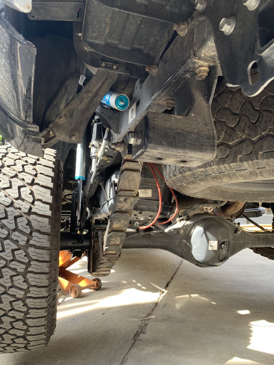

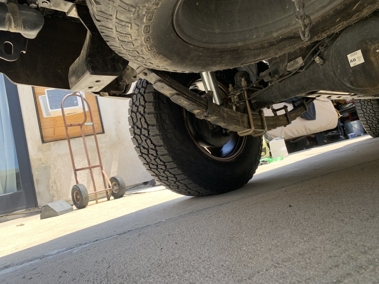

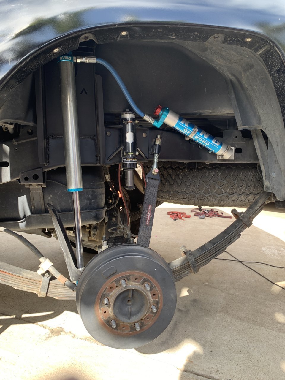

    Here's a shot of the spring under axle with the tundra shock and the @ARCHIVE hammer hangers and super bumps . icon hydros are coming and i would love to do the shock relocate with 12" foxs

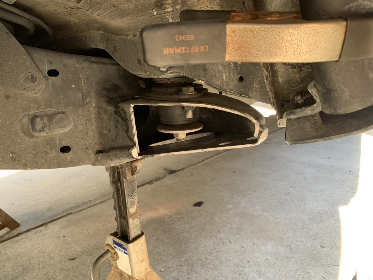

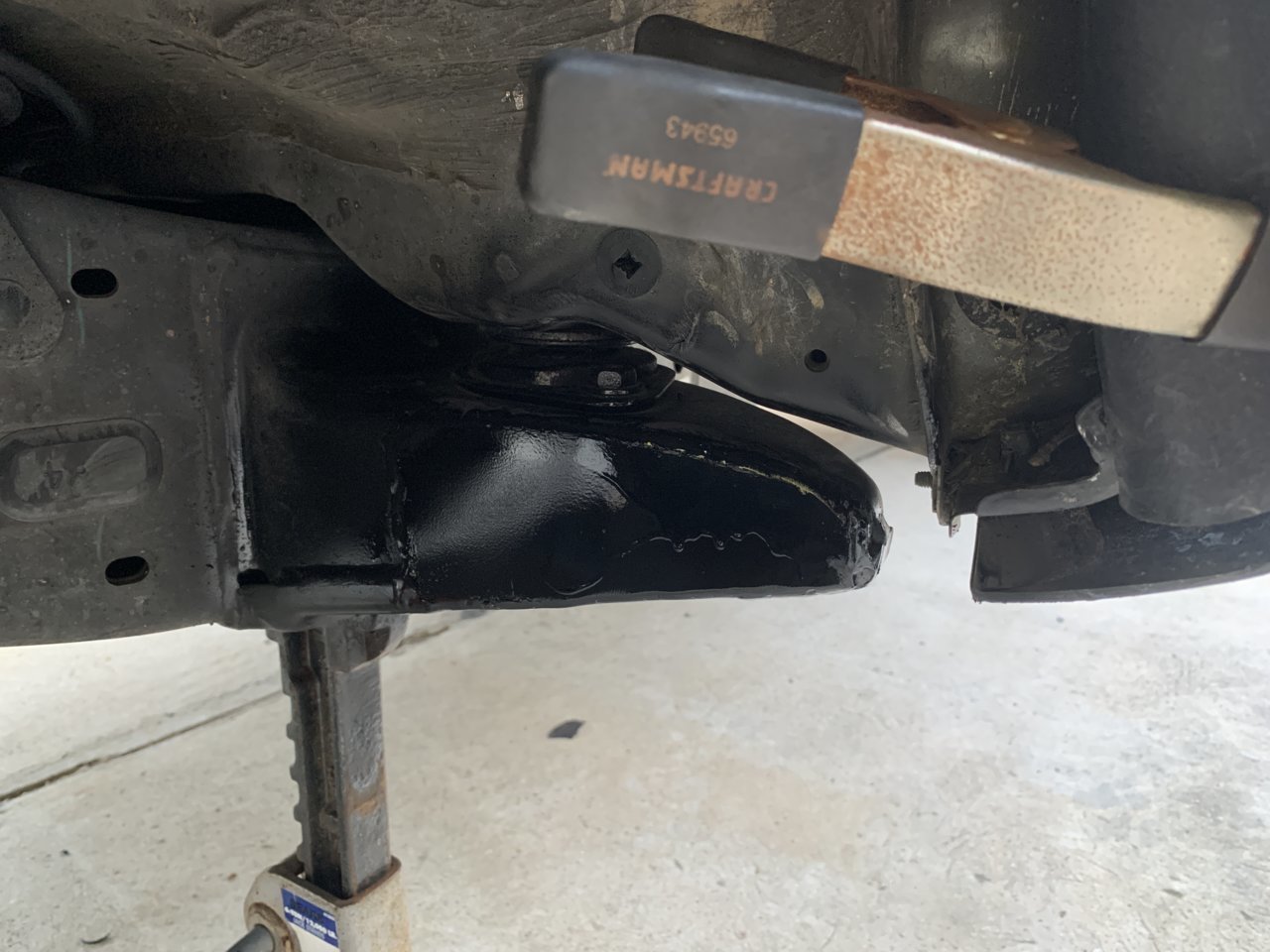

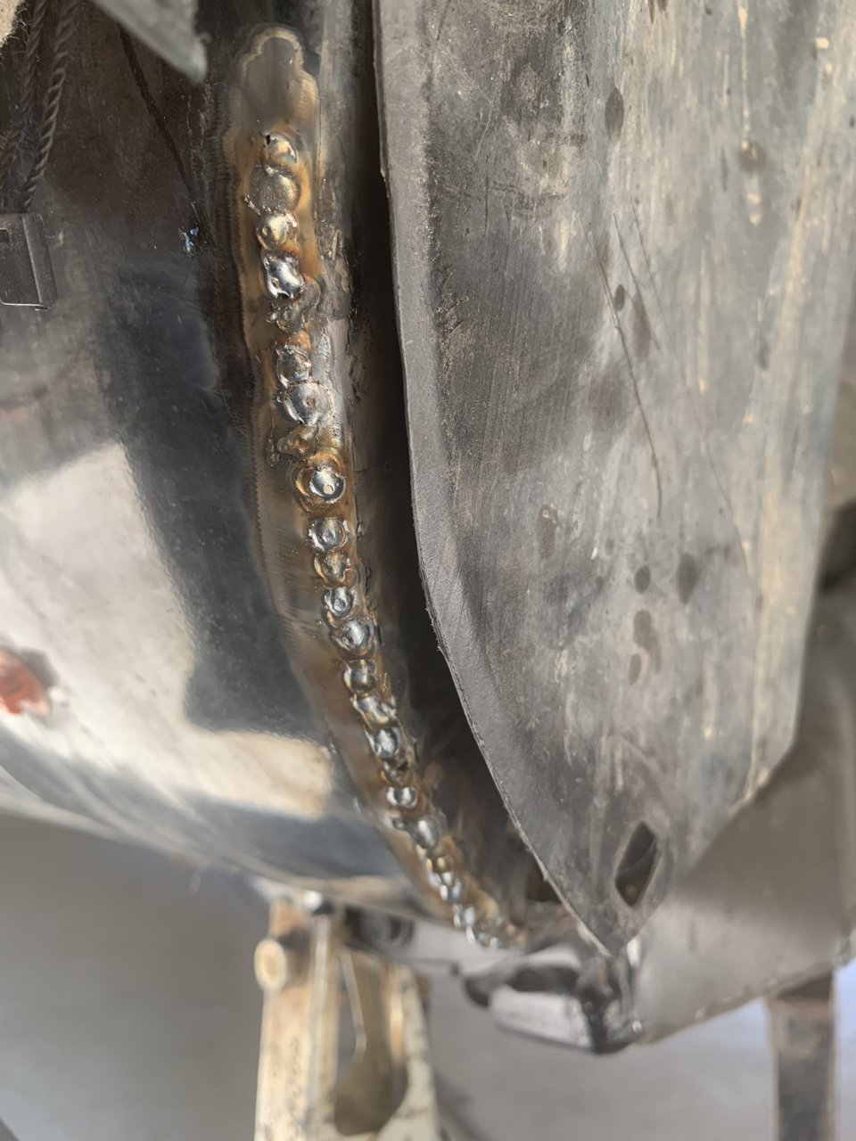

    here's the bamf cab mount chop. super easy. i need to trim the seam weld at little bit

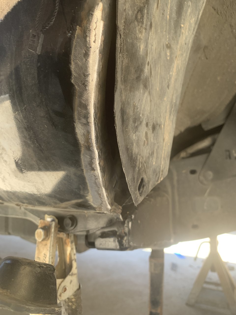

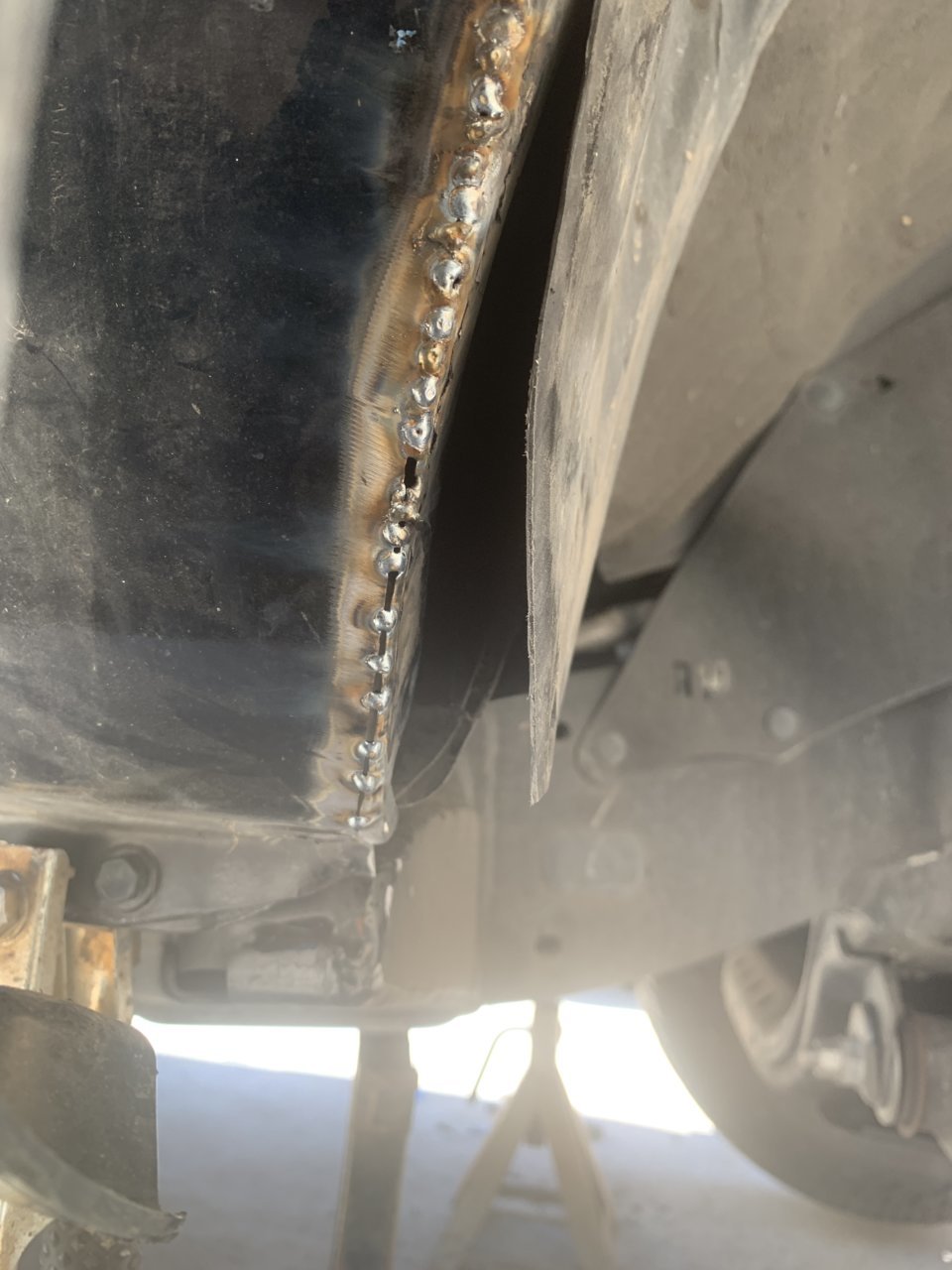

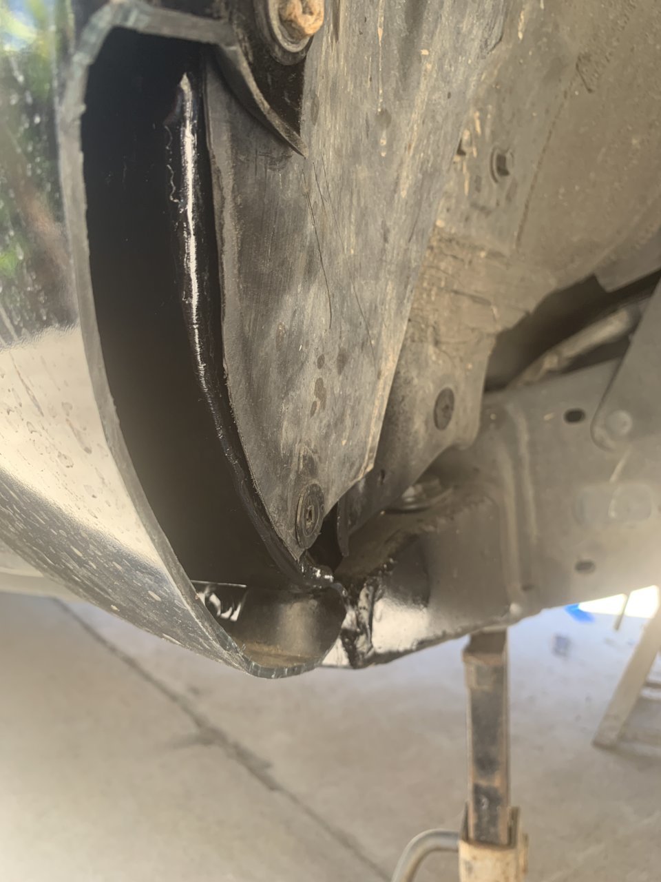

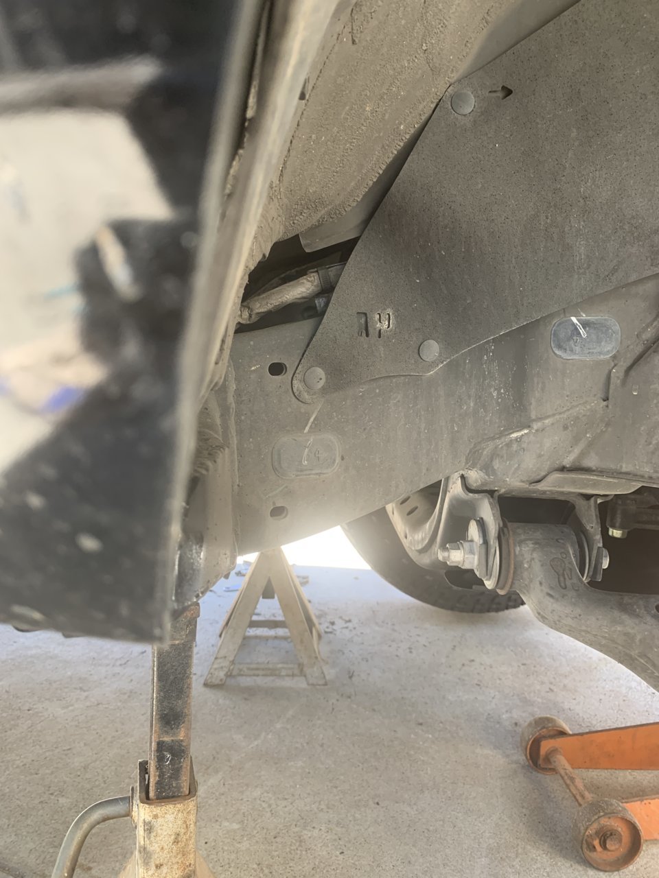

    so after i did the cab mount chop i was still hitting the pinch weld and the corner of the fender. so i figured i would pie cut the fender and suck it closer so i could mount plastic to it. and get it to line up with the cab mount chop. bent the pinch weld to the outside of the truck so i could screw the plastic down.

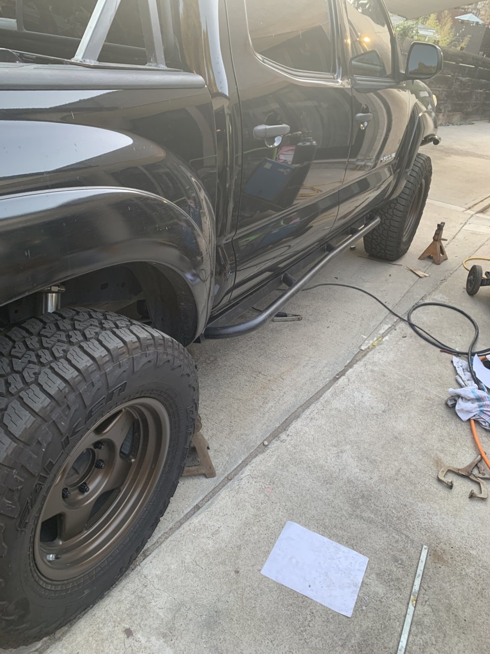

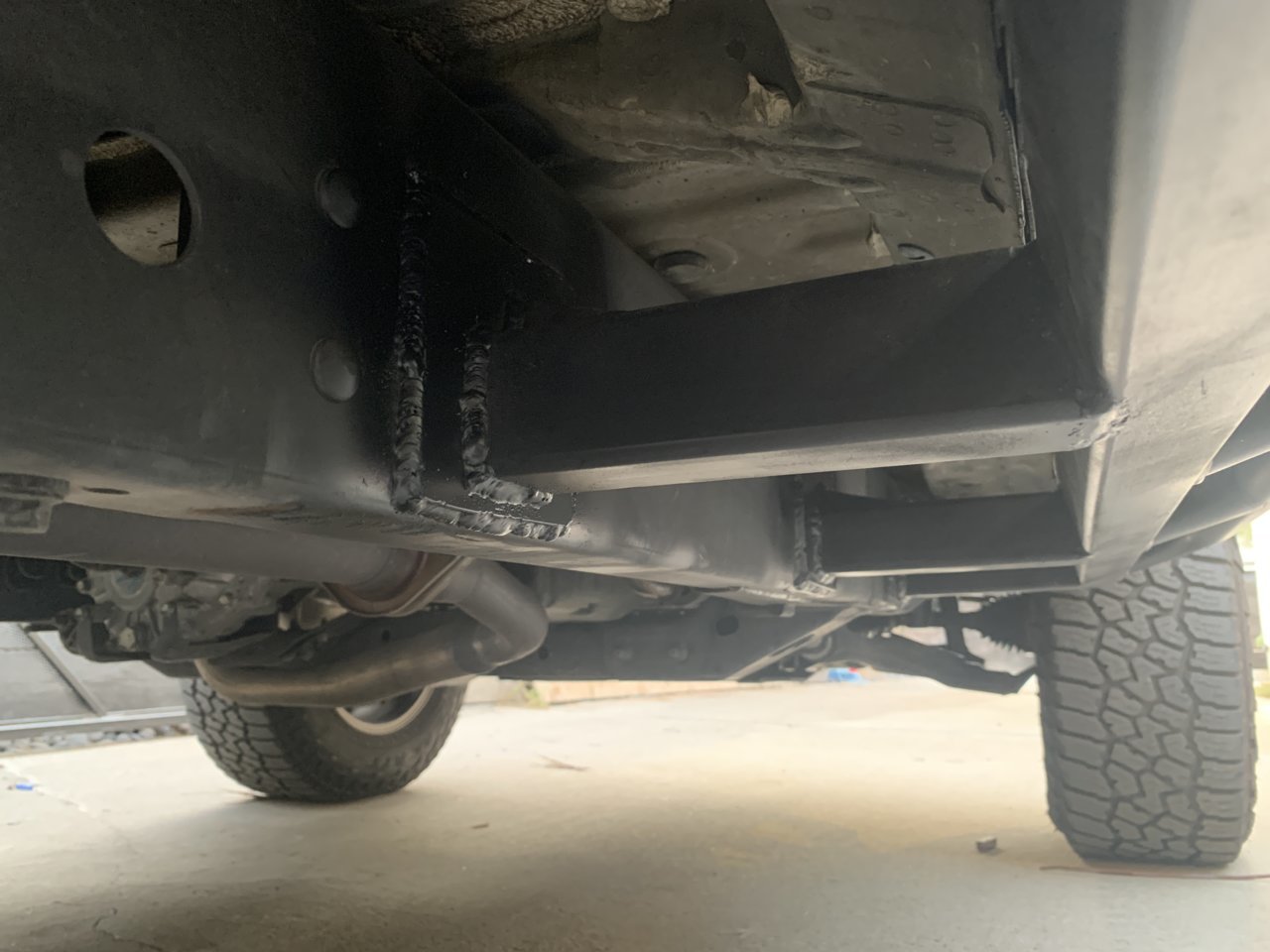

    got some pelfrey built rock sliders from @JathzPyrite as he is parting his truck for a new one. got them buzzed on today. should do the jobIMG_5159.jpg IMG_5158.jpg

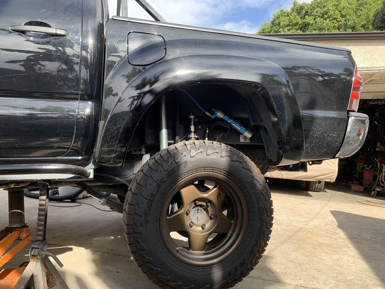

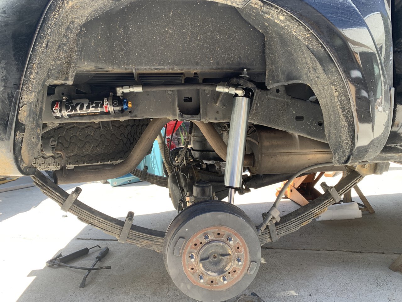

    well i got to installing the @ARCHIVE shock relocation. i used a cutoff wheel and and a air chisel like everyone else but i did it in my driveway. At the same time knocked out the limit straps and icon hydro bumps. rear feels pretty good now with a full load of moto and camp gear i can mob down most rutted fire roads with some whoops and not bottom out. crawls up most stuff more planted even in two wheel with the locker locked. now its the front that i hear topping out the shock or feel hitting the duro bumps. that said its a 100% improvement over stock. install was pretty strait forward. i think it easier than doing the hammer hangers. cutting off driver side shock mount was the second most difficult part of this one because i was lazy and didn't take the bump out. first was the cutting the old shock mounts off the axle with just a cutoff on my back it took a while to get them off and cleaned up. also holding a degree tool and tacking by myself was tough because it was hard to see what degree then tack. just awkward. but it all turned out alright took a dayIMG_5182.jpg IMG_5181.jpg IMG_5180.jpg
