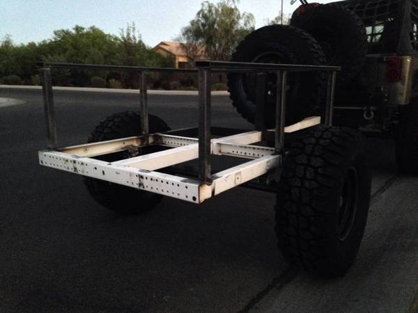

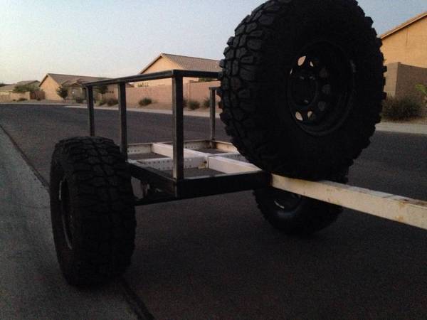

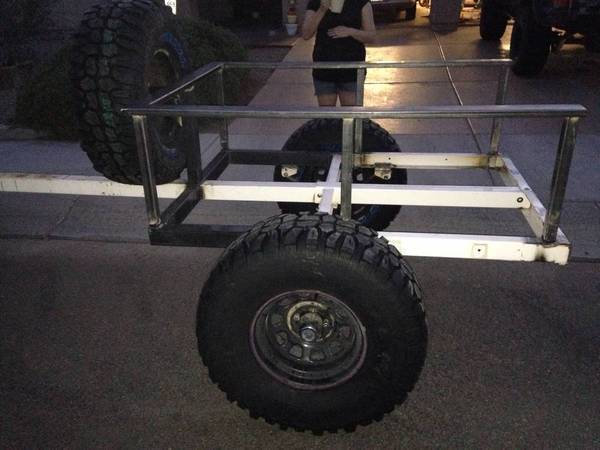

    Today, the guys at Big O Tires hooked me up with a smokin' deal ($180/tire!!) on a set of three 33x12.5x15 Mud Claws which they mounted on some 15x12 jeep rims that CrawlinWJ hooked me up with. I brought them home tonight and finally got the trailer off those stupid 12 inch trailer tires. It's finally really starting to come together:
    With the 33s mounted, the ground-to-frame measurement is around 24"

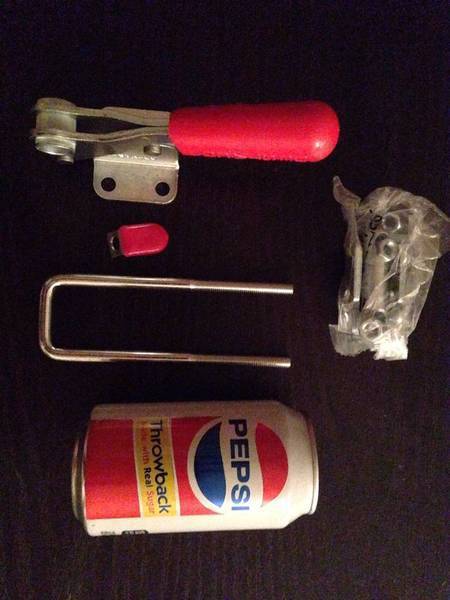

    I ordered a set of tiregate latches on Ebay, which came in today. They're a lot bigger than I expected but fuck it. 1,000# gate latches FTW :cool:

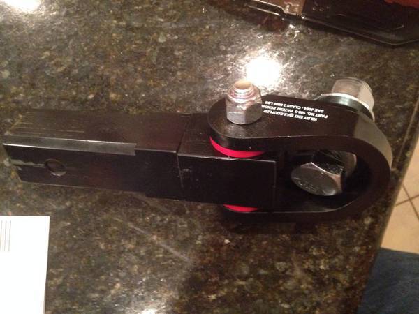

    AND I got my Max Coupler yesterday!! This thing is awesome! Adventure Trailers currently has them for $250 shipped.
    This weekend, I will be finally cutting the 14 gauge steel sheet to line the bottom and sides, adding custom built steel fenders (square style to match the fenders on my Wrangler), the tailgate, and fabbing the tongue attachment for the Max coupler. I'm really stoked that it's finally coming together :D

    Thanks man! Right now tongue weight is 30-35lbs, but will be going up once I sleeve the tongue bar to strengthen it. Also, there will be water cans mounted up front and a deep cycle battery/2,000 watt inverter for onboard 120 volt household power.
    I was thinking of going with a drop-bar style tongue jack because of the height issue, and maybe a pair of electric jacks at the back corners to level it on un-even terrain for when the roof top tent is used.
