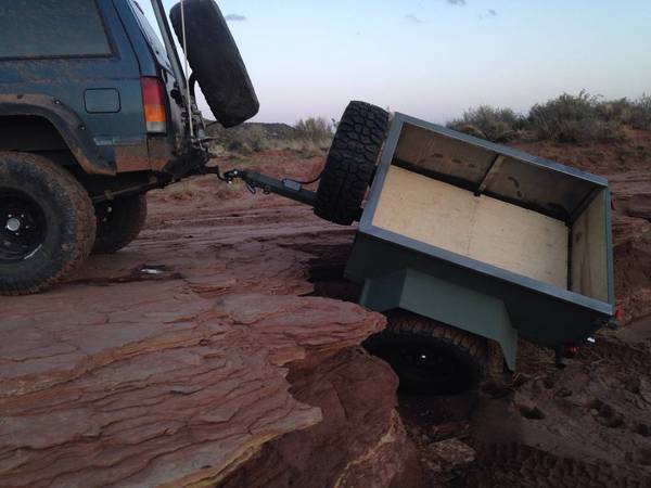

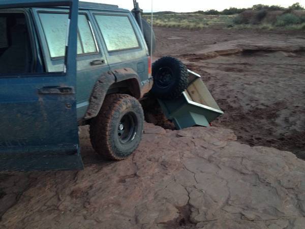

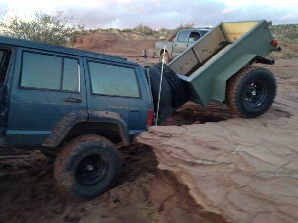

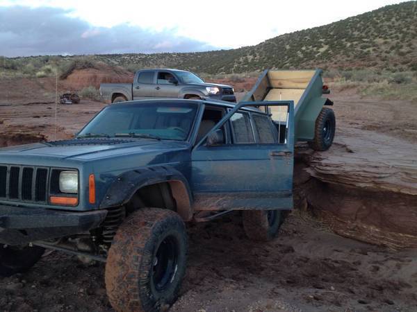

    As a matter of fact, there was one thing. As Germ and Snowtank can confirm, I was doing some pretty crazy shit with the trailer in a wash at Germ's place in Snowflake, specifically the high-speed drifting and jumping. In the process I managed to *slightly* bend the axle tube (didn't even notice it till I got home), and found some flaws in the spring setup.
    All that in the name of testing; I wanted to make sure the trailer could stand up to anything I threw at it. But weaknesses were exposed and will be corrected.
    No worries tho, I bought a new 2,000# axle today and ordered a new spring kit, complete with brackets, hardware etc. Also, certain areas of the bed are getting reinforced/gusseted and the tongue area of the trailer is getting revamped soon :)

    If you're going to do that work, why not 3500 lb axle?
    Considering you already bent one axle, I'd consider it for the strength over the 2000 lb axle.
