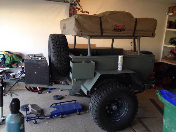

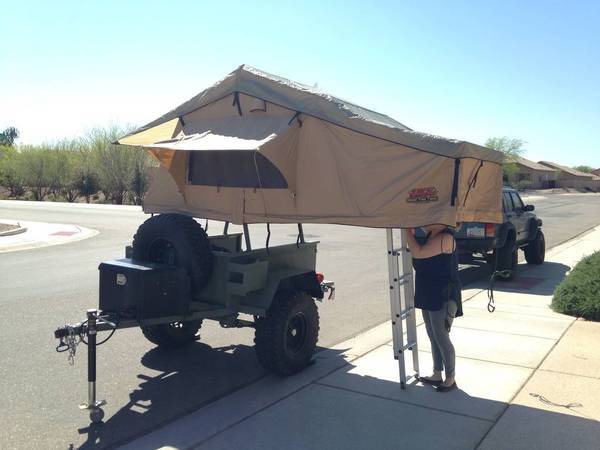

    Been a while since I've posted, so heres some updated trailer pics!

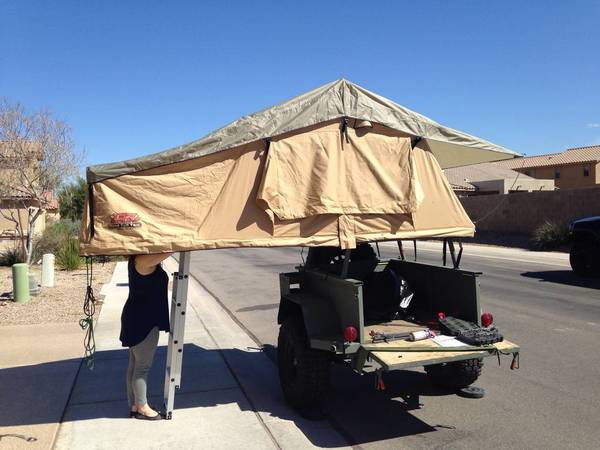

    Finally got my RTT purchased and mounted up with the help of Stefen! Had to set it up in front of the house of course :D

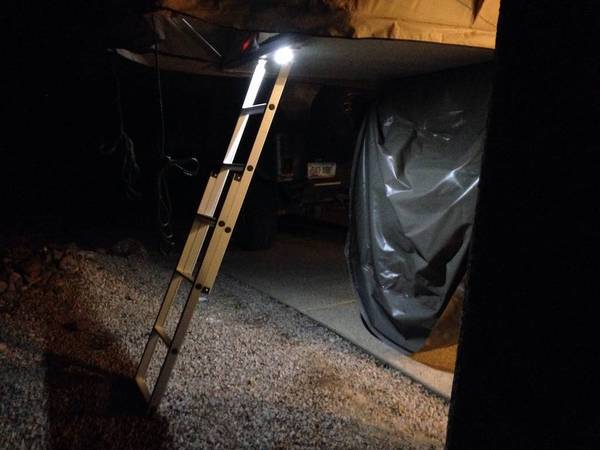

    Of course, I had to set the tent up with lights. I recently ordered a shitload of these: http://www.amazon.com/gp/aw/d/B00C1Y...=AC_SY200_QL40 These are 6"x0.75" miniature adhesive backed lightbars. I call them "lightbars" because they're not flexible (bending them kills them). 12v, 0.5A each, and very bright.

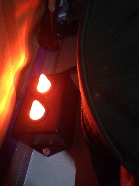

    I set up a small box with a couple cheap illuminated toggles, one to control the light for the ladder and the other for inside the tent. Wiring to the LED bars is hidden under the mattress, with a 12 foot power cord with a male 12v plug on the end that plugs into the receptacle in the tongue box:
    And placed one of the mini lightbars for under-tent/ladder lighting
    And one bar inside on the center hoop. Lights the shit out of it!
    Here's how its sitting currently, in anticipation for some camping!

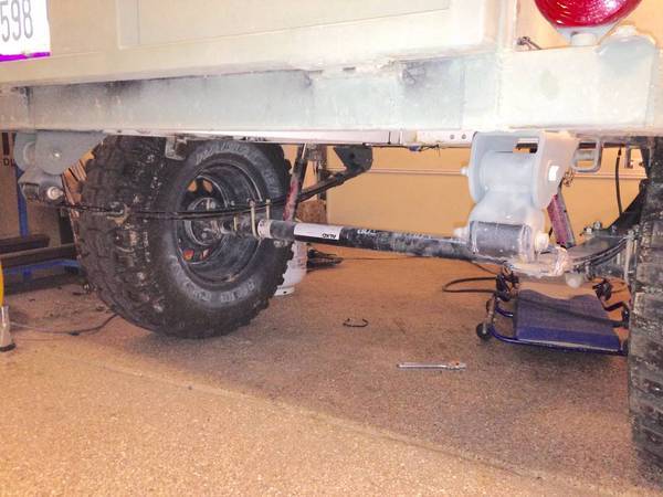

    After the last camping trip, I decided that the springs I had on it were way too stiff. So, I switched them out! Can anyone guess what vehicle these new springs are off of? :D

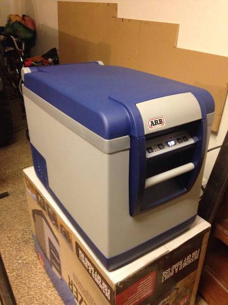

    And picked up one of these! No more ice!!

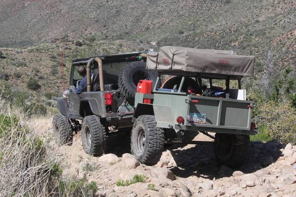

    Teaser pic from Rug Road on the 27th of March! More to come!

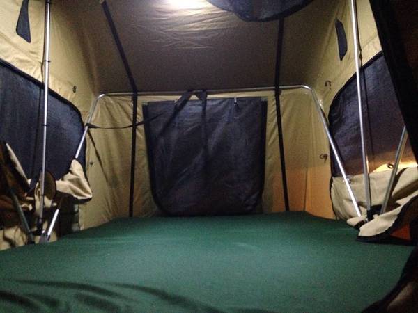

    While on the trip, I also did a lighting "trail install" on Snowtank's rooftop tent! Here's a pic of the interior and ladder lights from his tent after install:
