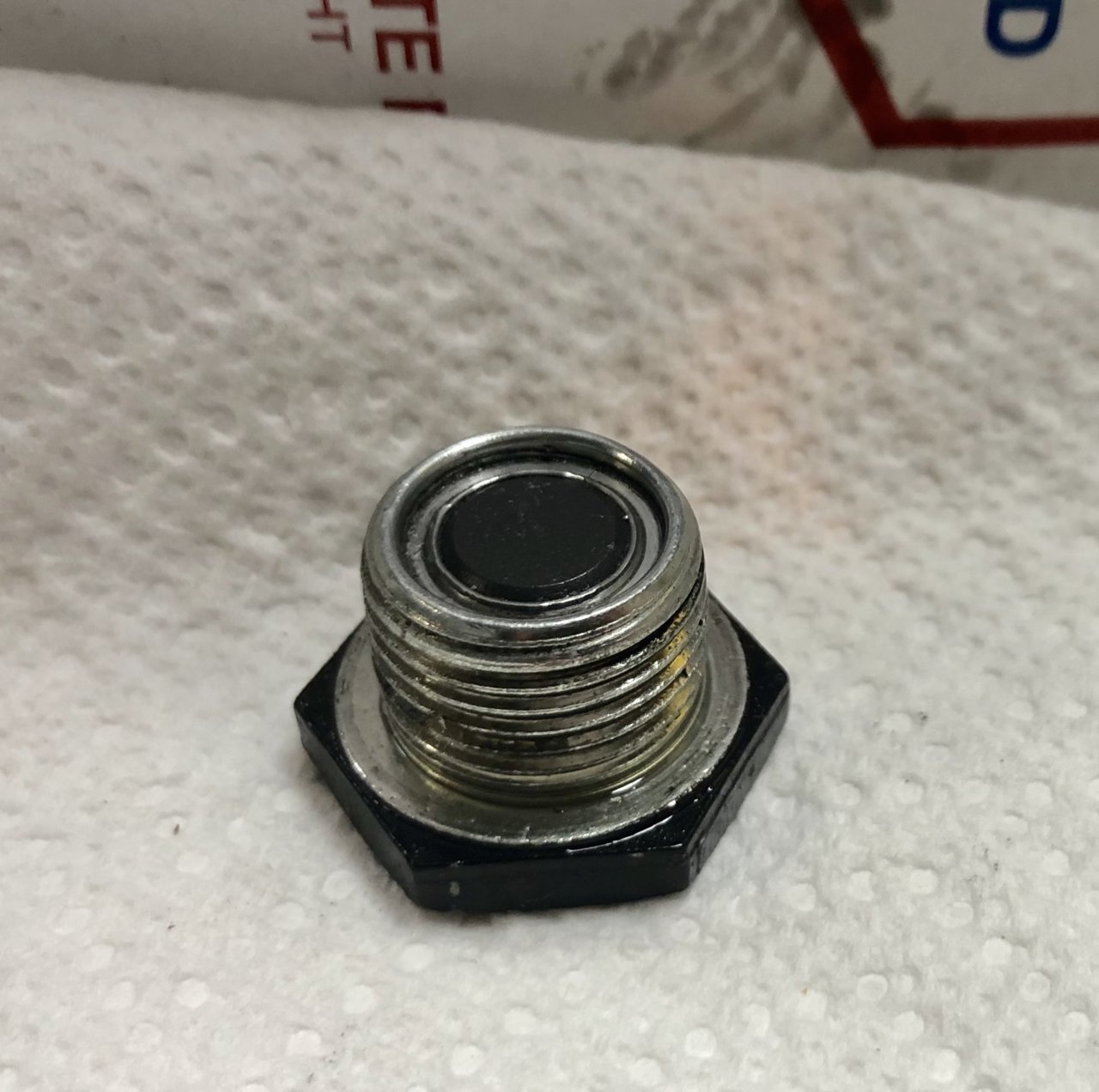

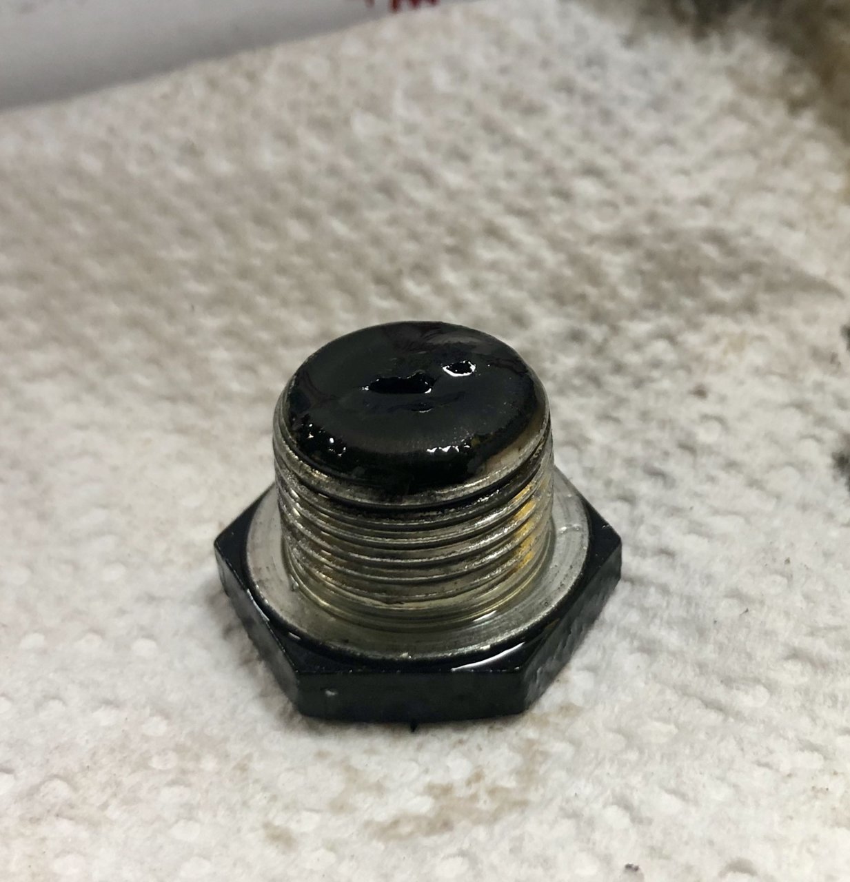

    I also decided to change my rear diff fluid at 25k miles with Lucas 75w-90 GL5 full synthetic. I read the ECGS document and did some other research, and decided to go with a high quality full synthetic GL-5 gear oil.
    The magnetic drain plug had a big ol’ glob of very fine metal shavings, which after only 25k, less than half what Toyota recommends, and having only gone off roading twice, was a little surprising.

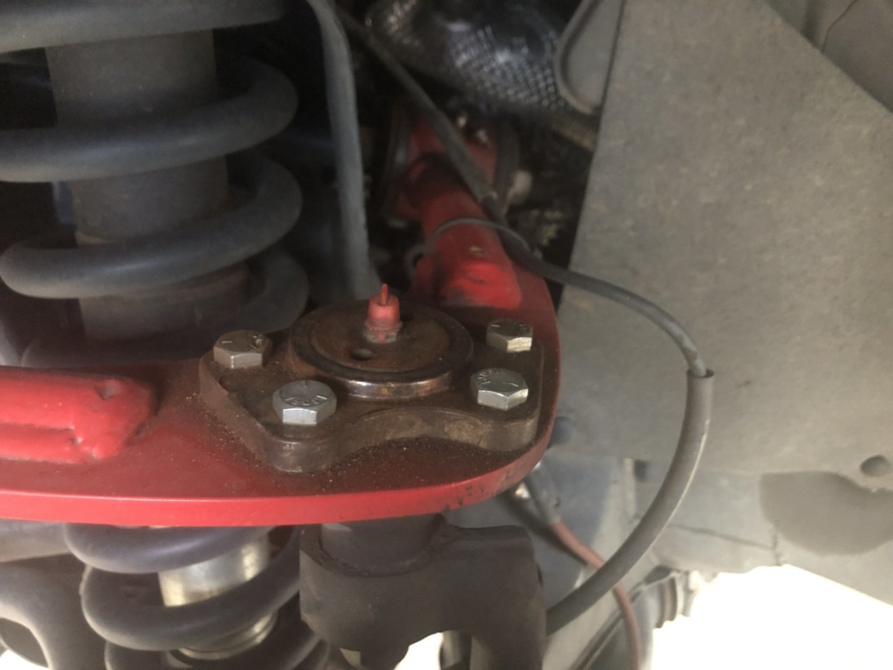

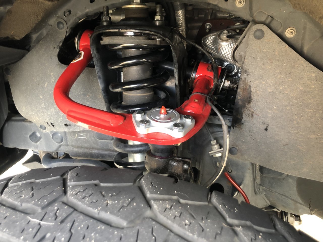

    I finally got a chance to pull apart my front suspension the other day. I had to replace my rusted JBA ball joints and install extended top hat studs & wheelers spacers.
    First I replaced the JBA ball joints. When I purchased my UCA’s in early 2018, I did so right before they switched from clear powder coat to silver Cerakote. The clear PC did not hold up well at all. Cerakote is a very durable and high quality coating used for firearms among other things. These were covered by JBA under warranty.
    BEFORE
    AFTER
    As you can see in the after pic, due to my suspension sag and my not noticing/getting an alignment again, my driver’s side tire is wearing badly on the inside. A little bummed about this but I’m hard on tires so I rarely get 3yr out of them.

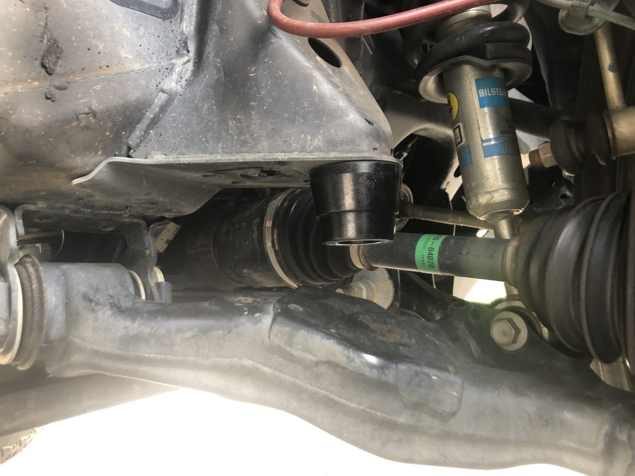

    Next, I installed the Wheeler’s poly spacers. Initially I was gonna install 5/8” on driver side and 1/2” on passenger side to get me to a full 3” lift and account for “driver side lean”, however I was concerned that I may push CV angles too much.
    Therefore I decided to use a 3/8” spacer on the driver’s side and 1/2” on passenger side. This was perfect! After driving around for a day, hitting a few bumps to help everything settle, I’m just shy of 3” lift and side to side difference is under 1/4”. I’m back to being almost level front to back with similar tire-to-fender gap, which is what I wanted.
