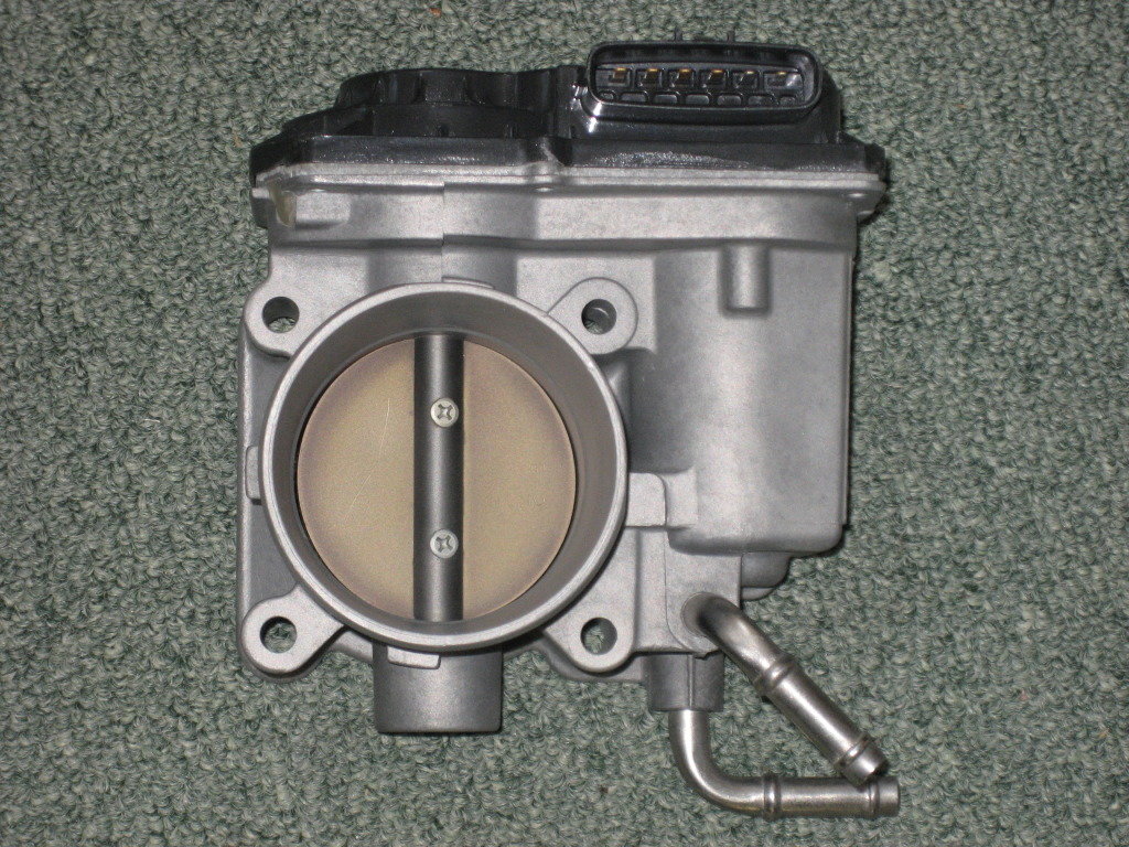

    So this is both the MAF and Throttle body?

    No, that's just the MAF, and it isn't the Jet model that fits your truck. I couldn't find an exact pic. Your throttle body looks similar to this...
