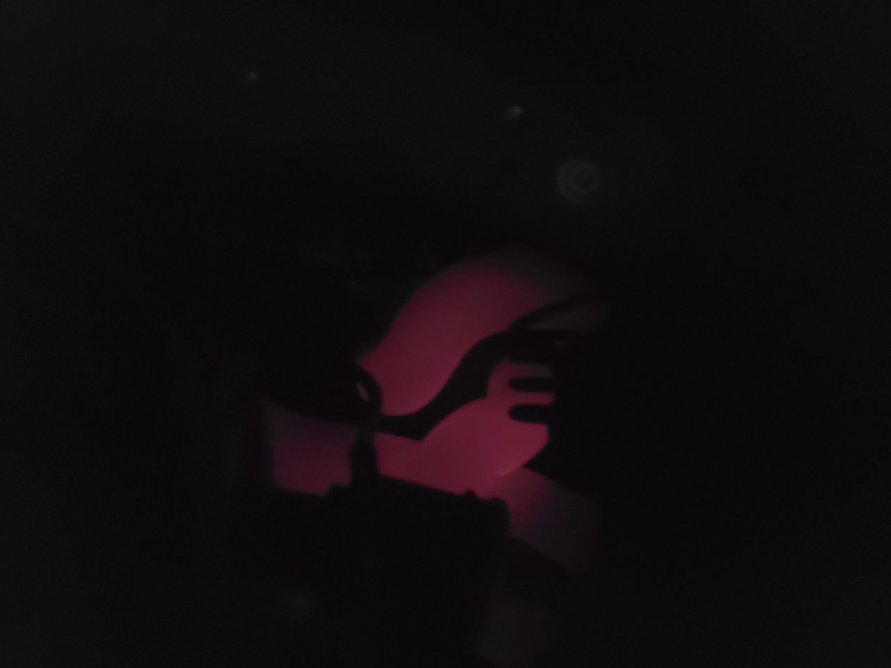

    Here is a pic of the Spec-U header at night looking through the fender after running parked at 2500 rpm for 10 to 15 seconds. I looked in and saw it glowing so hopped back in the truck with camera ready so I could duplicate the condition.

    Yeah I watched a video where they used a laser thermometer to measure how much the ceramic coating changes the temp. Very cool stuff, that pic is badass!

    Annnnd whyyyyyy were you parked running at 2500RPMs? Experimental purposes only?
    I have one of a glow to share. :D
    https://youtu.be/O7-ZylA7Nuc

    Actually yes. I think I was messing with the stereo so it was idling for awhile. I don't like shutting it down after just idling a long time so I give it a little rpm for a minute or two before shutdown. Then I was feeling for my electric fan on how much it was blowing through the fender area and saw that.
    That is an awesome video. Truly shows how hot cats get!

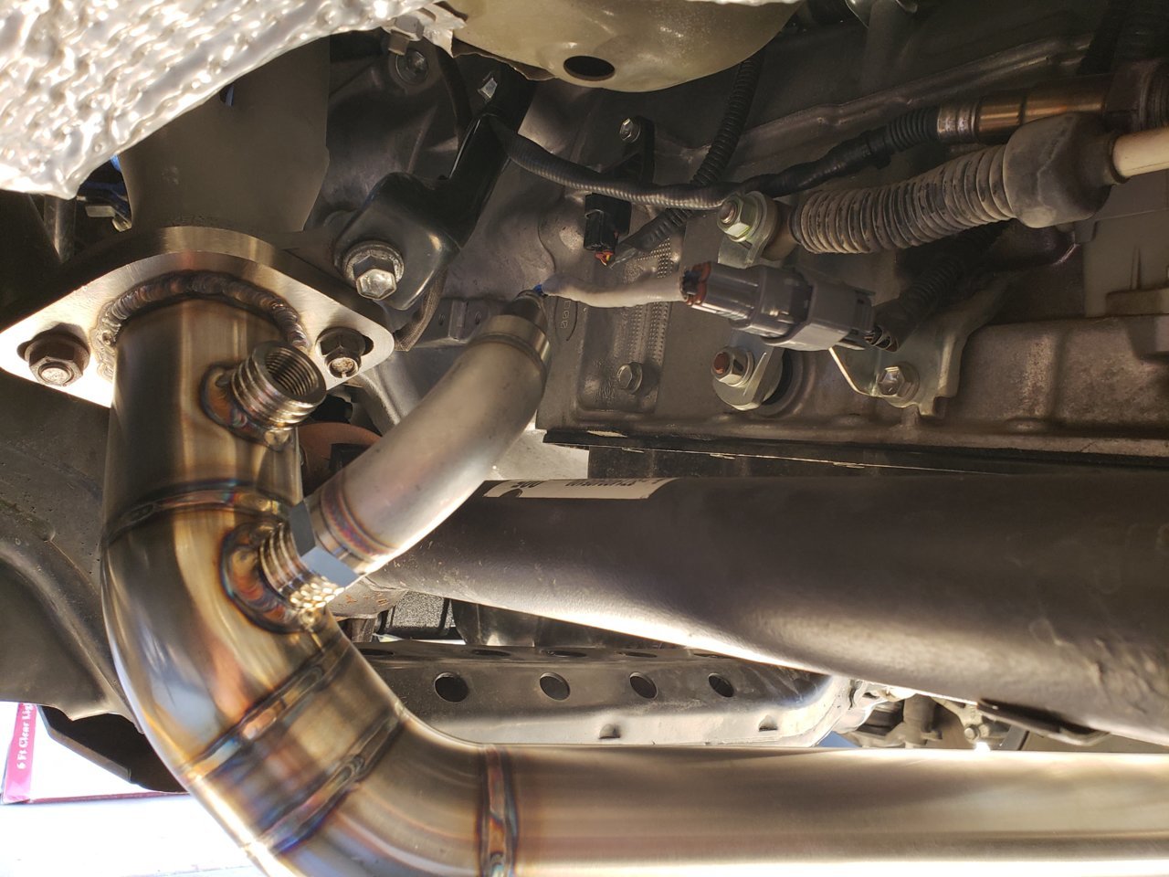

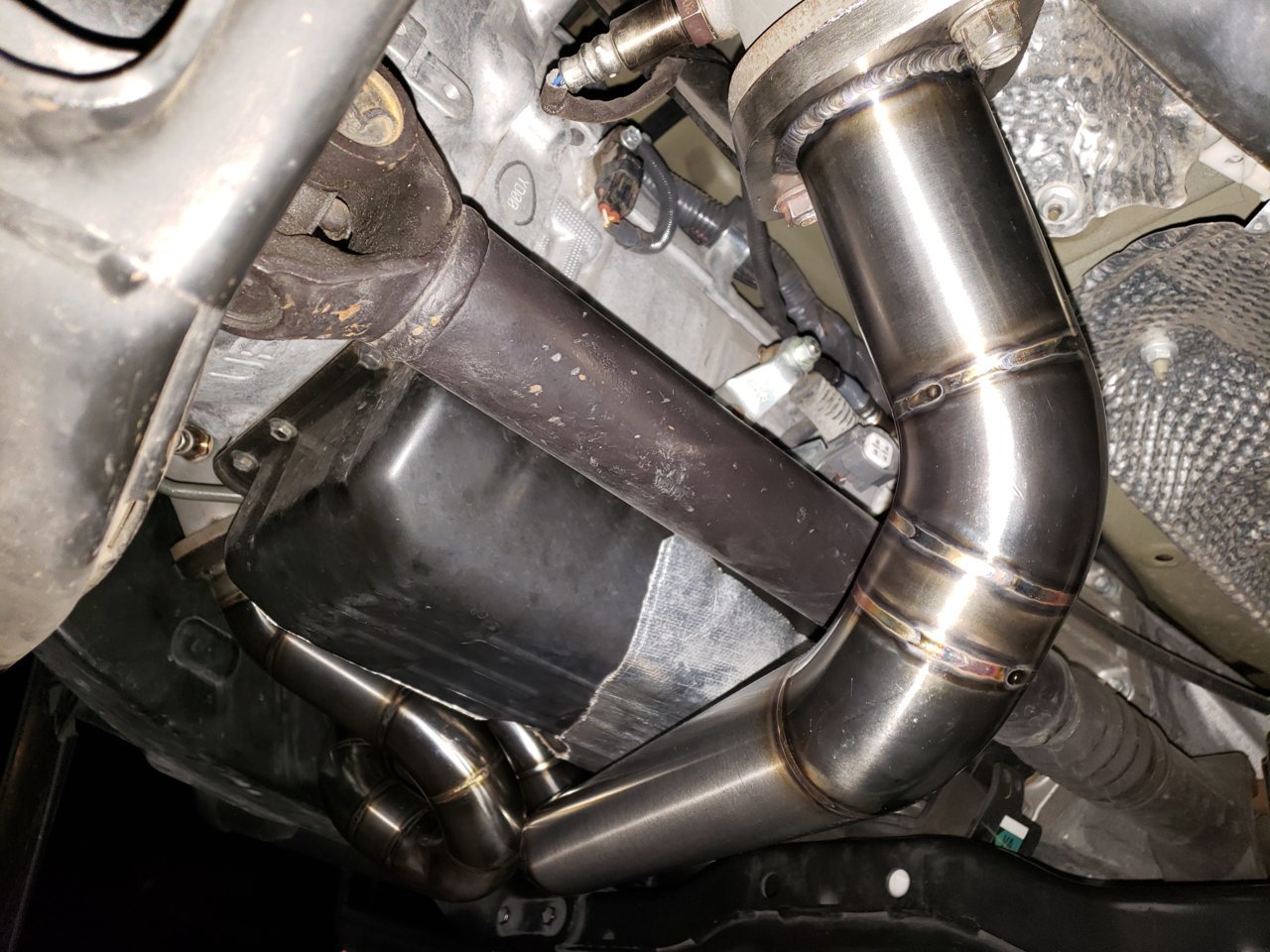

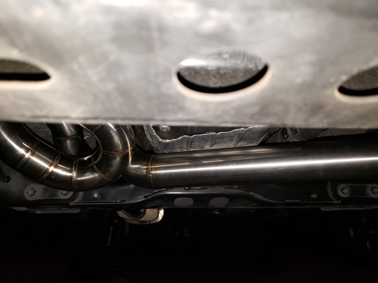

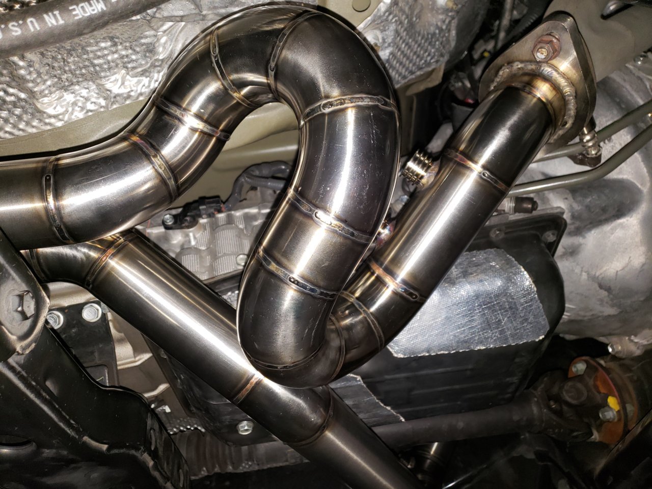

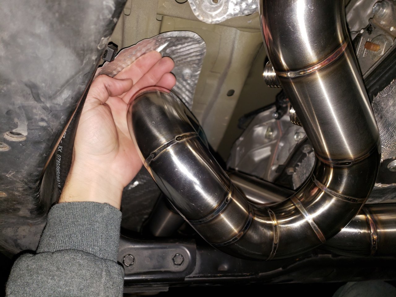

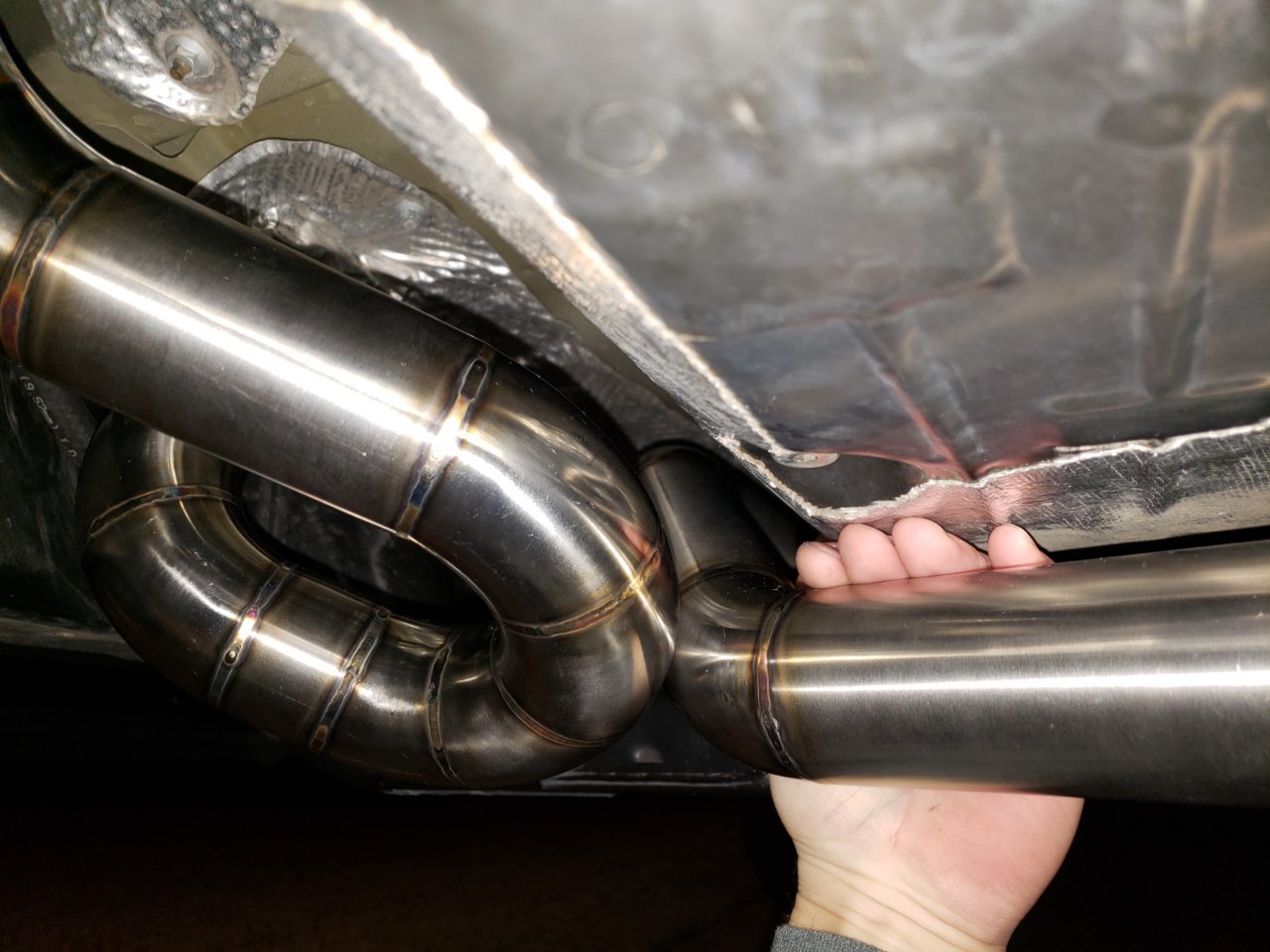

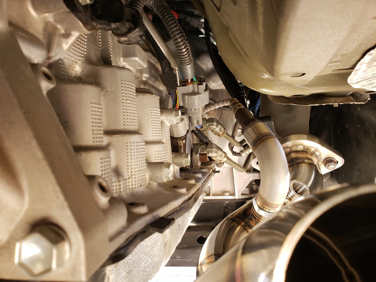

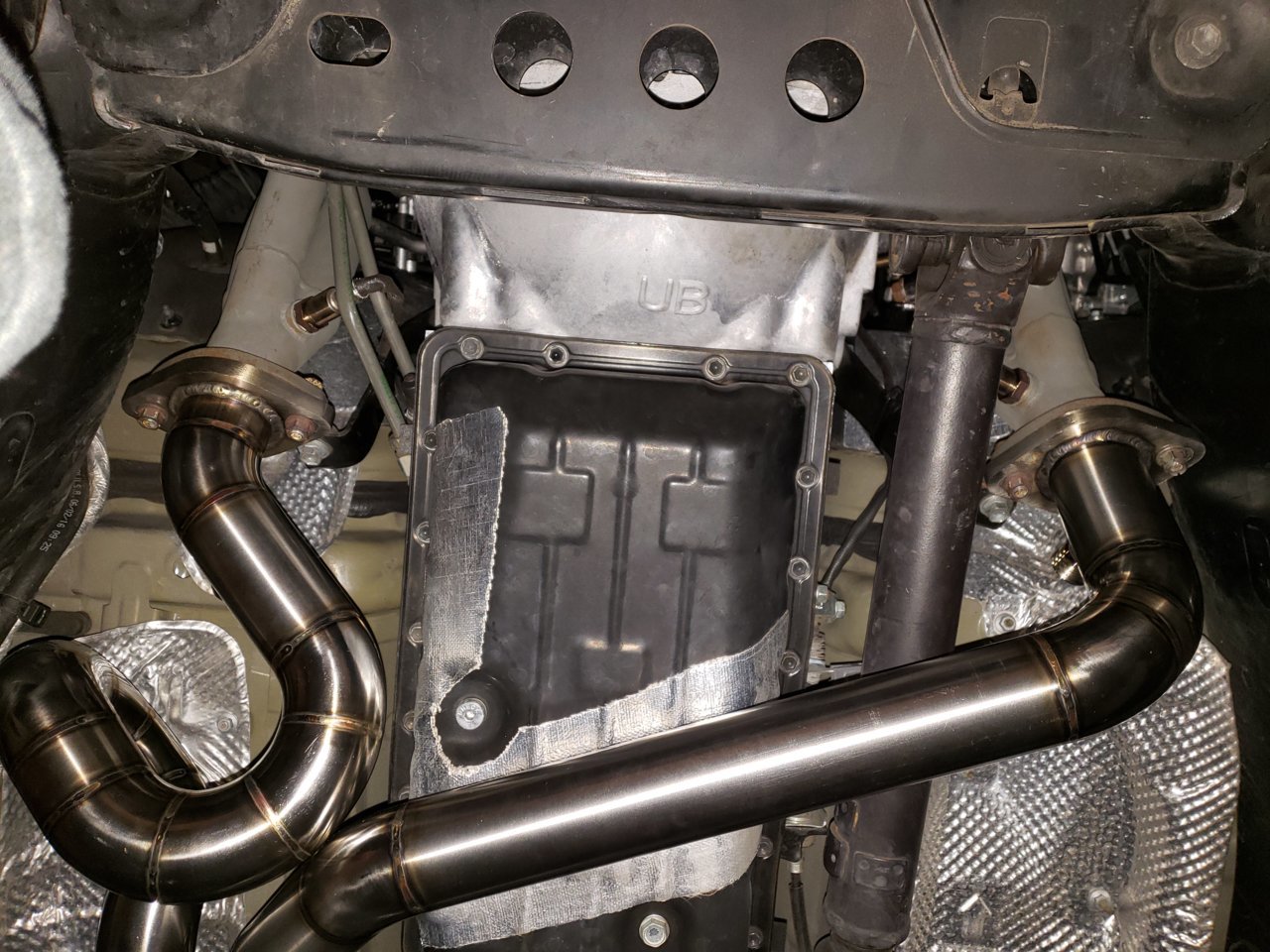

    @Stryker420's y-pipe almost finished. Just have to make a hangar and weld a brace in. Then attempt to figure out how to make a jig for this thing.
    The area around the front drive shaft contoured to allow room for the larger diameter T4R's shaft.
    I didnt measure but there is about .5 to .75" of clearance to the trans pan. I ran it high like this to allow as much space for skids as possible.
    A good shot of the "all 45° bend" option and access to the trans drain and check bolts.
    Plenty of space between frame and body to pipe.
    Tucked!

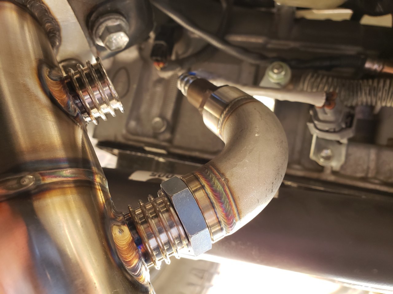

    O2 J bung adapter drivers side. You may have to bend the bracket at the trans to allow more room. This is positioned to best work without an adapter but the adapter and O2 will fit.
    Here is a good pic showing how bending the bracket forward will allow slack in the O2 sensor harness.
    Passenger side with J bung adapter.
    All for now,
    Roost

    JacksonTacoma
    JacksonTacoma Well-Known Member
    Jul 25, 2017
    #224953
    1,185
    James
    Jackson, MI
    2015 S/C TRD Pro
    Magnuson SC, 2.5 pulley, hptuner, FPR mod, AFE Intake, URD longtube headers, JFR Y-pipe, 255 Deatschwerks, 76mm TB, Banks 3" exhaust, cam gears
    Well done Roost! Another one bites the dust.
    :thumbsup: on the j-bung fitment as well.

    Thanks Jack! Not quite yet. This is the template for a jig if I can make one that will work.
