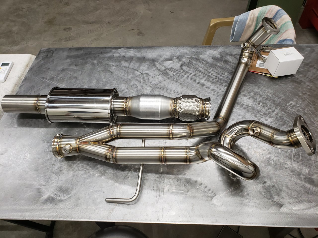

    Happy 2021 peeps!
    #26 complete and will ship Monday.
    Now to figure out the x-runner hanger ordeal for #27.

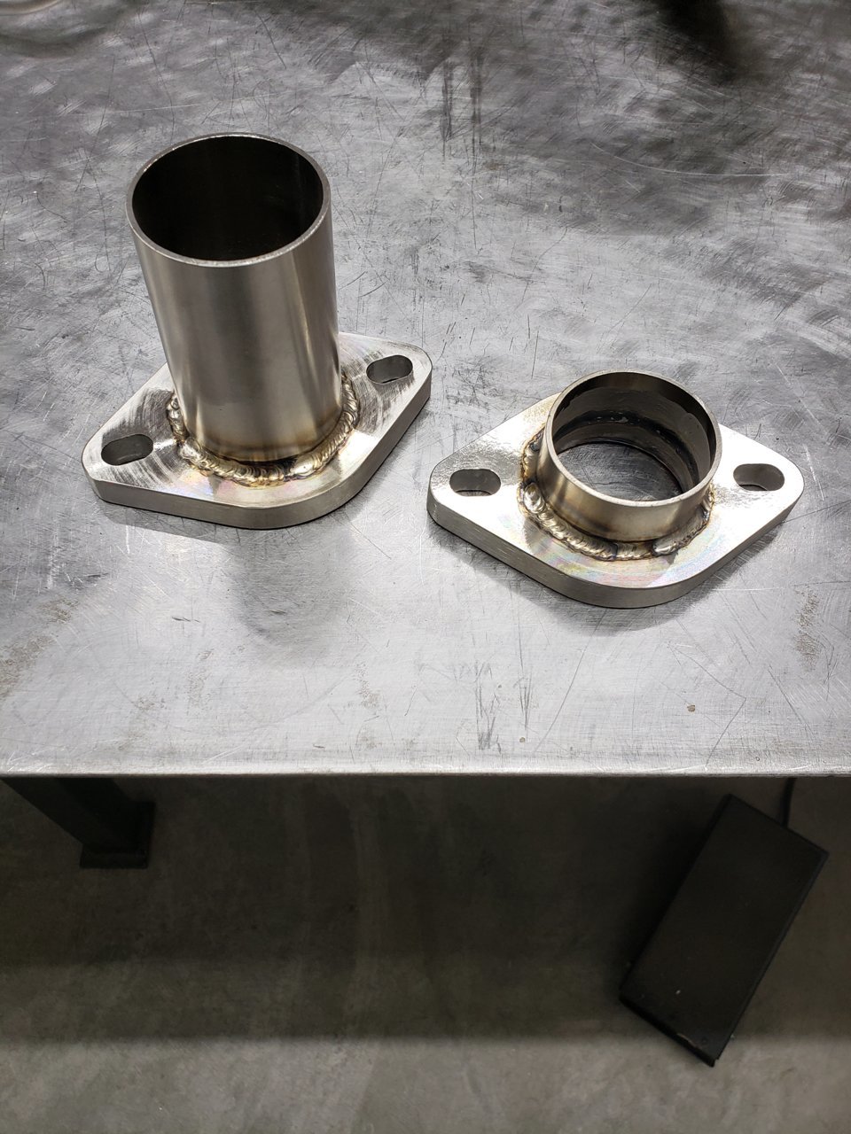

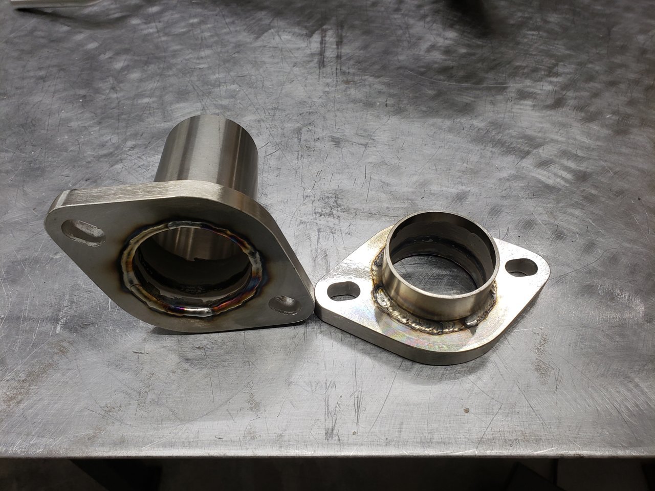

    Yup! Here's your nubs.
    Of course flange face wi) be sanded.

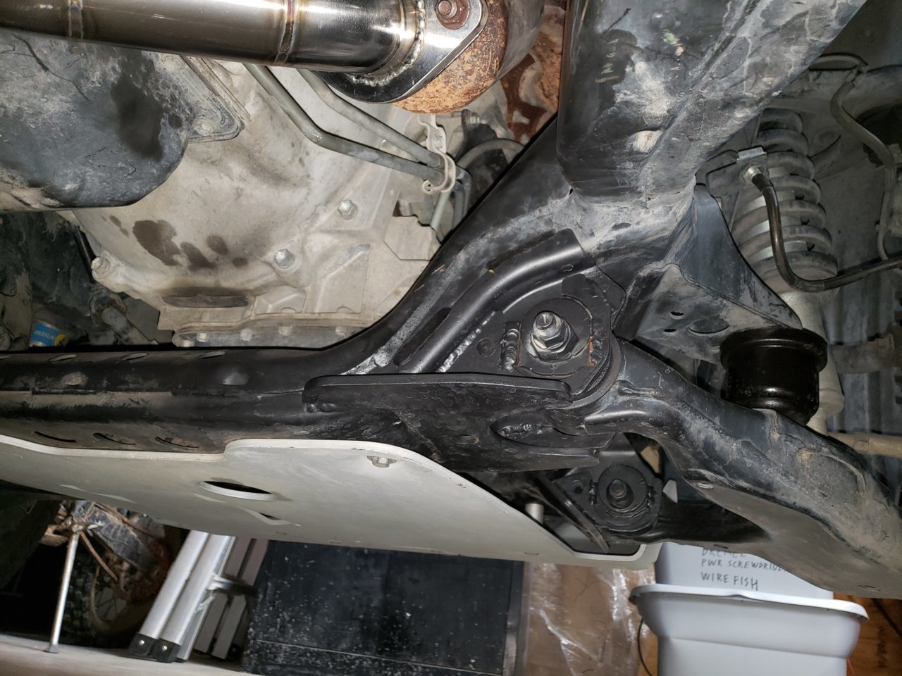

    Do I remember reading somewhere a while back that the Marlin crawler gussets get in the way of this downpipe?
    Has anyone installed this with both the gussets and full set of skid plates ?

    Here it is

    Ah, like there’s not enough room for it to be maneuvered into position. Gotcha.

    If you have a hanger welded on. On mine we relocated it further down the cat back.

    This is correct. Since you have to install the y-pipe from the front, the merge collector and hanger have to slide up and over the crossmember. The front flanges wont clear the aftermarket gussets IF the y-pipe hanger is installed.
