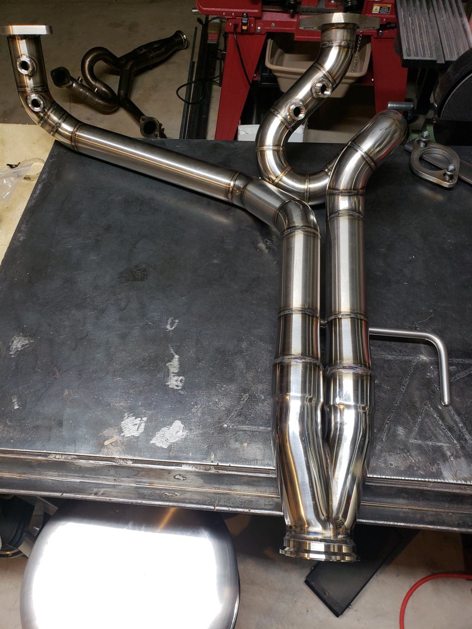

    I have thought about mimicking the truck but I should be able to cradle an existing y-pipe to make the jig IF I can make the cradle precise enough. That is the biggest factor.
    People (including myself) dont/didnt realize how a 2° rotation of one bend effects everything tremendously. This means the jig has to be perfect! @loginfailed and I saw that first hand building his and a couple others have seen since. I know @rjbiii has because I finished building his while he was at my house. He saw the back and forth checking every joint on his truck. Probably 15 trips back and forth just to finish his. Probably at least double from start to finish.

    YES, i can attest to this.. Back and forth so many times..

    To ensure fitment.

    Totally worth it, but goes to show how perfect the jig needs to be!

    You just need to jig the critical points like the flanges, end point and where the pipe is close to crossmembers

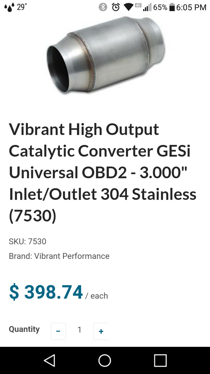

    Amazing, absolutely amazing. I just ordered some 3" SS exhaust tubing in 1 foot lengths. I am going to finish the rest of the welding myself. I have a very good instructor so it should turn out "titties and beer". Take your time with the jig Roost. I am in no hurry and I don't want you to feel rushed. You are the man!

    I have used the ceramic core ones before, and still needed to used a sim with it. Cats aren't sought after by the unscrupulous, for their ceramics. They want those Precious Metals.

    Thank you! That may help but the biggest issue I see is due to all of the compound bends if I'm off slightly in any one area it throws everything else off. It wouldnt be a big deal if I was just making two pipes terminate at the same point but keeping them equal lengths AND a specific total length is what I am most concerned with.
