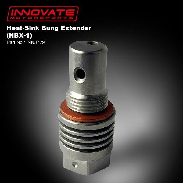

    No problems at all. I have read on the Innovate instructions that you have to have the sensor flush with the exhaust and not protruding into the exhaust path. The O2 bungs I use are the correct length to do just that and the fact that they are finned helps to keep the sensor slightly cooler which most likely helps with longevity.

    Mine sit in the stream a little. I have occasional issues with one of them. I just picked up a pair of these to try out, but haven’t installed them yet.

    Those are pricey aren't they?
