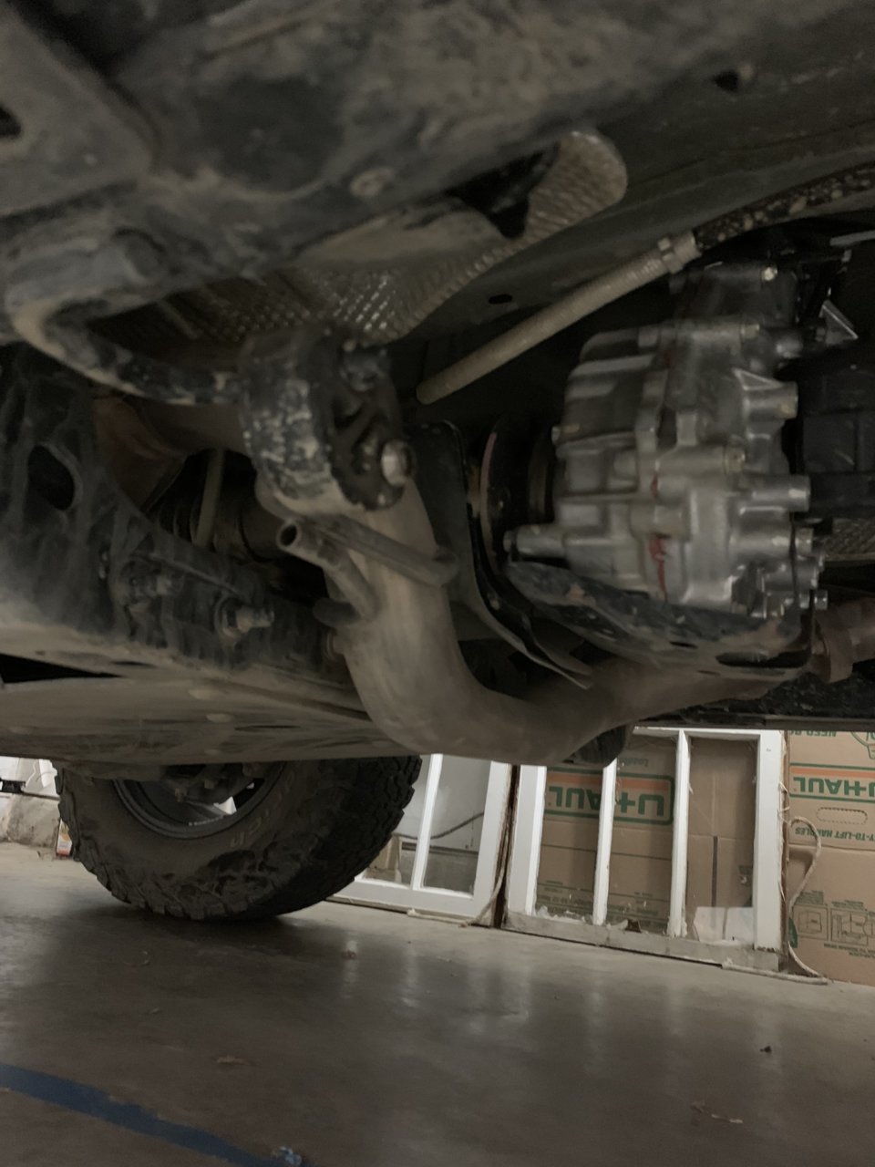

    This part here sir.

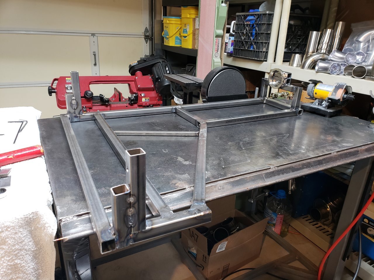

    Ahhh, the old factory underhang. I dont have any 1 3/4" or 1 7/8" tubing or whatever it is. Realistically your best bet is to just come on out for mod day and if I have enough time and the right material (never done a third gen) I just make an equal length y-pipe for you. We can talk payment via PM if you want.
    I have no idea what all the engine specs are though for the third gen. To make the optimum y-pipe I need all of the specs to calculate tubing diameter and length. Info needed is:
    Bore
    Stroke
    Engine "V" angle
    Firing order
    Intake and exhaust valve diameter
    Intake and exhaust valve lift
    Average cam lobe separation angle (variable cam timing)
    Exhaust manifold length
    Desired most effective rpm range
    That's just off the top of my head. Some parameters are a given like # of cylinders but the rest we have to find.
    Let me know what you want to do.
    Roost

    I dont know what I'm doing so I'm building it so I can duplicate the y-pipe. Probably way overkill for a seasoned jig maker.

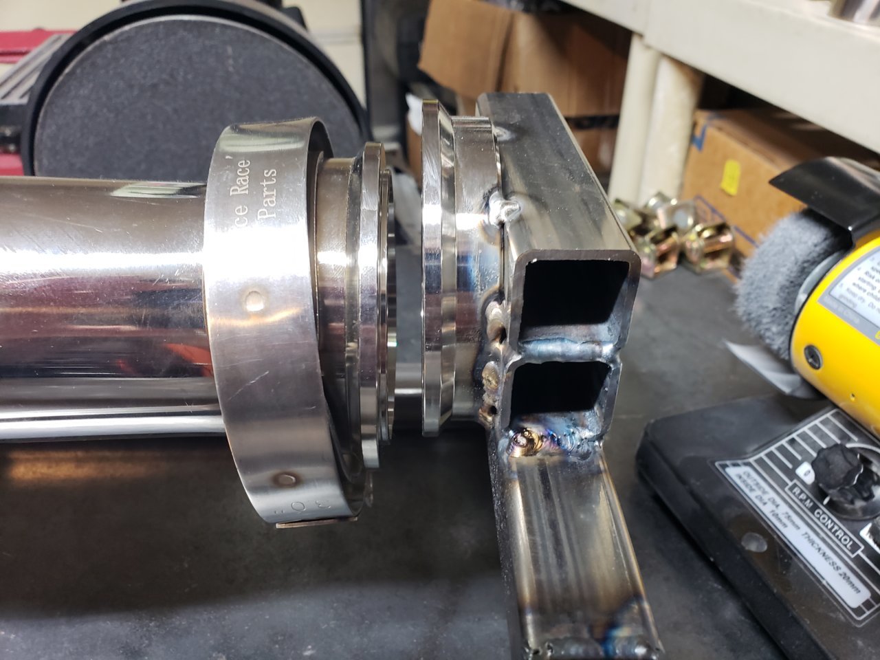

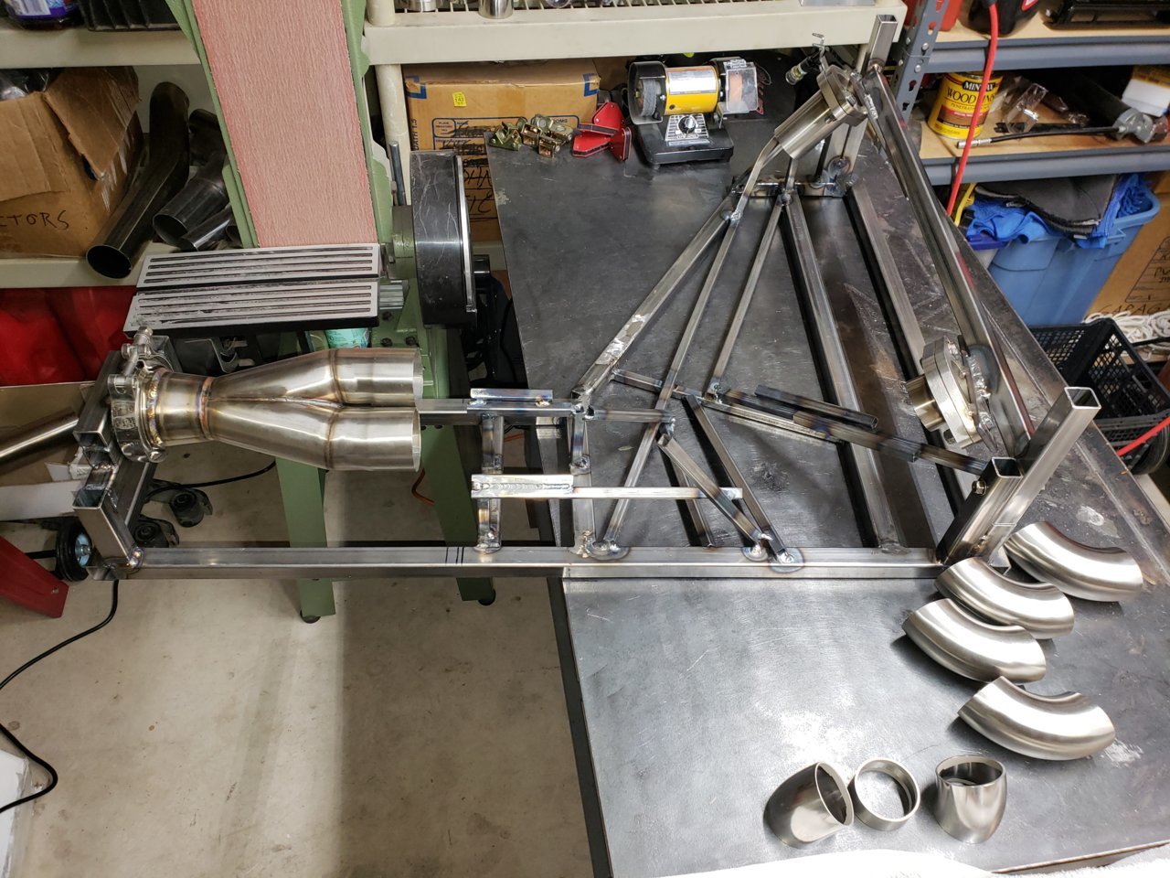

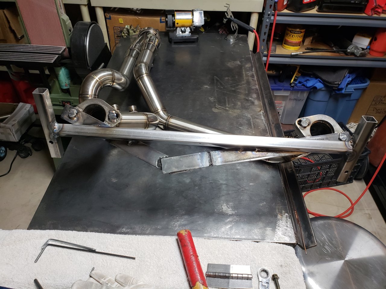

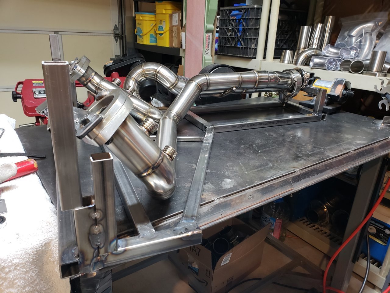

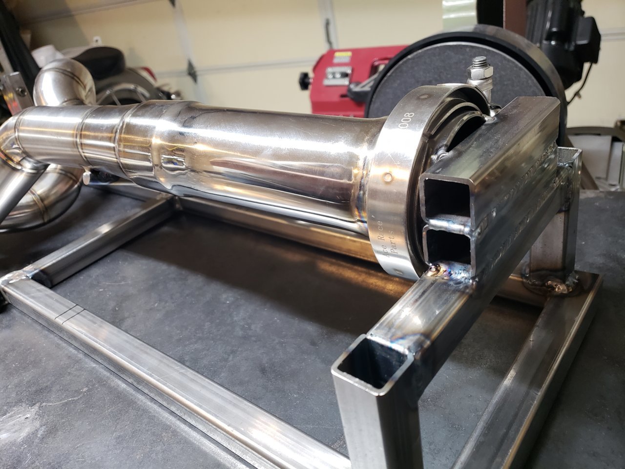

    So this is the erector set. Hard to tell all the angles in the pictures but there is a lot.
    This is the beginning of @Biscuits y-pipe. It is the test pipe to see if my jig works.

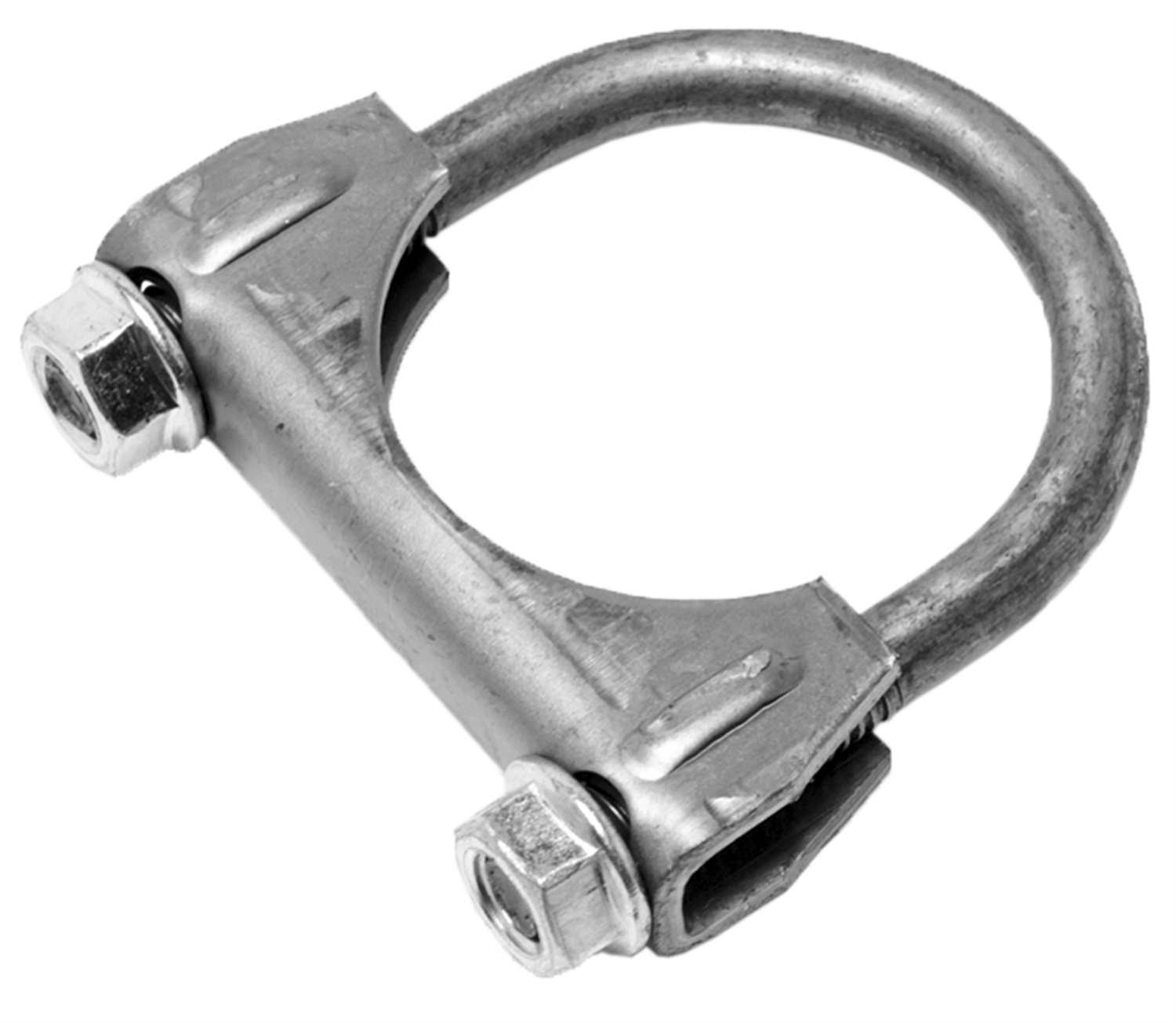

    not sure if it helps but ive seen jigs use those exhaust band clamps before

    The butt clamps?

    whatever you want to call these
