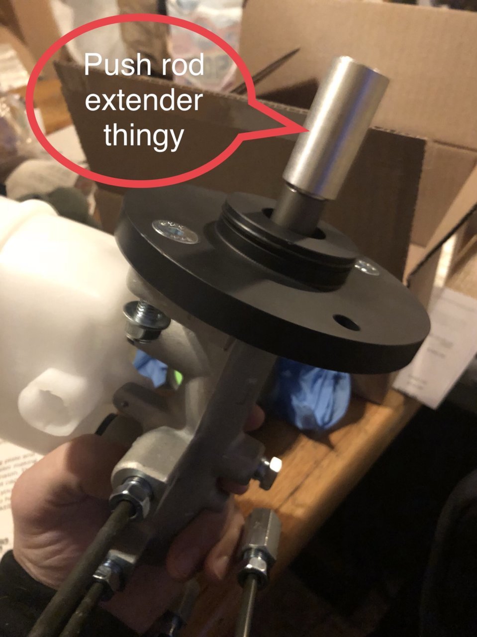

    You got to make an adapter plate and a lil vacuum booster pushrod extension thingy...I fit a nice 1" 1/8" bore wilwood one mine works good

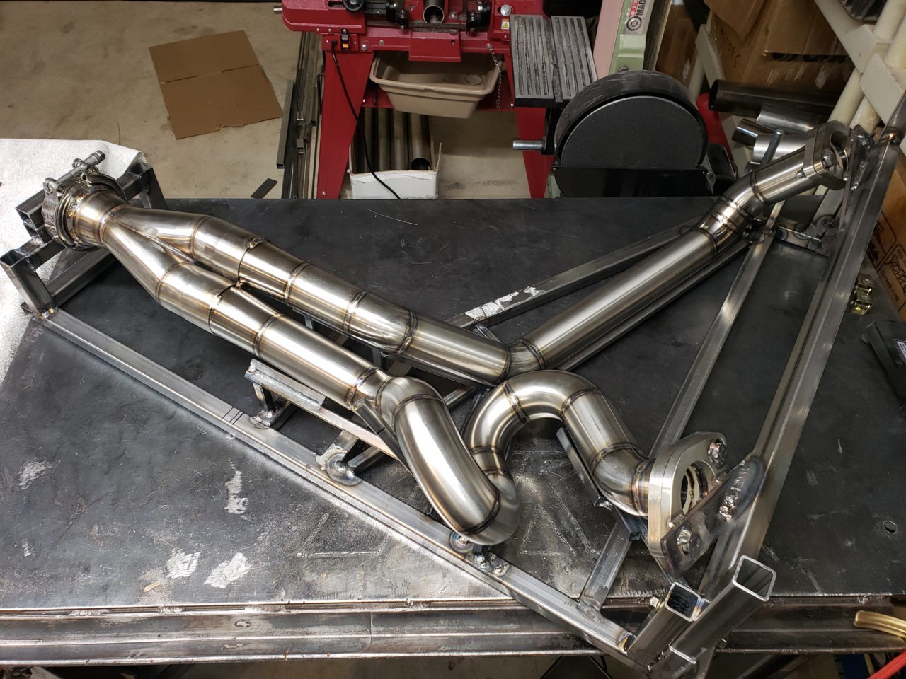

    Making progress on @Biscuits, y-pipe.
    Had to add a few pieces to the jig to ensure correct tubing placement.
    This one will be test fitted to my truck to confirm the jig, then I should be able to make these in two days or less.
    I still only have enough flanges for two more y-pipes right now but may have them made locally either by water jet or Plasma. There are only a couple places that have 1/2" stainless 2 1/4" flanges online and they are out of stock until most likely January.

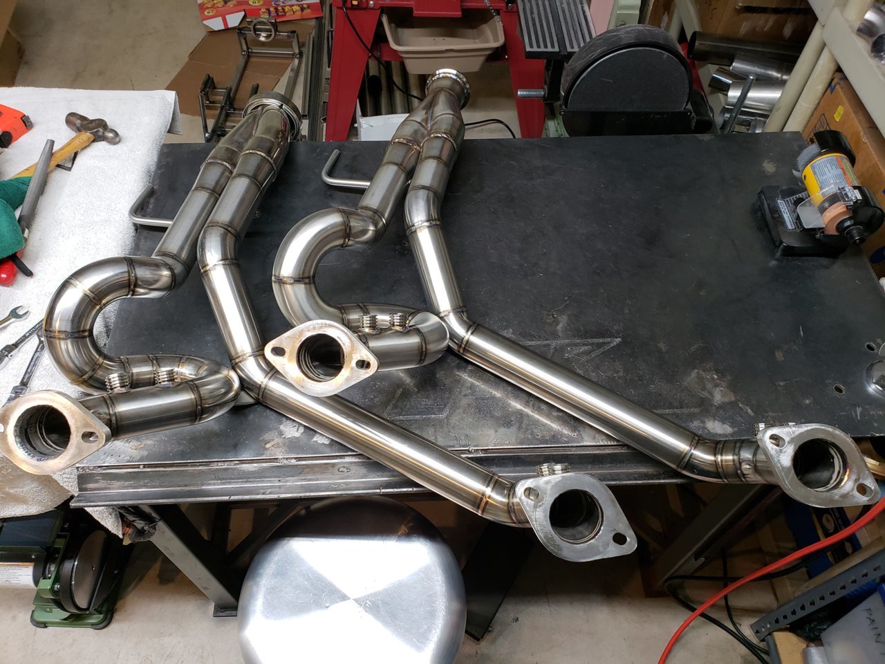

    Making progress! Just finished @Biscuits and have started @Wild Heart's. The two shown here are #8 and #9 of @Stryker420 and @Biscuits.
    Tomorrow will be checking fitment of @Biscuits y-pipe on my truck for jig verification then continue on with @Wild Heart's build. I am also waiting on a quote from my local metal supply to have 1/2" 2 bolt stainless flanges water jetted. I'll call them tomorrow if I havent heard back from them. I have enough for 2 more y-pipes but have been checking my regular source for over a month and they have been out of stock.
    I am expecting more boxes to come in tomorrow to see if I can package these any easier than the ones I've already shipped.
