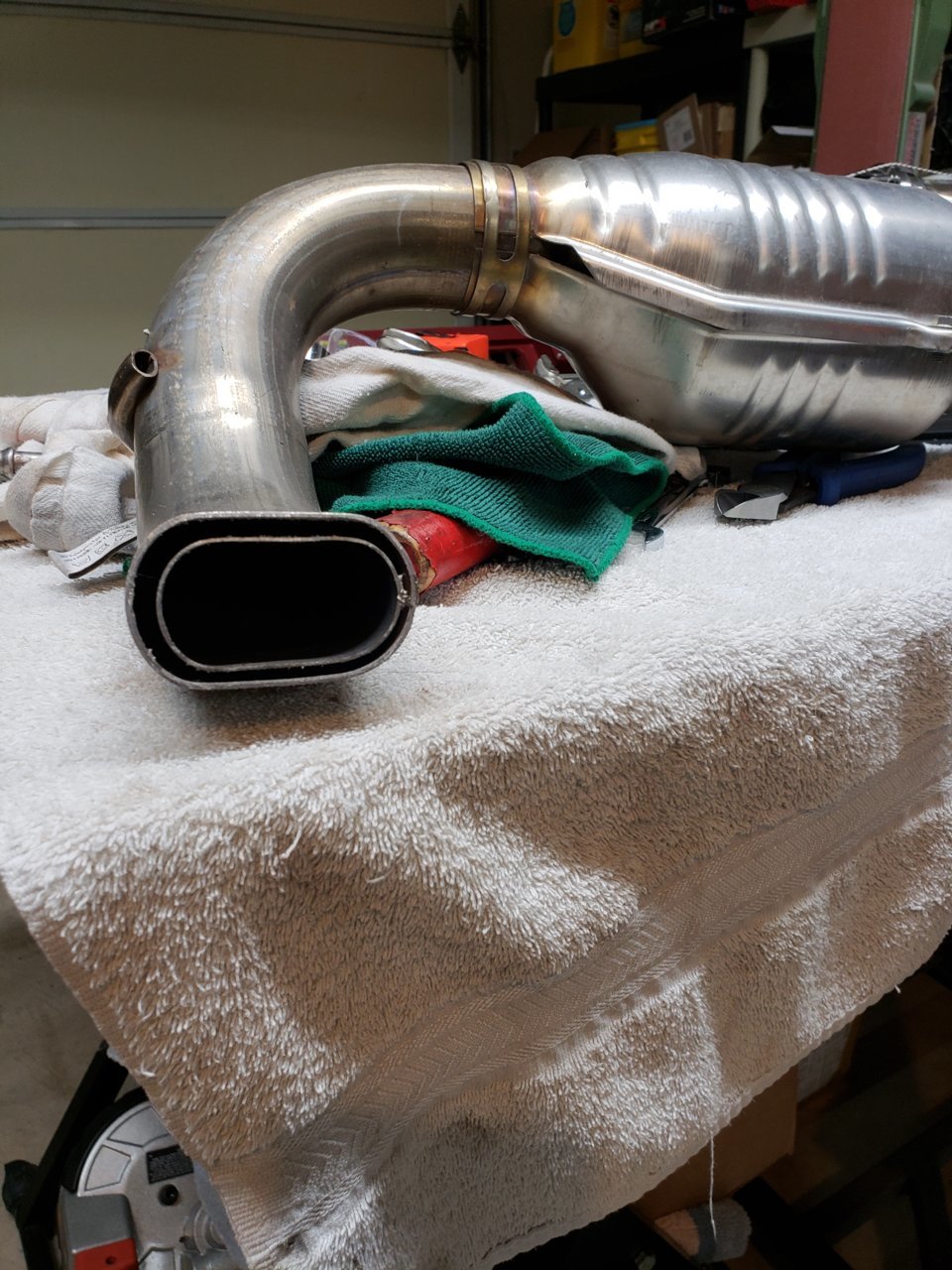

    The stock y-pipe is restrictive because of the cats and tubing diameter, not the crush bend as is commonly believed. The tubing is the same diameter at the crush portion, just ovaled. Here is a pic of mine that I cut because I was curious.
    The gains from my y-pipe are obtained through optimum tubing diameter, specific equal length, and REAL merge collector.

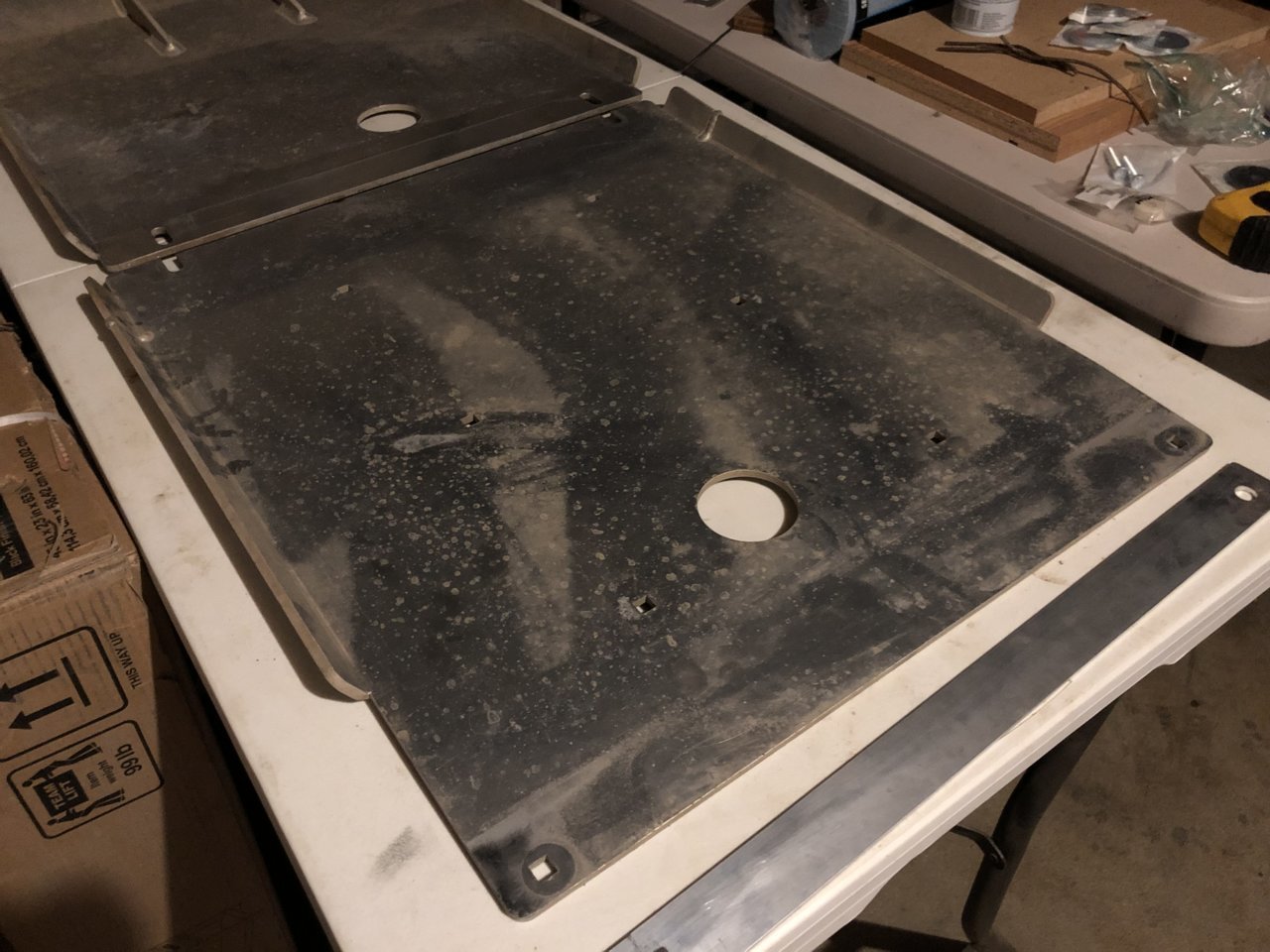

    I’m thinking about swapping the 1142 for a 12249 to see if it makes it a little quieter.

    It would if you can fit it in there.

    The body is 18” long and it looks like it will fit if my cutting and welding is precise enough.

    Does it lay flat on the trans side or is there reinforcements on that side? If it’s flat you should be good. Pick up a couple washers to space it where it mounts up with the ifs skid and mine fits with room to spare. F0D086FD-8B48-4FCD-9FA1-D48CAEBE28A5.jpg
    This is how mine looks. I made spacers that you shouldnt need to make if your headers are not jacked up.
