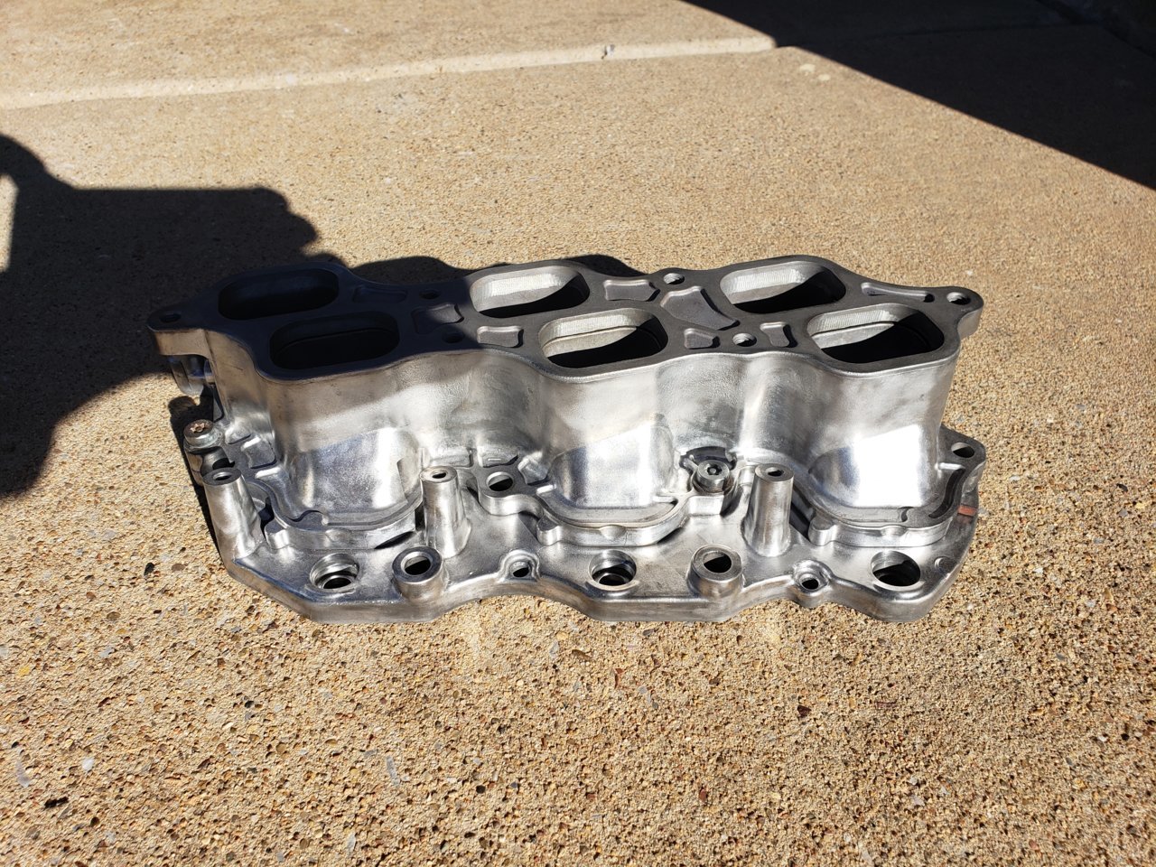

    I may have a ported lower intake manifold ready for someone to swap out. $350 and I get the core.
    This manifold is cleaned but not ported.......yet.

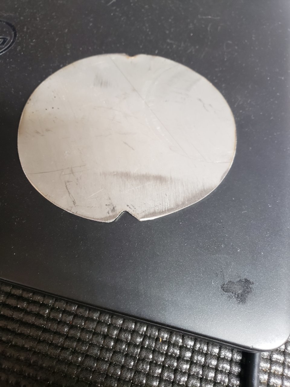

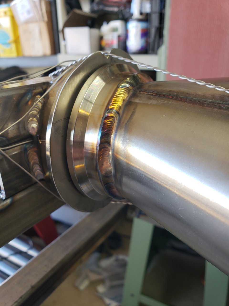

    So something I totally missed when building the jig is I welded on a 3" v-band. Now I'm working on a 2.5" merge collector but cant mount to 3" vband.
    Solution: fab up a thin shim and safety wire the merge to the jig.

    you dont typically want mirror finishes on the intake side of things
    Roostfactor[OP] likes this.

    True anywhere after fuel is introduced. I think he is talking about his throttle body though.
    My saying is shape over finish when it comes to ports.
