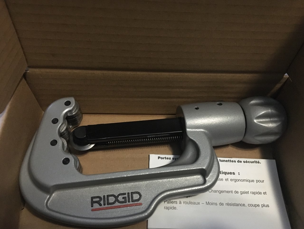

    This arrived yesterday:
    :sawzall:

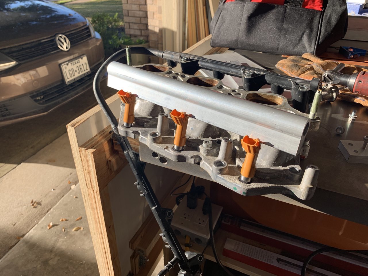

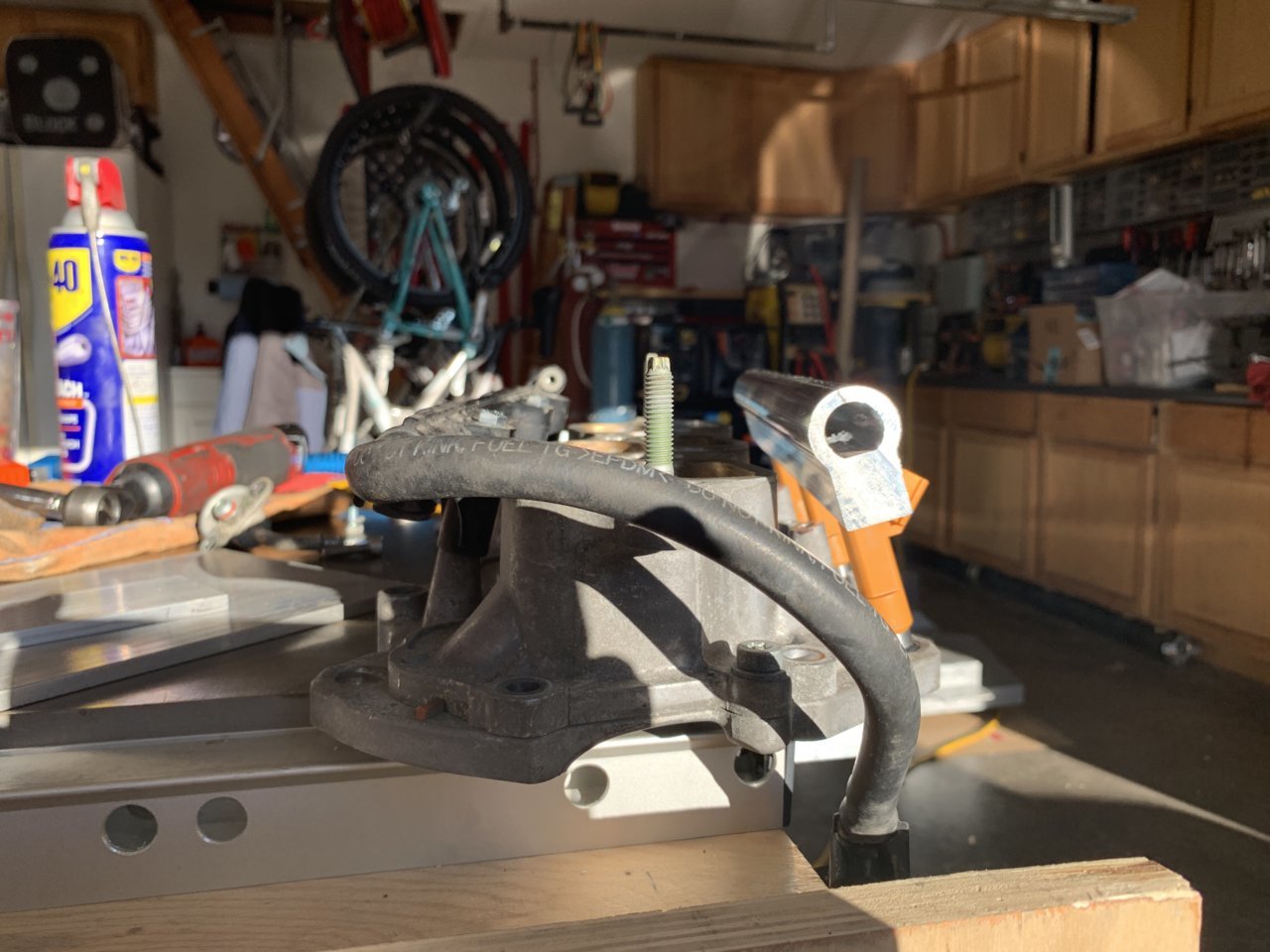

    So are we still doing injectors? If so, it will be a good time for me to check clearance for my DIY fuel rail.
    After adding the bottom injector o-rings to the manifold, the new rail sticks up about 1/4”-1/3” higher than stock. On the passenger side it won’t be an issue. But driver side under the supercharger might be cutting it close.
    If we are pulling your blower off, I can sit my spare manifold with the rail on top and check. If it won’t fit, I’ll have to mill 1/8”-1/4” of material off the bottom of the fuel rails.
