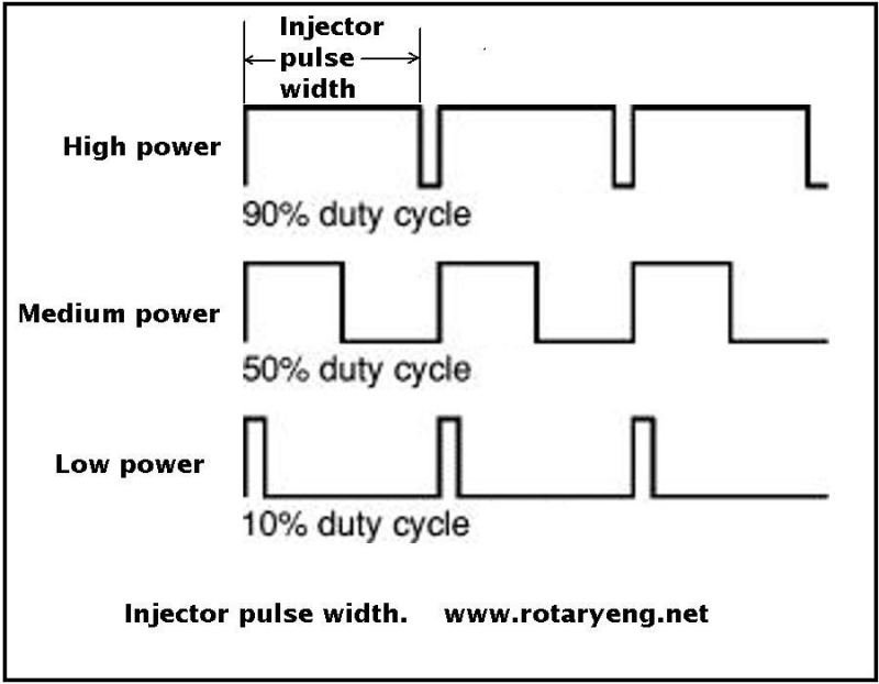

    The two most common means of measuring injectors ON/OFF time is injector pulse width (IPW) and injector duty cycle (IDC). Injector pulse width is the time in milliseconds that the injector is open and injector duty cycle is a % of time the injector is open in a complete 4 stroke cycle.
    In both cases a larger number means more fuel is being used because they both represent the amount of ON time of the injector.
    So if you are at a no load idle and turn the ac on, both the IPW and the IDC will increase as they are both a measurement of ON time.
  10. Jan 21, 2019 at 11:38 AM
    #750

    Ahhhh, gotcha i had it completely backwards then. I thought IPW measured the time they were off. That's much clearer now, thank you sir!

    No prob. Here is a chart for a visual reference.

    Very good chart, saving for future reference
