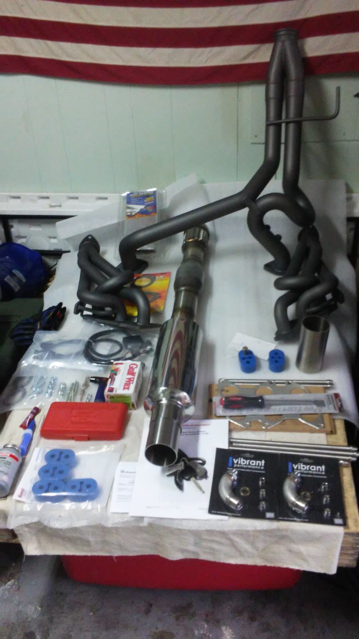

    Late start, but I'm beginning a header install.
    I may have to throw out a lifeline soon... :notsure:

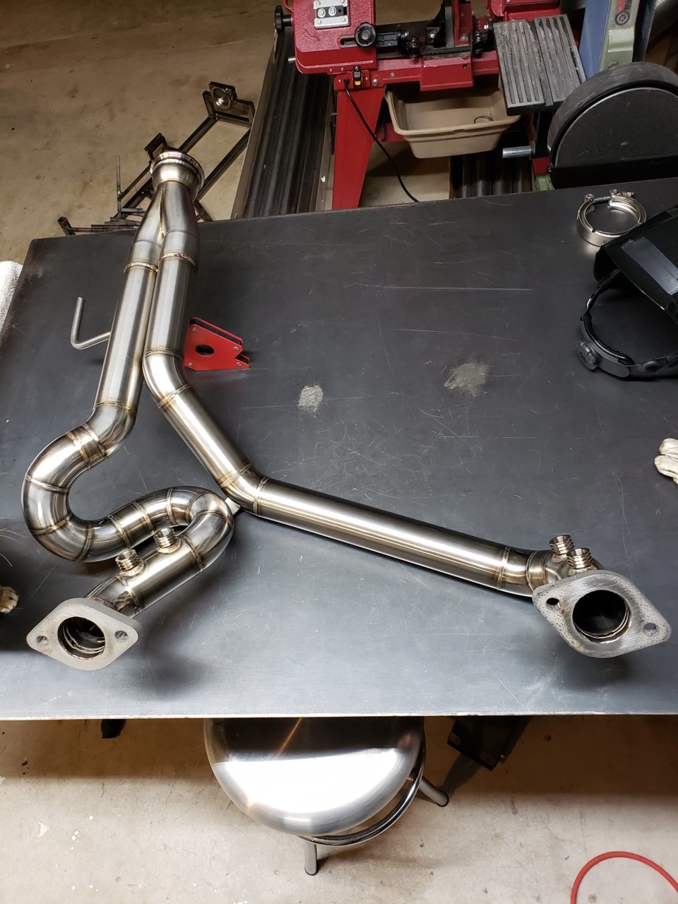

    Sweet! One step closer. @Basikbiker should be stoked. New y pipe should compliment his recent work on his back half. Looks sweet! Congrats.

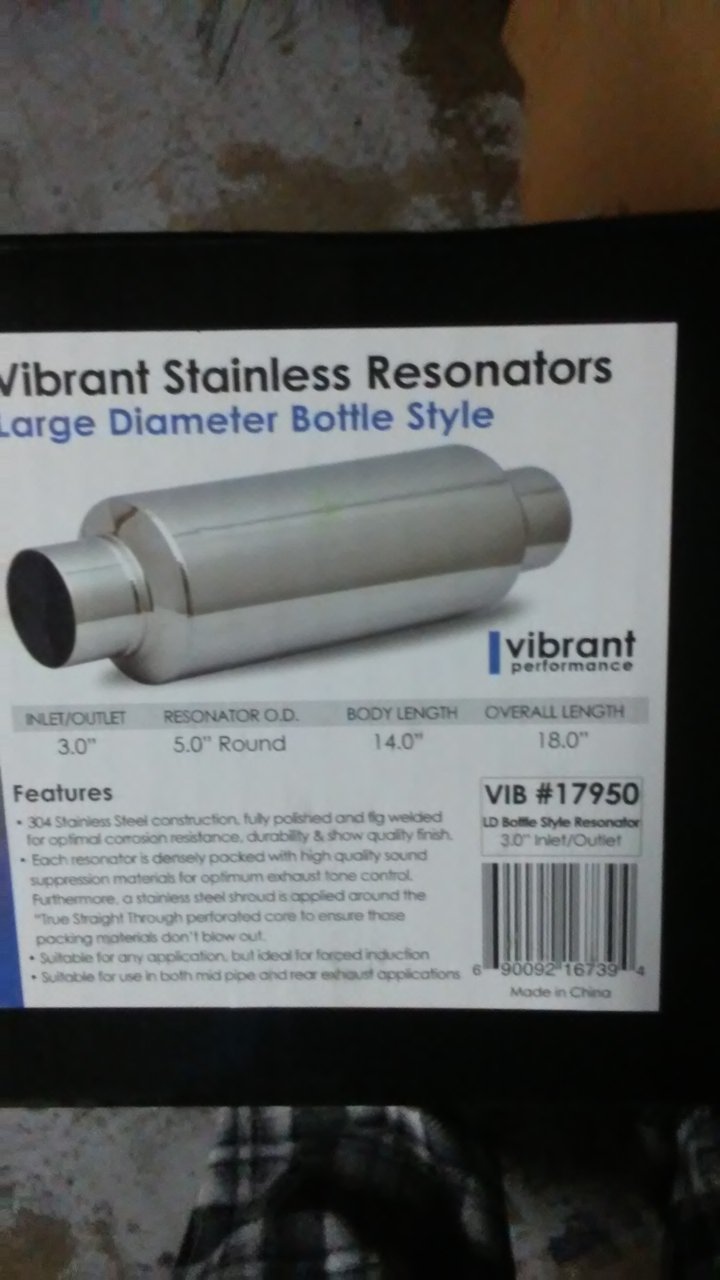

    2012 Tacoma DCLB
    Ok so I ran into something that is critical to keep all exhaust above frame... 23" rearward of the v band from y-pipe to rear section, the exhaust should angle at a 45° upwards. This is key to keeping the bottom of the resonator above the frame. Mine is .5" lower. So now I have to cut off my freshly welded on resonator... Then design a new section. I welcome the challenge and just wanted to share my findings.

    2014 DCSB 4WD
    What resonator is that you’re using?

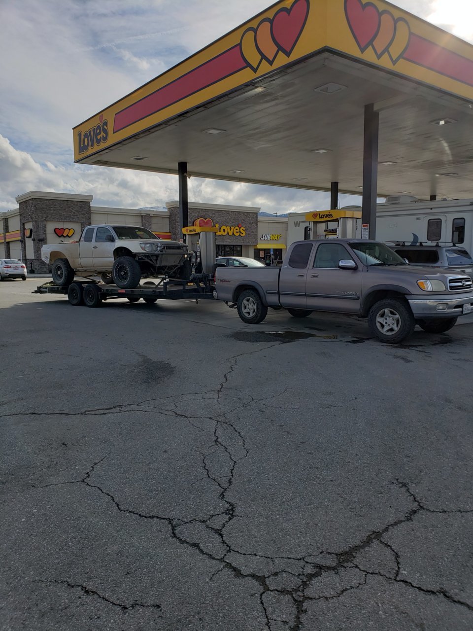

    Thanks man!!! Zaust looks soooooo sweet! Perfect timing broke a hanger off my current one today along with a steering rack....hard parked on the trailer for now lol

    2014 DCSB 4WD
    On my rear section, I did a similar setup and I can’t fit my resonator there either without modifying the exhaust. I’m using the Vibrant ultraquiet. It’ll fit before the muffler, but I’m considering putting it after the muffler instead.
