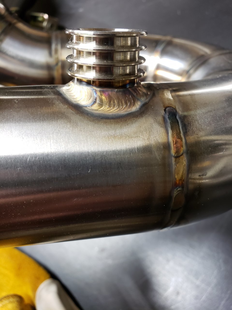

    A little eye candy.

    Finned for her pleasure. I like it.
