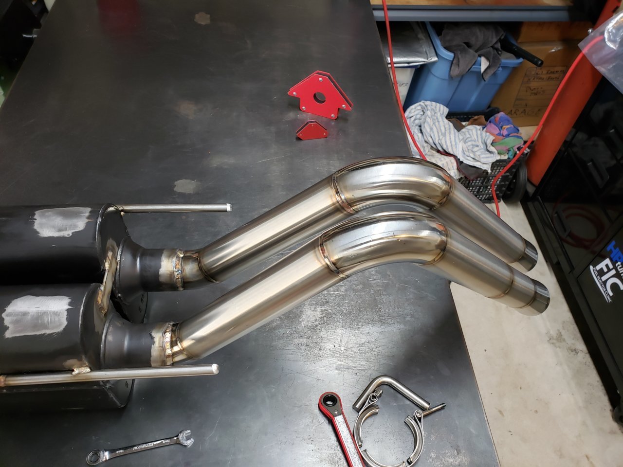

    Are those slight reducer tips on the ends? Kind of looks like it.

    Actually 2.25 to 2.5".
    I know I was going the wrong direction but wanted to test it out. I might get some 2.25 to 2" transitions to swap out just to see what it does.
    It sounds way different but I need to drive it more to see how I like it.
    It's very quiet at idle but now the exhaust resonant frequency is moved up the rpm range from around 1200-1400 (resonant frequencies reoccur at every multiple of 2), to around 2000 rpm. This I think is due mainly to having mostly dual smaller pipes as generally speaking smaller diameter tubes have a higher natural resonant frequency.
    Testing continues.....after I pack/ship @JacksonTacoma's y-pipe.
