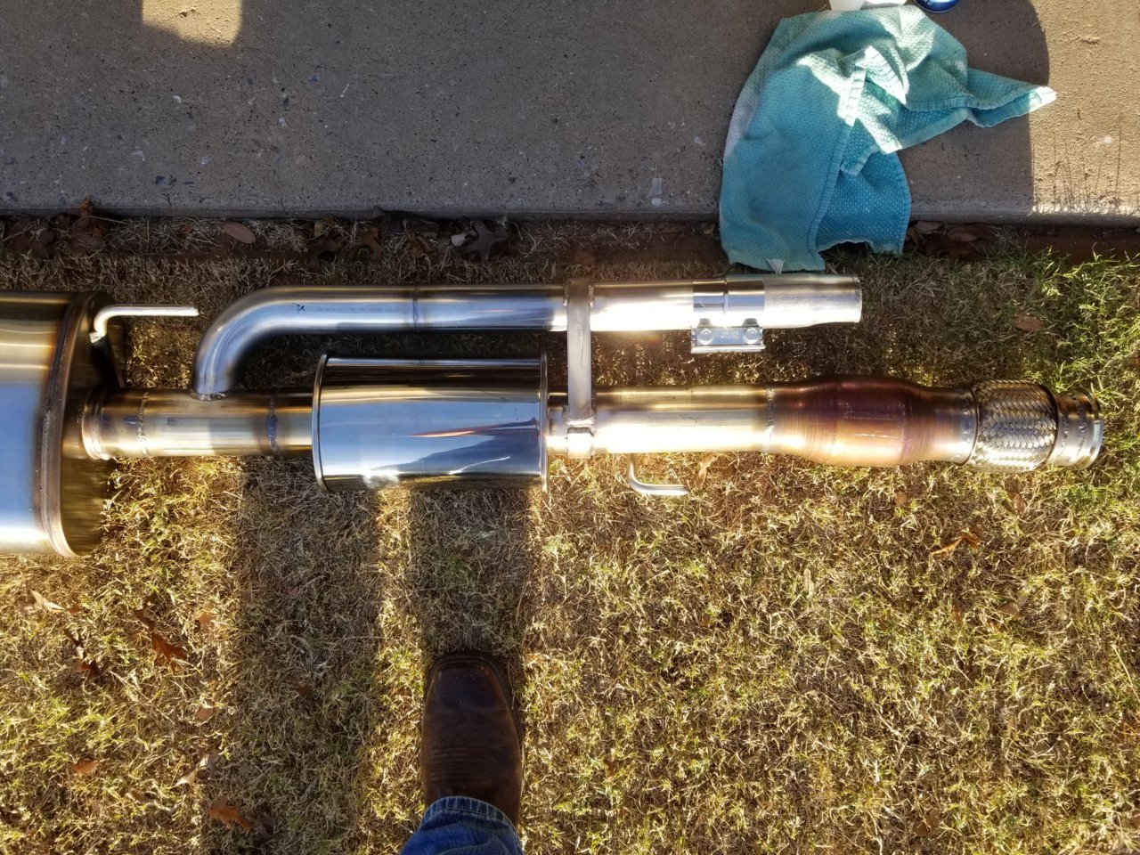

    @Roostfactor thank you for starting this thread! Your doing beautiful work on your y-pipes!! I honestly never thought a Tacoma could have a refined sound until I saw a few videos using your y-pipe.
    I have also entertained various exhaust designs however each one incorporated a Helmholtz resonator. @DocME mentioned it on one of the previous pages. Have you considered trying this approach? They do work really well and are easy to tune in order to attack the drone at a specific rpm.
    Keep up the great work!

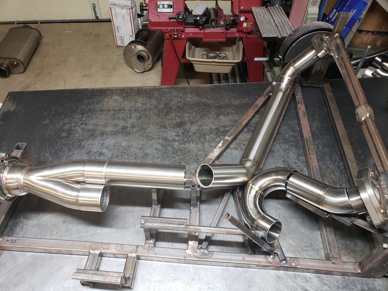

    A lot of peeps have skids with my y-pipe. I have not installed them so I havent seen the clearance 1st hand. Some skids may need a brace trimmed where the pipe goes under the trans.
    It would have to be a full custom fabbed y-pipe to make it fit correctly since I cant use the jig to make it.
    We can do it though!

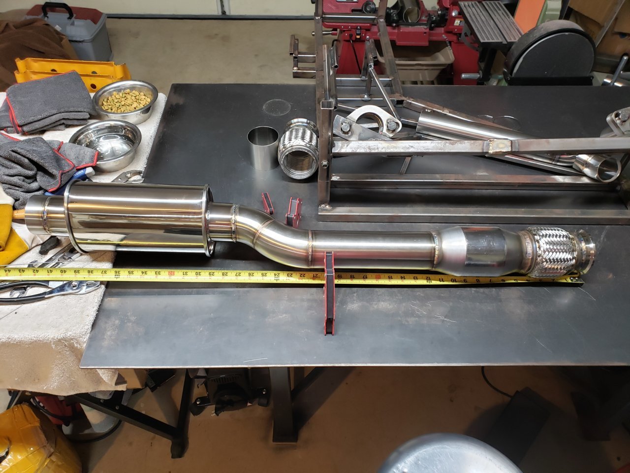

    Yes I did experiment with a 1/4 wave resonator commonly and incorrectly termed a Helmholtz. I had installed mine between the resonator and muffler and in hindsight should have placed it post muffler. I had an expanded piece on the end with a clamp for adjusting length. It has been removed for a long time now.
