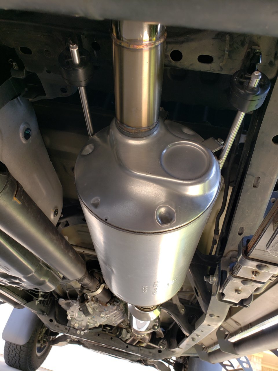

    It is round and looks like a keg.

    Is the keg muffler s/s like your JFR Y pipe?
    Is this available from you as a kit?
    Bolt up kit: Your Y pipe, keg muffler, and all s/s piping back exiting stock location for my 2007, DCLB, auto, 4x?
    Please say it's so and price.

    I believe its 409 stainless which is standard now for oem's not 304 which is what I use.
    No it's not, sorry. You may be able to find the muffler as a takeoff from a muffler shop. It's from a 2019 Dodge Ram.

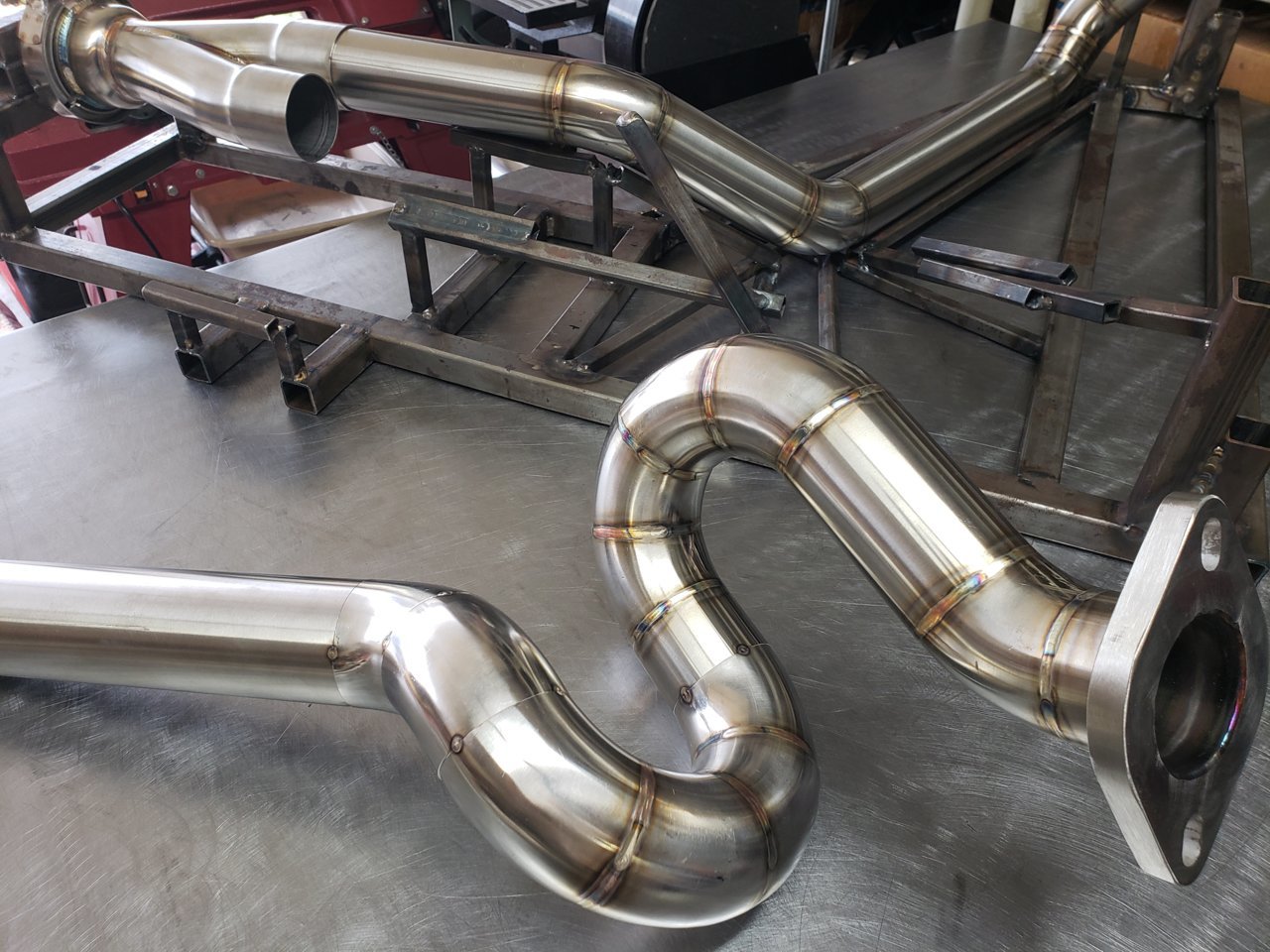

    Surprise! A little update. @RAGS2WRENCHES yours is finished. Sorry for the bad pic. @tblizzard yours is in work (in the jig). I hope to have them both finished and shipped out tomorrow. No guarantees though. I hate packing these things!

    I dont.....only because I get to do it daily. I still love it!
    So now the passenger side is tacked up it gets taken off the jig to weld up.
    Then back on for bung placement/drilling holes and hanger fitment.
    Once that is tacked on it will come off the jig again for final hanger welding and qa check to make sure I didnt miss any welds.

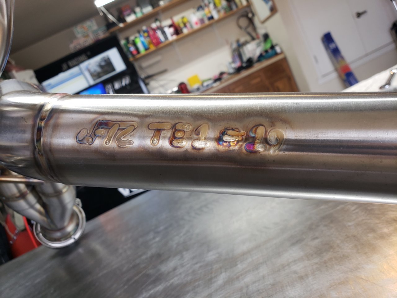

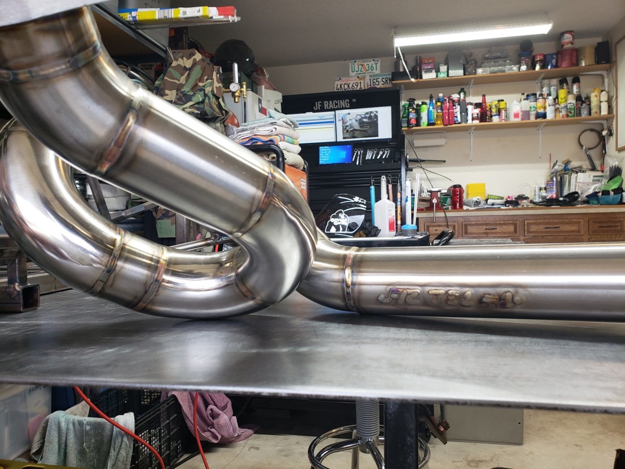

    Also a small update. I no longer weld a bracket between the two pipes. A few others have been running without the bracket (I initially didnt weld around the corners of the bracket so my first couple y-pipes brackets broke.
    Nobody is having any issues without the brackets and since the overall y-pipe length is pretty short AND is being secured at the header flange at the front, and hanger + merge collector in the back it is plenty solid.
    Thanks @BassAckwards, @loginfailed, and @5thGearPinned for letting me know about the brackets and that there have been zero issues.
    So instead here is how I am labeling these now.
    What y'all think?

    This is awesome. If im ever back up your way, id love to have you label mine like that! My bracket fell off on the hwy somewhere
