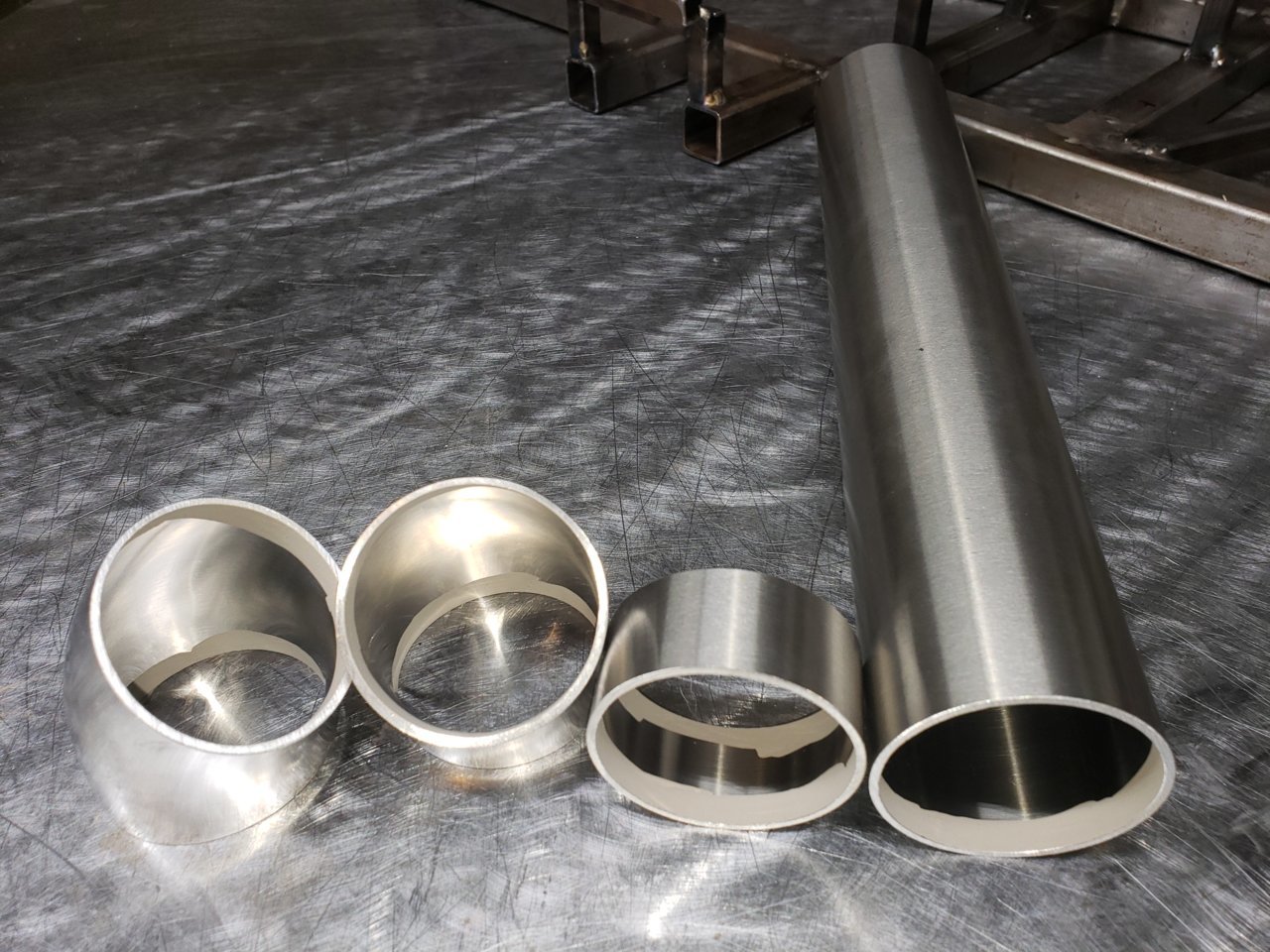

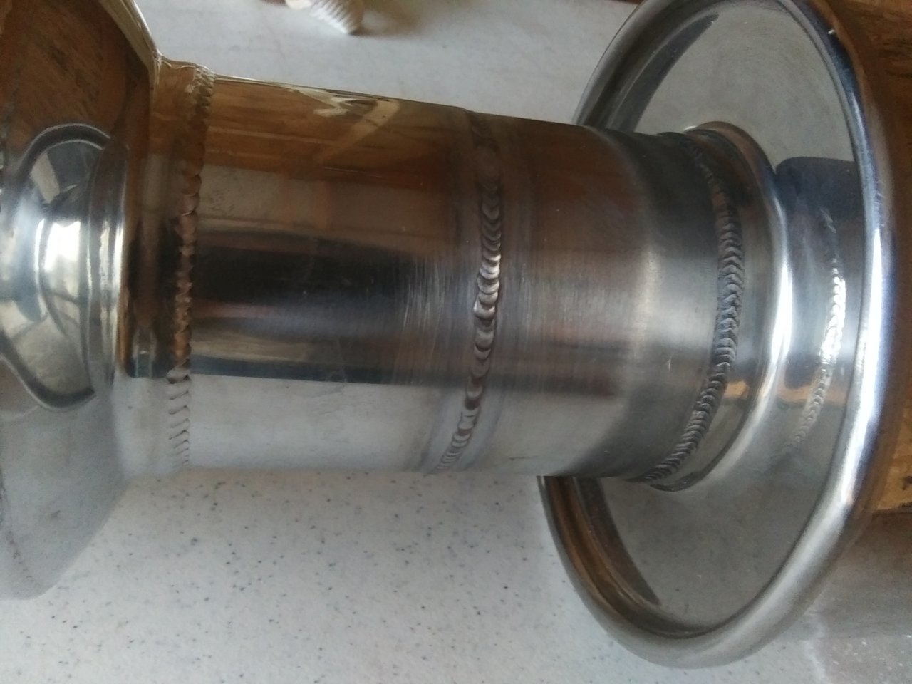

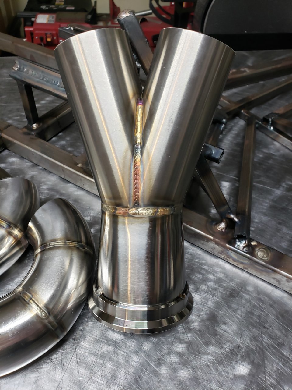

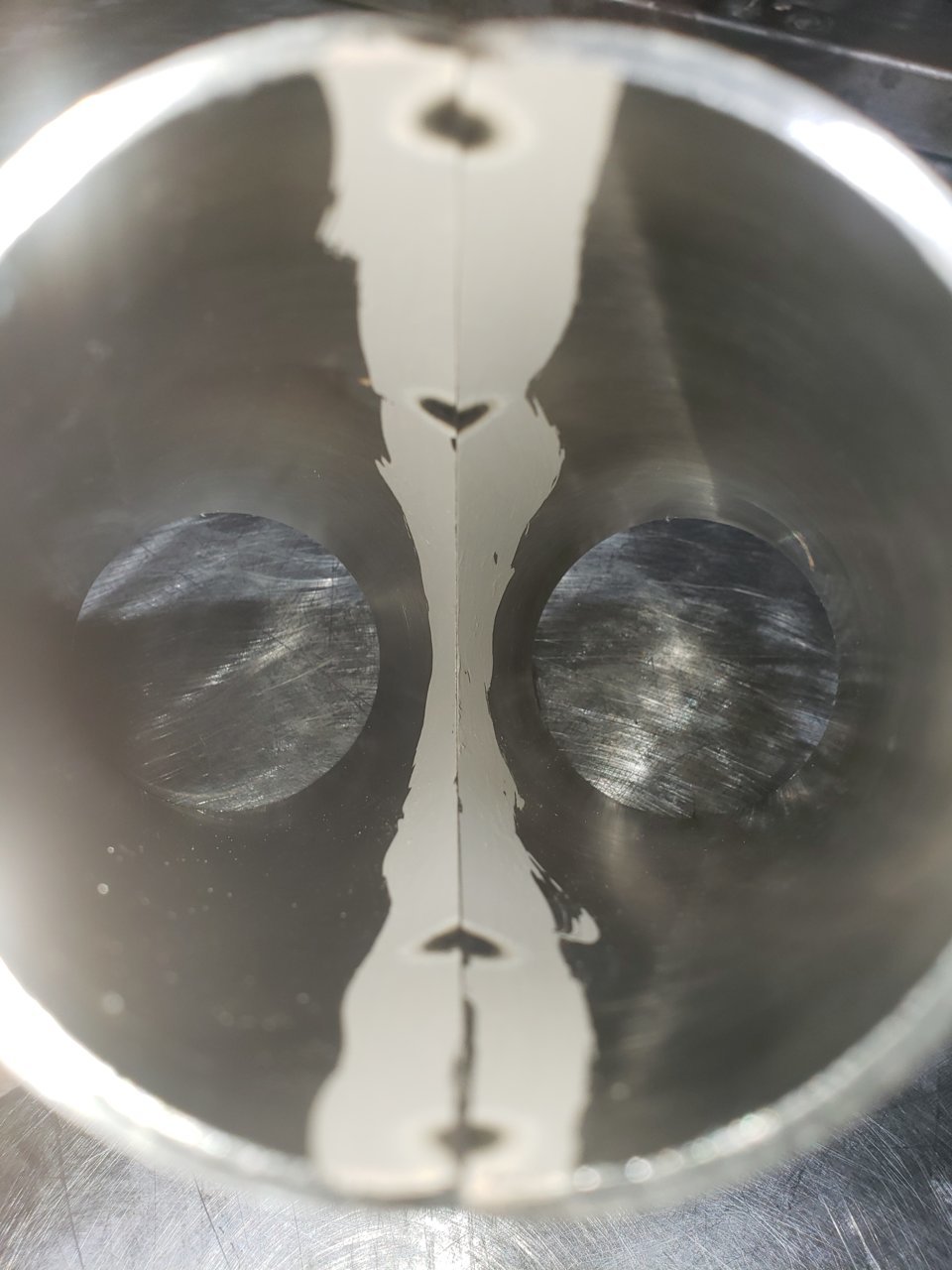

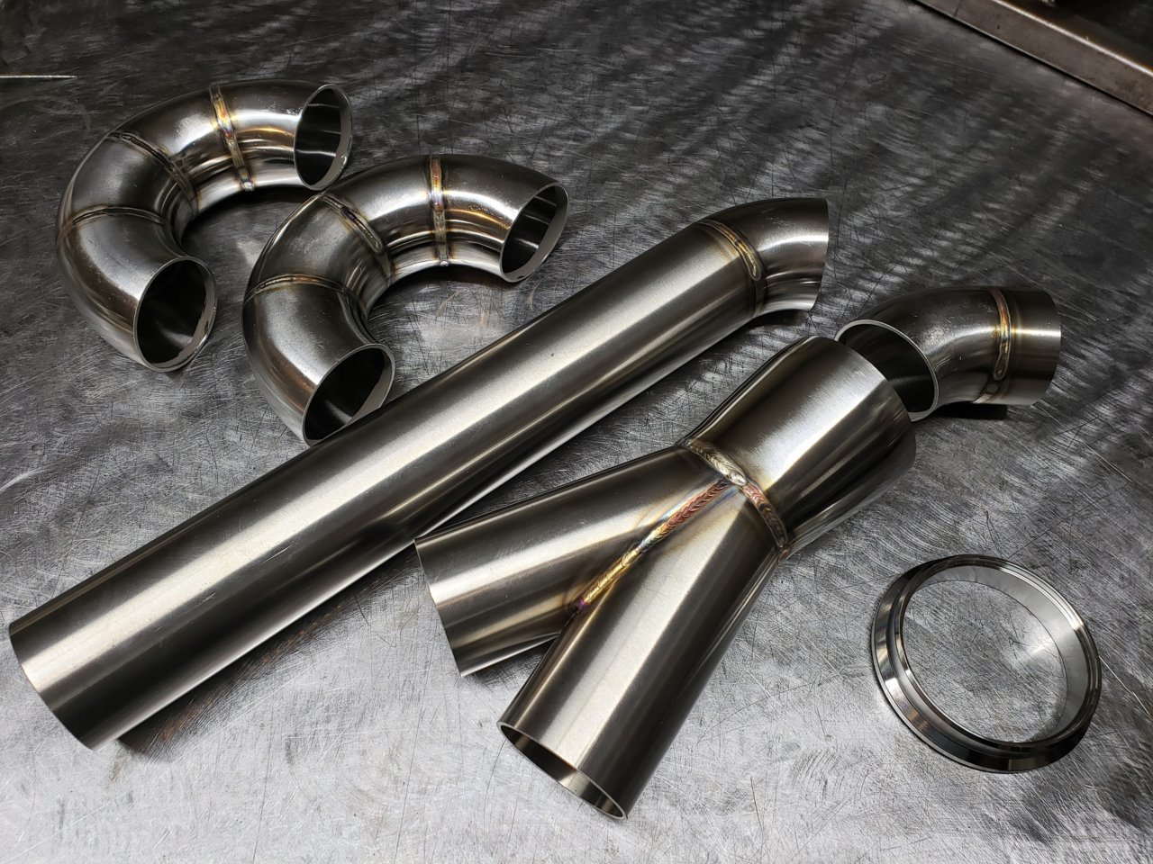

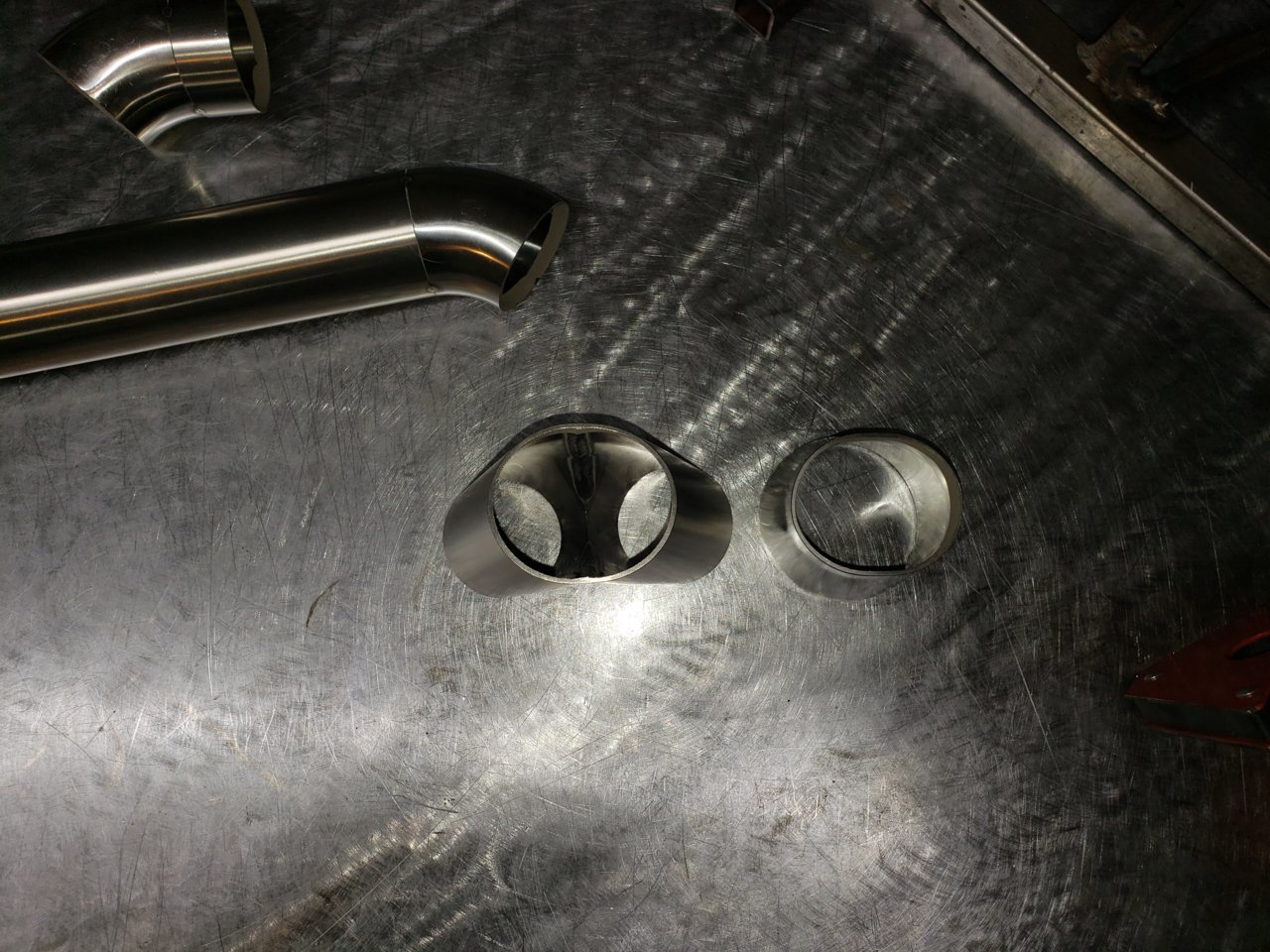

    Here are some pics from @Lucario Runner MOTEC y-pipe. It is a tedious project.
    20191126_182423.jpg 20191126_185428.jpg 20191126_185457.jpg 20191126_210830.jpg 20191126_222035.jpg

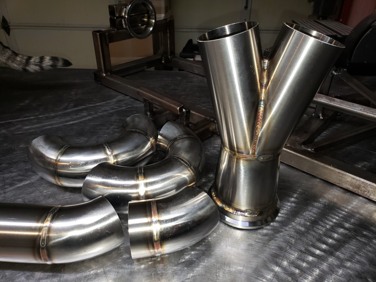

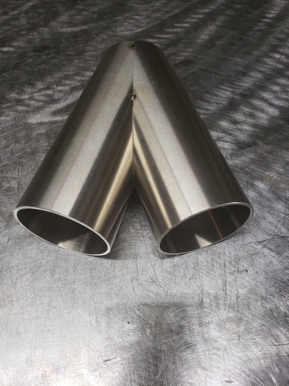

    That's just the merge collector.
    20191126_201759.jpg 20191126_215733.jpg 20191126_235116.jpg 20191129_190720.jpg
    Progress so far.

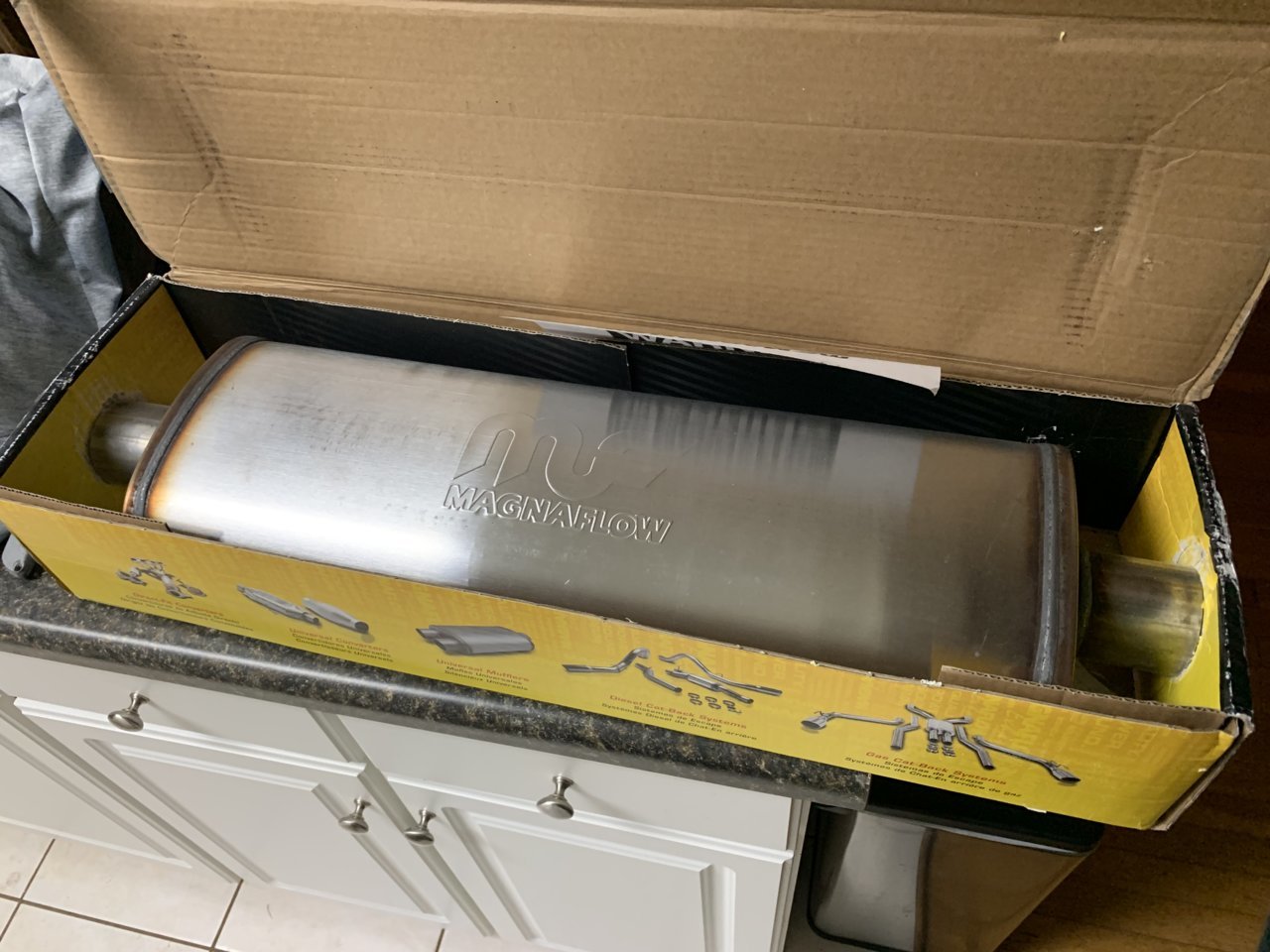

    Decided to try a 24” Magnaflow. I like the magnaflow on my ‘87 4runner 22re

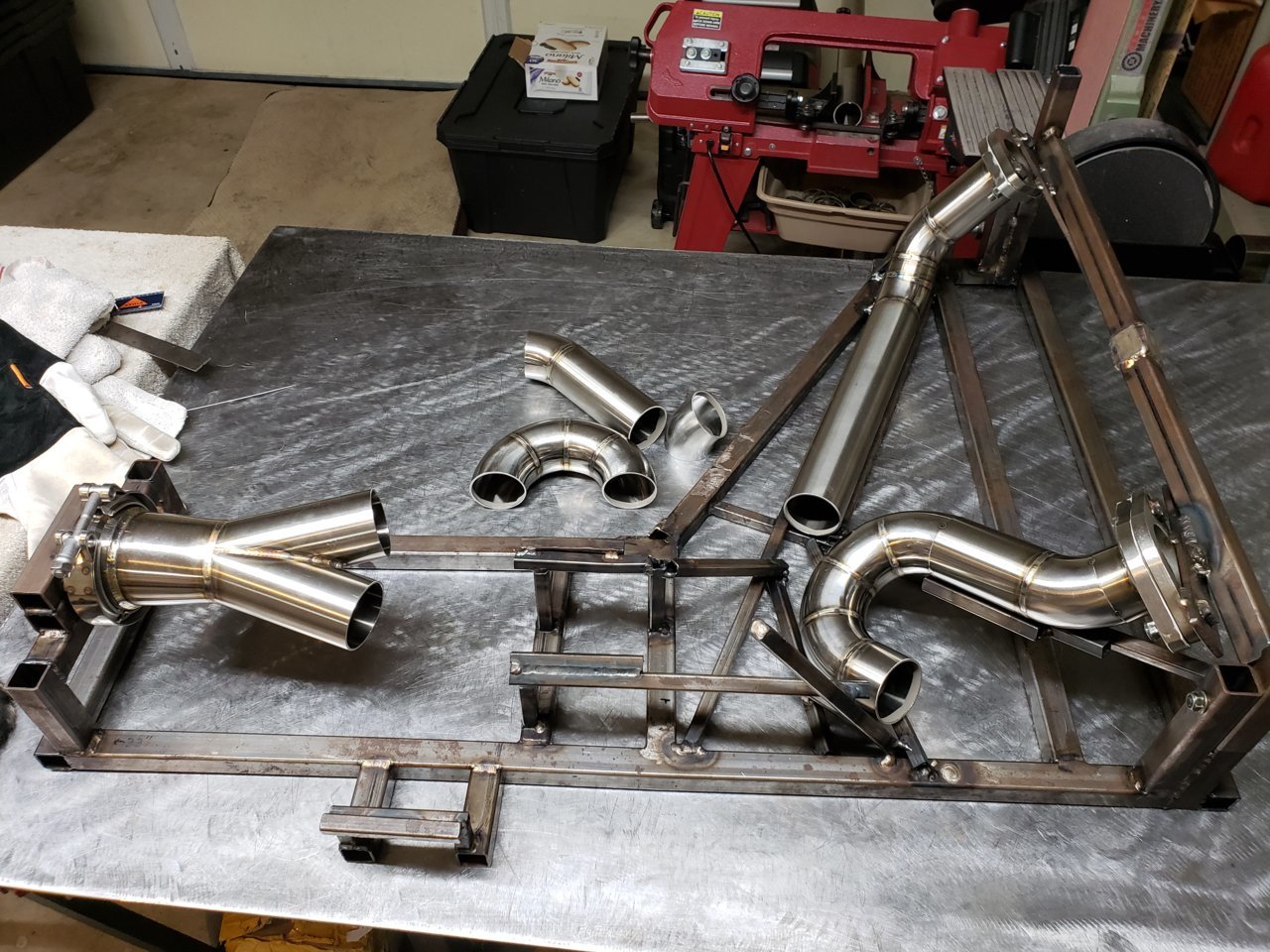

    Since my last post on this thread I've been very busy learning to tig weld and building a couple systems for my V8 4Runner, a bit in part to Roostfactor's inspiration.
    Hope I'm not spamming you guys here, I just know you guys are interested in custom exhausts or it might even give you some more ideas for future systems.
    First was a equal length full 2.5" Y: (more equal length might be more appropriate)
    Next up a catback to replace my Dirty Deeds setup:
    Then a dual system with the same magnaflow mufflers as my single, and a homemade x crossover dumped before the axle. Super happy with the dual, sounds even better than any of my systems before it, and really scoots along when over 2000 rpms. I might have lost some low end torque but it does sound awesome...
    And this weekend I built a welding table, had the laser at work cut it out and I welded it:
    Anyway, that's all I've got for now, waiting to receive my DT long tube headers before doing too much more, although I might start costing a titanium single muffler system. I might dyno test some of these setups in the future too.
