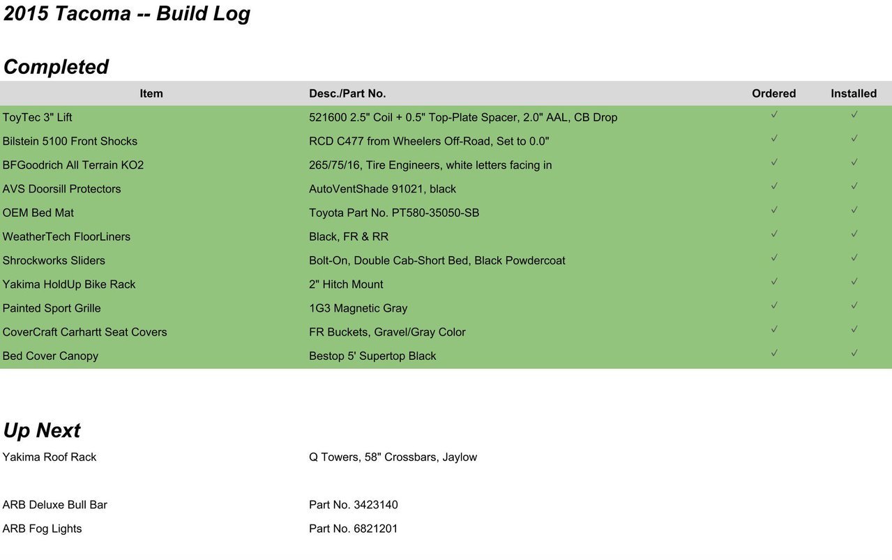

    Thanks, helps me plan and prioritize (and keeps me accountable with the wife).

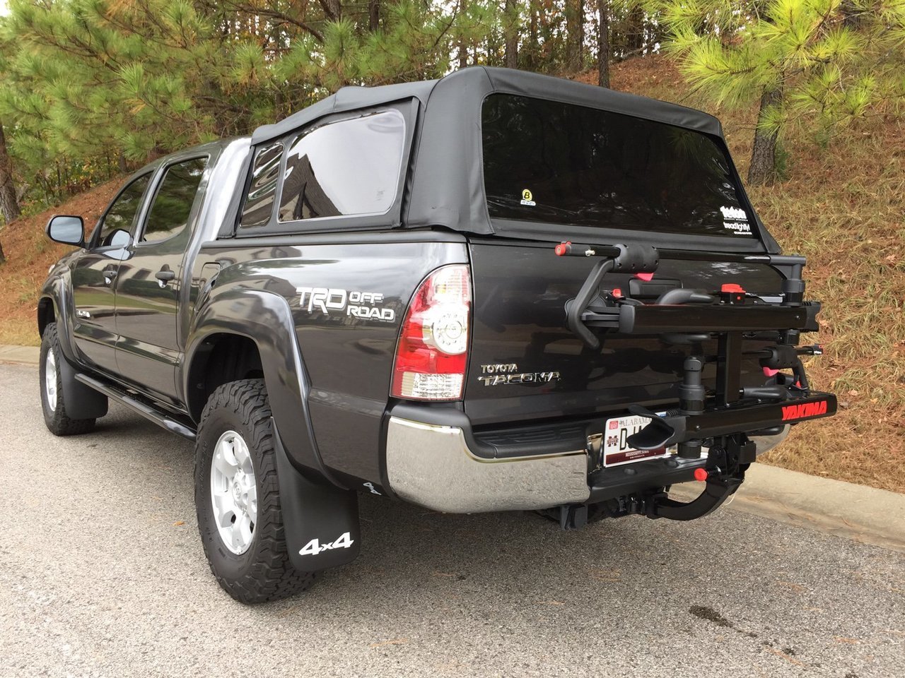

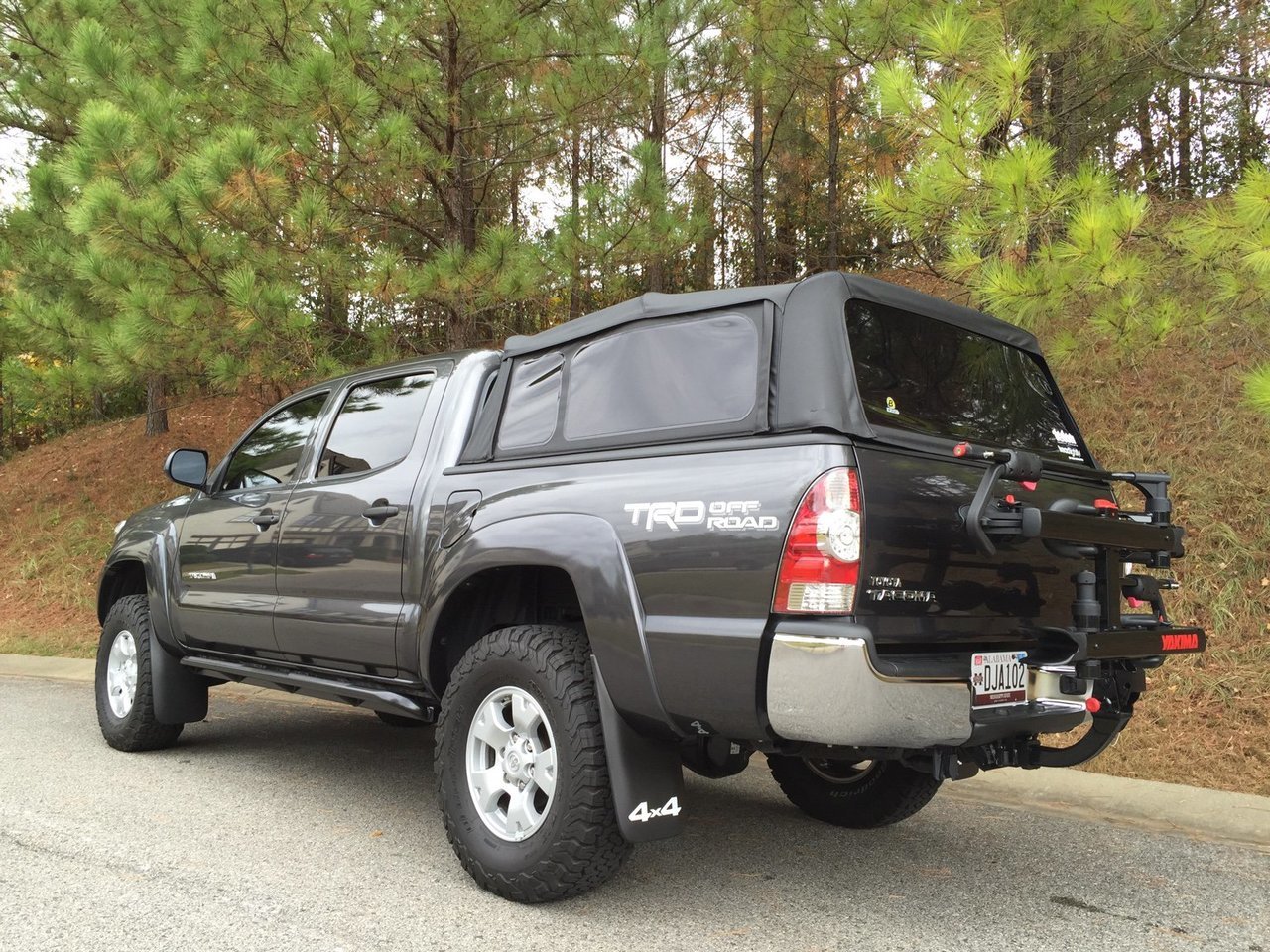

    2) KB VooDoo Bed Bracket + Yakima spare parts = Rear bike tire support
    My tailgate wouldn't close using my RockyMounts Driveshaft bike front axle mount on the front-most bedrail. This is a problem for carrying bike gear/camping equipment obviously.
    I saw KB VooDoo's custom bed brackets that attach to the OEM cleats. Combined with some spare parts from Yakima:
    Yakima Boa wheel tray
    Yakima Strap
    Yakima Hex-nuts
    I had to get some additional polypro spacer stock, and cut it to about 3/4", from McMaster to act as a standoff so that the Yakima wing-nuts wouldn't interfere with KB VooDoo's bracket. Also had to cut about 7 pawls off of each side of the Yakima strap for the same reason. Ultimately it came out just the way I wanted and it's solid as a rock!

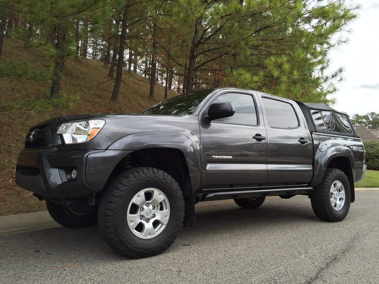

    FRONT:
    --ToyTec/Eibach 521600 2.5" Coil Springs
    --Bilstein 5100 RCD C477 Shocks (set to 0.0")
    --ToyTec 0.5" Top-Plate Spacer
    REAR:
    --ToyTec/Deaver 2.0" AAL
    --Factory TRD Bilstein HD (yellow/blue) Shocks
    Couple of install pics:
    Result:
    Numbers:
    Alignment Results: (really pleased with numbers given stock UCA's)

    You're stoked! Loving the build thread already, and the spreadsheet haha! :thumbsup:
