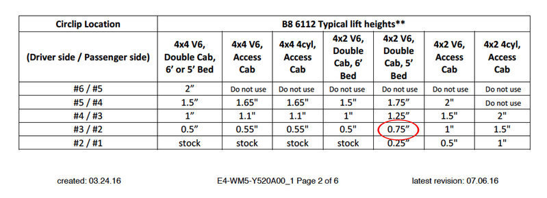

    Looks like you wanted a more moderate lift, assume you could go up another notch in the 6112s and 5100 if you wanted higher, correct?
  16. Apr 3, 2017 at 12:11 PM
    #36
    jhunter80
    jhunter80 [OP] Well-Known Member
    Sep 15, 2016
    #197373
    116
    Southern California
    2017 TRD Off-Road Pre-runner
    A.R.E. Z Series Shell Clazzio Leather Seats Bilstein 6112 (2nd Notch/0.75" lift) Bilstein 5100 (Rear) SCS F5 Wheels (16x8/4.5 Backspacing) Goodyear Duratrac 265/75R16 (C Load Range)
    Yes, you can go up to about 2 inches (depending on the truck you have) according to Bilstein (image attached and my setting highlighted...I went 2nd notch on both sides with a 1/4" spacer on driver's side to level out taco lean).

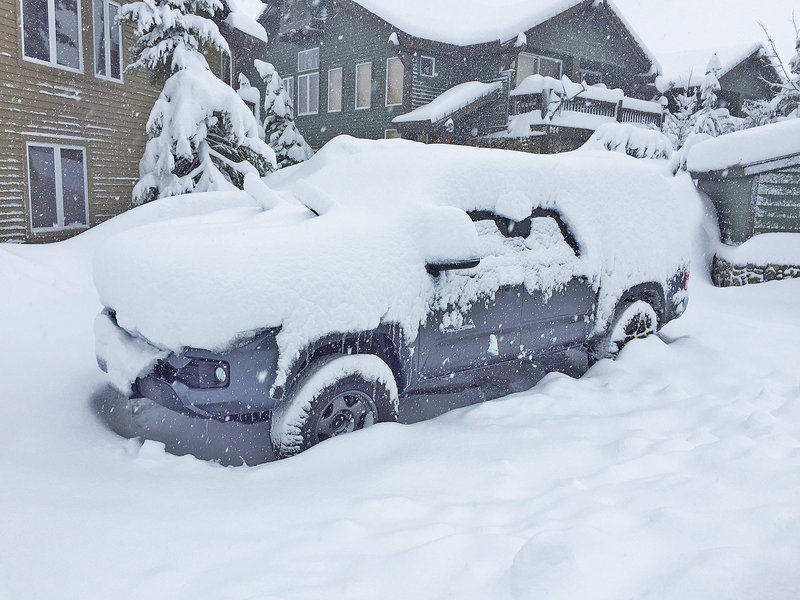

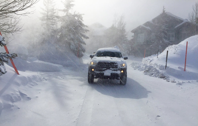

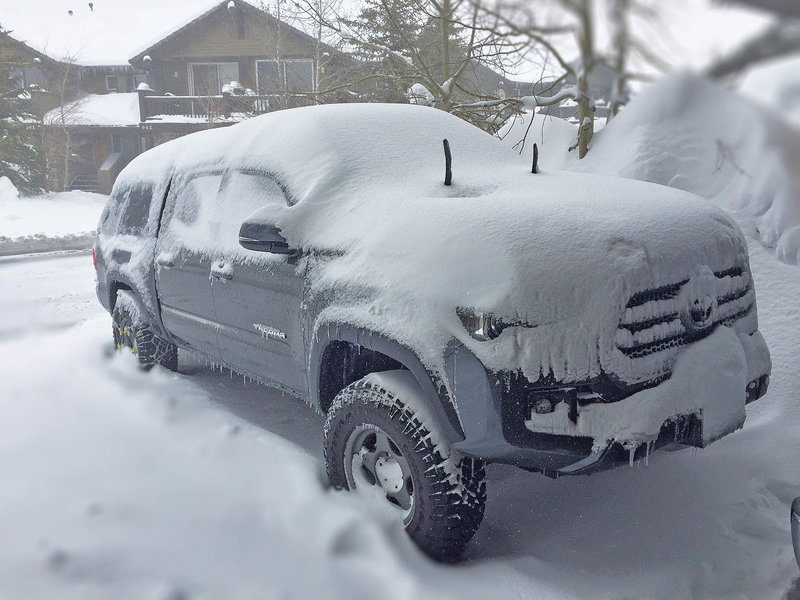

    4/10/2017:
    Spent the weekend snowboarding in Mammoth ... 4 feet of new snow over the weekend and perfect, bluebird conditions on Sunday. Only had to use the LRD once, in the morning after super heavy overnight accumulation of snow, and I have to say that I was really impressed. Didn't think it would be much help, but dug me right out (second pic where I'm totally buried). Yes, I put on the chains. Honestly, no choice and the only smart choice given the conditions. I had my fiancé with me and the winds / roads were straight up dangerous. We drove 8 hours, tried to beat the storm, but ended up out in the worst of it at 1:00 am with only about 5 miles left to go. Never seen snow/ wind like that. Weather report said gusts were 80 mph plus. I can say that the Duratracs lived up to their rep as a great snow tire, and IMHO the truck performed as well as anyone could hope for a prerunner in 4 feet of snow. Close to 1,000 miles this weekend and taking the truck in tomorrow for the 5,000 maintenance. Love my truck more and more everyday!
