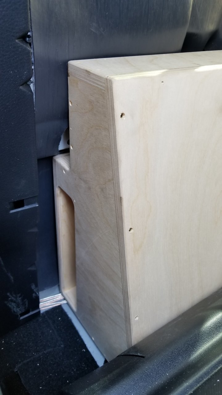

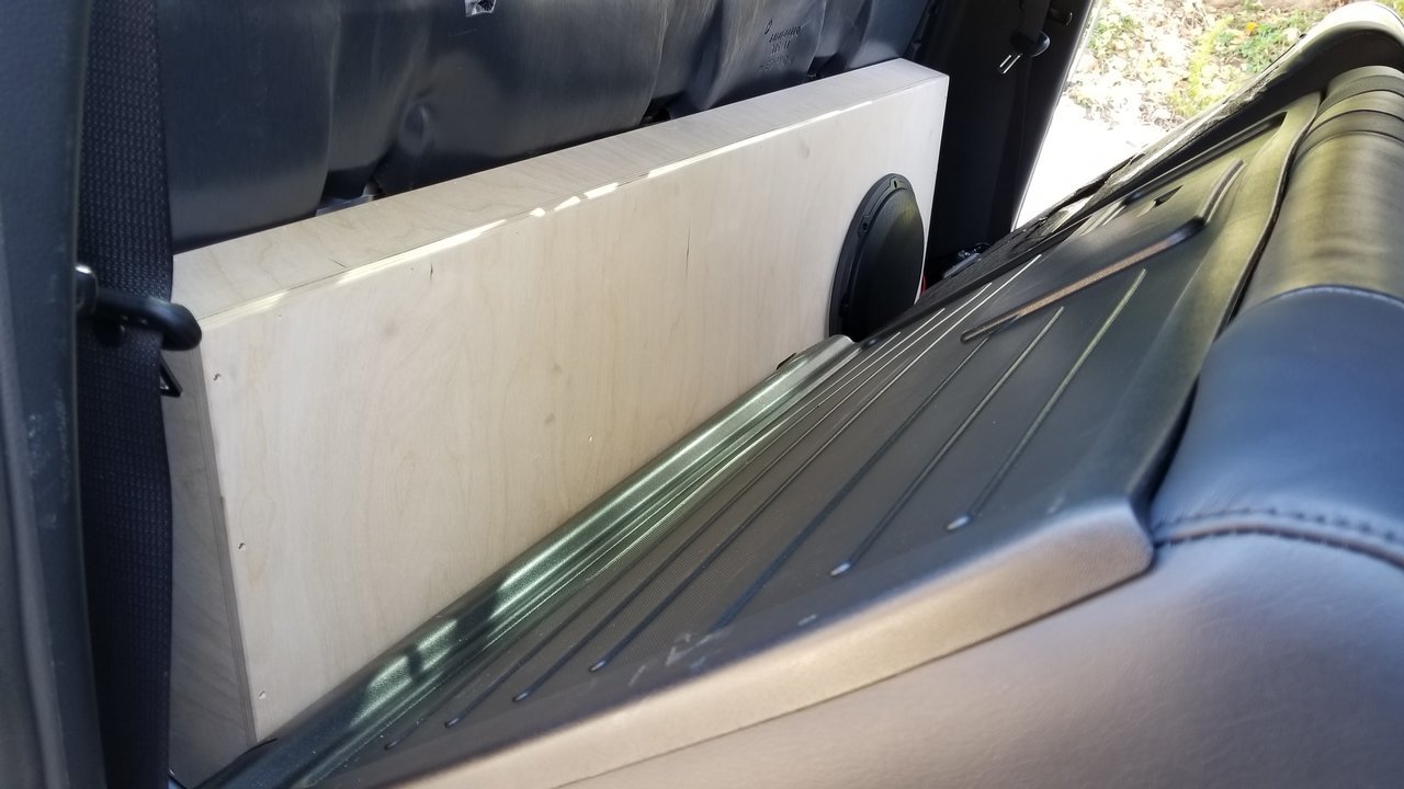

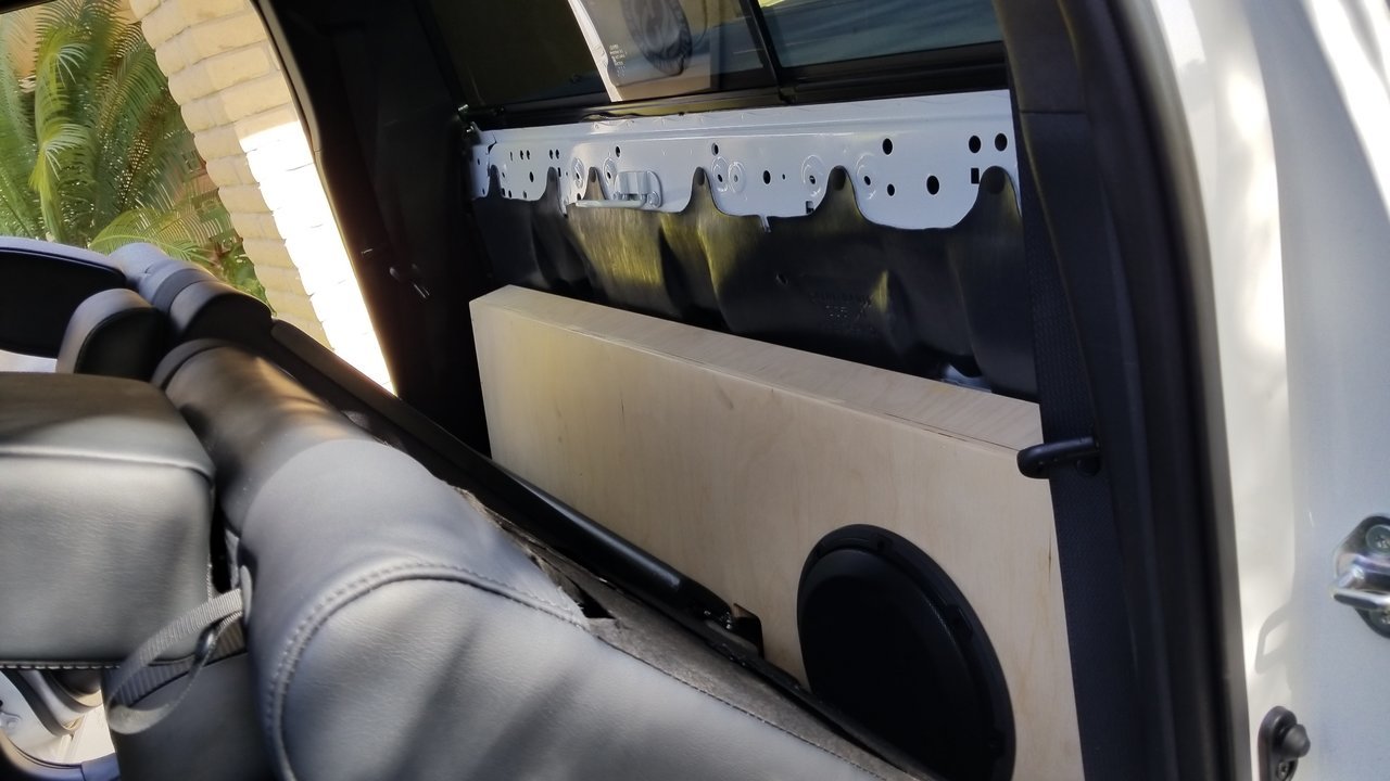

    Alright, mission accomplished. I got my system all installed and mostly dialed in and it sounds AWESOME. :bananadance:
    Mr. Marv (@Mrmarv) built my custom enclosure to my requested specs (modeled using WinISD) and, let me tell ya, it's a thing of beauty. He really is a master at his trade. Even the pro installers said the same when they scoped out the quality of the enclosure they were installing along with the rest of my system. I seriously considered adding a fine wood finish or bedliner on it but it isn't visible behind my seat so decided against it for now.
    The JL Audio 10W3v3 (2 ohm) is in a slot ported enclosure with a bit over 1.3 cubic feet of net volume and tuned to 30hz. We used 13mm Baltic birch wood to gain even more enclosure volume than was possible using 3/4" MDF. It fits perfectly like a glove behind the seats and the seats fold back as normal. The enclosure is not visible at all and everything looks perfectly stock with the seats back.
    The sub is powered by a Alpine PDR-M65 (rated 650W RMS x 1, though birth sheet says tested 731 watts) with Alpine level knob mounted up front. It sounds incredible. I have played a wide variety of music through it so far and it hits clean and DEEP. This thing absolutely slams for a 10" and everyone thinks I must have a 12" or more. Rock, rap, metal, jazz, whatever...it all sounds great and really well-rounded due to the pretty flat response curve down to 28hz or so. I have it crossed over fairly deep, which sounds better to my ears as it pairs really well with my components mid-bass response. This sub seems to love this ported enclosure spec and really shines in it, IMO. I have attached a few quick pics of the sub and enclosure behind the rear seat of my 2018 Tacoma Off Road DCSB. I also have a 10W3v3 grille from JL Audio covering it.
    In case anyone is curious, for mids and highs I am running JL Audio C5 6-inch components up front with the tweeters mounted in the A-pillars (not the crap stock locations) and coaxials in the rear all powered by a JL Audio HD600/4 (150 watts x4).
    If anyone is looking for a great-sounding ported subwoofer setup for a 2016+ Toyota Tacoma double cab, this is your solution. Contact Mr. Marv and ask him to build this design. You won't be disappointed. Hope this helps. :thumbsup:

    Did you have to remove the rear plastic from the driver-side rear seat?

    Yep, Marv's work is impeccable. And yes it is very clean even at very high volumes. Honestly, it goes much louder than my old ears really ever need. I really prefer quality over quantity so I rarely crank it, but it sure can crank when I want it to! I had the gear laying around from my last vehicle and working perfectly so I figured I'd put it to good use in my new Tacoma.
    I did remove the plastic behind the driver's side rear seat but I don't know if I even needed to with the speaker cover. I just did it to eliminate potential rattle from the cover hitting it and allow more air/sound flow directly from the sub. Plus, it is invisible to anyone in the truck so what the hell.
