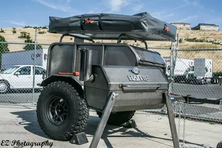

    Yeah it's got a hint of rust after the thunder storm in MOAB. I've got a silver powder coat I'm coating the box with that will match the truck.

    Couple question for you if you don't mind... What kind/thickness did you use for the center beam/reciever?
    I noticed in your first lay out the center beam/tounge stuck way out but then you chopped it off right after the angled braces, any reason for this?
    Then later you re-attached the tounge with brace and bolts, why? Did you sleeve this inside and then rosette weld the two ends and sleeve together? Just trying to figure out why you cut the tounge off, other than to save room/space.
    Also, last question I swear.... It looks like your center beam was slightly smaller than your outside, then you welded brace/patch panels to connect/brace the outside beams and center beam? Any particular reason?
    I hope to get to see this trailer in person some day. Thanks for the time man and awesome truck and build.

    Thanks I'm really loving the trailer.
    What kind/thickness did you use for the center beam/reciever? its 2.5x2.5x.250 wall its receiver tube.
    Then later you re-attached the tounge with brace and bolts, why? Did you sleeve this inside and then rosette weld the two ends and sleeve together? Just trying to figure out why you cut the tounge off, other than to save room/space. its not sleeved its bolted on so that I can mess with tongue lengths to change how it tows. I like the way it is now so its staying like that. And its for swinging the tongue out of the way for storage
    Also, last question I swear.... It looks like your center beam was slightly smaller than your outside, then you welded brace/patch panels to connect/brace the outside beams and center beam? Any particular reason? yes I made the main frame from 2x3x.120 wall so I added little squares of. 250 plate so it fit flush with the receiver tube that is 2.5"

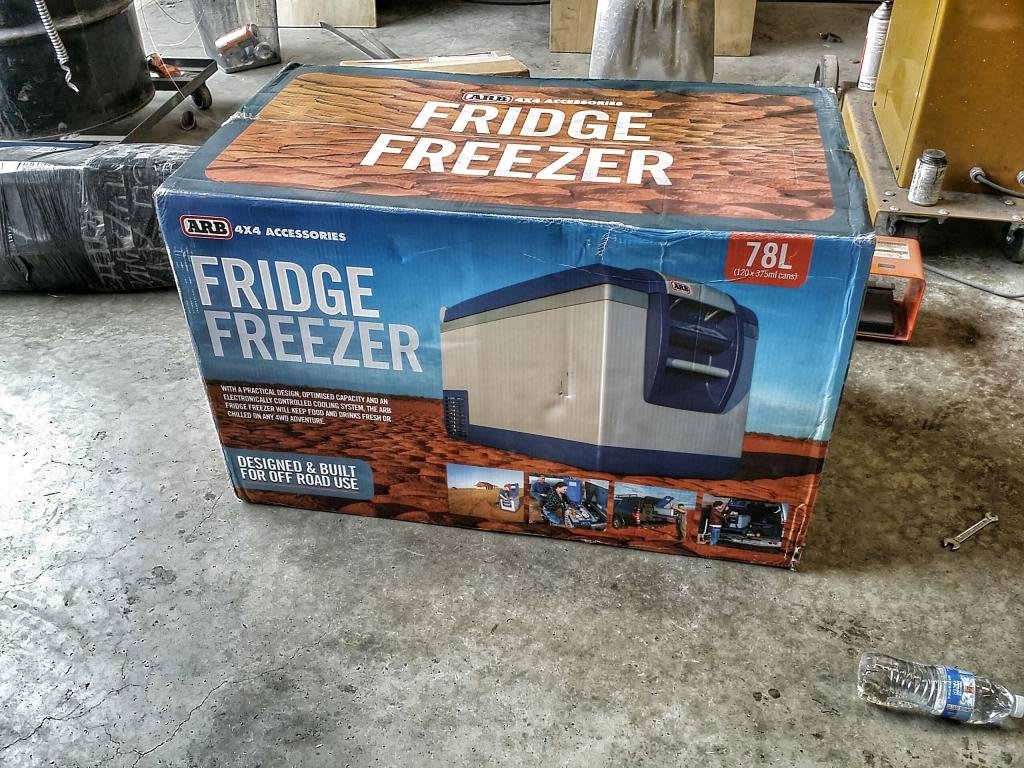

    Not much of an update but I just got my 82q ARB Fridge 3 sets of 500lb drawer slides and lot of other little things for the trailer. It's coming back to the shop in a month or so to get finished up!

    Here is a shot of the new fridge it's a beast!!
