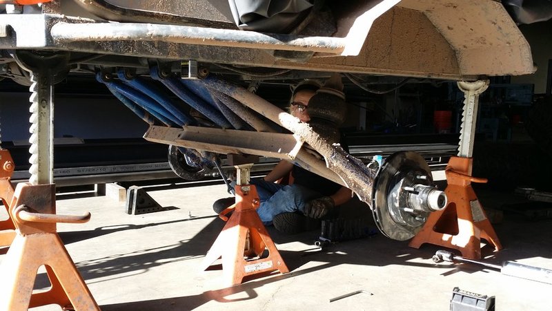

    No I don't I'm pulling them off this weekend to fit up the new ones. But the bushings twisted so much that everything riding half way across the country like that just started to bend. I'm not sure if the tube twisted or they just bent at the spindle attachment point but you can see the spindles are not square to the ground.

    2100 fully loaded I did some finish welding on the arms before powder coating it that may have done it. i think they twisted at the spindles there was just not enough support there. The new ones wont be moving at all and frankly I think they look better :D

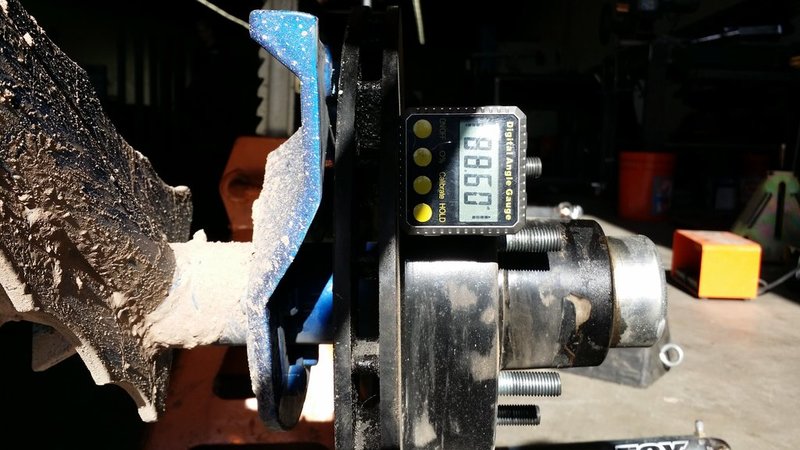

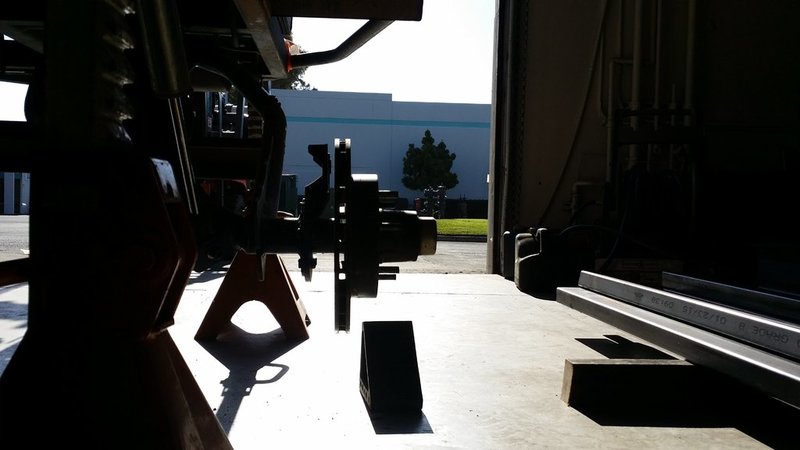

    Well i got the new control arms all mocked up this afternoon i put .70 degrees of positive camber in them. I couldn't find a drill bit long enough to open the holes in the mounting tabs to 5/8th. So i just cut off the corssmembers and made some new ones out of 2x2x.250 wall A588. The tabs are a 3/4 wrap so they are never pulling off! I took a few pics of the bent ones after the Utah ghetto fix i had a little more then a degree of -camber unloaded. Loaded it was more like 4 or 5 degrees.
