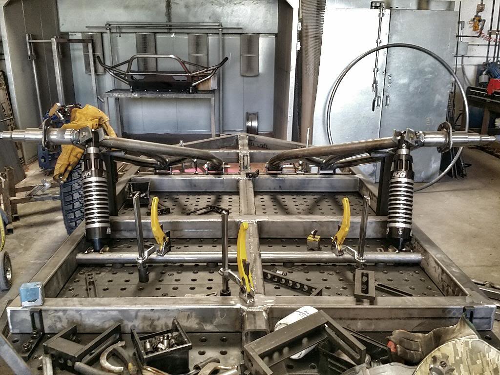

    I came in for an hour today to get the struts mocked up. They are 8" stroke ORI's there will be 4 up and 4 down if travel. They are mounted at 63 degrees at bump. These were just for mock up i have a blue set coming to match the truck. IMG_20140420_093234_1_zps2kr3pgni_d3f743249c2ce92a10154140439829e415e702e6.jpg
