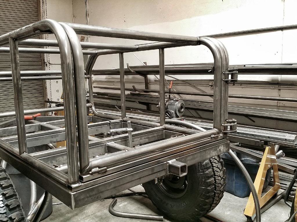

    I got the tailgate just about done today I really didnt think it would take 9 hours to build it but I had a wild idea to make a spot for my camp stove.
    It swings out and flips down my stove will be mounted on the gate for easy setup.
    I also got the bbq swing out started kinda. IMG_20140426_164056_1_zpsblfhygz9_9cebd4eb6be8bf71dd0531f6ae7fd968669e9b9c.jpg

    Yeah the gate took longer then I thought becuase I keep thinking of other things I can do. But I really like how it came out it will be nice to just open it, flip it down and be ready to cook!
