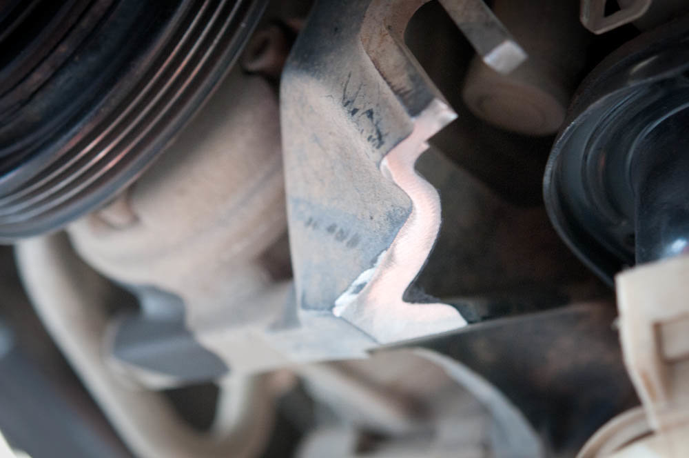

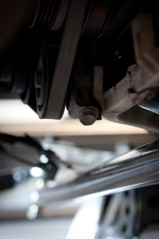

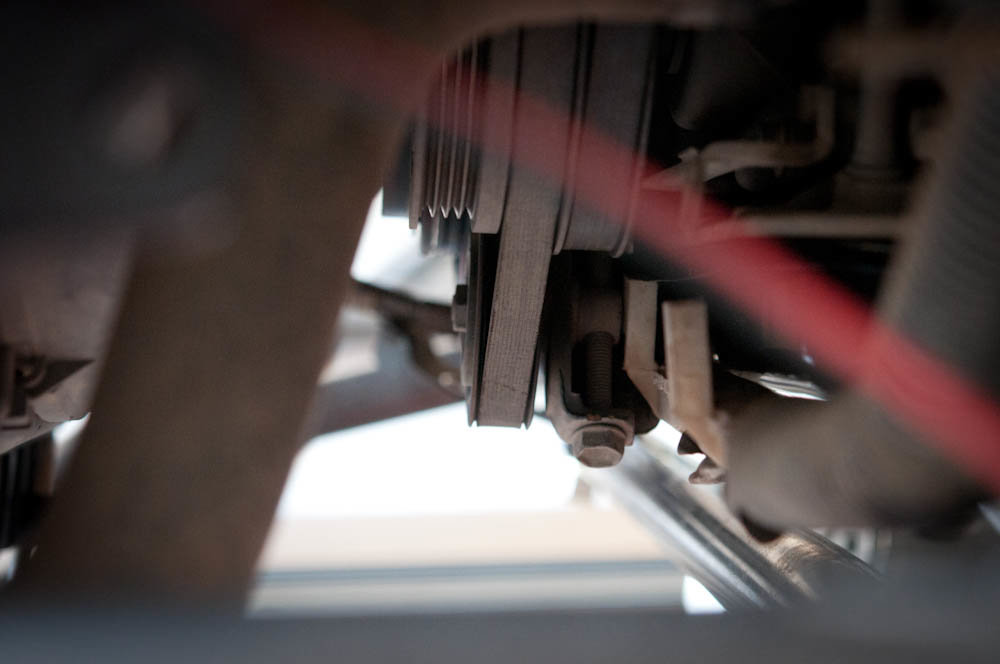

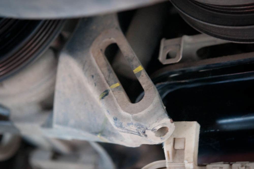

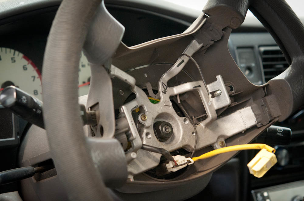

    Today was all steering

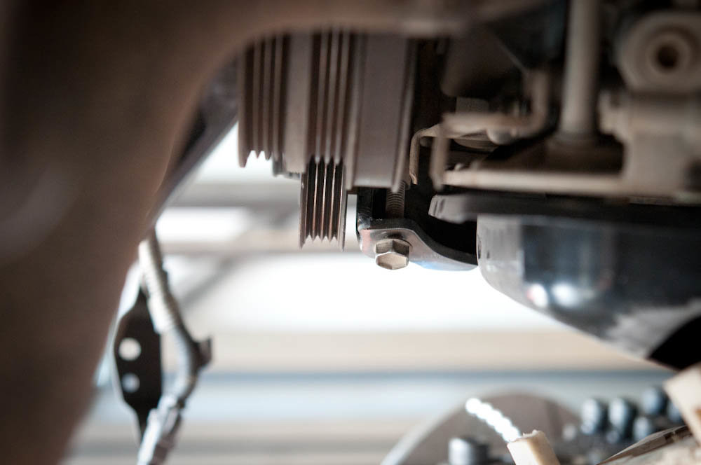

    First off i did the AC pulley mod and gained about 1.5" for the Drag link :D
    Before
    After :D

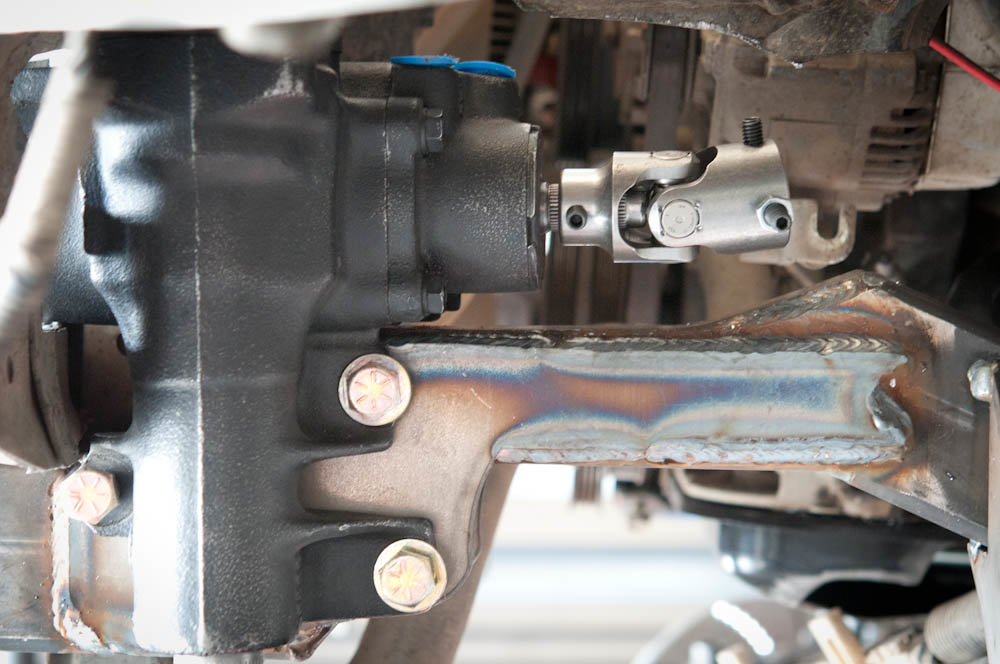

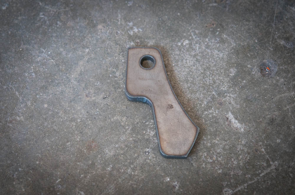

    I fish plated the driver side frame with 1/4" plate for the steering box and it's mounted temporally I still have to plate the bottom bolt section.

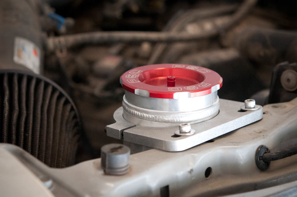

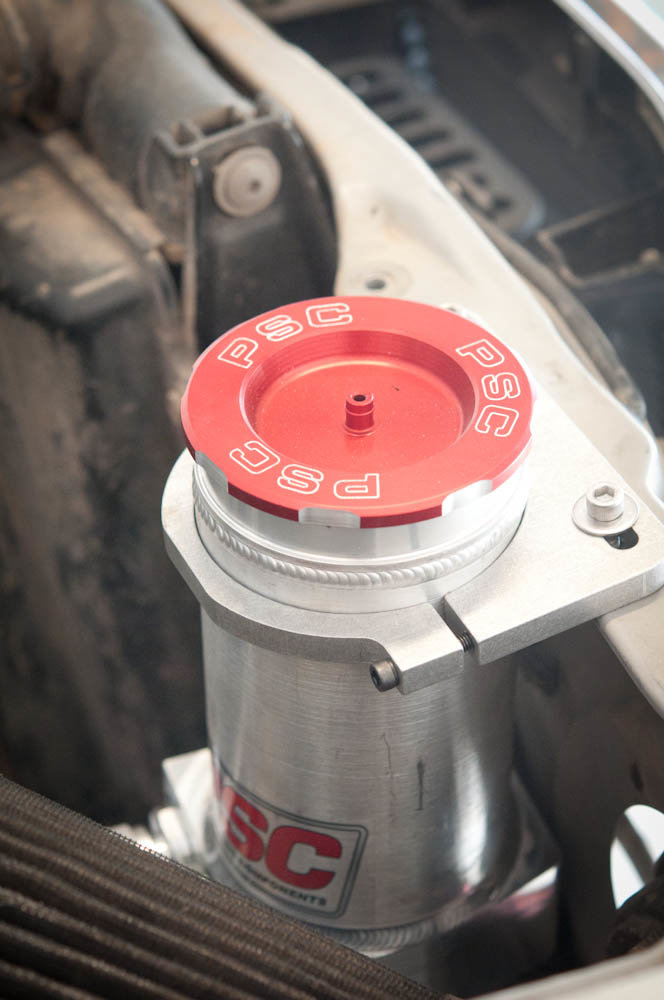

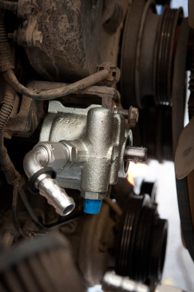

    I got the power steering pump mounted up I need to go grab a pulley installer on the way home that's why the pulley and the lines are not on.

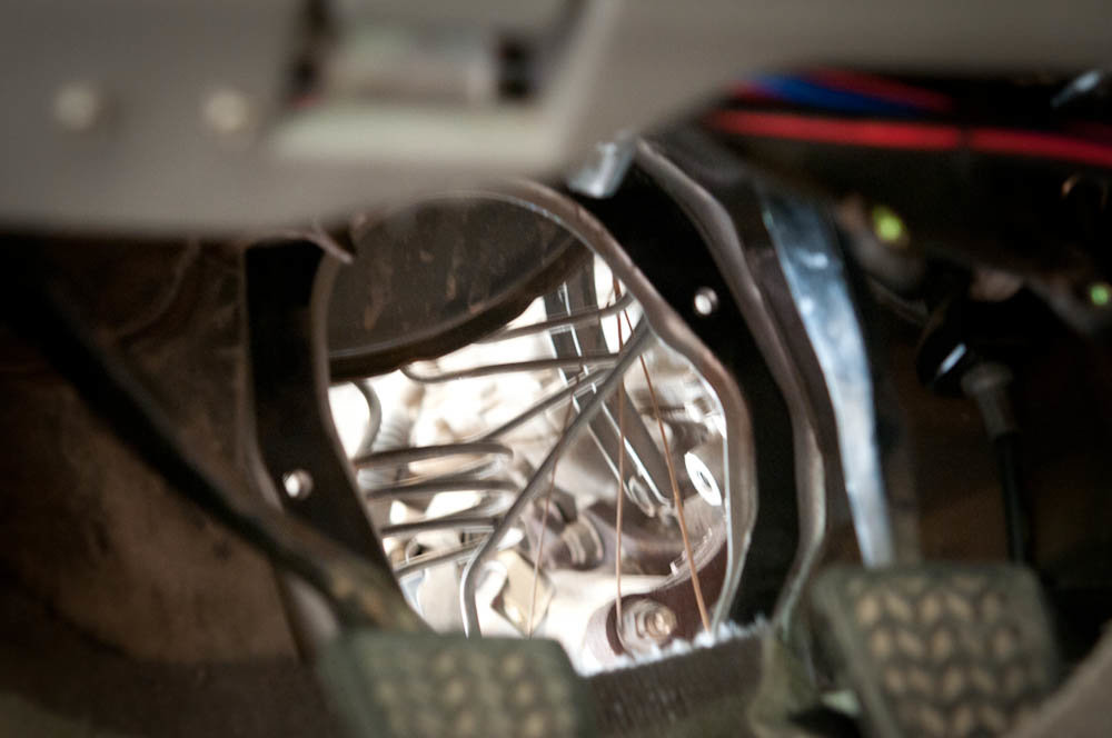

    Then I moved into the cab I pulled the fire wall plate and stock steering shaft. Note to self don't use a ratcheting combo on the top bolt of the fire wall plate :mad:
    And the part number I got of TTORA for the steering U joint didn't work out so well so i have to pull the steering wheel and the shaft to get that fucker on.

    Yeah the part # is wrong on Ttora, I have the correct one in my build somewhere I will search for it.. It's the right # (3 years ago) :(

    Now you tell me :( after i spent 75.00 bucks on that damn joint :mad: I'll fucking weld it on the shaft if i have to.

    Yeah it's retarded, I was in a huge pissed off battle with the guy who did my SAS and he kept telling me the joint wouldn't work..
    It's the one that connects to the box right?
    Kartek 11/32" 29 Spline U-joint
    Can't even find it on their site anymore lol :mad:

    No the one to the box fits fine its the steering wheel side where the splines are off.

    Hmm, who knows anymore, it's been so long :eek: I'd just weld it if you can.

    Yeah thats what i'm going to do i'll pull the shaft tomorrow turn down the splins on it and weld this bitch on.
